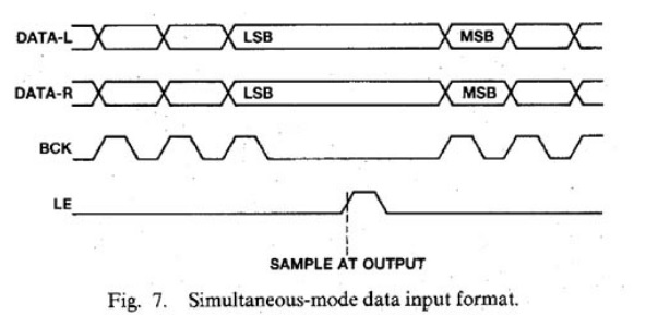

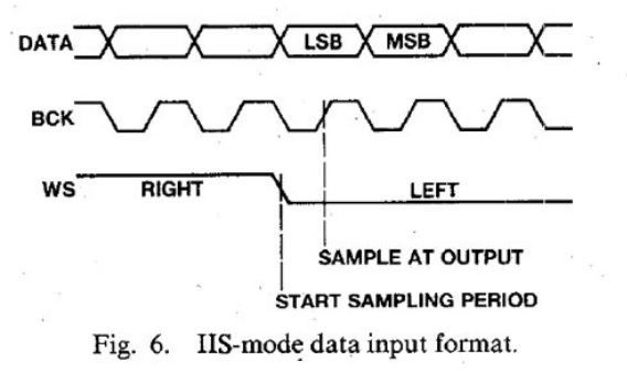

I am looking at the "DAC END" schematic, trying to understand the use of the 74HC04 hex inverter to generate a latch signal for the right channel of the AD1865N-K. I understand this might be specific to the AD1865N-K chip, but I would like to understand as many of these designs as possible to inform my own. Is there a text one might recommend that dives into the design theory of the digital front end for these R2R designs? That will be the hardest nut to crack for me, I think.

The digital front end depends on the specific DAC chip and not on the DAC type.
Different R2R DAC chips could use different protocols, for example the TDA1541A also supports I2S while the AD1865 supports PCM only.
You should look at the datasheet of the specific DAC chip you are interested (protocol and timing section).

FYI, there is an article from Pedja that explains the evolution of the I2S vs PCM on the TDA1540 vs TDA1541a. TDA1541A and Model S USB, part 2: Simultaneous data mode - Audial I found it informative.
