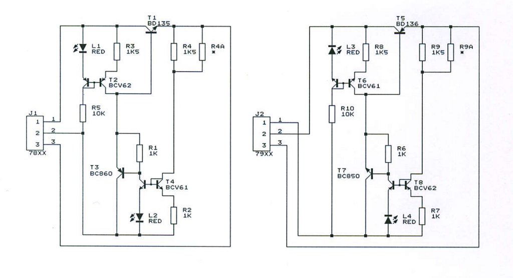

Hi LOrdGwyn,
If the reflected secondary impedance equals 54 Ohm, the primary voltage swing would be 0.004 * 54 = 216mVpp. The secondary voltage swing would be 2.16Vpp.

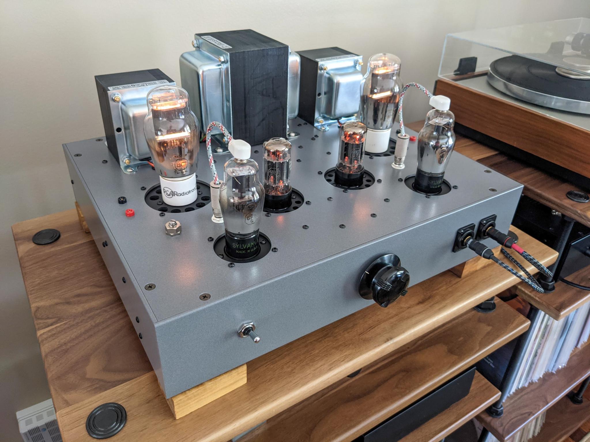

Same here (attached picture). These are 5W class A push-pull mono blocks based on 6N6P driver triodes exclusively. These were designed and built recently for use with the PowerDAC-R.
Common cathode gain stage (directly driven by the resistor array that has 30 Ohm output impedance).
Improved see-saw phase inverter (symmetry, frequency response).
2 x 4 paralleled triodes (cathode biased, not bypassed) in the push-pull output stage.
Toroidal 80W output transformer (Toroidy).
HV derived from standard 2 x 18V / 25VA toroidal PCB transformer + voltage quadrupler circuit.
Filament voltage derived from a standard 2 x 7V /25VA PCB transformer.
Two Mundorf 0.15uF EVO-OIL coupling caps (between see-saw phase splitter outputs and output stage).
Measured output impedance with KT88 transformer, approx. 4 Ohms. Frequency response (-3dB) 80 KHz. No global feedback.

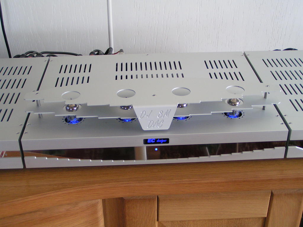

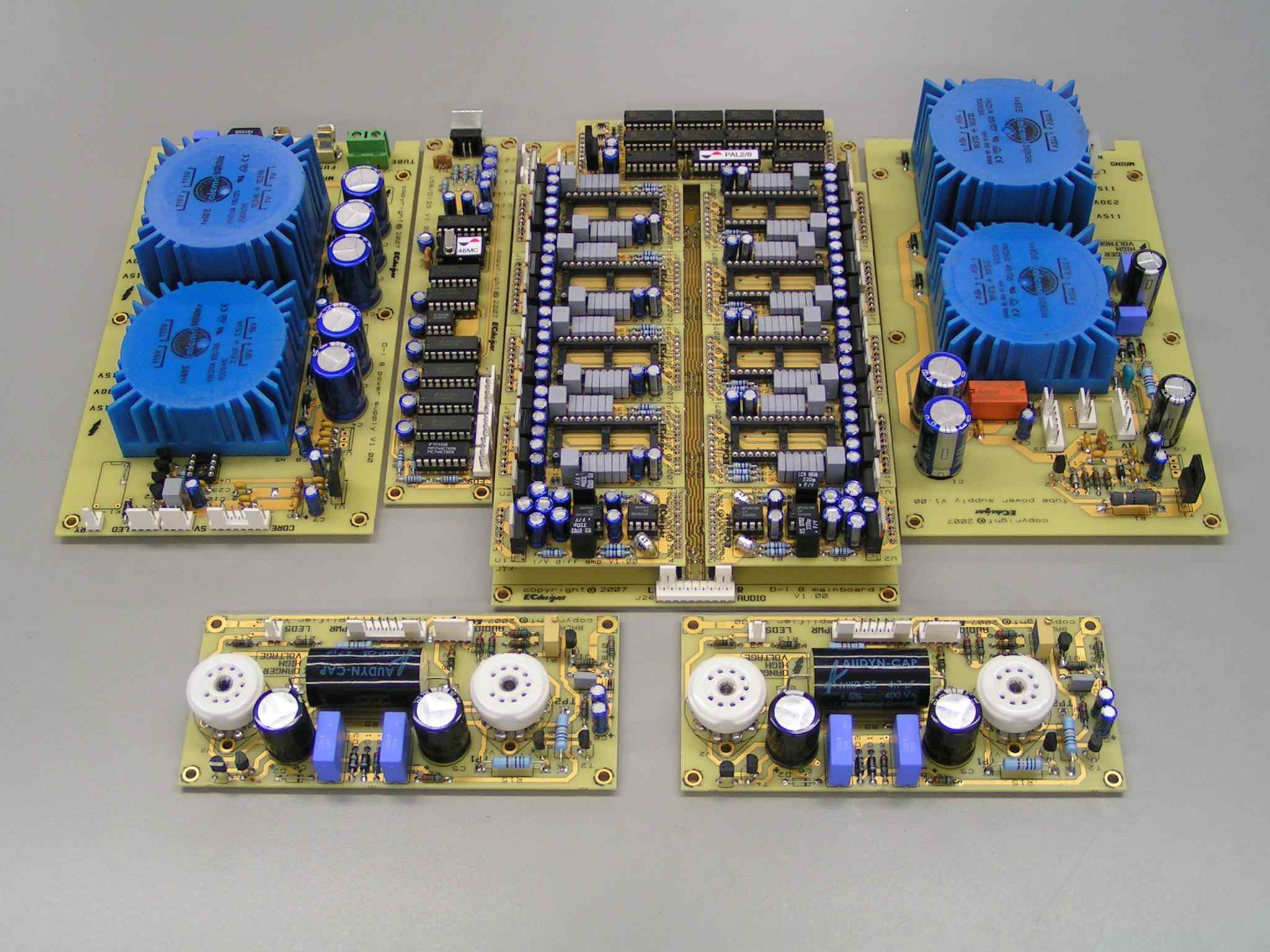

And I used a long tailed pair + cathode follower many years ago in the DI8M DAC project (8 * TDA1541A in parallel).
My first tube project was over 40 years ago, it was a tube-based oscilloscope with a DG7-32 picture tube.

ECdesigns has done an amazing amount of research on the merits of various decisions documented in this thread. Ryanj captured a bunch of this and created a PCB that many have enjoyed. He could also be a valuable resource to you on your journey.
DIY TDA1541A PCB "D3"
In my experience a tube output stage is a pleasant sounding companion to the TDA1541a btw.
Thank you for another link, really a bounty of information you all have left for others. I'm hoping my implementation will impress, given it is my first I think it will satisfy!
In the active way you could use a choke loaded grounded grid tube I/V stage (DAC output into the cathode circuit).
Very impressive! They are beautiful amplifiers, I'm sure the sound matches.
I only started doing tube DIY last January, but given the pandemic I had lots of time to learn and work on projects...I've been four tube amplifiers since then, a tube phono, restored various vintage gear, and more on the way!
Here is my most recent, single-ended class A2 801A with near 0V grid bias point, parallel 6BX7 cathode follower driving the grid
![PXL_20210523_191213763-2.jpg PXL_20210523_191213763-2.jpg](https://www.diyaudio.com/community/data/attachments/886/886600-966c95f2ee35941edfbf3a50ced0dd06.jpg)

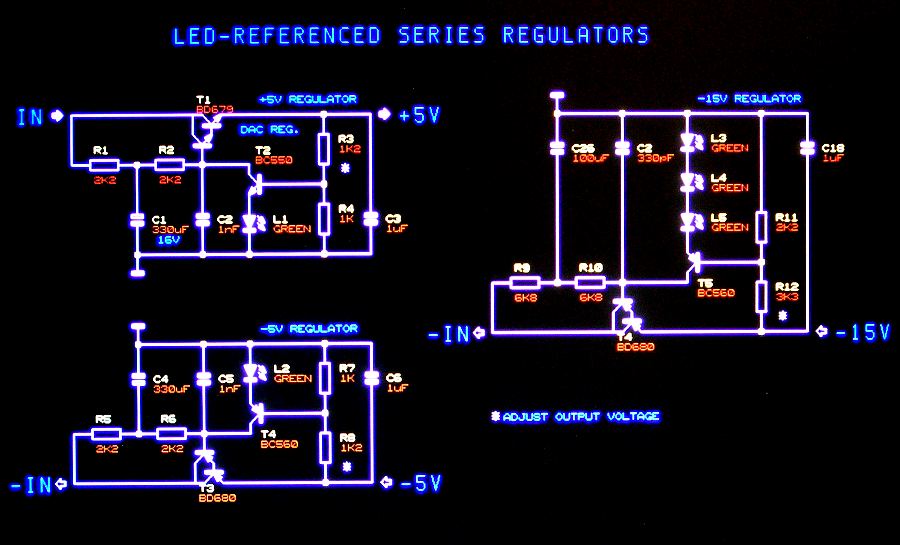

Simple Voltage Regulators Chapter 2: Output Impedance
You are using a shunt regulator with zener / LED as a voltage reference as opposed to TL431 error amplifier?

John here showed many reg confs for the TDA1541A, problem is it's hard to find : maybe by clicking ust the attached files item on the thread title line ?

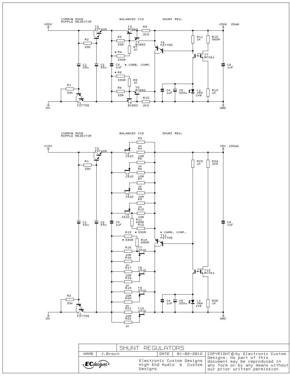

Here some attachments from the thread...
@LG : I checked, it's not a shunt reg in fact but a serie one, my bad. the Darlington is an emitter follower if I'm not wrong (way above my head)...
I really like the Rogic power supplies for 1541A.. IME stick with seperate windings for each supply and stick with his 10R common mode to reduce current charging pulses. I would add an extra filter section (depening on which version you are looking at). I also really liked small value (effective at HF) choke in each leg (common) but not on a common core. There was also his DS revision where detail was explained WRT small/no capacitor post regulator at one or more of the rails.
