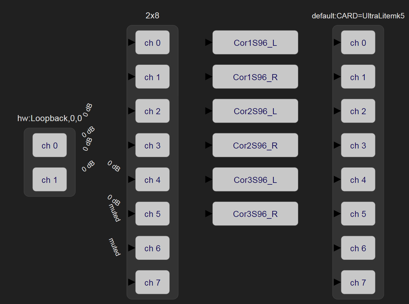

It would be nice to see the up or down sampling step as a box in the pipeline plot. And the we would know as a Conv filter would be plotted either after or before this.

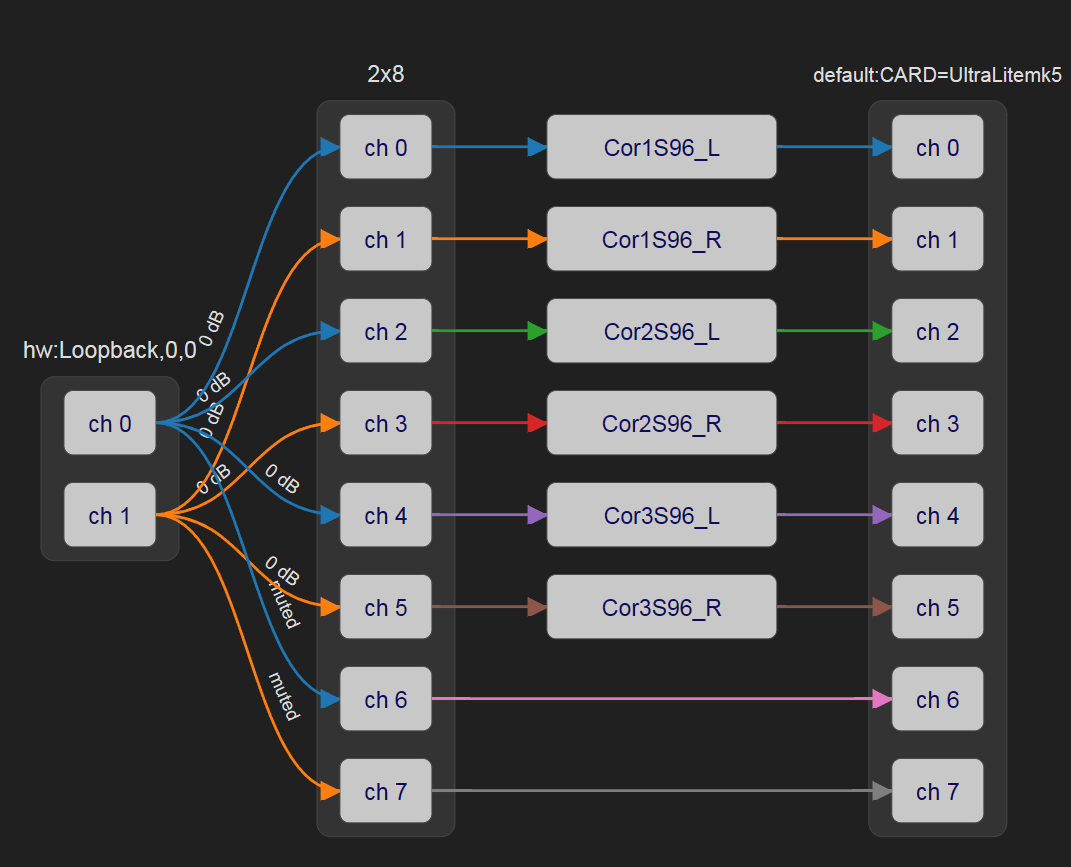

I do like the coloured lines in the pipeline plot.
Yes that's probably a good idea, then there can be no confusion. I'll add this in the next major version.

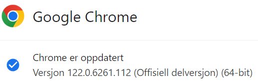

I upgraded from 2.0.0. to 2.0.3 and my lines has disappeared in the pipeline plot. I also upgraded to Pycamilladsp 2.0.2 and Backend 2.1.0. I tried a browser refresh, but it dosen't help. Does anyone have an idea of what is wrong?

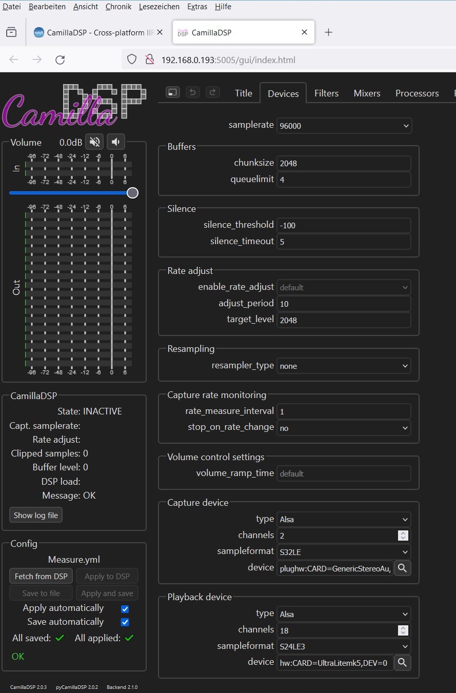

I have a problem with config files not being automatically activated in v2.03 on a raspberry pi 4 and Zero 2w. I have it set up according to the excellent instructions on audioscience review, and everything works except that I have to go into the GUI and 'Apply to DSP' before the config that's active in the statefile is loaded into the DSP and then everything works fine, until I reboot. This is a problem when I'm running off grid without my usual wifi. The service that starts Camilla DSP has these lines in it (among others):
User=pi
WorkingDirectory=~
ExecStart=camilladsp -s camilladsp/statefile.yml -w -g-9 -o camilladsp/camilladsp.log -p 1234
I tried adding a default.yml config and referencing it at the end of the ExecStart line, but that didn't work either. Any suggestions?
