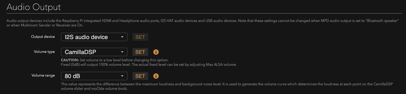

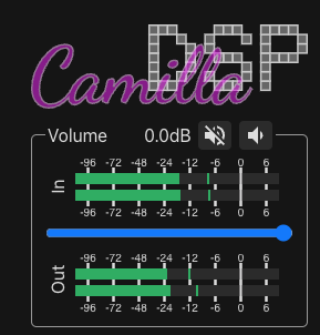

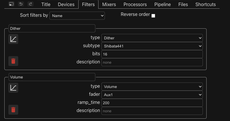

I use Camilla DSP with Moode Audio on a Raspberry Pi4. I noticed that when using Camilla DSP, the output volume is lower in general. There is no gain attenuation anywhere in the pipeline so curious why this is the case. I only have a flat dither and a volume filter in the pipeline configuration. Even compared to the input volume, the output volume seems a few DBs lower (screen shot). I usually have to have my volume knob on my integrated amp at 4'o clock when using Moode + CamillaDSP whereas if i use the MPD (with Camilla DSP off) i can listen at 1'o clock setting. @HenrikEnquist thoughts on why this might be the case.
Yes, That reflects the software volume setting on MoOde. I noticed it immediately on posting. I then raised the setting to 100% on MoOde and the pipeline page showed -0.0 db as expected. The difference (apparent attenuation) between using the CDSP configuration and without remains the same. The volume heard goes up and down chamginge the MoOde setting, but it's always quieter when the V2-ProtoDAC.yml config is invoked.

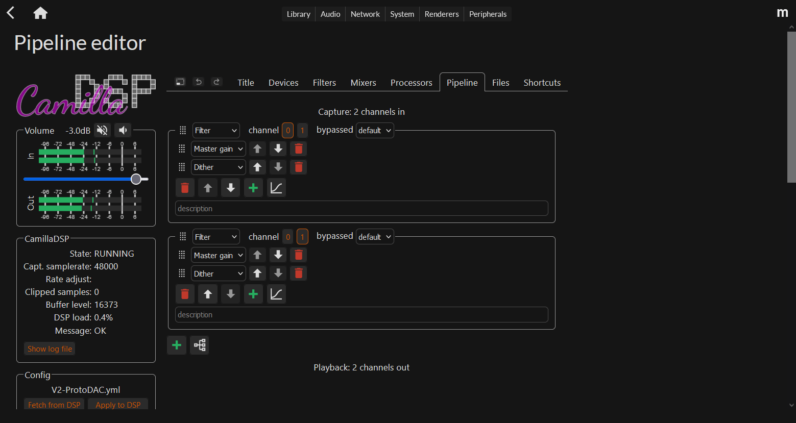

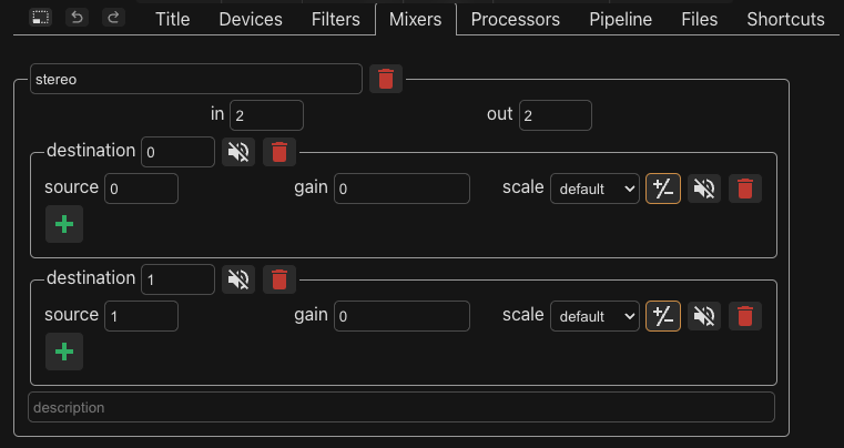

Here's the yaml file.
YAML:
description: ProtoDAC TDA1387 X8 Non-oversampling DAC. Invert +/- signal polarity on both channels and apply Flat dither to

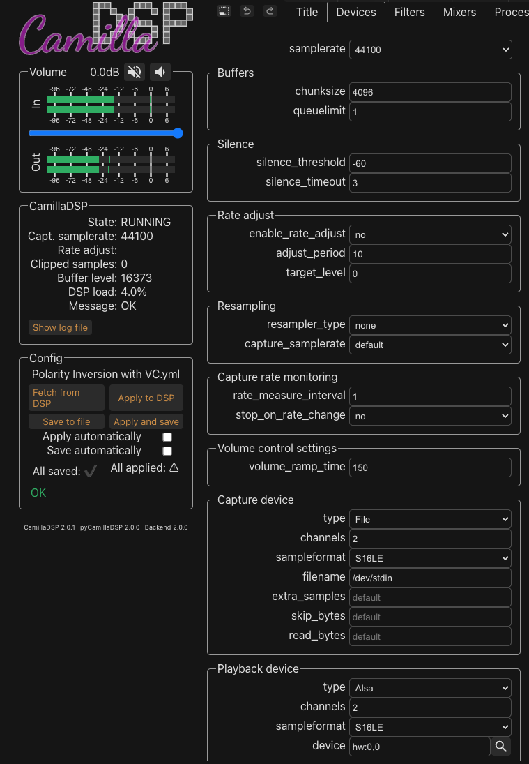

devices:
  adjust_period: null
  capture:
    channels: 2
    extra_samples: null
    filename: /dev/stdin
    format: S24LE
    read_bytes: null
    skip_bytes: null
    type: File
  capture_samplerate: null
  chunksize: 4096
  enable_rate_adjust: null
  playback:
    channels: 2
    device: hw:0,0
    format: S24LE
    type: Alsa
  queuelimit: 1
  rate_measure_interval: null
  samplerate: 44100
  silence_threshold: null
  silence_timeout: null
  stop_on_rate_change: null
  target_level: null
  volume_ramp_time: 150

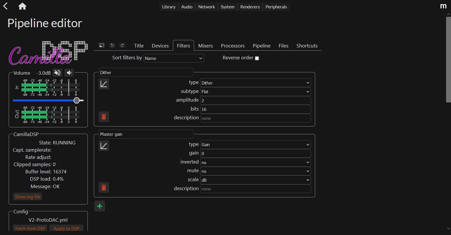

filters:
  Dither:
    description: null
    parameters:
      amplitude: 2
      bits: 16
      type: Flat
    type: Dither
  Master gain:
    description: null
    parameters:
      gain: 0
      inverted: false
      mute: false
      scale: dB
    type: Gain

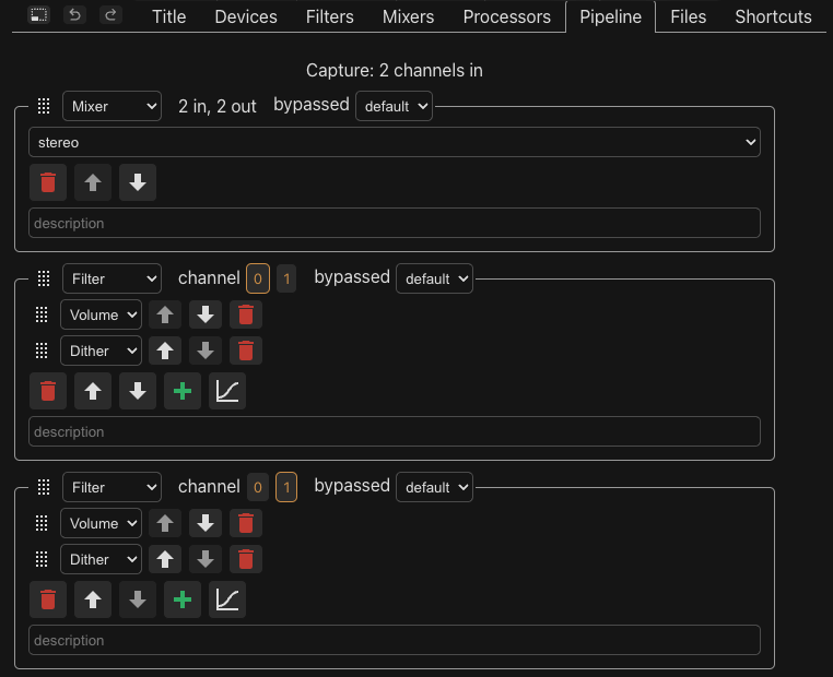

mixers:
  Stereo:
    channels:
      in: 2
      out: 2
    description: null
    mapping:
    - dest: 0
      mute: false
      sources:
      - channel: 0
        gain: 0
        inverted: true
        mute: false
        scale: dB
    - dest: 1
      mute: false
      sources:
      - channel: 1
        gain: 0
        inverted: true
        mute: false
        scale: dB
pipeline:
- bypassed: null
  channel: 0
  description: null
  names:
  - Master gain
  - Dither
  type: Filter
- bypassed: null
  channel: 1
  description: null
  names:
  - Master gain
  - Dither
  type: Filter
processors: null
title: ProtoDAC TDA1387 X8
The ProtoDAC is a "passive mode" DAC i.e. it has no control interface (I2C), no on-board clocks, it just accepts an I2S data stream. Here are the pieces in the audio and volume chains.
Here's the audio chain up to the DAC:
Code:
---------------------------- Raspberry Pi -----------------------------     ----- Device ------
MPD -> alsa_cdsp -> CamillaDSP -> ALSA -> i2s-dac/pcm1794 driver -> I2S ==> ProtoDAC TDA1387 X8
The volume chain can be configured one of two ways.
1. MPD software volume
In this configuration CamillaDSP volume is set to 0dB in the moode routine that sets MPD volume type to "software".
Code:
MPD -> software volume -> alsa_cdsp -> CamillaDSP volume (0dB) -> ...
2. CamillaDSP volume
In this configuration MPD volume is set to "null" (fake volume) which causes MPD to output 0dB but still emit volume change events that are then picked up by a daemon (mpd2cdspvolume) that proxies the MPD volume level N (0 -100) to CamillaDSP volume in dB.
Code:
MPD -> fake volume (0dB)-> alsa_cdsp -> CamillaDSP  volume (-120dB - 0dB) -> ...
Hi folks,
I’ve been running Camilla DSP on a raspberry pi for a few years now and although its been great I have an issue which I wonder if anyone has some insight on.
I have a SPIDF input on my PI from my TV which then feeds into Camilla and then from there feeds out my DAC (OKTO). When the TV is off Camilla goes into a paused state and then I have to turn both the DAC off and turn the TV on and off again to get Camilla to work.
Is there a work around for this?
Not sure if this is related given CDSP with your TV off goes to pause mode as i should when input is missing. Anyway I had a similar problem when DAC where powered of CDSP had to manually be restarted. Back then Henrid sorted me out by recommending not to run CDSP with the -w (wait) argument. Then it will recover from error state automatically when DAC is powered on again.
@TNT, @HenrikEnquist here are my settings in Moode/Camilla DSP
Ok got it :) You have an extra Volume filter in the pipeline, reacting to fader Aux1.
In v2.0 there is always a volume control, no need to add one as a filter. The Aux1 fader will be set to -6 dB by the mpd2cdspvolume daemon:
CDSP_STATE_TEMPLATE = { 'config_path': '/usr/share/camilladsp/working_config.yml', 'mute': [ False,False, False,False,False], 'volume': [ -6.0, -6.0, -6.0, -6.0, -6.0] }
The Aux faders are not (yet) exposed in the UI, only the Main one is. Which means this extra volume control is stuck at -6 dB.
The solution is simply to get rid of the Volume filter :)
