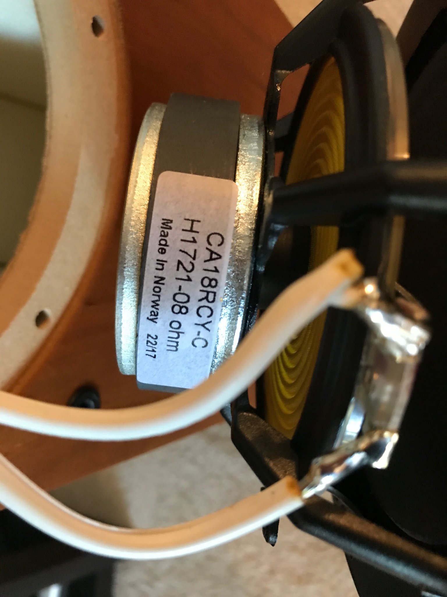

the below is a pic of the bottom woofer in my Proac. Although I can’t find any data on it.
Between 5mm & 10mm bitumen on all inside panels depending on which model
you can see the bitumen.
not sure how thick it is. Would need to open it again.
Seas CA18RCY-C is a custom chassis made for ProAc with a bigger lip to accommodate the Proac logoand is similar to the bottom woofer in my Proac DT8
You can buy the standard CA18RCY with the standard lip for around £70 Proacs would be £300 ish
They both sound the same just made to look different
CA18RCY - C is also in the studio 140

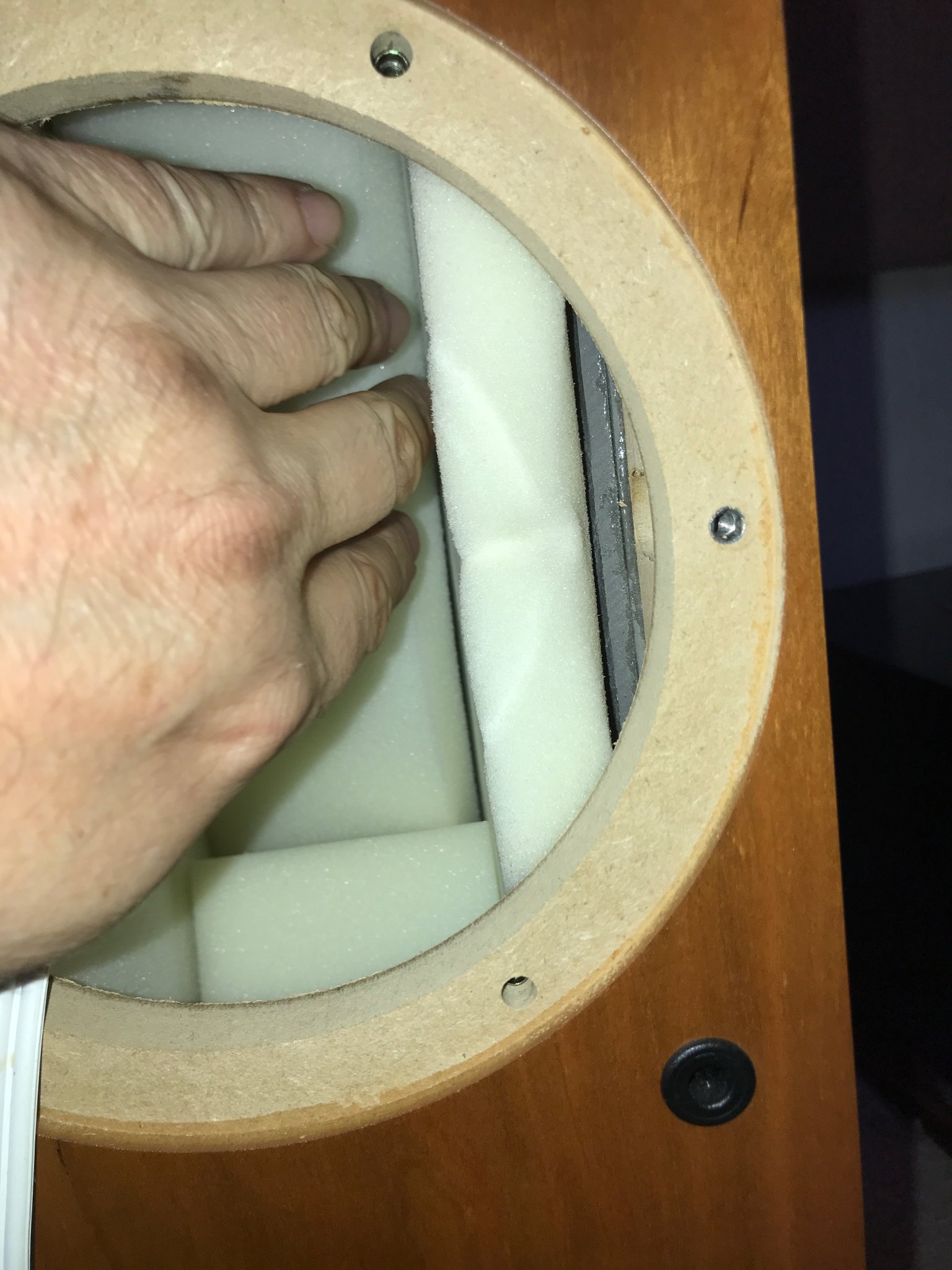

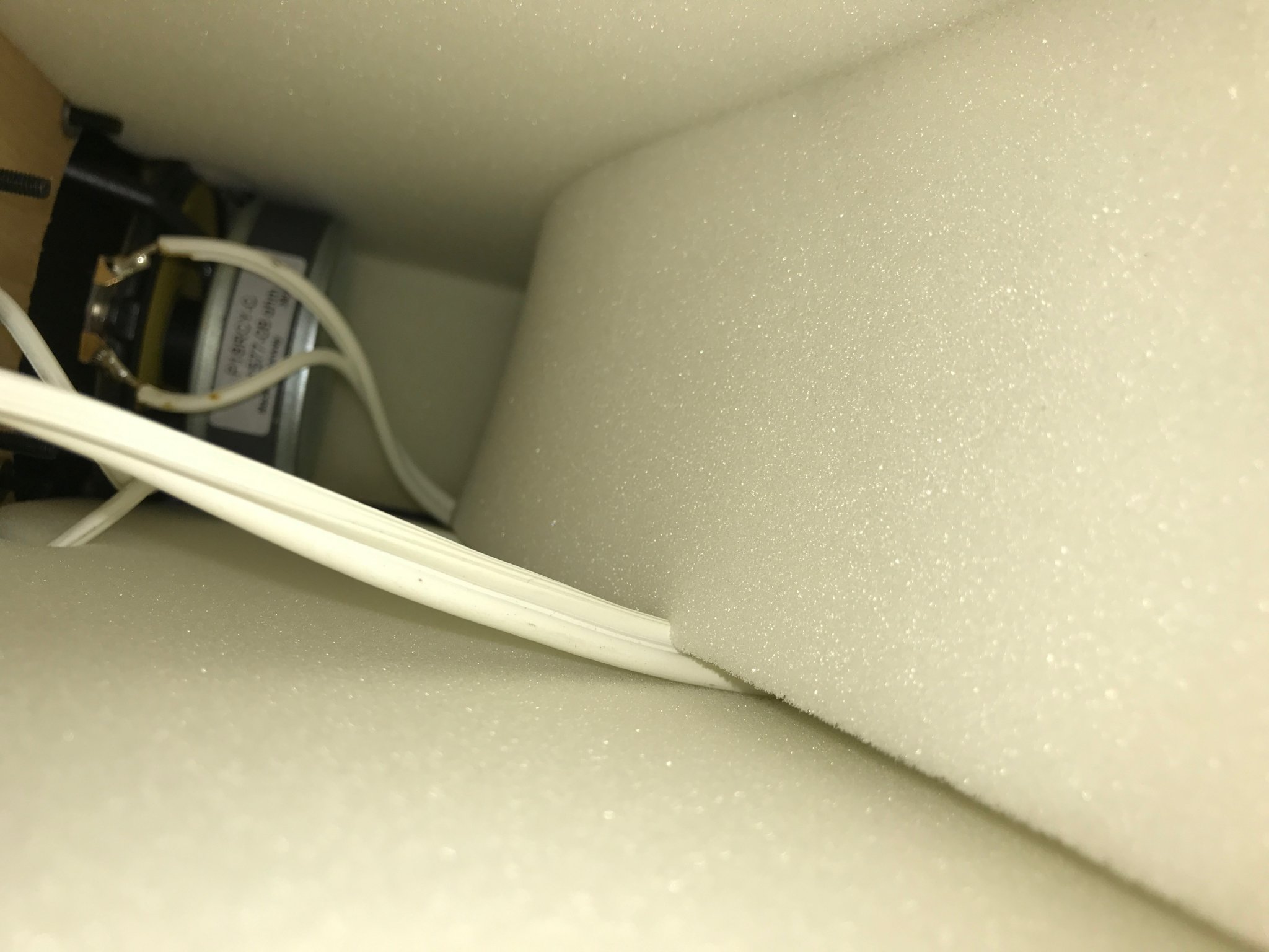

would changing out some of the lining which now is some sort of poly foam , with wool felt make for cleaner mids and highs?
something from here?
https://www.mcmaster.com/wool-felt/...alPath=wool-felt/firm-felt-sheets-and-strips/
here are a couple pics with the poly foam lining in the speaker currently.
Depends. Foam is usually used because it is consistent and low kabour to install.
Some ML-TLs are just lined, some with volue fill. All those i have done have been volume fill with either teased UltrTouch Insulation or well teased Acoustastuff.
You can tune the response to suit the room, placement and your taste. They should both also be considerably better at killing mid/top frequencies.
dave
