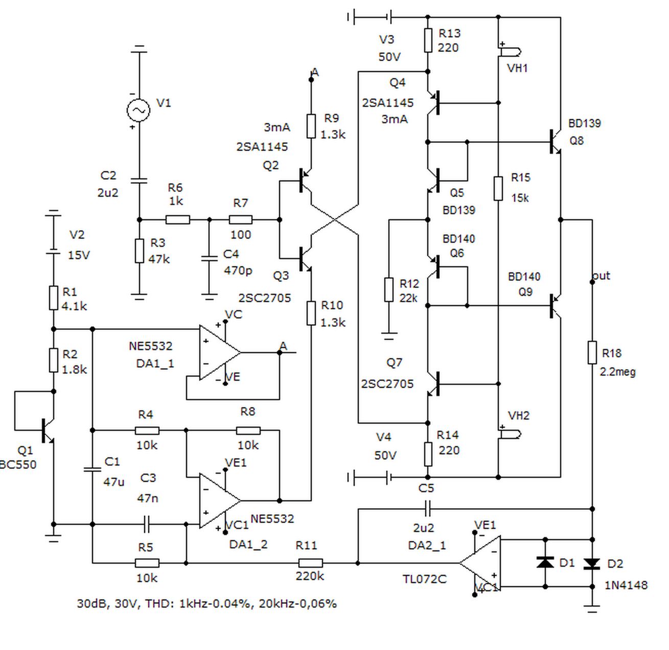

Could you post a schematic of your tunable error-correction OPS..??
I have seen this done on an amplifier with good results.
You can type in the search radiohibby 04 2013 - is the beginning of the article
ending in the next magazin radiohobby 05 2013

Links do not open, Could I trouble you to find the schematics and post them here as Graphics (PNG) files.

MiiB (4303)
Are the EC transistors connected to the Rails or to the VAS drive..??
I in my designs VAS using broken cascode
http://s019.radikal.ru/i610/1401/39/235f2cf252a7.png
best regards
Petr

Don't you have feedback through the opamp network..??
Operational amplifiers are responsible for the constant component voltage of the output - the servo. They work at subsonic frequencies below 1 Hz and do not affect in sound range. In the driver, only one shoulder power of input stage is controlled integrator.

I use a small negative value of the output resistance of about minus 0.2 ohms
You choice, in my book this is useless and dangerous, from a stability perspective.
I know about a theoretical improvement when matching the speaker Qts/Qes, but that would be exactly valid for a particular speaker only.

Waly (4318)
Waly! in your book, it is useless and dangerous, and in my experience it is very useful and safe. Repeat this all very pleased with the sound of power and no one complains about the instability of work. In my country, the firm was lounging on manufacturing speakers and amplifiers. After fabrication the amplifier of my circuits the company revived again. Improvements do not depend on the speakers. Tested with different types: horn, closed, labirinth (mazes) and other acoustic design.
