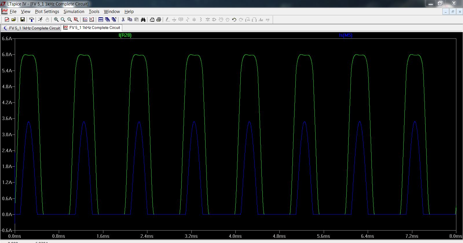

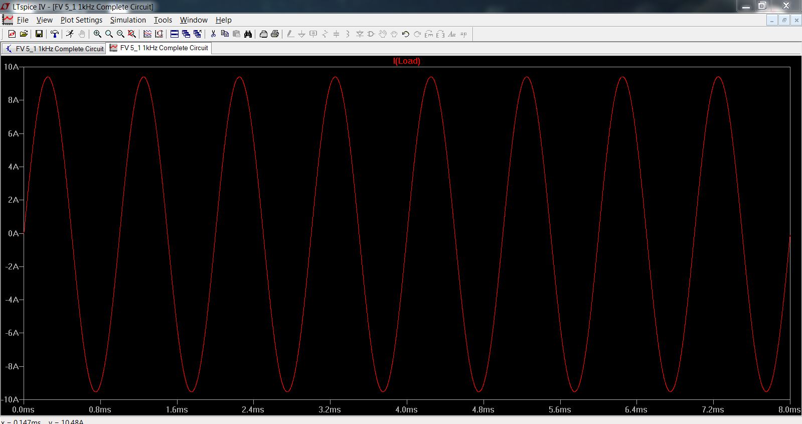

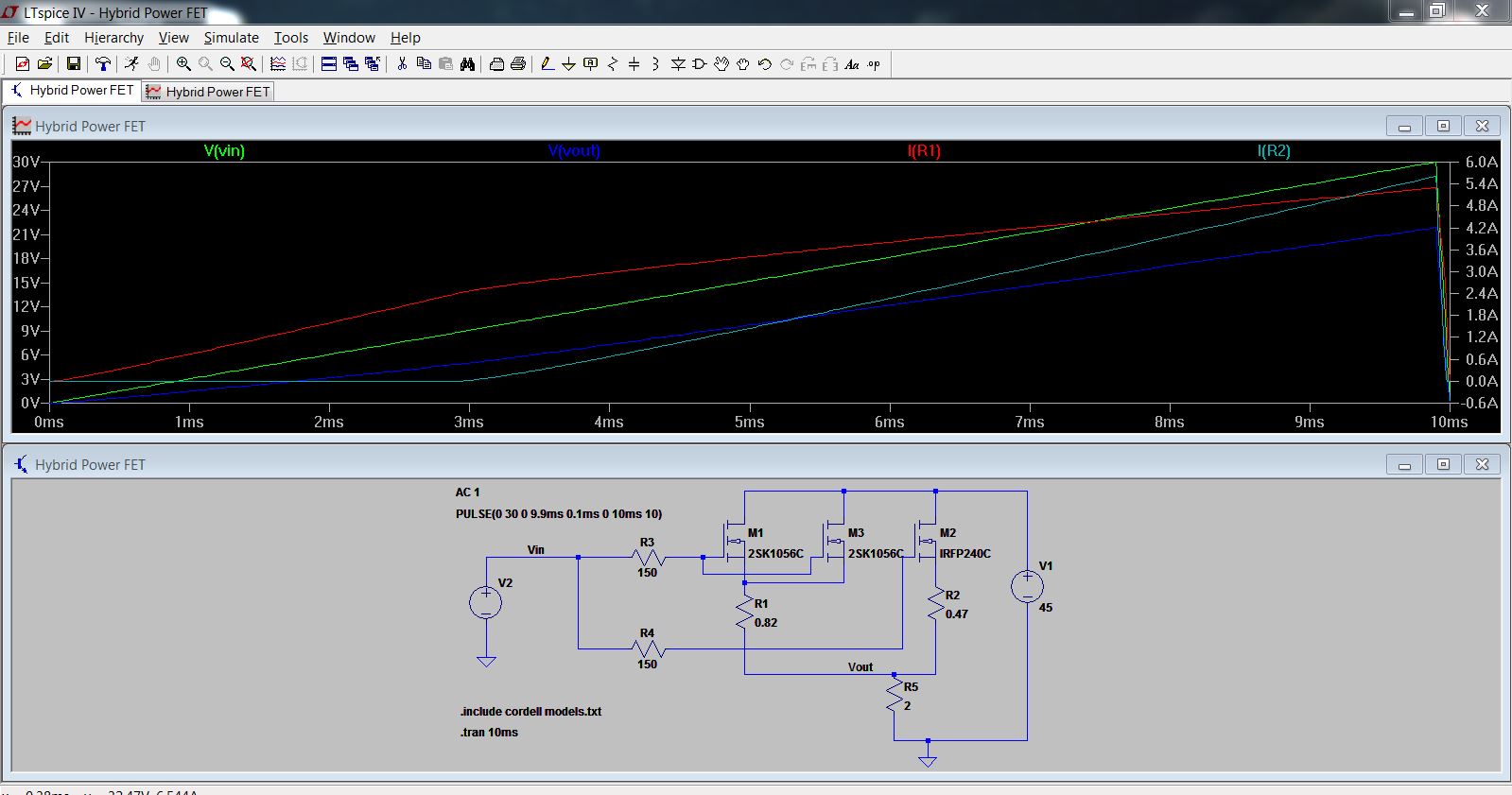

I've successfully worked on a design in simulation using Lateral FET's for normal demands and Vertical FET's running at zero standing bias for when the going gets tough. It was based on idea I put forward some years ago and relies on the Vgs properties of the different technologies.
These show the basic idea and the actual currents in each device in a CFP stage together with the load current. The lateral FET's max out at 6 amps (green) with the verticals taking over from that point as the loading becomes more severe (blue).
Neat idea.
Bob
