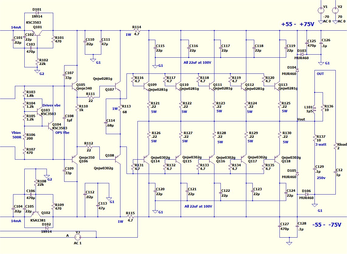

Again IMO, a 2EF is recommended for low power (<100W) amplifiers only.
Is this your opinion only or exists there detailed technical details? Maybe you are able to provide us some links or references?
This amplifier easily delivers > 220W 8R and > 440 4R using a 2EF bjt ops and has a very good low distortion performance.
BR, Toni
The EF2 for powers of up to 100 W is not a rule- just a guideline. For a 200 W EF2 amplifier, typically you would see 4 or 5 output devices and a driver stage. Into a worst case load of 3 Ohms, you would see a significant increase in distortion, and into 4 ohms, more than most designers would consider acceptable.
You've used many OP devices in parallel, and you've paralleled your VAS devices. This as you probably know means that for the most part, the OP devices operate where the hFE vs IC is high, helping to keep the distortion low. With the doubled up VAS devices, each device operates over a narrower IC range, and narrower hFE range also helping with distortion (same of course applies to the output stage).
The techniques you have used thus also achieve low distortion. The other option here would be an EF3, where with you design I would expect a further 10 to 20 dB reduction in distortion i.e 1-2 ppm range. However, chasing numbers this low is wasted effort in my view.
However, your amplifier looks like a very nice design - congratulations!

Hi Toni,
Nice work and results in that design. 2EF designs can provide good performance, but are much more vulnerable to beta droop and ft droop. Even in somewhat lower-power designs, I generally believe that a Triple is a more cost-effective way to get high performance under a wider variety of conditions, such as high current into low-impedance loads. In lower-power amplifier designs, where SOA considerations might allow as little as one output pair, it is more cost-effective to add the pre-driver to make a Triple than to add more output devices just to avoid problems with beta droop and ft droop.
So there is no hard and fast rule, just a range of preferences. Self has historically preferred 2EF, while I have usually preferred Triples. Both can yield good performance. Self achieved his so-called load invariance by paralleling output devices, I achieved it by going straight to a Triple.
Bob
I simulate my triples at 2R . Even as I never expect this , I'll get "anal" and
go for 1 or lower. Just a slightly larger "suckout" cap at the driver stage.

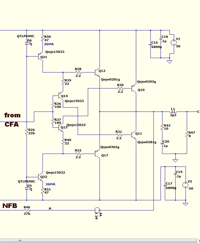

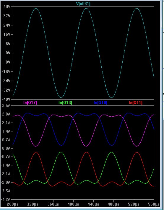

On a different tangent , anyone ever tried a class A OP on a CFA ?
Here is one (below) that is quite promising. H2 only and total THD20 about
as low as my standard EF3 (w -gnfb).
OS

With the above values , 4 pairs would be good. I have this running 80V p-p,
not quite the "power hog" as the genesis class A OPS.
Nice thing is that ALL the THD residual is H2.
PS - this "alien" OP negates itself thermally ... the MJE's offset the NJW's nearly perfectly.
OS

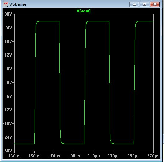

triple (below 1) puts out wave (below 2) into 1u/2r load.
I can't get this triple to oscillate - whatever I do !
20 different input stages - the OPS NEVER misbehaves ....
OS
