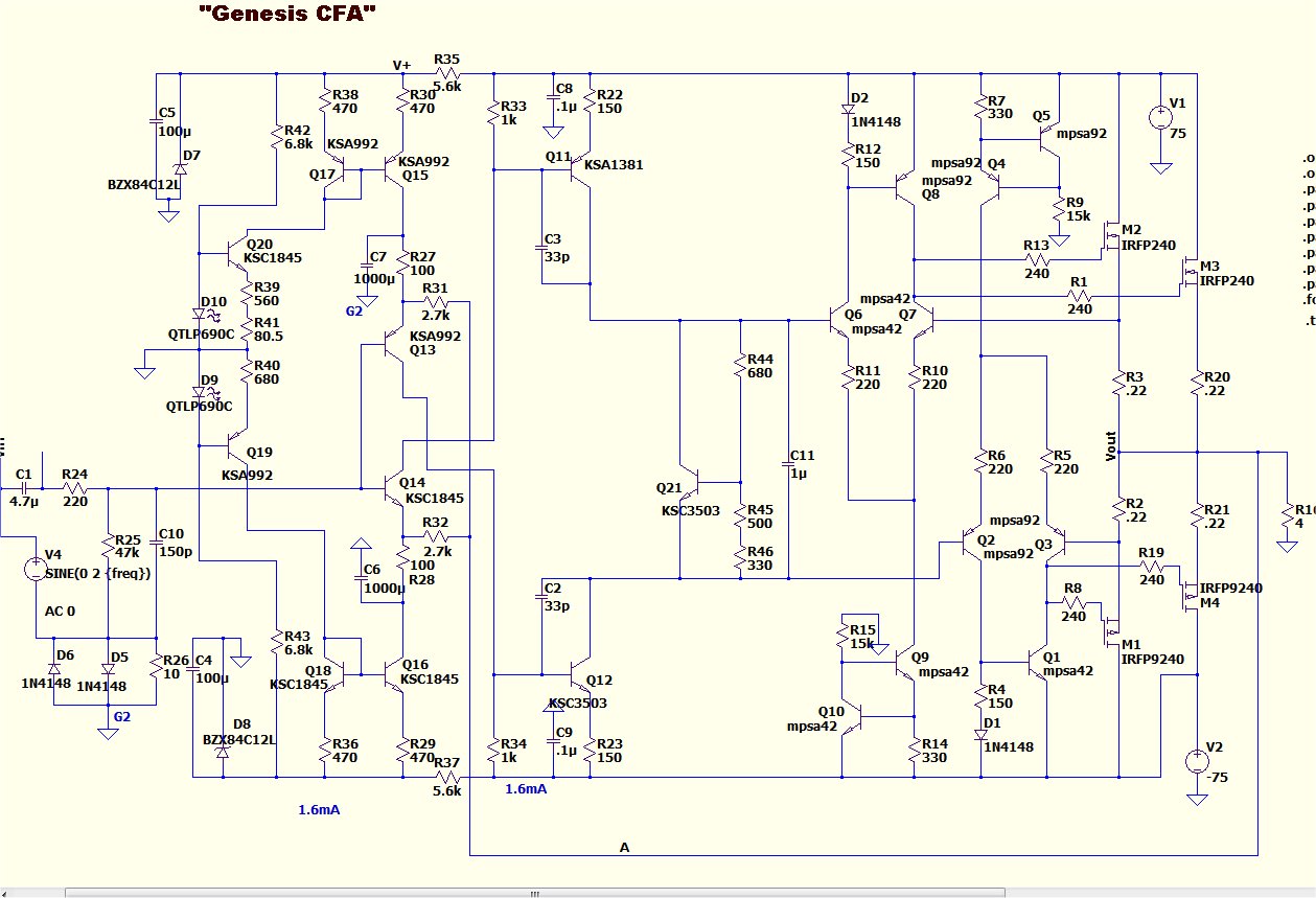

genesis stage
here's the 7000$ amp's OPS ...
Dirt cheap MPSA's + IRFP's ...😀
LOTS of heat !!! :redhot::hot::hot:
OS

Below are the 2 class A's (new one and ... the "genesis")
and the EF3.
Interesting ....THD20 of -
.08 for my new class A.
.0009 for the "genesis" .... (it seems to have OP device error correction !)
and , a healthy .018% for the EF3 (biased at 72ma).
All @ 80v p-p , 20k/8R
PS- I did not include models ... y'all want to use your own , anyhow.
OS
When I first reverse engineered it , it was one of 4 paralleled amps.
Forgot to switch it for stand alone operation.
(below) , I scaled it to a 2 pair IRFP 4R/200W class A.
..... still a nice .003% THD20 -4R.
CCS's needed more (I) for stability. 🙂
edit- broke out into oscillation as soon as it left class A !
PS - this is my oldest simulation - I knew very little in 2008 😱 😱 .
OS

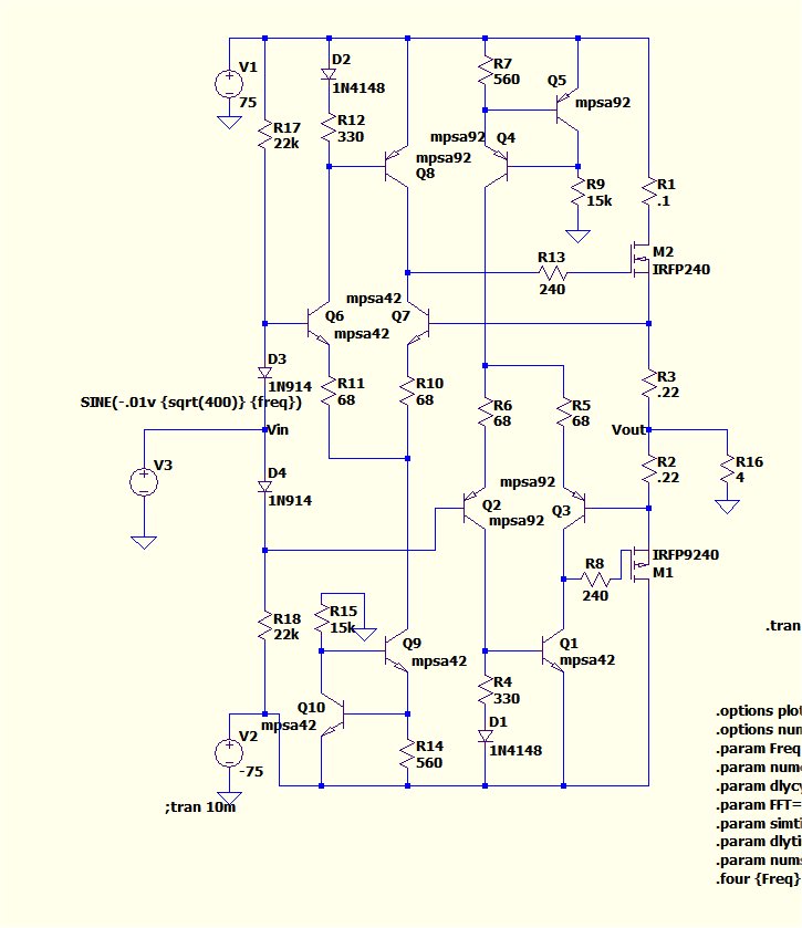

Genesis CFA ??
😀😀 Looks good , VSSA + genesis OPS.
The Vbe here can set FET bias between 3 - 6A and will thermally
stabilize the OPS. The real genesis did this plus used a computer
to allow remote control of the class A bias with a control voltage.
R45 = 0R=5.7A to 500R= 3.1A.
PS - H2 dominant and real stable (SW).
OS

I simulate my triples at 2R . Even as I never expect this , I'll get "anal" and
go for 1 or lower. Just a slightly larger "suckout" cap at the driver stage.
On a different tangent , anyone ever tried a class A OP on a CFA ?

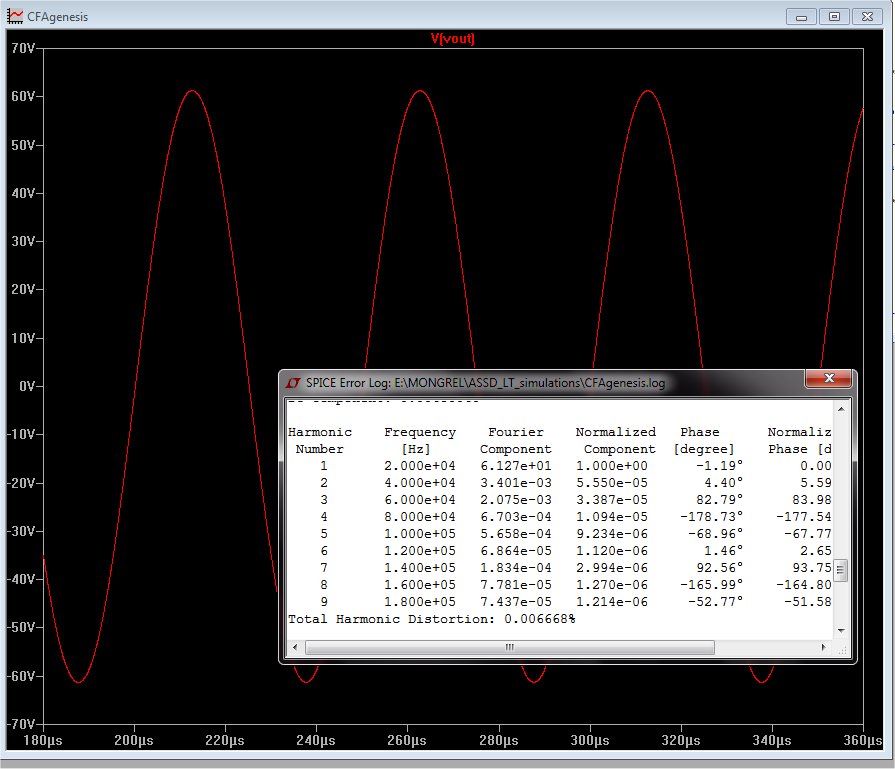

Here is one (below) that is quite promising. H2 only and total THD20 about
as low as my standard EF3 (w -gnfb).
OS
Now your talkin. Add body to the wonderful dynamic capability of your amps.
WOW ! .001/1K and .006 THD20 at 125V p-p/4R
A "pass killer" 😀 . CFA , as well !
Edit - 3 pair IRFP @ 60V will be enough SOA to have a "badger class" 150W class A. (just looked up IRFPxxx)
You would need 7A per rail continuous - 800VA 45-0-45V trafo per channel.
OS

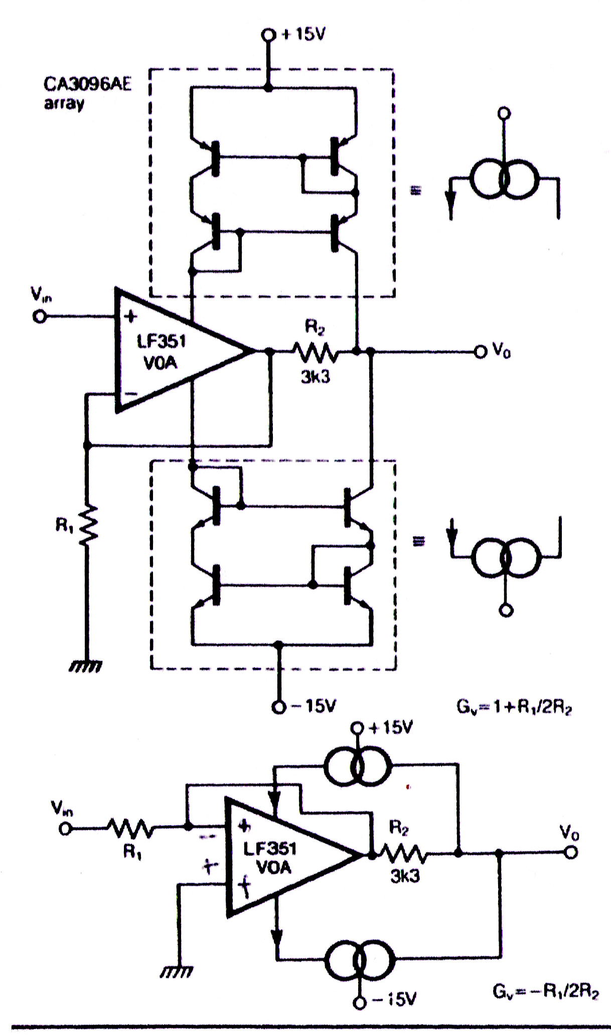

Richard: The schemo in post-4388 looks essentially like the heart of a CFA. Do you have a link to the text that goes with this?

no link... as you can see from the example (LF351), it is a very old idea; One of the benefits of collecting circuits for a long time. I believe you can find it on the Internet... it was in a circuits idea collection. I used the idea a few years ago in a Power Amp front end with a better IC OPA, of course, with excellent results. Works very well and cuts costs and size.... a long time favorite area of interest for me... thus, the reason I saved it.
THx- Having fun.
