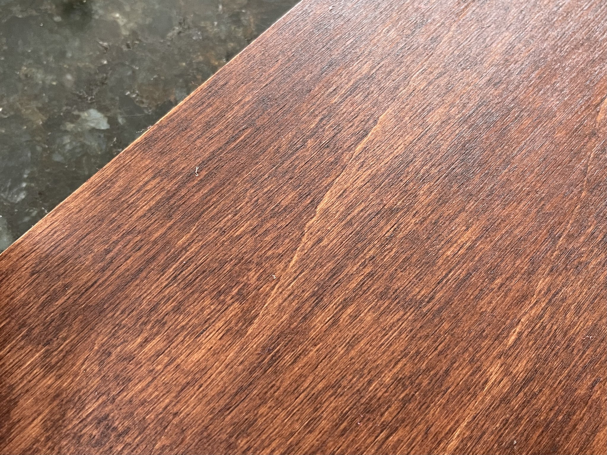

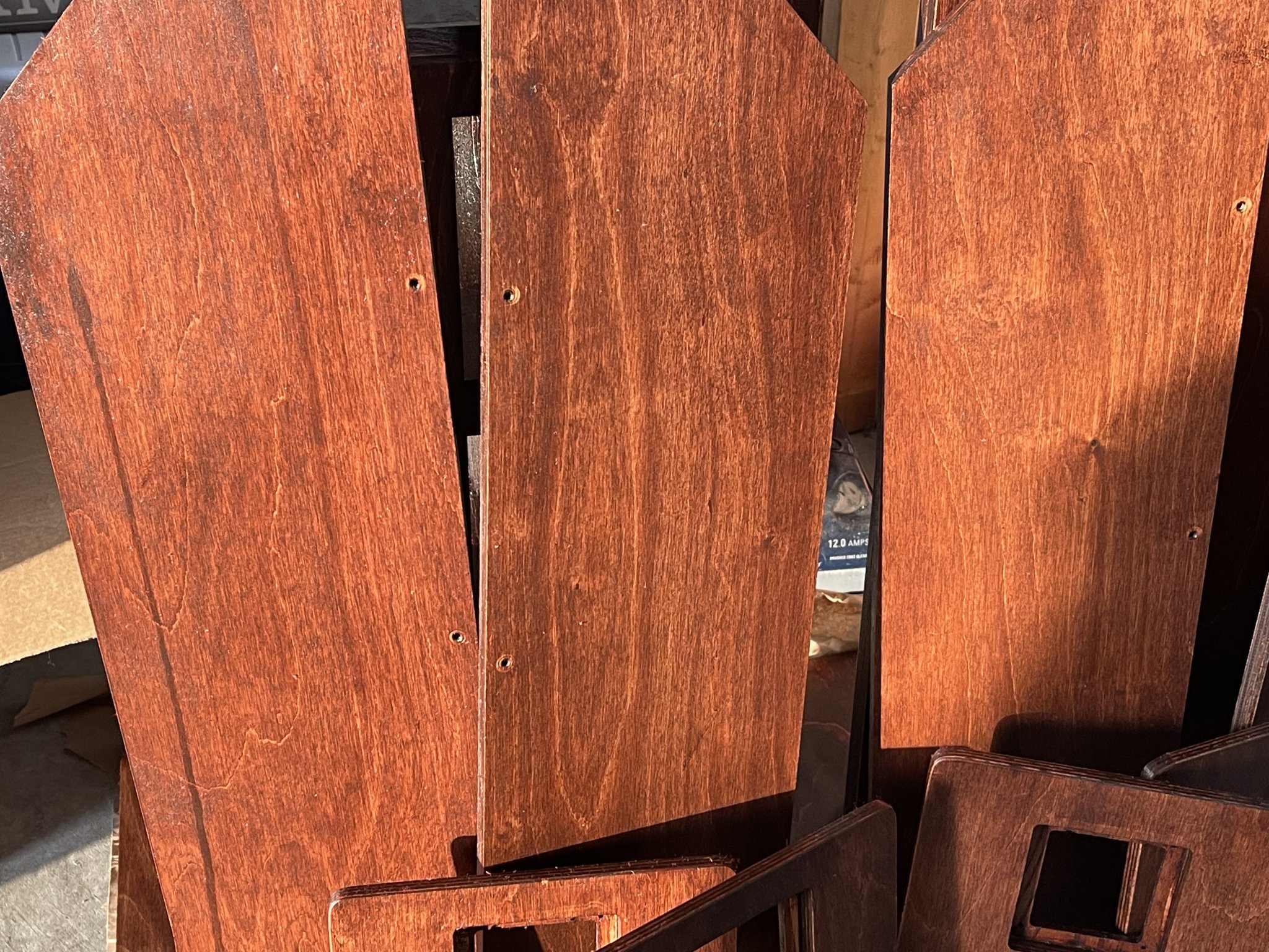

I have used espresso brown stain before in BB plywood and it never turned out as dark as I would like. I like this color much more in that it approximates antique mahogany better. The first coat of BLO has almost dried but still slightly oily to touch. Looks very good. Natural cloudy daylight through window used for illumination here vs evening sunset light yesterday which is warmer.

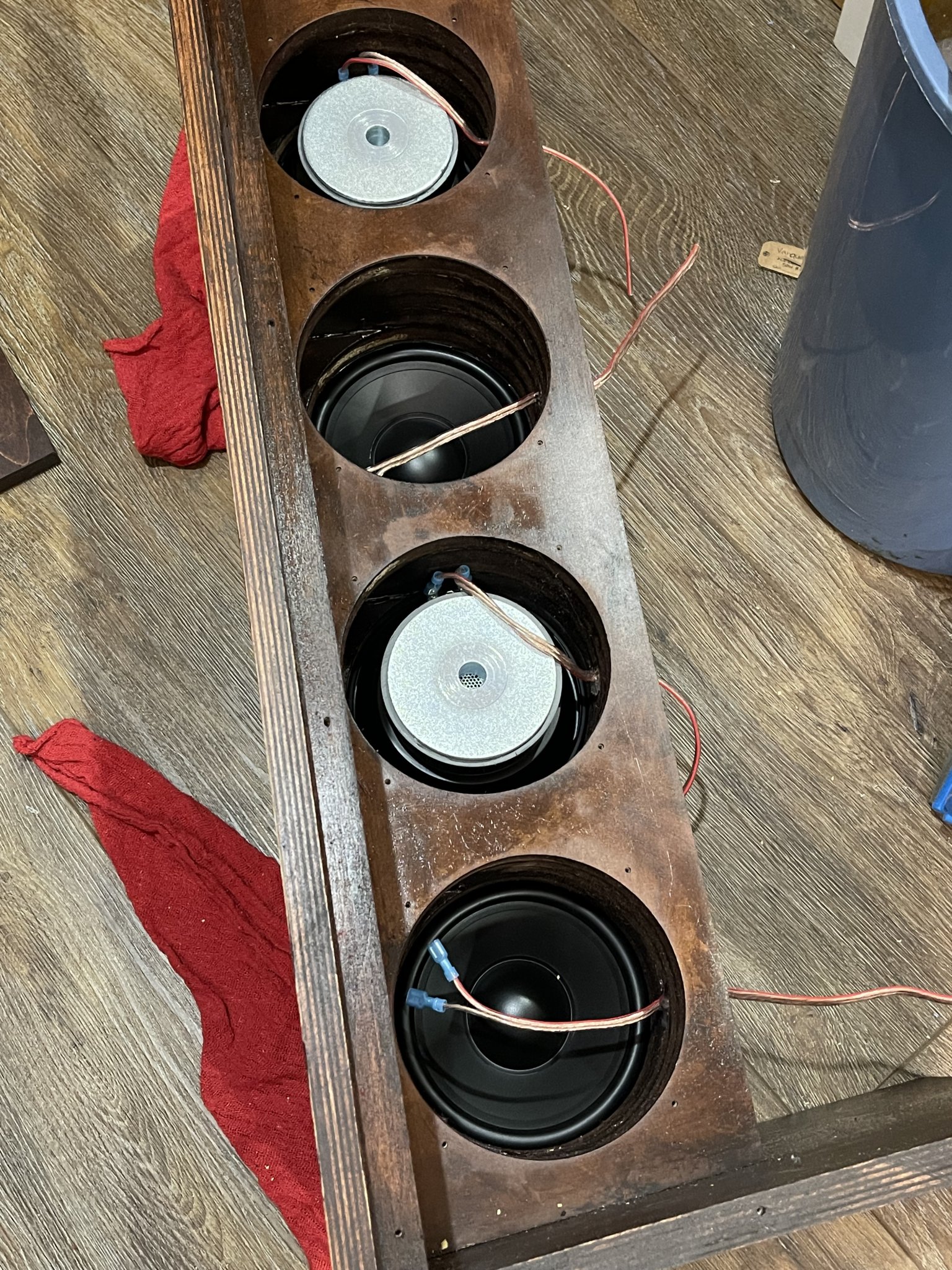

I am testing out two potential candidates for the woofers. They are the GRS 6PR-8 6.5in polycone 8ohms (85dB at 2.83v) and the Pyle PDWM6 6.5in paper cone foam surround 8ohms (92dB at 2.83v). The latter should have plenty of sensitivity but Fs is not as low (as is typical higher sensitivity for pro audio woofers). Both use identical stamped steel baskets with 4 screws so I can swap them out after I determine which one I will go with.
I will be wiring them as 4 sets in parallel pairs for 4ohm each set, then series/parallel those 4ohm pairs for a nominal 4ohms. Paralling an 8ohm should give +6dB at same 2.83v, then series paralleling those shoulld give another +6dB sensitivity boost. Open baffle will lose about 6dB of sensitivity. So overall should be +6dB or 91dB at 2.83v sensitivity at around 100Hz.

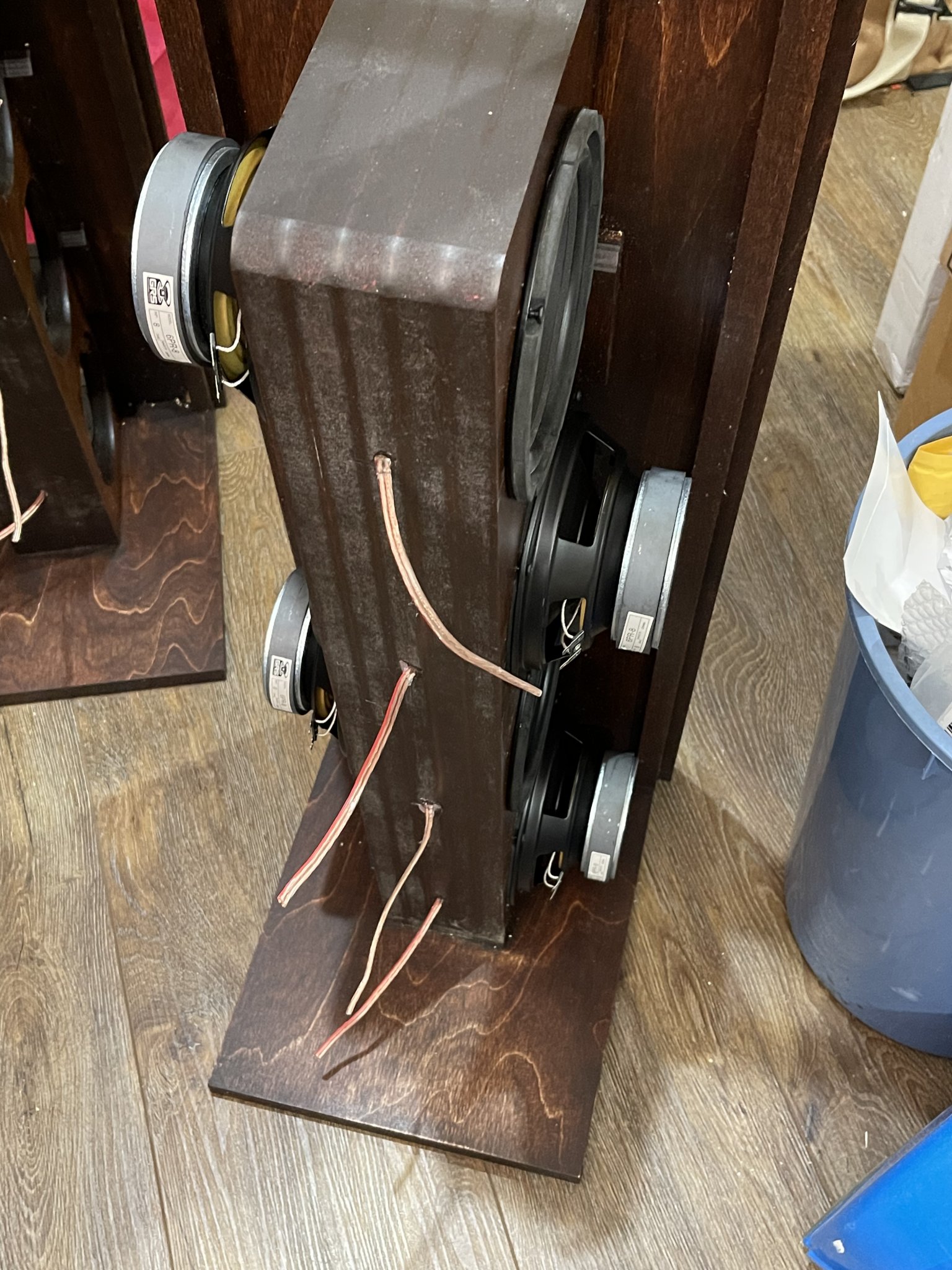

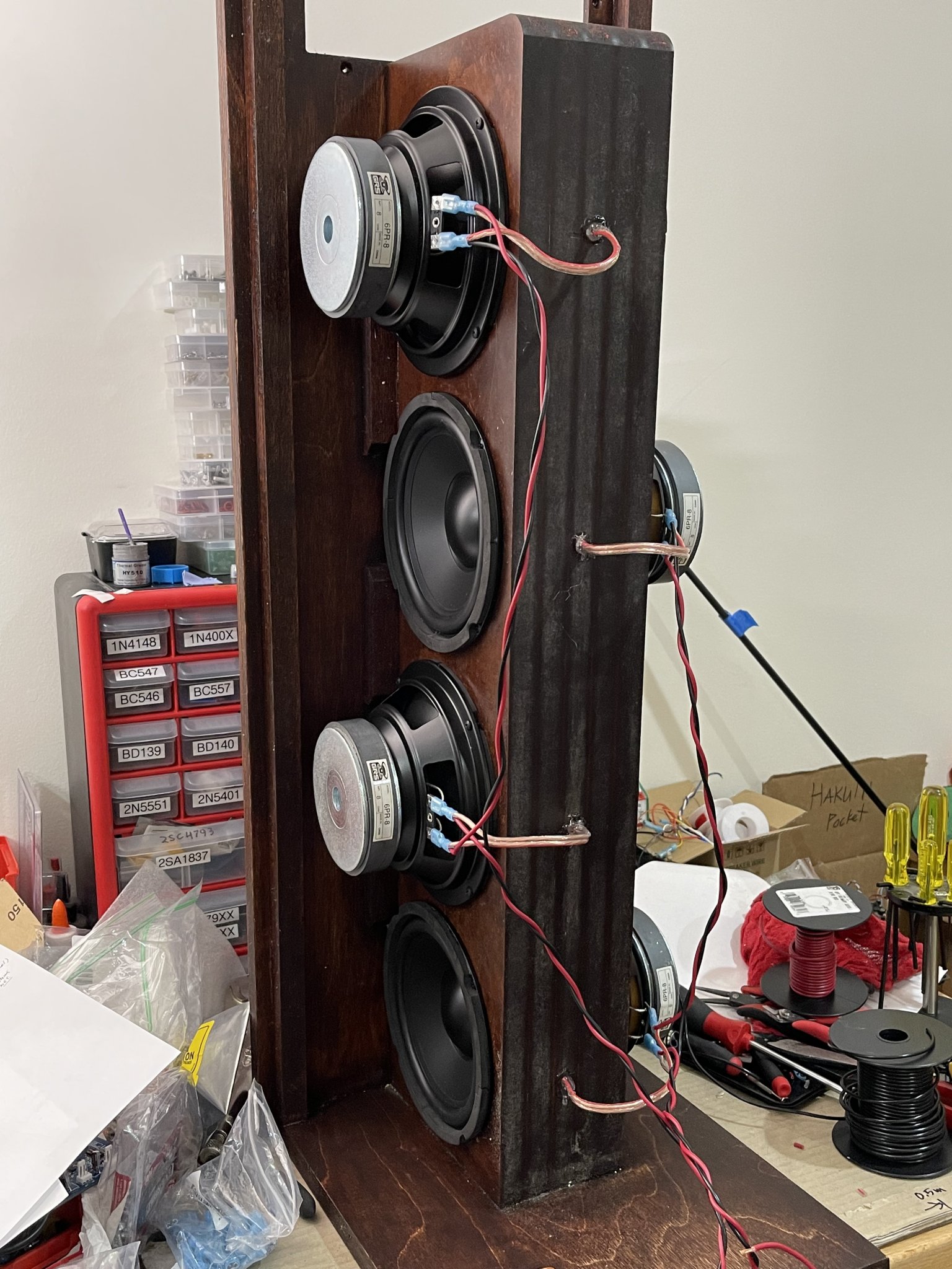

Installed the woofers today. 4 sets of parallel and 2x series then parallel those for 4ohms nominal. Alternating drivers in and out. All wired up and tested polarity with 9v battery. All drivers push in and squeeze air out of slot on +ve polarity.
The weight of 8x woofers is really noticeable. This is a heavy speaker now. Listing it up onto the bench to do the wiring wasn’t easy. About 52lbs now I think, before tops or wings or XO boards.
Good call on testing polarity yourself. I've seen a few woofers that have had their wrongly labelled.
But a 9V battery is a bit overkill ! A small 1.5V is good enough, and causes less stress, especially on smaller drivers with limited XMax, or heaven's forbid... tweeters!
I tried a 1.5v battery and could not see the deflection well enough. 9v is equivalent of 1 way stroke for 10w power into 4ohms. Not too bad. I was less concerned about the mislabeled polarity and more whether or not I wired it correctly. My estimates say that 8x 8ohm drivers wired as such should give +12dB at 2.83v? 4x parallel / 2xseries / 1x parallel wiring.

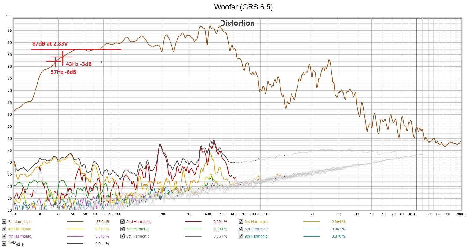

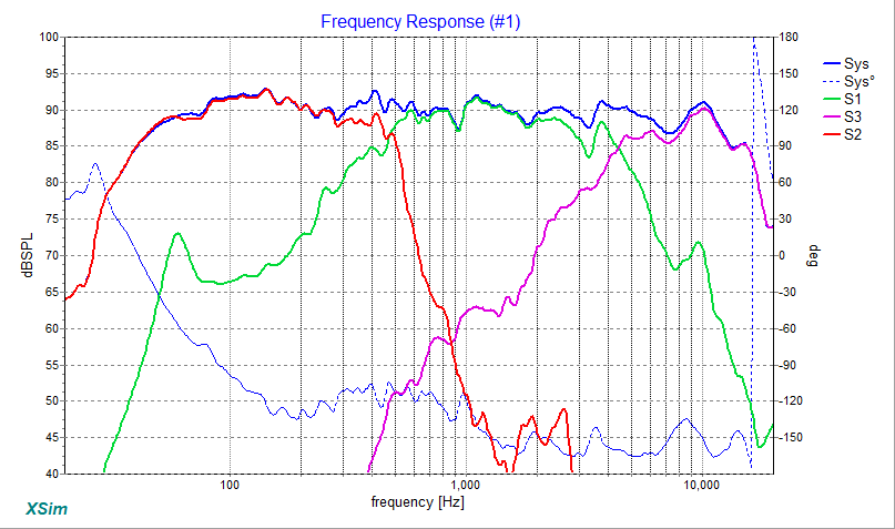

I just had time for a quick measurement. Mic is 0.5m and at mid range axis. 2.0Vrms for equivalent sensitivity at 2.83Vrms and 1m.
With the GRS woofers, the overall sensitivity in the bass at 50Hz is 87dB at 2.83V. This is not bad for HiFi open baffle speaker. The -3dB point is 43Hz and -6dB is 37Hz. The upper bandwidth is reaching 550Hz which is great as that gives me some possible FAST type crossovers. This is all natural fullrange measurement with no EQ or DSP. I think this can be made into a passive crossover quote easily. Notice that the distortion is quite low. Some of the distortion peaks are from other things behind the speaker in the room rattling during the sweep.

Was this with the wings on or off ?I just had time for a quick measurement. Mic is 0.5m and at mid range axis. 2.0Vrms for equivalent sensitivity at 2.83Vrms and 1m.

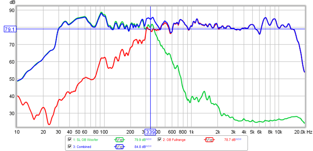

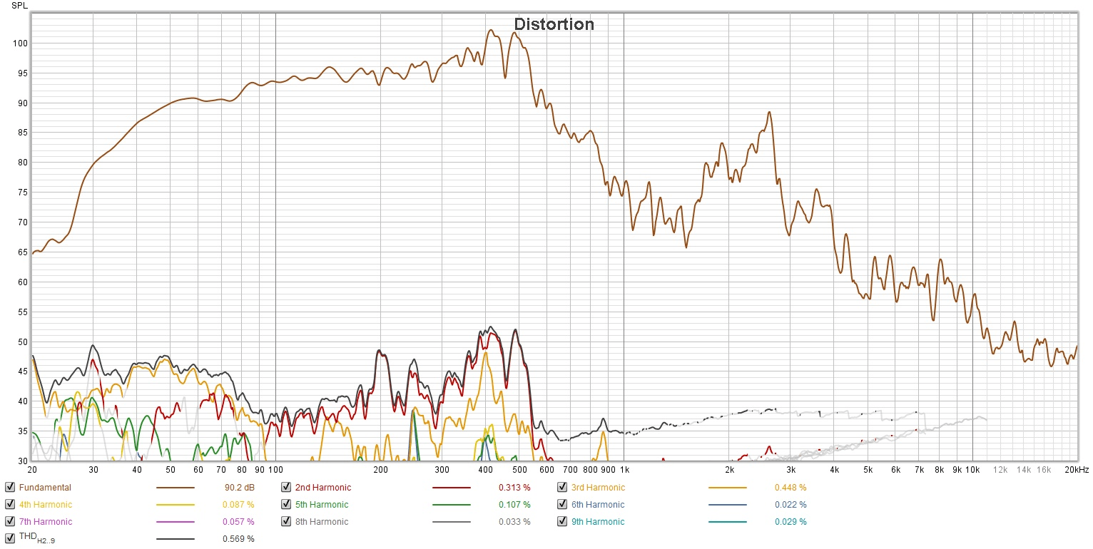

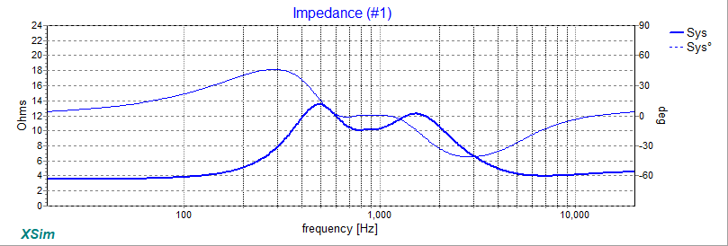

I redid the measurements carefully and found a software checkbox that was clicked and attenuated the signal of the mic. The sensitivity is closer to 89.5dB at 2.83v.

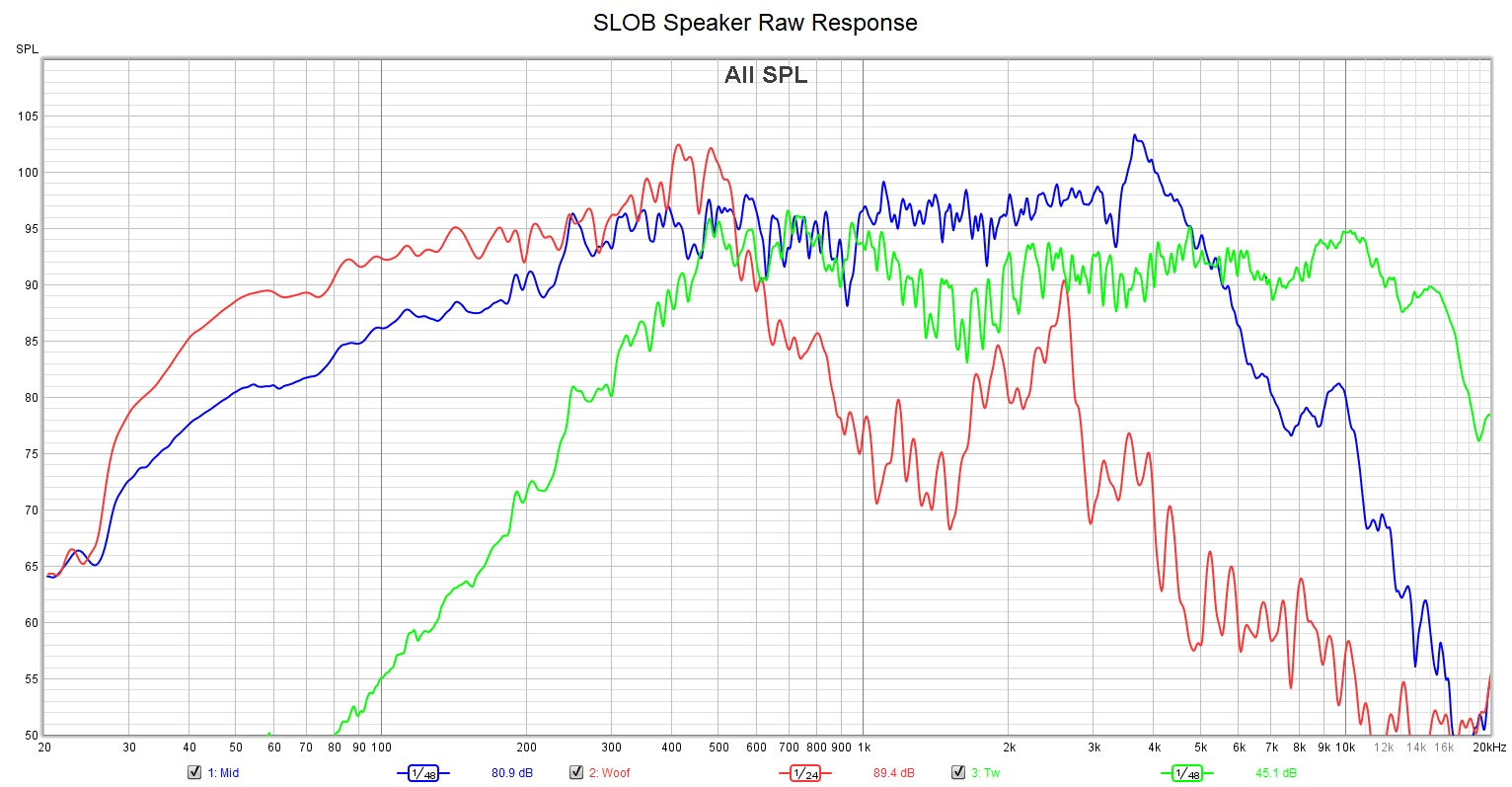

Raw responses of all 3 drivers now measured. It looks like I can put the asymmetric crossovers at 500Hz and 3.7kHz:
There is a strange thing with the absolute SPL displayed on the distortion plot. At lower frequencies, it seems to not agree with the individual plots. That’s why I will go with the more conservative value of the individual SPL plot.
All data is with wings on. With wings off, the baffle width of 12in would predict the bass to start falling off by 600Hz I think. Once I get my crossover simulated, I’ll take the wings off. I don’t intend to operate in that mode so it’s not high on my priority list vs getting a crossover developed.
