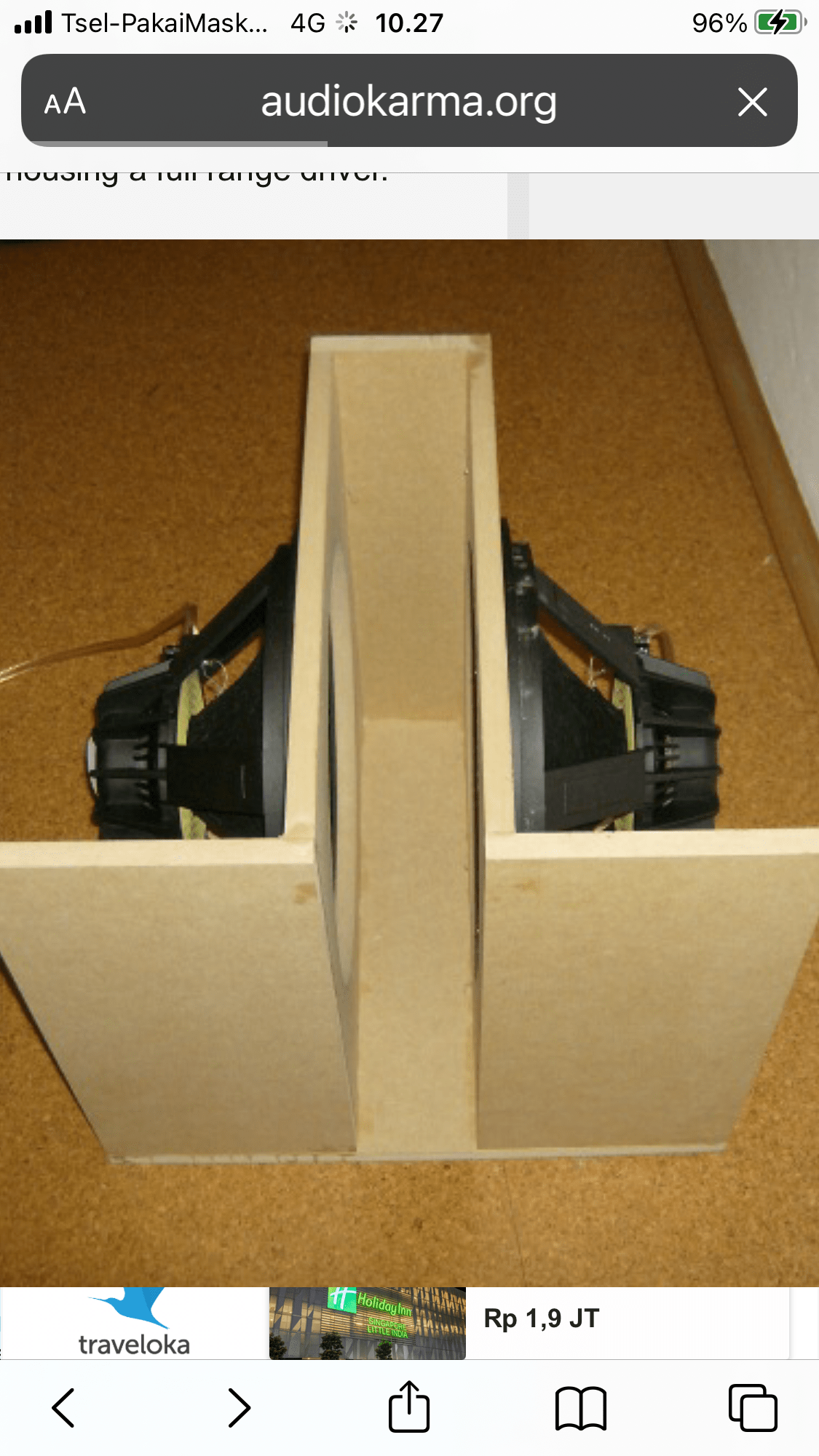

How about getting higher extension from a pair of 12" woofers by mounting them on a small slot with magnets out?
Maybe a pair of GRS 12" on a say 8"x 8" x 4"" front slot with both magnets out.
Usually a 12" might get a 13" deep slot but why bother giving it so much depth when the slot opening is restricted to say 13" x 3" ~ 40sq"
A 8" x 8" square woofer opening x2 is going to unload the woofers output, compared to the slot mouth area.

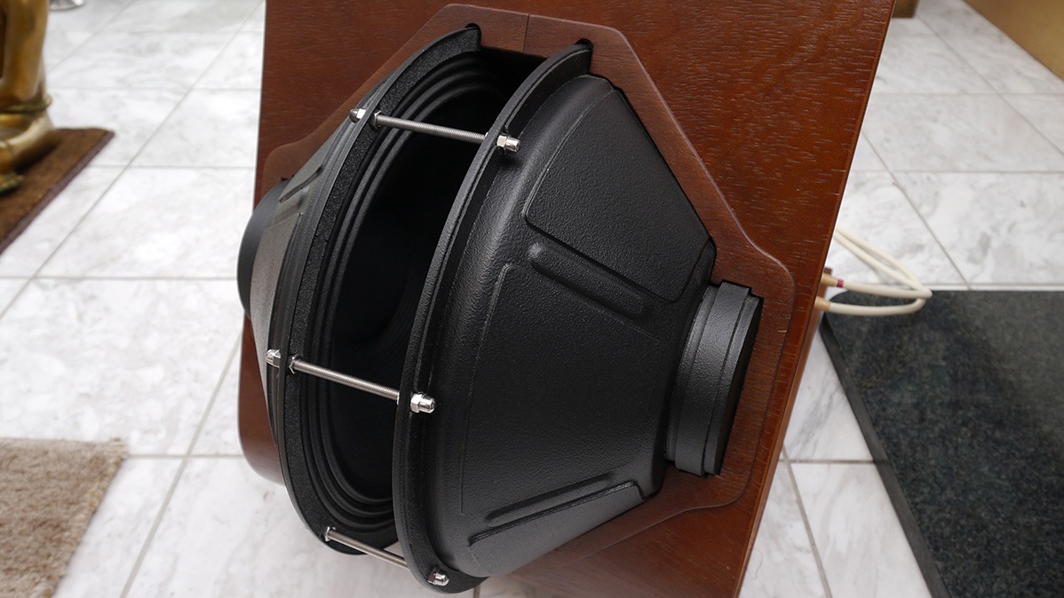

Would an arrangement similar to this with half clam shells shorten the average chamber depth or provide any advantages for larger drivers like bringing their centers further in line with the front baffle ?
ecobox3
I am not sure where the chamber is in this and what the half clamshell does? So volume in between cones comes out the front while volume in clamshells exits the back? This does have a smaller chamber dimension as it’s open at the top and bottom edge - so chamber depth is effectively half or 6in in this case.
YesI am not sure where the chamber is in this and what the half clamshell does? So volume in between cones comes out the front while volume in clamshells exits the back?

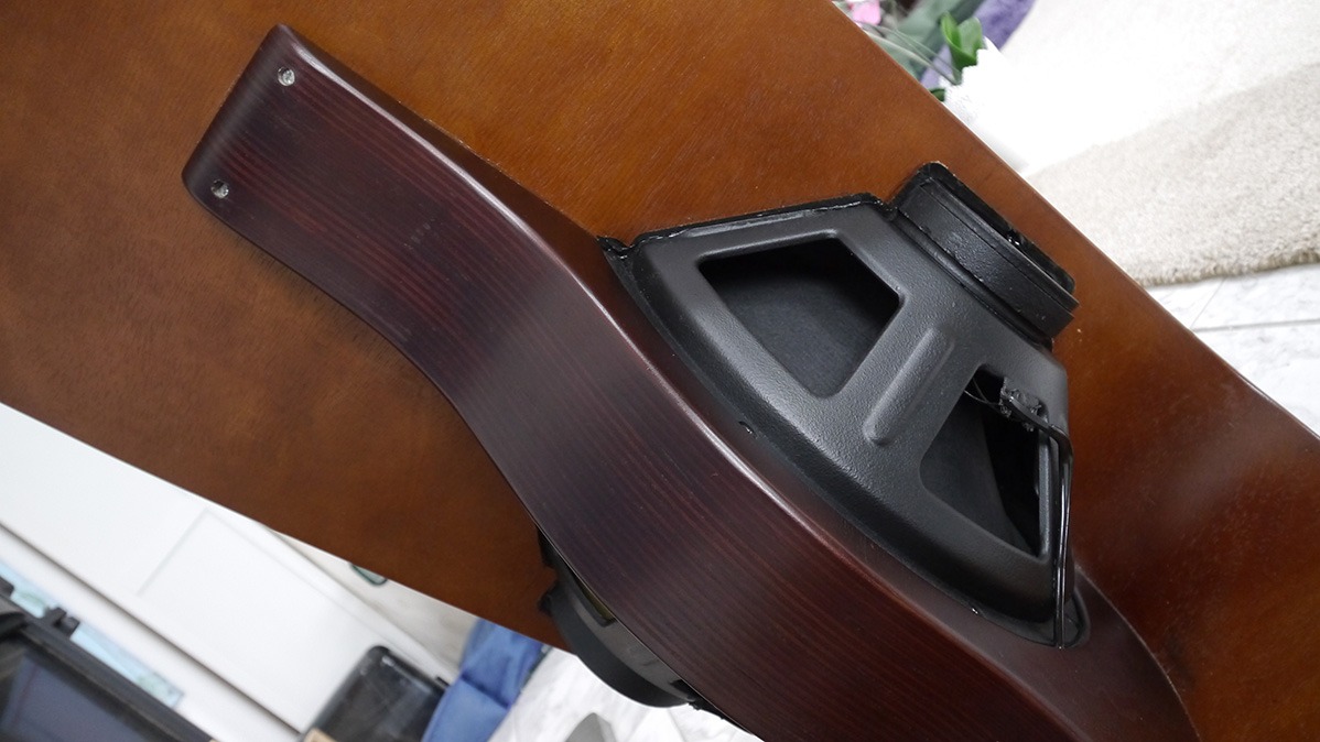

Here is the back. The center slot is a traditional low volume SLOB (but pushed half way forwards).
There is a (assumed) metal shroud (half clam shell or is the part of the actual basket not punched out) on half of the back of the driver on the front of the speaker creating the half-chase that pushes the air behind the speaker. It is easy to overlook on first glance. Notice there are no holes between the magnet and the rim of the driver in front of the speaker like there is in the back of the speaker.
I would assume it resonants and could probably be built differently, while keeping the same small volume in front.
