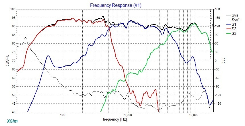

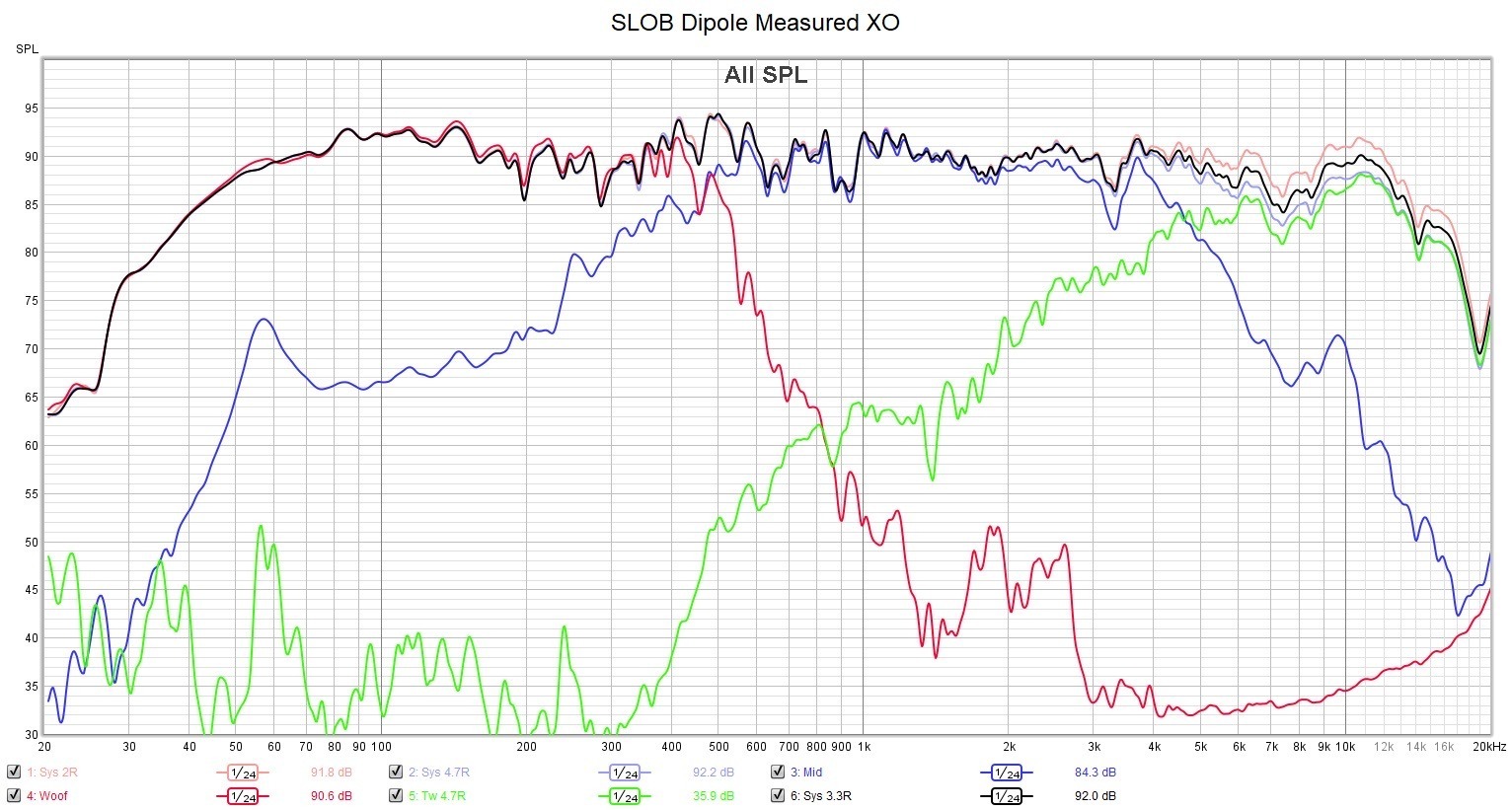

I haven’t used an AE driver before but if you look at the response of the SLOB drivers here, there is no horn coloration. I got rid of the pesky 200Hz distortion peak by adding Noico to the woofer basket. The ones with magnet in the chamber had a ringing mode like a bell. There is some output near 2k but it’s down -40dB. The trick is to put the second order electrical system the same place as the slot first cancellation frequency. That makes 4th order filter with fewer components.

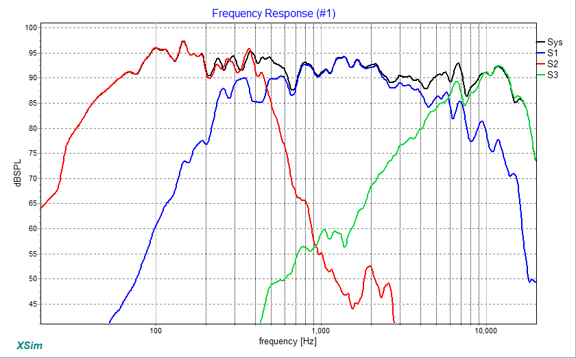

This was first Xo:
Current one is more like this with more midbass:
This was first Xo:

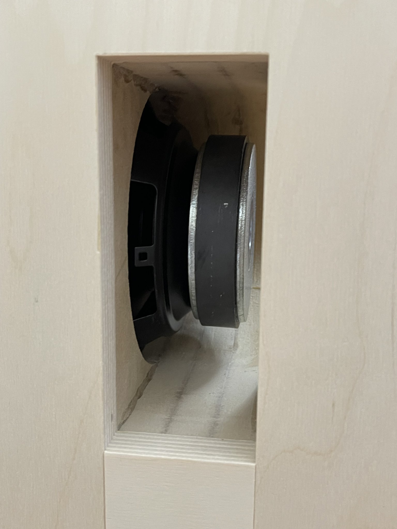

The depth should be as shallow as possible and that is limited by the diameter of the driver surround. I suppose one could make a partial opening from driver cone to chamber (maybe 1/2 of diameter) to reduce chamber depth even more. That creates a different band pass effect like a synergy horn side injection. Then you would want lower Qts more powerful drivers.
The slot cross sectional area needs to be less than combined Sd of the two cones in order to provide loading or resistance. This has effect of controlling cone motion to reduce distortion. So if Sd is 120cm2 for one driver x 2 is 240cm2. Then slot cross section is 240/3 or 80cm2. The slot width needs to be big enough to allow space for magnet to sit inside. 80cm2 would be 2.25in x 5.5in tall. Thats exactly my slot cross sectional area. The slot cross sectional area reduction by 1/3 also has effect of increasing air velocity in front by 3x while air velocity in back is not accelerated and this is what provides the extra dynamic punch asymmetrically to the front with some more directionality. There is about a 2.5dB effective gain in sensitivity vs a plain wide open baffle.

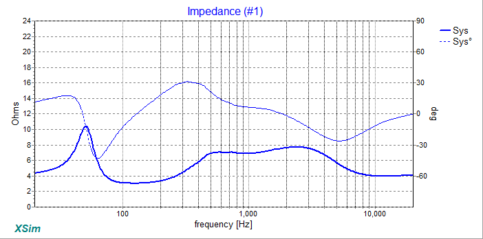

Series parallel eight x 8ohm drivers to 4ohms gives a 12dB boost in sensitivity at the same voltage vs 8ohm single driver. Add 2.5dB gain from slot loading. Take away about 6dB loss from open baffle and we are at a net 8.5dB overall gain from nominal rating of the woofer, or 93.5dB for 85dB nominal. That’s incredibly sensitive and a whole lot of bass for a narrow U baffle dipole.

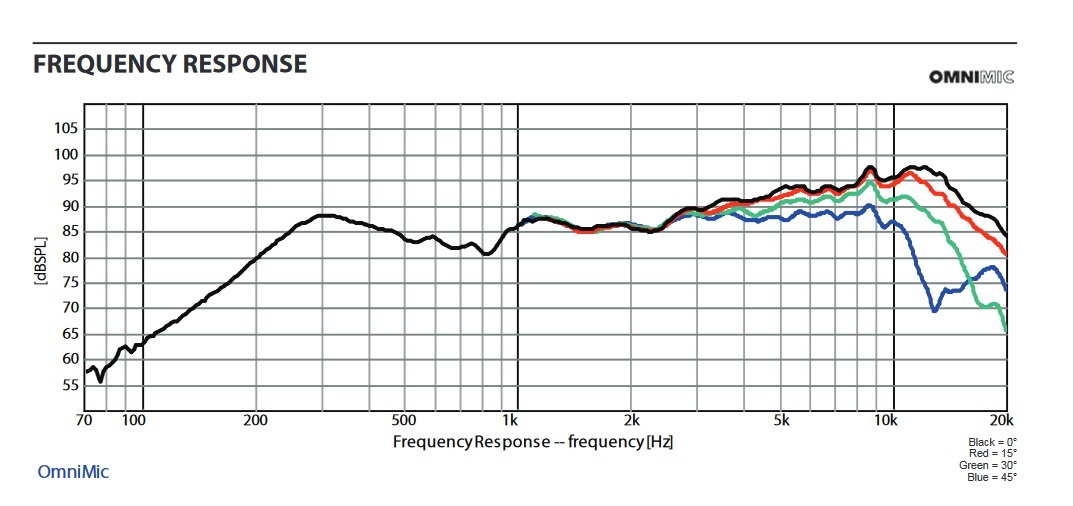

I think GRS 8in is a good idea and I considered using it as well without a mic but sensitivity is only 85dB or less down at 400Hz. Dip at 800Hz to 80dB or so. Maybe a mid is still needed. The SLOB woofers are so sensitive that you need to match it with high sensitivity drivers in mid and tweeter.

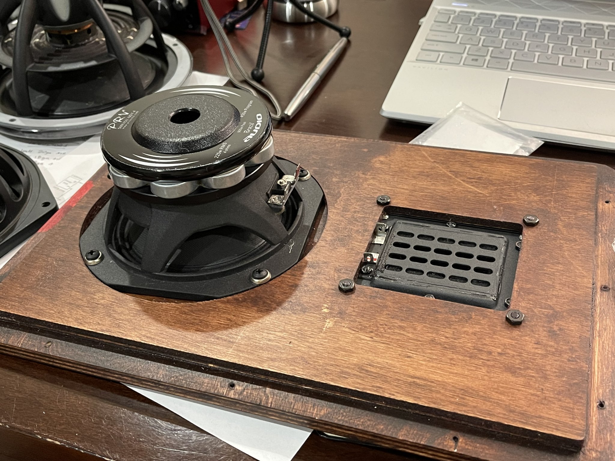

The width of 2.25in was matter of convenience as it was 3 layers of 3/4in thick MDF sandwiched by two layers that provide the mounting panel and covers. Why 3 layers was to make it big enough to fit the driver basket and magnet inside the chamber and be about the correct slot width to give 1/3 Sd of both drivers. The height of the slot was diameter of the cutout hole diameter (~5.5in) for the driver. It just happened to be about right. You can be off a little - it is ok to be a bit larger or smaller. You can also adjust it with an exit aperture cut to exactly the size you want placed on the baffle.
You can clearly see the 3 layers that make up the middle stack for the slot width here. And the height of the slot matches the cutout hole.

Not a good idea to cross it too low, it will distort. I use it only 1kHz and up. Mid definitelly recommended.I think GRS 8in is a good idea and I considered using it as well without a mic but sensitivity is only 85dB or less down at 400Hz. Dip at 800Hz to 80dB or so. Maybe a mid is still needed. The SLOB woofers are so sensitive that you need to match it with high sensitivity drivers in mid and tweeter.

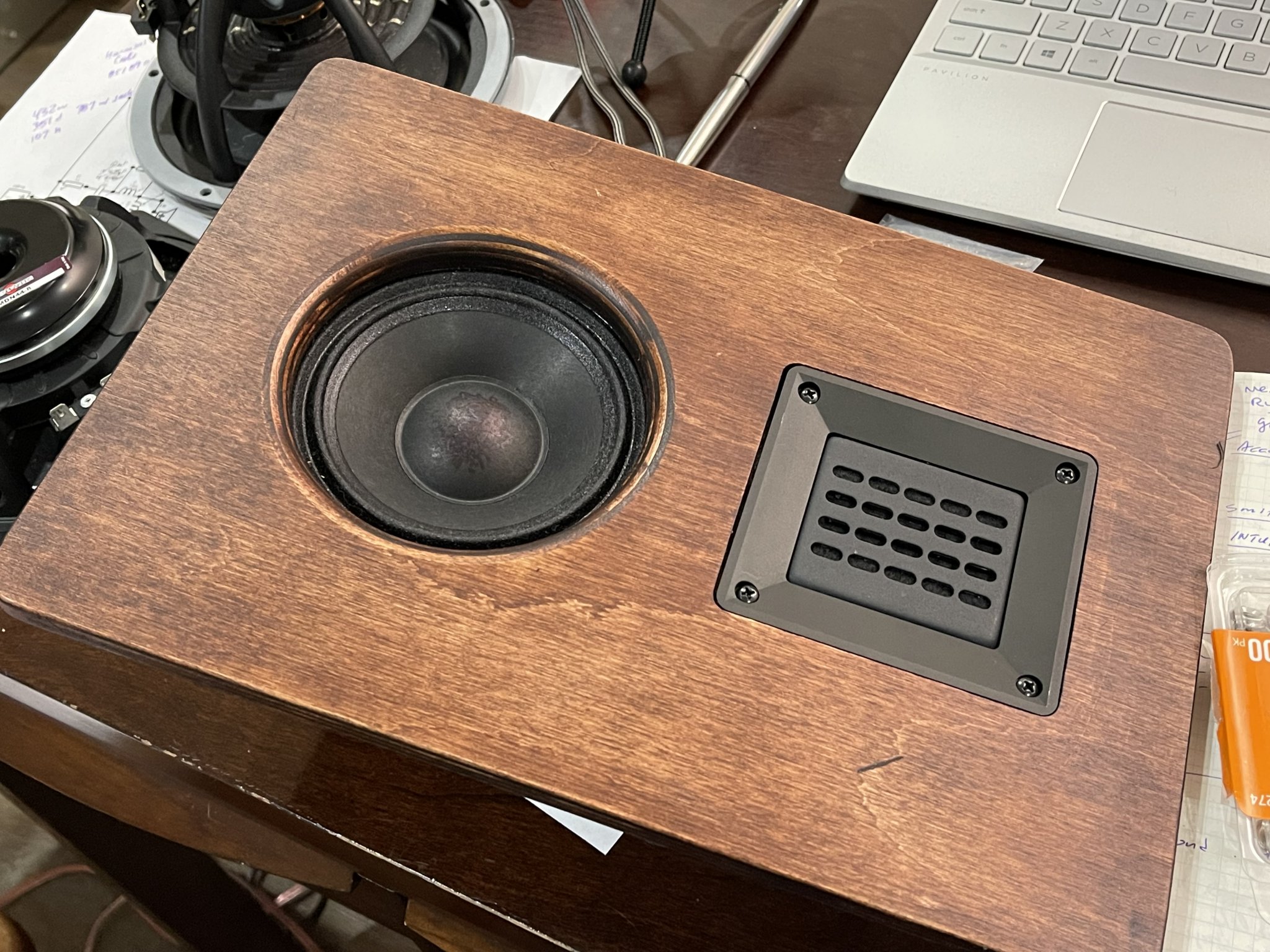

I have been playing around making a brand new XO for the 5MR450NDY. It took a lot rejiggering. Changing the mid is a new XO from scratch unfortunately. The mid is handling the whole decade from 470Hz to 4700Hz for good telephone band coherency. Distortion should be about 20dB lower than 6FE100 at 1kHz.
