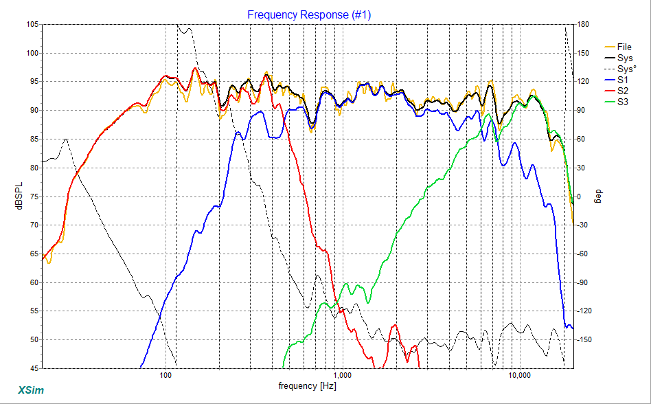

New XO with the 5MR450NDY is sounding great. The distortion went down significantly.
This even sounds great over youtube. That PVR is brilliant. Happy days!

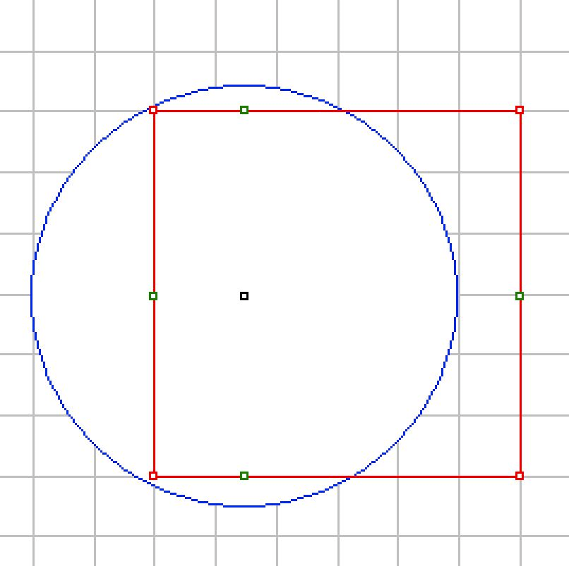

There might be a way to use a smaller slot, to allow higher frequency extension, with a larger woofer:
Red = the slot side profile eg 6" x 6", front to the right
Blue = driver SD eg 7" for a 8" woofer
With this a 8" woofer can be applied to slot of 6" instead of the usual 8" + 1" = 9"
The front slot reduces the output area of a woofer loading the woofer. If the cut-out area above is more then the slot area/2 (for two woofers per slot) it will not additionally load the woofer. The magnets will both need to be out of the slot like the Pass deign. The lateral dimension is the woofer dust cover depth x2 plus slot. So in the x axis, the cone depth x2 + slot width </= slot depth

Exactly. For those wanting to use big woofers in a SLOB withn a cut down slot size, the x-axis woofer dustcover to dustcover separation will quickly become the slot dimension limiter.
Theres a fix for that. Just divide the slot in the centreline along the z-axis. The divider will be equally loaded so could be relatively thin and still be low resonance. Then the x-axis is only half and no longer a limiter.
I am not sure what the orientation of the divider is? It needs to reduce the front to back dimension (back to slot mouth distance). If that is there, it blocks air flow from the back half out to the front. One could put very porous reticulated foam in the chamber to reduce the resonance cutoff.

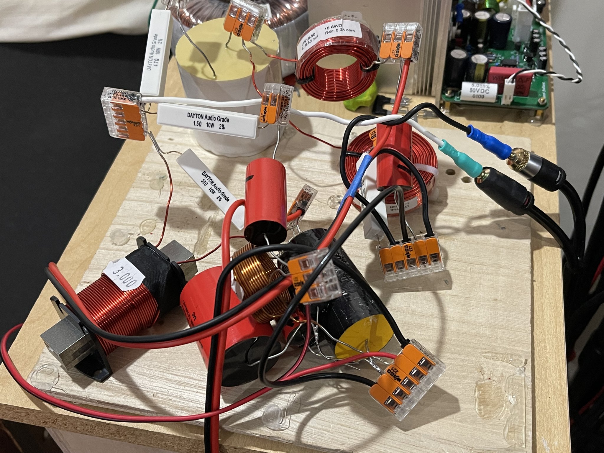

I just built up the XO for the second channel with PRV 5MR450NDY driver. I was lucky I had enough parts in my XO development kit to make a second one. Listening in stereo now. Gorgeous sound. Vocals are super and astonishingly clear. The midrange is the star in this speaker and it helps to use the best one you can find.

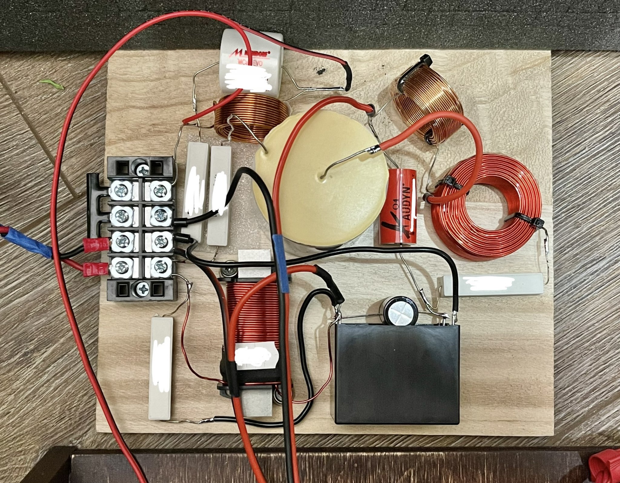

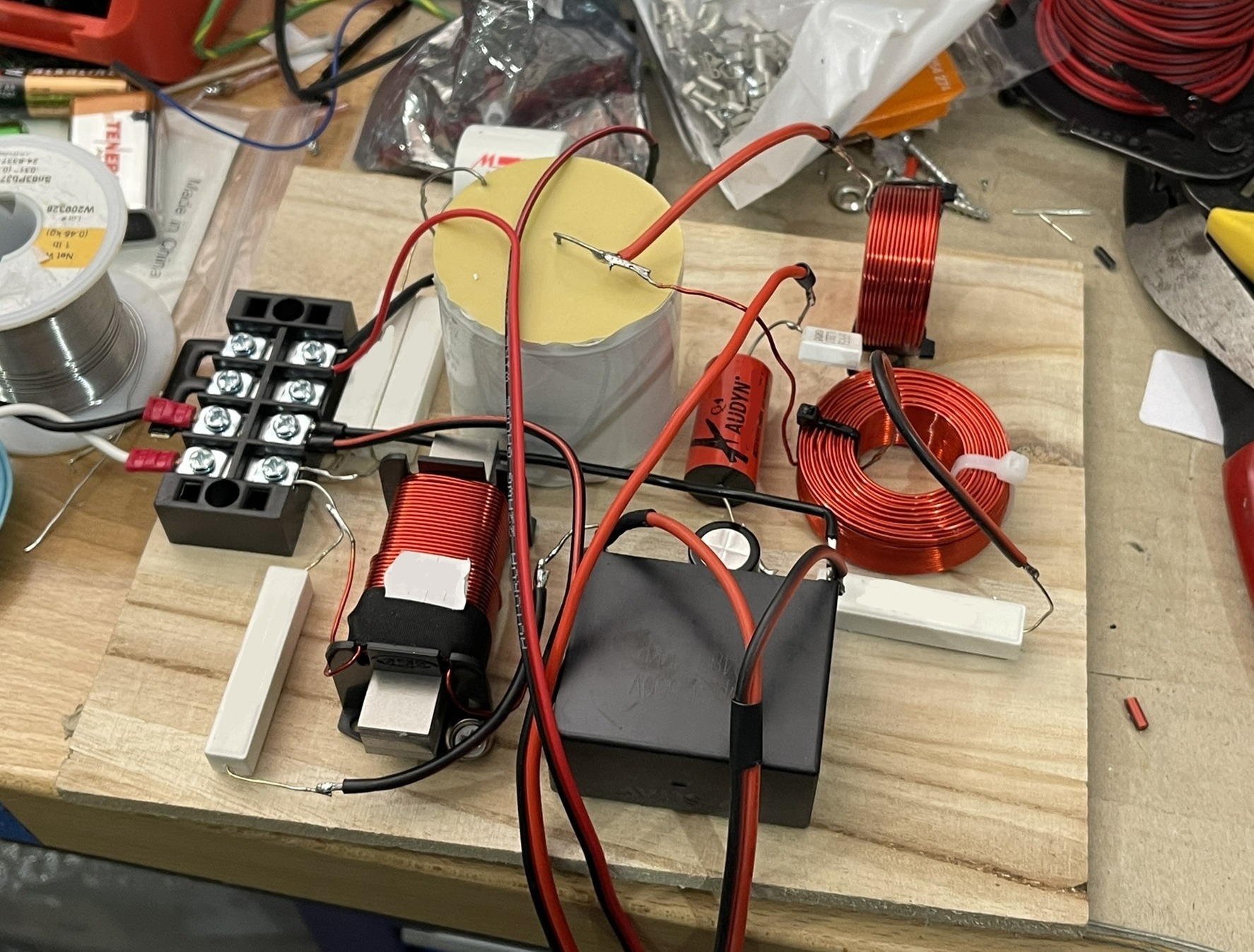

I just soldered up a P2P crossover board for one channel. I think it’s pretty much locked in now. This will let me move the speaker to another room to test it out in a different environment. (Sorry about the redacted values) It may be my imagination, but the soldered joints XO seems to sound better. More clear and a bit louder vs temporary Wago clip connectors. Mundorf EVO aluminum in oil cap for the tweeter. A huge MKP film cap for the mid and combo electrolytic and large MKP box cap for the woofer.
