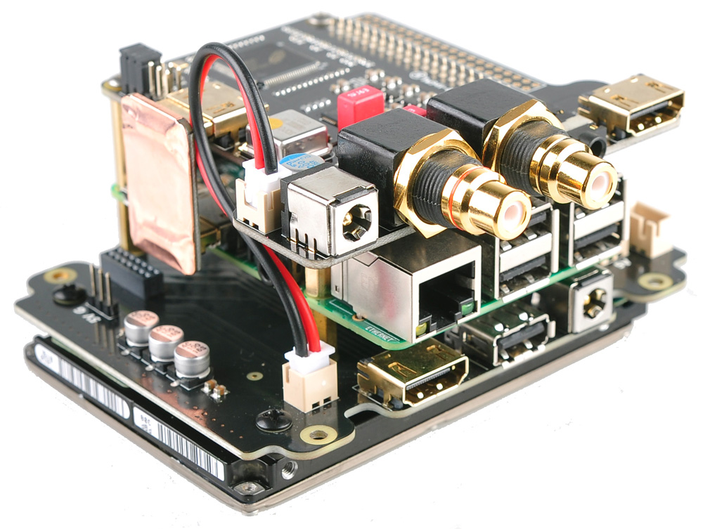

I buy that one because it include a tiny box, hdd connect board, and power:
![X4000-1000p8.jpg](/community/proxy.php?image=http%3A%2F%2Fwww.suptronics.com%2FminiPCkits%2Fimages%25204%2FX4000-1000p8.jpg&hash=37f50cbc3915d1eb7fc9cd90a827198c)

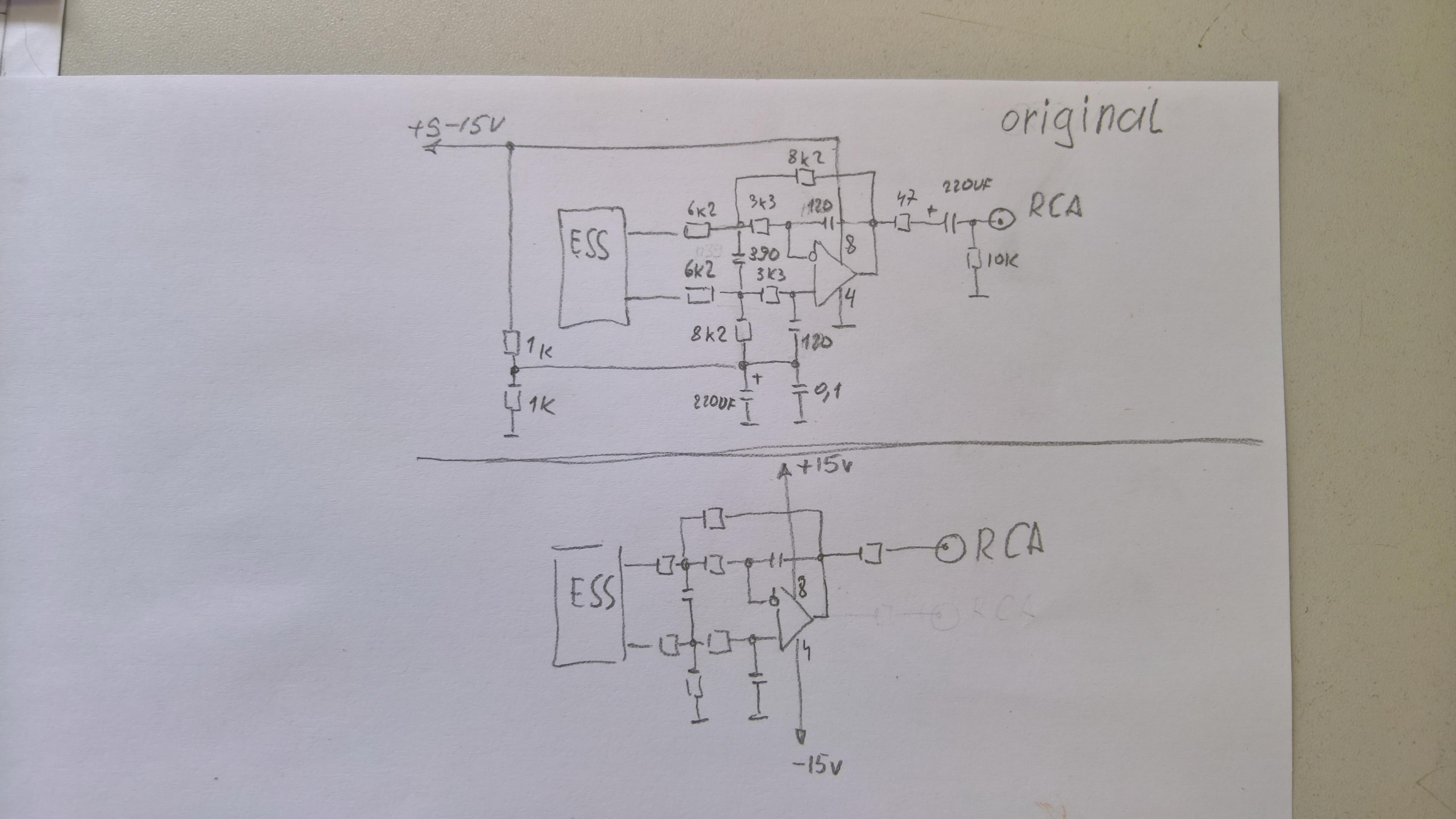

The I/V stage is strange, it forces the DAC into voltage mode and then attenuates the output voltage. It is adapted from an old AD datasheet, and simply jacked by by a factor of 2x-3x on all the resistors.
I traced out the circuit and there is a 6k2/3k3 divider at the input, which then requires the LPF to have gain. This makes the opamp fairly audible, and the output carries its sonic footprint. I believe there is some potential locked away in this part of the circuit, though it would need a significant effort to design a proper I/V stage without documentation.

The I/V stage is strange, it forces the DAC into voltage mode and then attenuates the output voltage. It is adapted from an old AD datasheet, and simply jacked by by a factor of 2x-3x on all the resistors. ~

ES9018K2M/ES9028Q2M use OP to be I/V should be better. Indeed, much ES9018K2M/ES9028Q2M design only use resistance. Why? Reference design uses 500R resistance. I think that is Market segmentation: example, CS4397 & CS43122 have difference reference design.

For IV stage it really confusing.
It current out, add series Resistor it voltage out

Anyway it's a moot point. With the opamp voltage limited to a little below 12V, getting a clean and high quality 2VRMS output from this board is probably not possible without a totally new I/V stage. The default opamp is quite the performer. OPA2134 is is only very slightly better, LME49720 is quite poor in this board because of the low voltage and high source impedance.

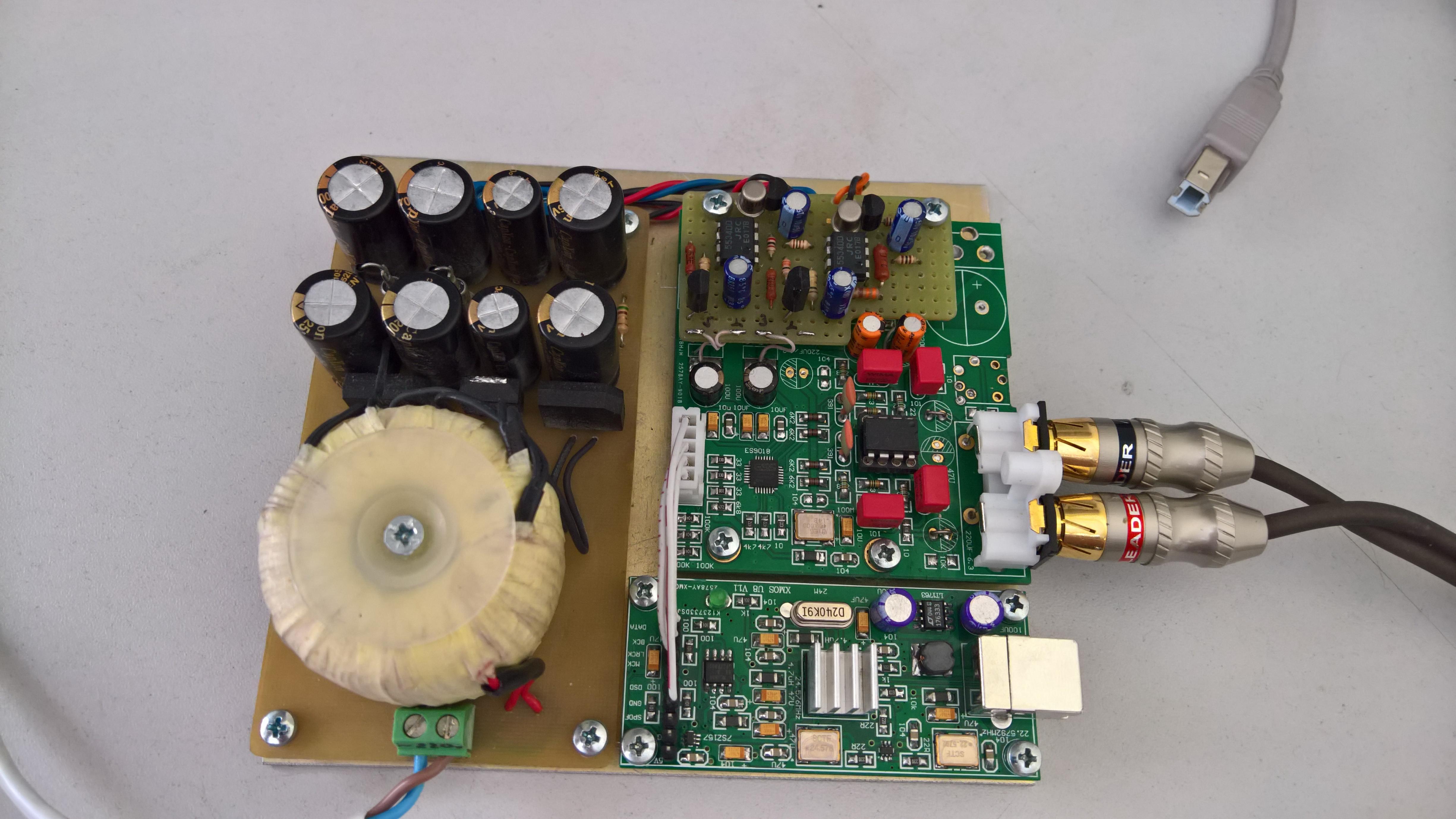

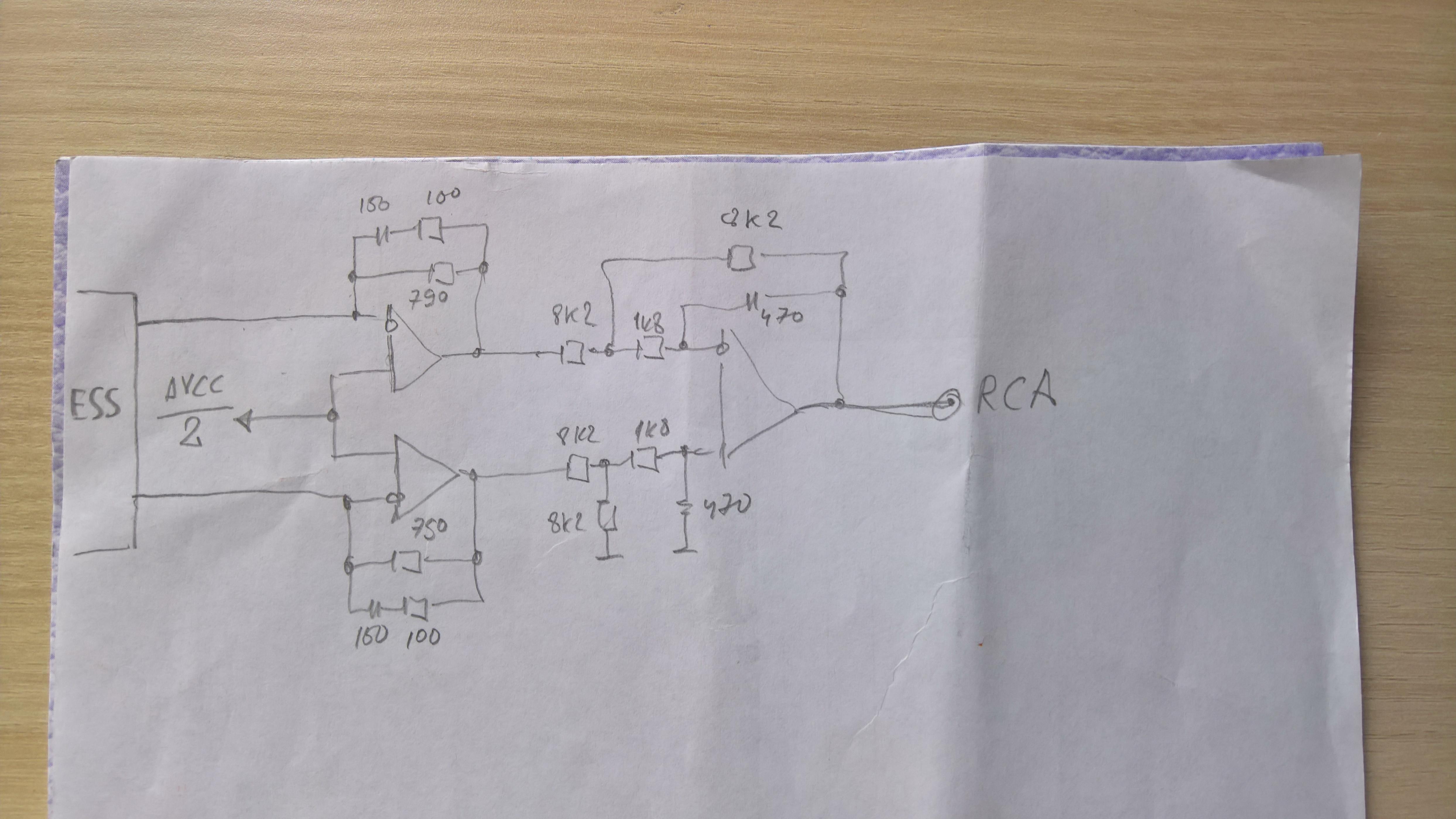

Refined food opa2134 feeds + \ - 15v
schematics ?
Resulting differences ?
Bogi, that's a decent way to do it. You can lose the output cap and the opamp gains a lot of voltage headroom, though with 12V to the opamp (that's 13.5V in) you can already get 6V P-P signal nice and clean with an OPA2134 or similar rail-to-rail opamp.
I would think more of an improvement is still possible by removing the 6k2 resistors and taking those pads to a better I/V. I see that as the major issue, as BJT-based opamps sound like trash in this because of the very high source impedance and a badly designed I/V. For low current output stages like this a discrete I/V at about 6-8mA will fit the bill perfectly.
I wonder if it's worth the cost though. The base unit is already overperforming its price bracket, and with simple higher V+ input and few cap swaps it is at a very competitive level. We compared it to an iRDAC after mods and it was quite a bit ahead.
