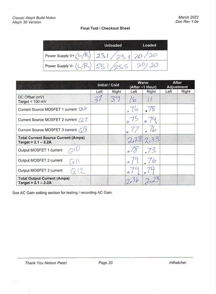

what offset did you land on once everything was to temp? Those matches are pretty good.My first measurements. I attribute the super low DC offset to Randy's exceptional matching skills.

On the above chart. Almost single digits.what offset did you land on once everything was to temp? Those matches are pretty good.
