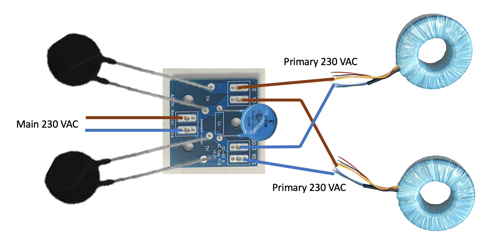

you need thisIs it fine to use this wiring for dual mono application with two 230VAC primary transformers?
Note that in many european countries you do not have polar mains plugs and do not know which one is going to be the live and which one the neutral.
