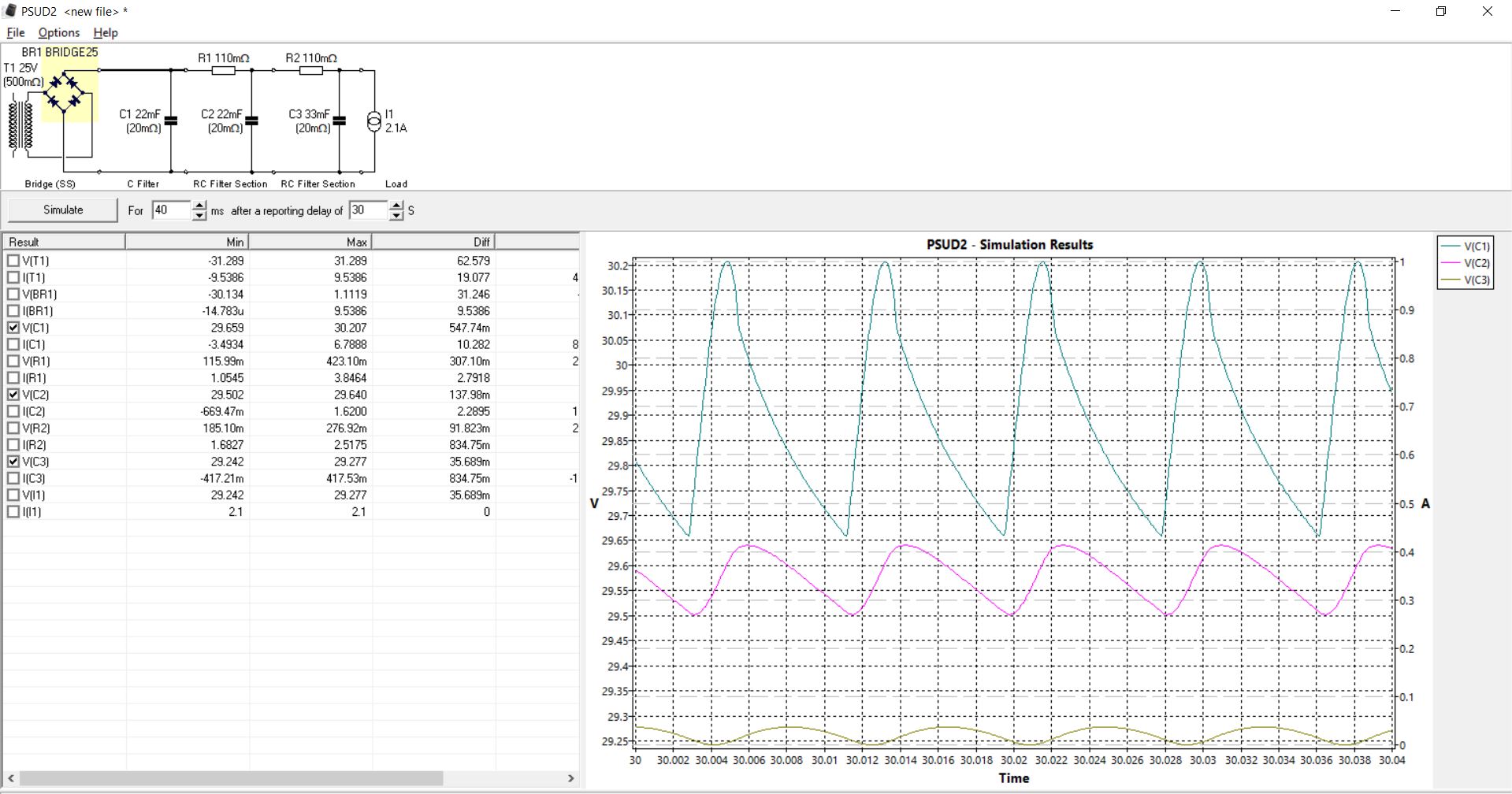

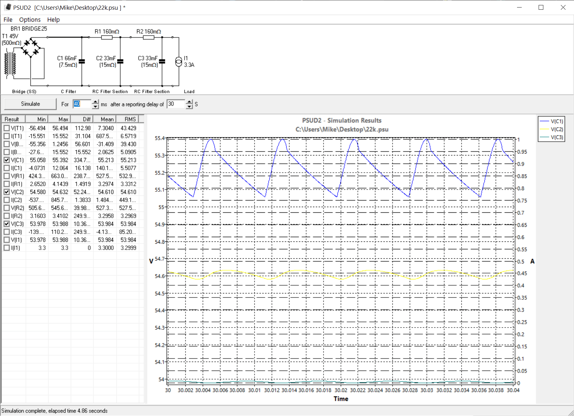

Okay, so I have gone through the build guide for the Aleph 2. I have a few questions for you guys.
First, would it be a bad idea to use 16 IRFP240s per channel rather than the 12 and bias each device a little lower? Or would this take some of the magic away from the sound? The thought is maybe lower distortion, and better at driving 4 and 2-ohm loads. Maybe a little extra emphasis on the bottom.
Second, stepping up to a 800va transformer seems reasonable. How about a 1000va? The cost jump isn't significant. Do you think I will notice a difference in sound?
Third, caps suggested are 22000uf. Would it be a bad idea to go with 33000uf x8 or does the CRCRC pretty much cut the ripple down so much it won't make a difference?
Also, since we are dealing with a purely class A amplifier, I assume the bass won't be improved from these power supply changes. But tell me if I am wrong.
Thanks!

1000va - go for it.
22 crcrc vs 33kuf 8 pack crc, model in Duncan power supply designer. Or if you’re talking 22 vs 33 crcrc of course 33 will be lower ripple. But the extra RC makes a nice difference. Run the sim and see if it’s worth the extra money to you. Then decide
16 MOSFETs instead of 12, it’s possible but you’ll potentially need to tune the source and output resistor values. There’s an Aleph spreadsheet floating around out there that could help. Feel like experimenting? On the other hand, you can say “ain’t broke, don’t fix it”. I can’t say how the additional MOSFETs will impact the sound.

That is what I was thinking. If the difference is minute or worthwhile. I haven't tried LT spice yet but this would be a nice simple thing to try. I will give it a shot.of course 33 will be lower ripple. But the extra RC makes a nice difference. Run the sim and see if it’s worth the extra money to you. Then decide
PSUD sounds familiar but something else I haven't tried. I will try that first. I opened LT spice and started playing with it just a little bit and can already tell there is a learning curve. I found some tutorials which I will go through.
Is this it the PSUD you are mentioning:
https://www.duncanamps.com/psud2/

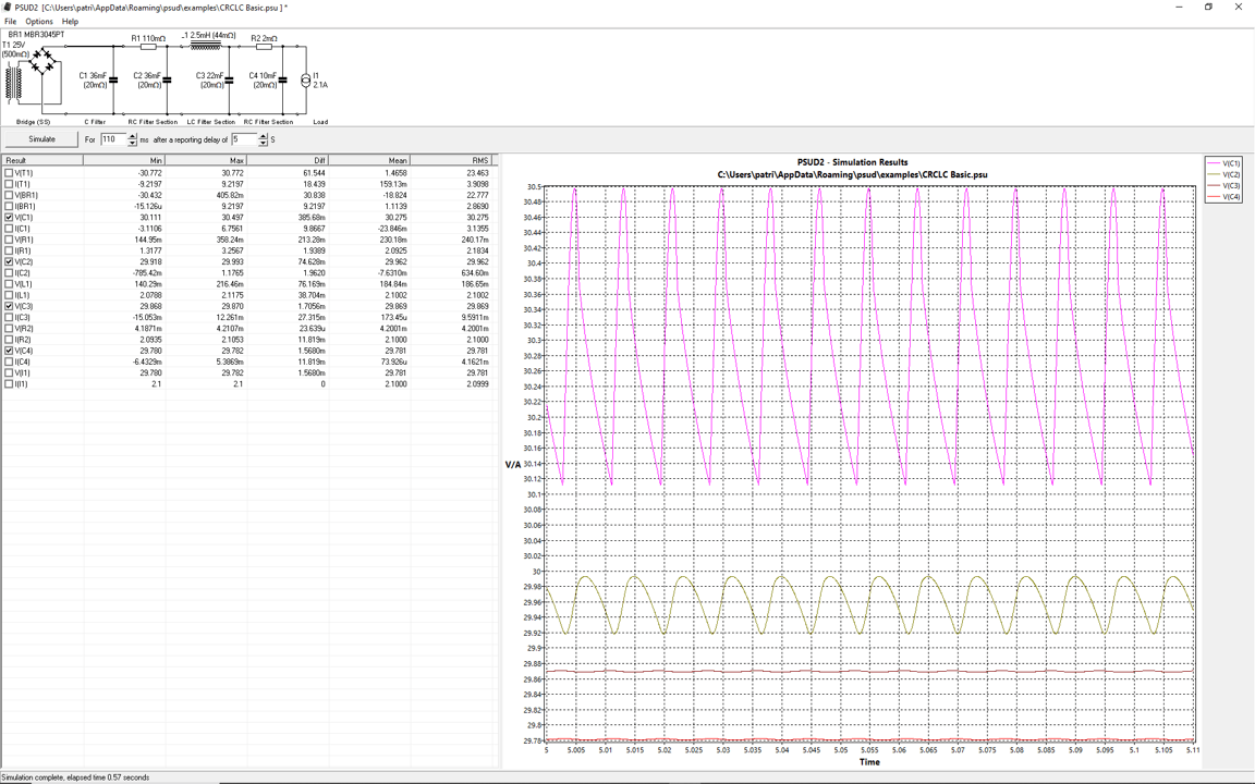

I'm still noodling the PSUs for my builds. I may combine a few efforts/projects and make the transition to separate PSUs for my new Alephs (TBD which ones I will build).
I STILL have not gotten around to incorporating the Hammond 159ZLs commonly used around the forums into my PSUs. I have some ... somewhere. I have also seen the recommendation to have at least one cap bank close the amp boards, along with using "motor run" caps in that position...
Onto the actual question...
I don't want to get rid of my old FW PSUs. I may run lower 24V (ish) rails on the new Alephs, but I can sneak a bit higher with the 35V caps if needed. Trying not to get over 30V at the first cap bank. I can also build new PSUs as needed, but repurposing is fun.
IF I were to take an existing "FW" style CRC and add the Hammonds into the new "PSU" chassis along with some "motor run caps" in the ballpark of 10mF (in the amplifier chassis close to the boards) would it look something like this?
Existing PSU filter ... 36mF => 0R11 => 36mF
New PSU filter ... 36mF => 0R11 => 36mF => 2.5H => small R for umbilical / other amp wiring => 10mF
Sim attached. Looks like a solid performer at the expense of a 'little' voltage. Am I close? Any drawbacks or considerations? I gotta be missing something.

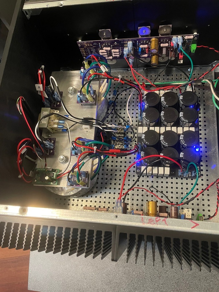

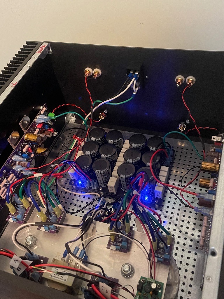

As you might have noticed in the photo. I've switched back to the standard bridges to address a performance issue. That aside, upon my initial startup all my measured values to date are so close to perfect (Thanks to Randy) I think I'll skip the AC gain for now and go into service this weekend. Can't wait!
Dan
Dan

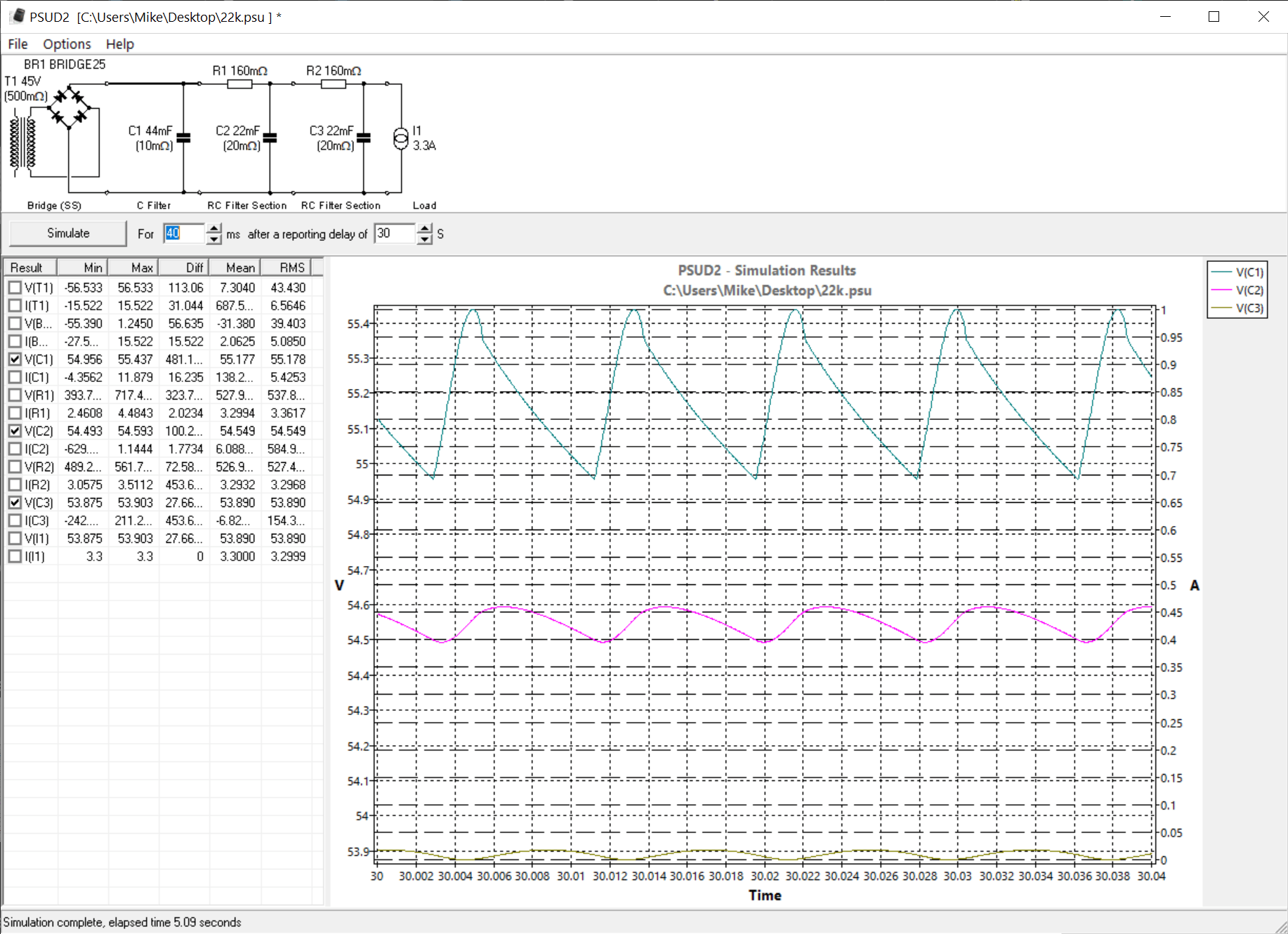

That PSUD program is really neat. I just doubled the capacitance for the first stage since the board is CCRCRC. I put the transformer at 45 volts accidently thinking that I was inputting the rail voltage but for all intents and purposes it gives results. 22000 seems to get a pretty small ripple coming out of C3. I adjusted it for 35v transformer and got 27mv coming out of C3. 33000 gives 10.143mv.
Here are some of screen shots:
22000uf caps
33000uf caps
22000uf caps
33000uf caps
