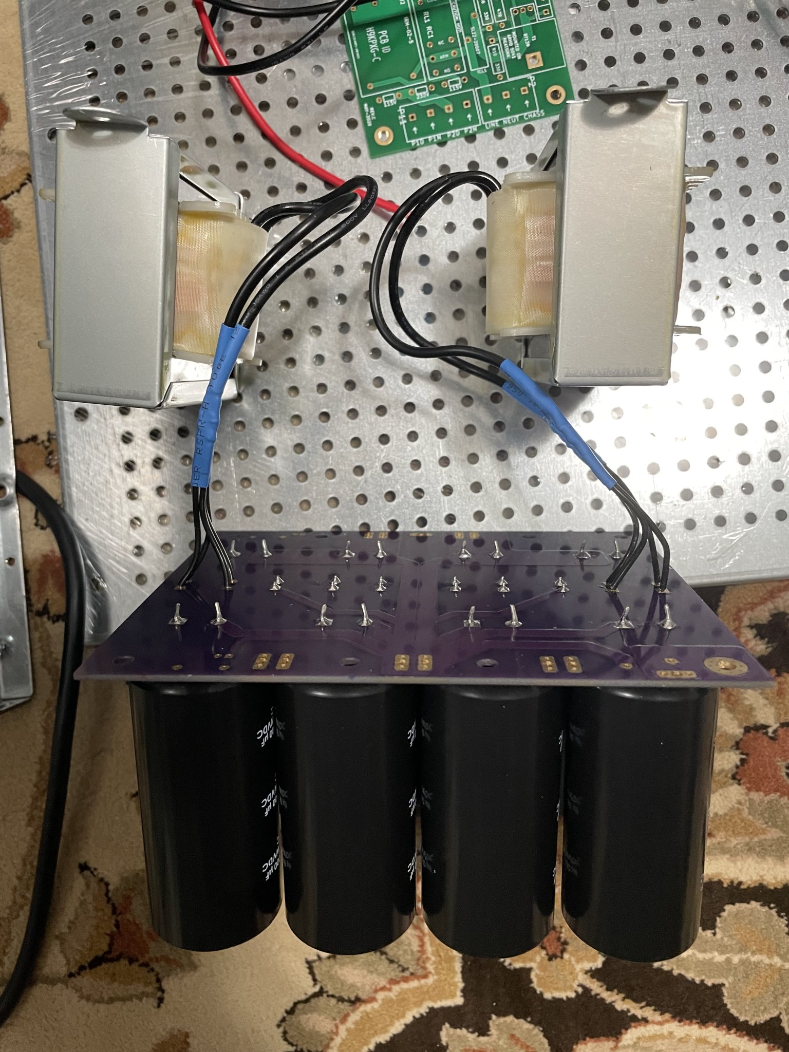

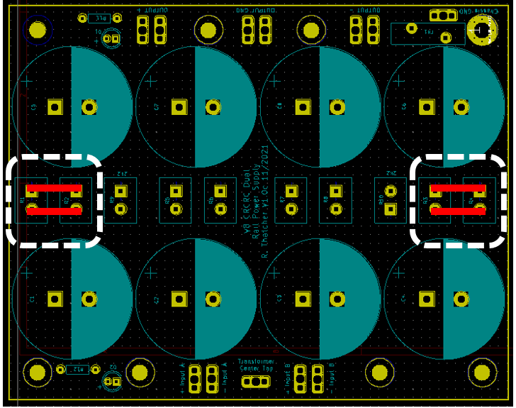

1: Do you have any other pictures of how you incorporated the Hammond chokes into the V8 boards? Looking at the schematics and applying my limited knowledge my best guess is you just leave R1, R2, R3, and R4 unpopulated and then wire the Hammonds across R1 and R3? I have read more than once ZM wax poetic about the use of chokes vs R and this seems like a very slick way to incorporate them into Randy's boards. And sense I haven't put anything into a chassis yet pretty easy to adapt into my builds.

Chokes - take a wire and bend it into a U shape to create a loop. Connect the holes of R1&R2 and R3&R4. Connect the choke wires to those U / Loops. The red lines are the loops you'll create. Top side or bottom side, up to you. Use the thicker gauge scrap wire from 3W resistors that are coming off the main aleph boards or other wire that fits in the holes.

1. You are correct re: wiring. Pic attached of my first effort. The choke wires are a much larger diameter than the holes. So, I thought I would be clever and split them into two pieces attached to some 18AWG solid core which fit perfectly into the PCBs. I'd strongly advise against the way I first did it... The chokes are heavy, and I'm ham-fisted. The solid core snapped twice after repeated strain as I was monkeying around with layouts. So... I took everything apart and redid it using some really flexible multi-strand. Worked like a champ. With that said... I know for a fact that others (with far more knowledge and talent) have better attachment methods; drilling out the PCB, and/or bundling the choke wires and 'necking them down' to fit into the smaller holes. Also... while I would never commit someone else's time... Randy is a pretty darn nice guy, if you asked... he may have a way to mod the boards to make it easier to use chokes. What I don't know is how to measure (properly) if the connections are proper. I'm 99% sure that they are. Measuring a 0R16 resistance with my DMM is sketchy at best, and the circuit "works" without them in place. It seems to measure well from a noise standpoint. So, I consider it good. If you know of a tip re: how to measure that they're actually wired properly, I'd love to know. Can inductance be measured in situ? Maybe some reading for me.

Edited to add - See Randy simul posted with an answer re: how better to do it.

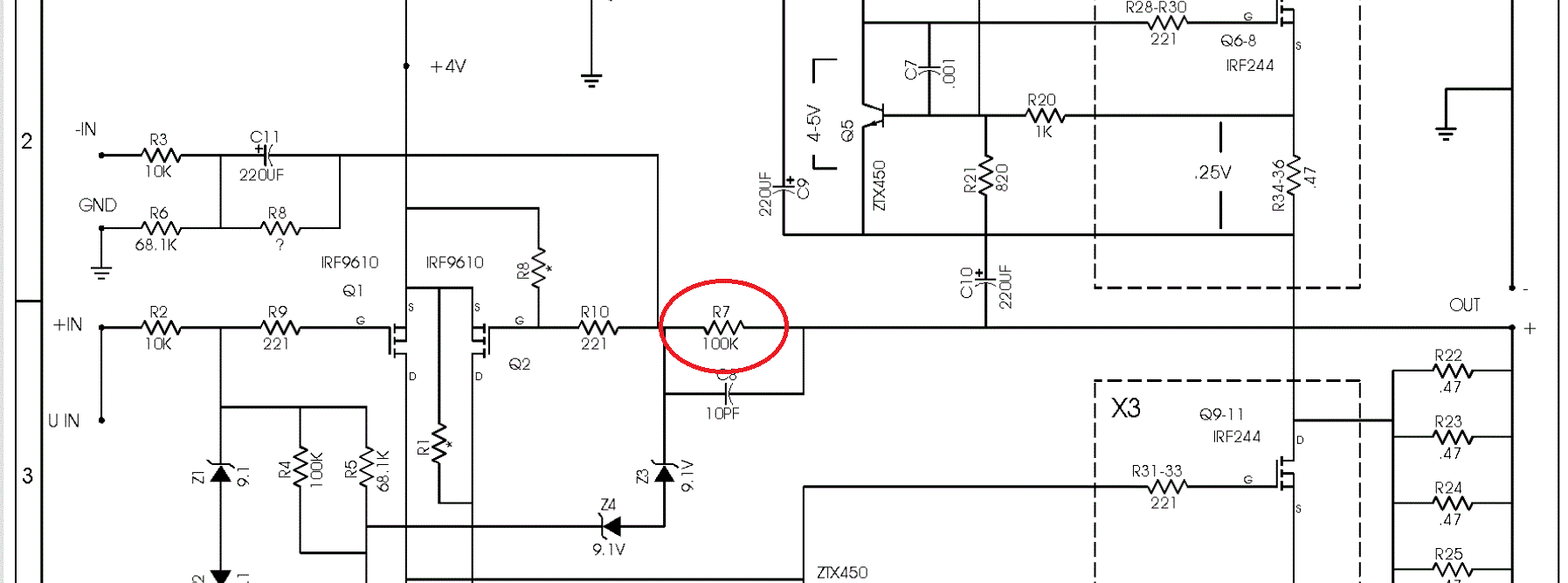

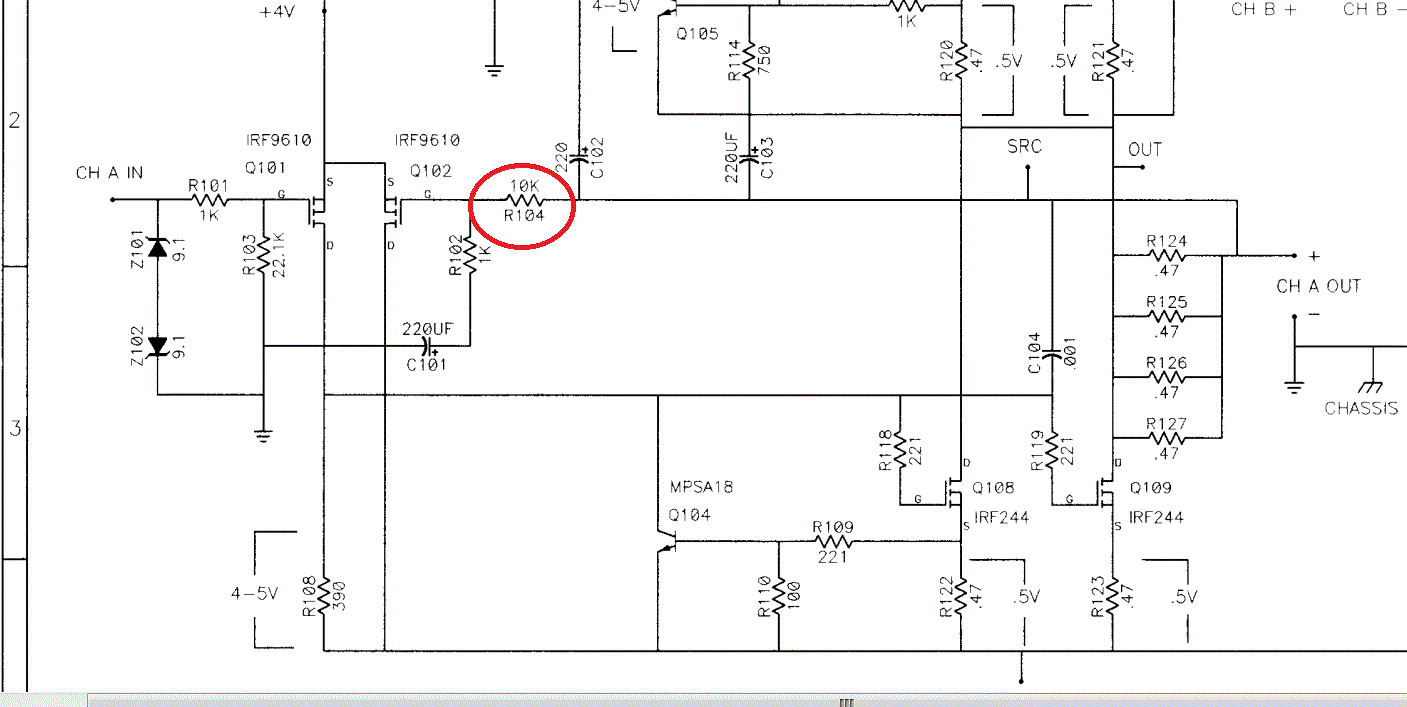

A few question arose while I was comparing the input stages of the different (2, 3, 4, 5, 30 and 60) models of Aleph amplifiers. I have attached the relevant parts of the Aleph 3 and Aleph 30 schematics (copied from the service manuals).
I have read the manuals and think I understand the changes in the (input network) resistor values, additional 10pF capacitor parallel to (what I presume is the feedback) resistor, but why is the feedback resistor (marked with a red circle) 100k in all models except the Aleph 3 (where it is 10k)?

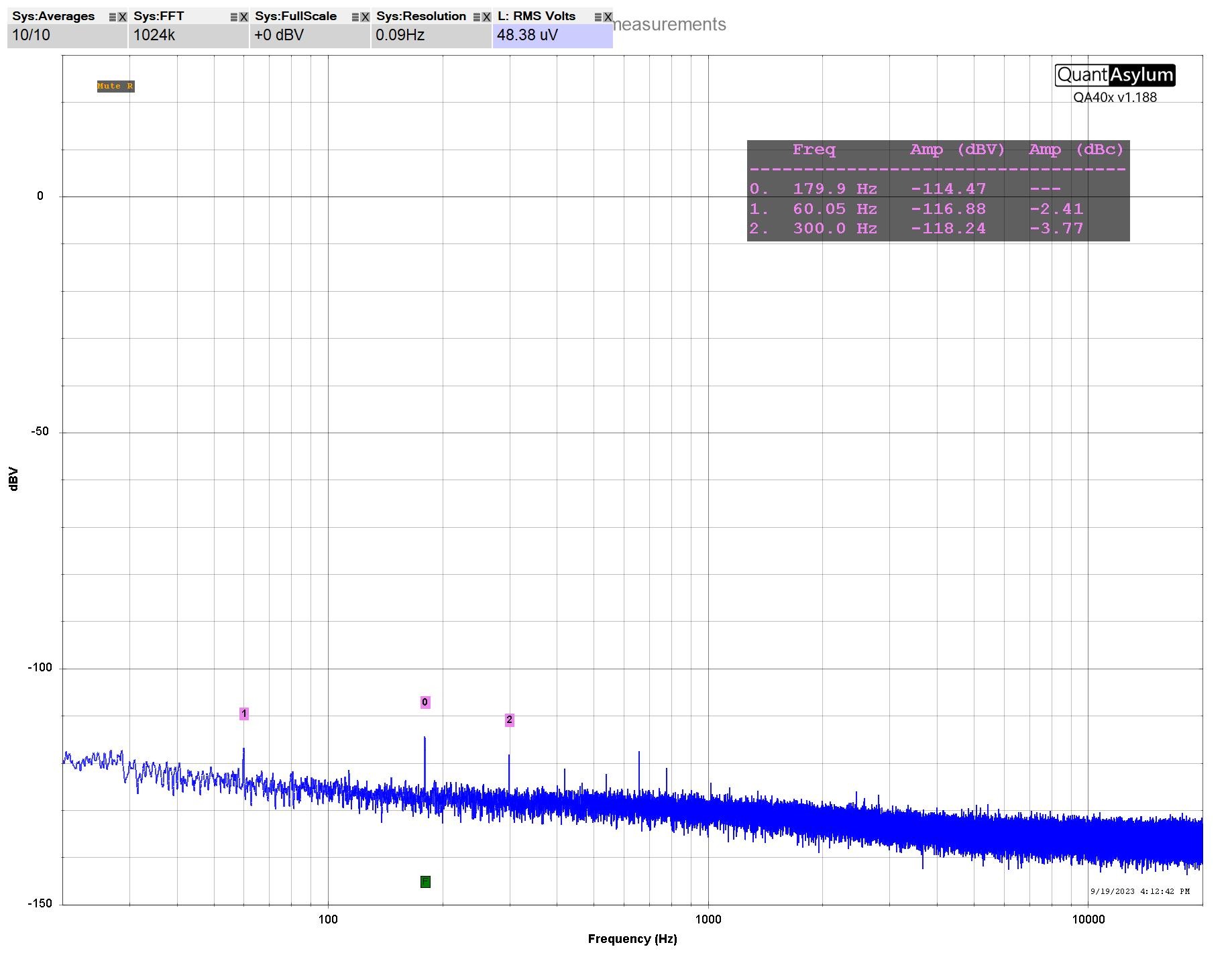

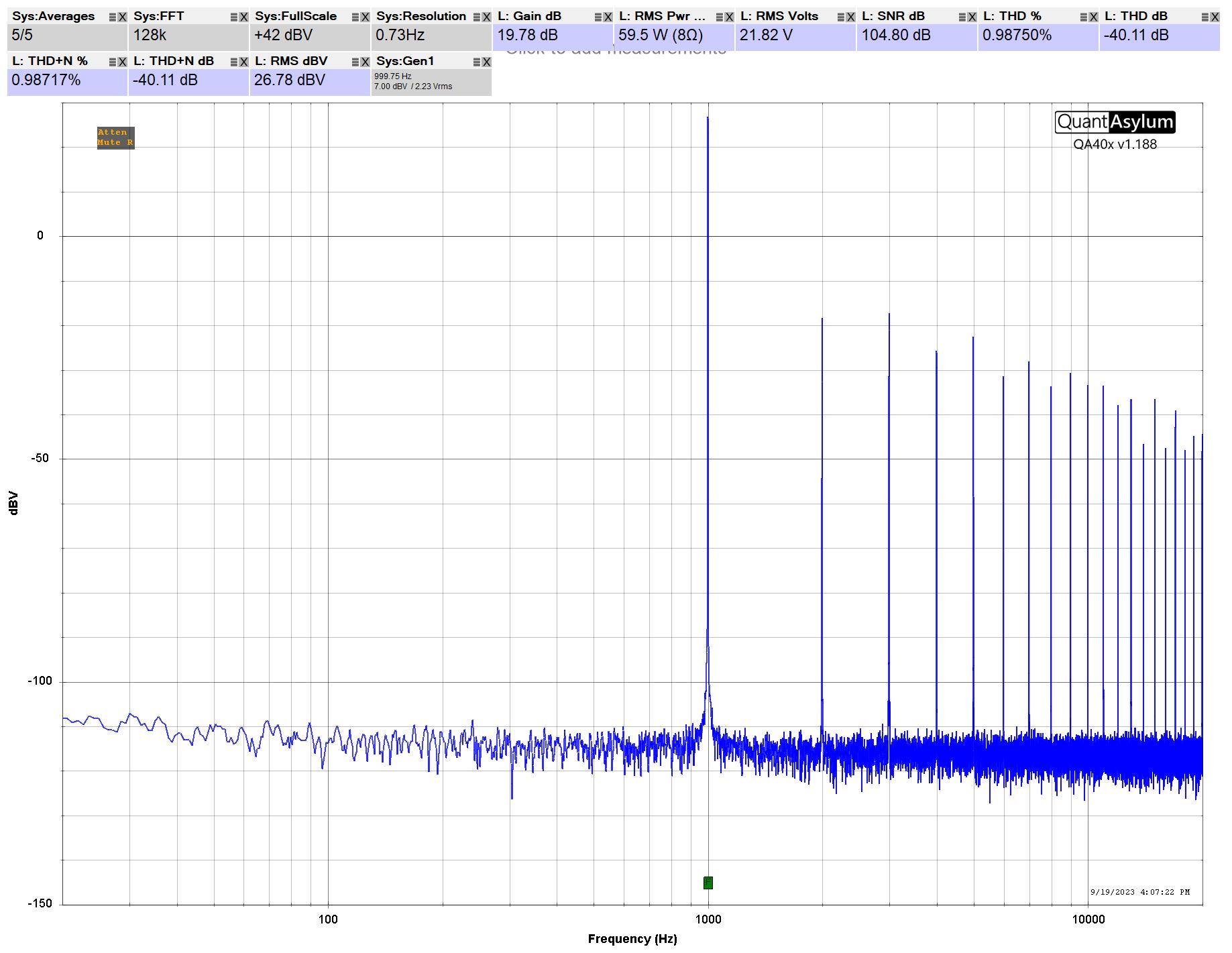

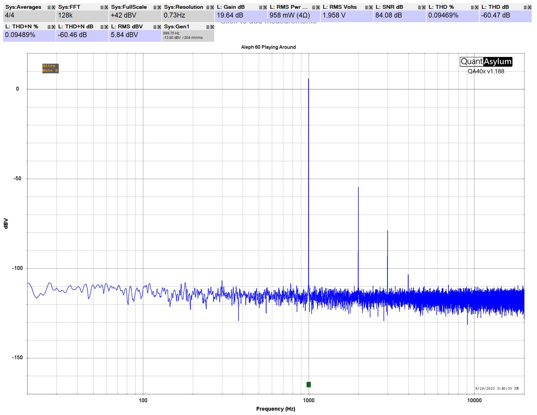

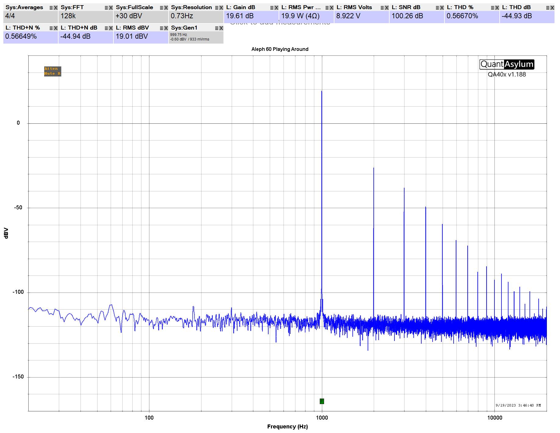

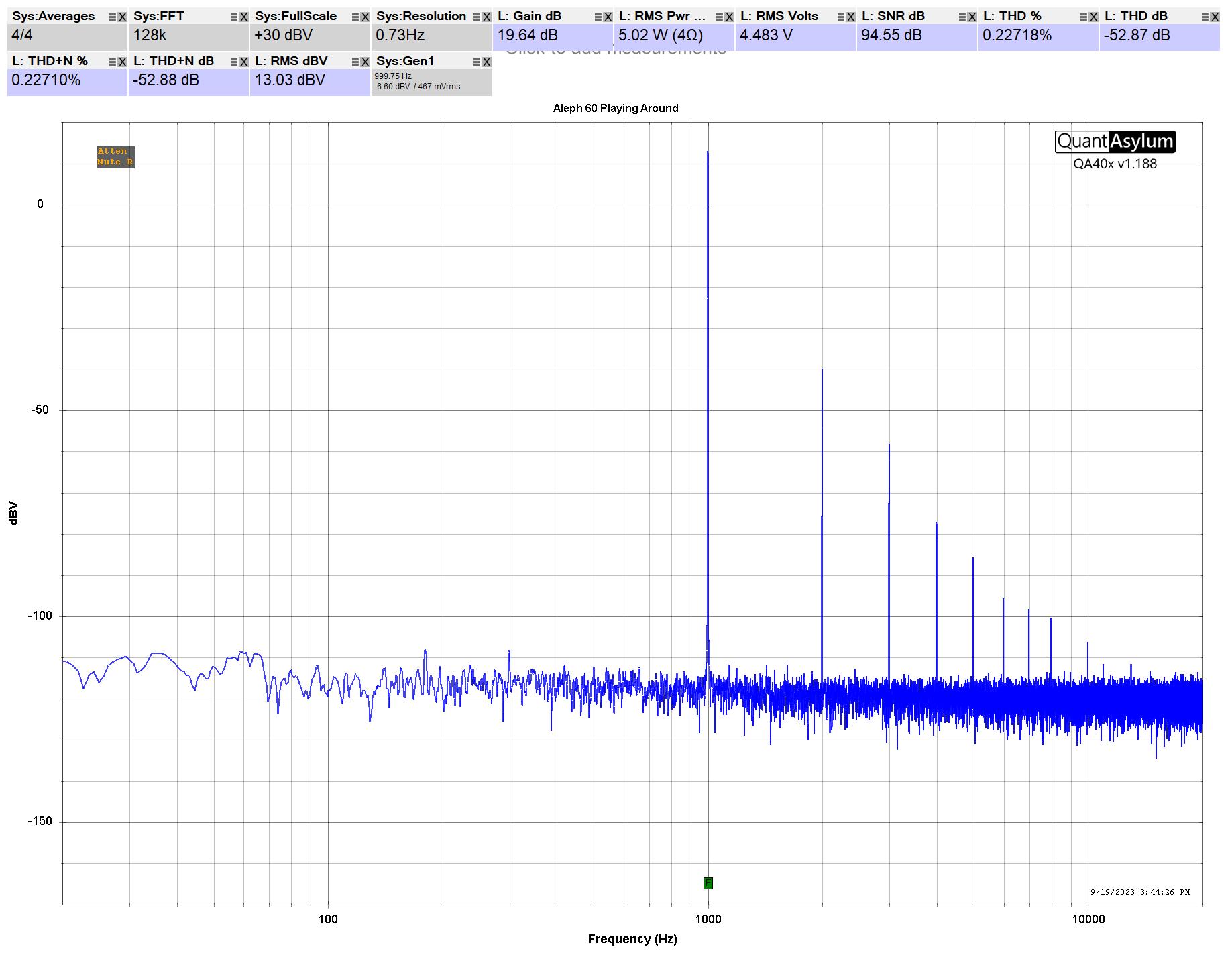

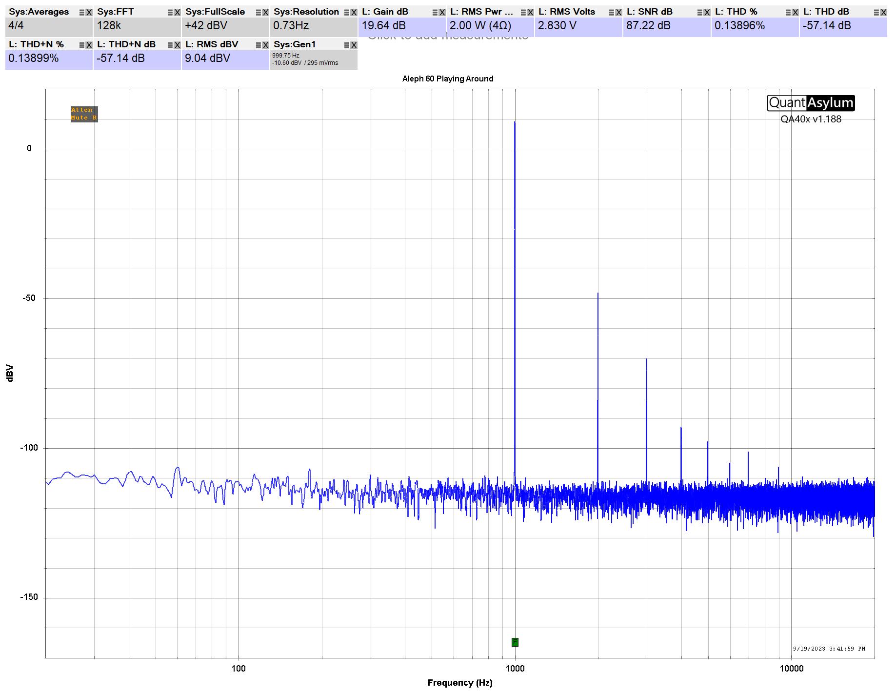

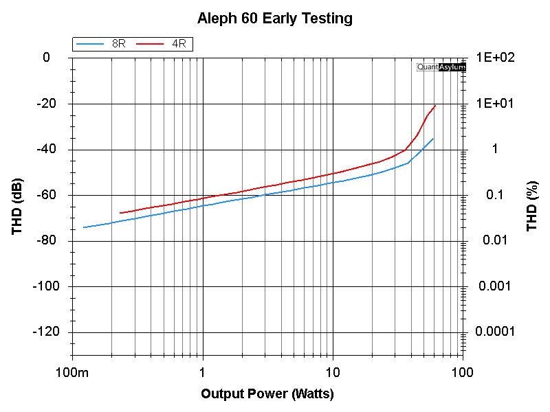

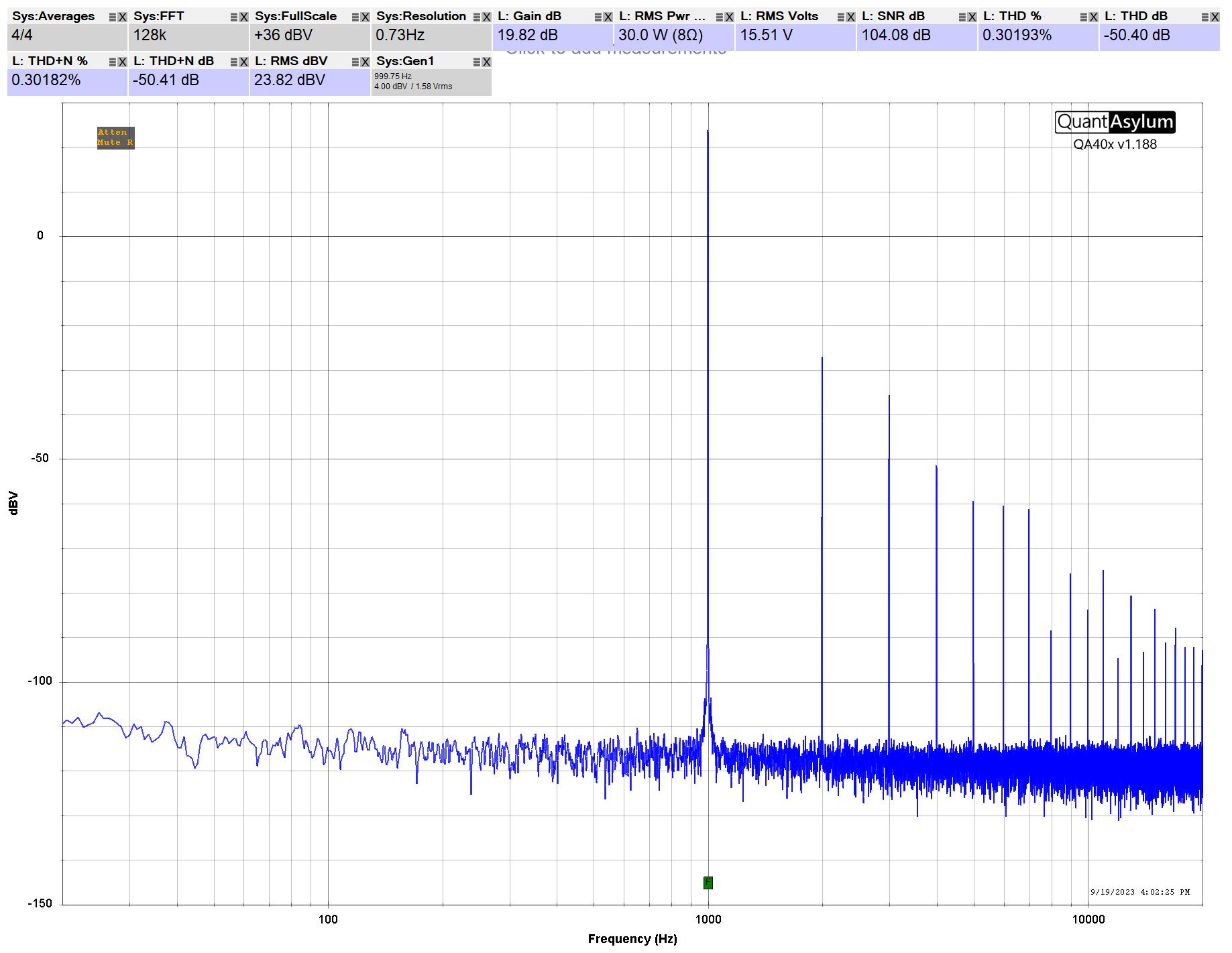

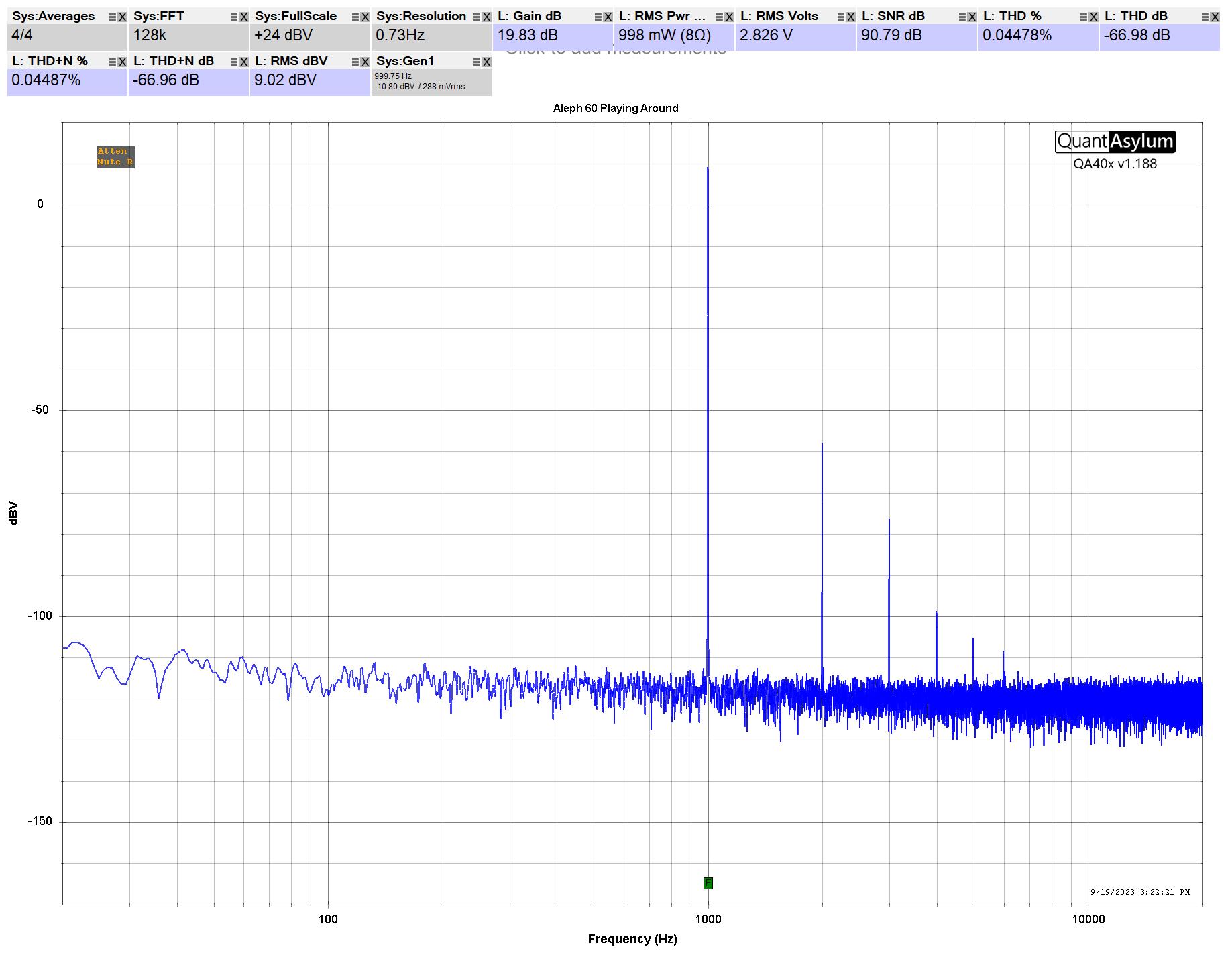

After a delay working on another project ... at long last I finally had a chance to get back to my Aleph 60 for a little while. It's still not done... but I wanted to do a few measurements before I buttoned it up. These are (as the title in a few of the graphs say) playing around. I don't even remember the bias I originally set. I just got it hot...
The AC Gain is 50% by the method described in the guide. For those that like measurements... here ya go! I thought it was pretty cool that the 1% distortion point was... you guessed it ... 60W (8R).
Note... I am just getting familiar with measurements. So, take these with a bucket of salt. They make sense, so I'm posting them. I also ensured a high level of repeatability. I trust them, but ... you may not. If I find any errors as I learn more, I'll certainly say something. tl;dr - they're correct to the best of my knowledge and ability.
I am tickled to death with the "Wretched Excess" PSU and the A60. I had to "go deep" to try and find any 60Hz and harmonics. It's quiet.

And... the best measurement of all... it sounds awesome!
I still want to play with AC gain etc... but that will come later.

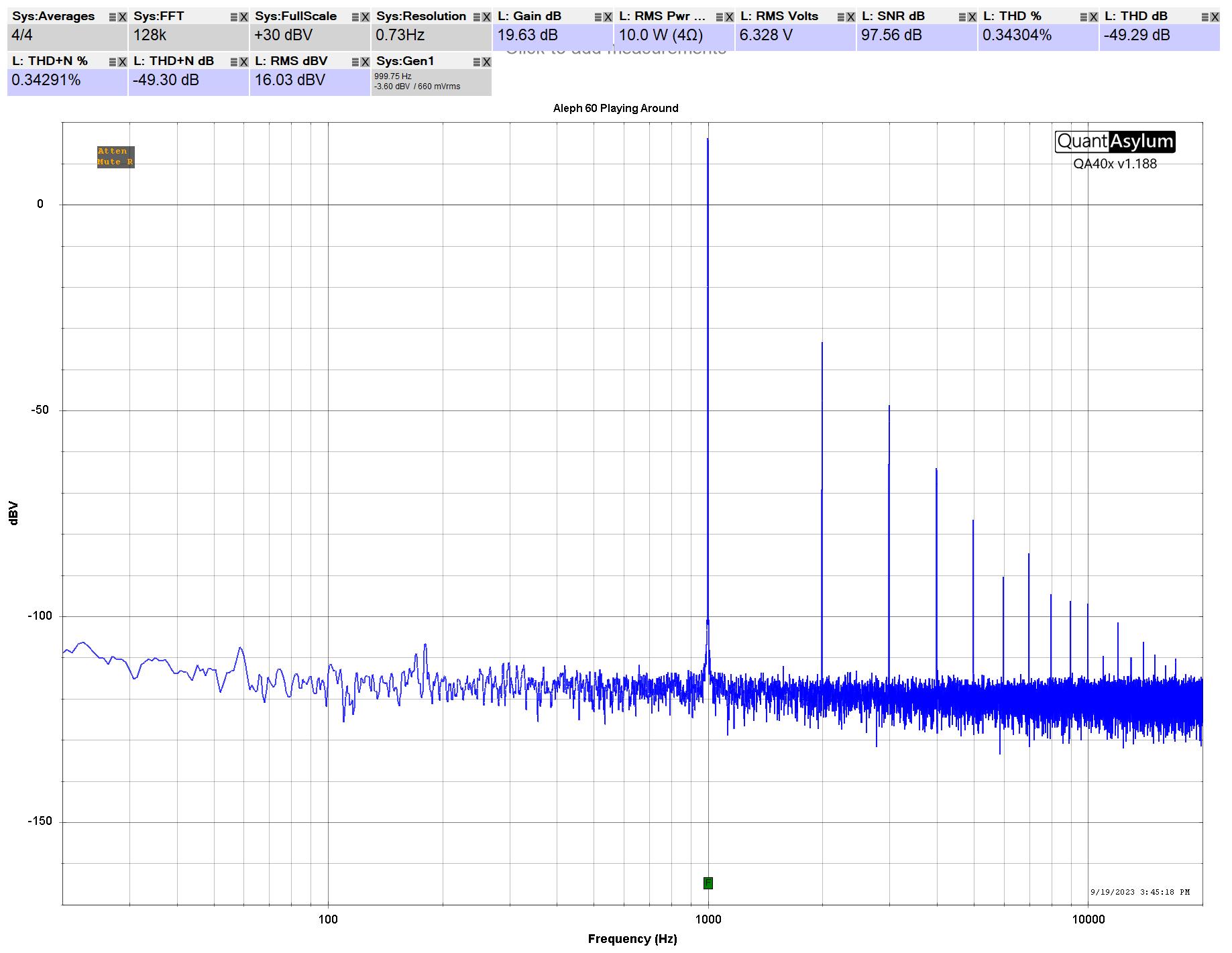

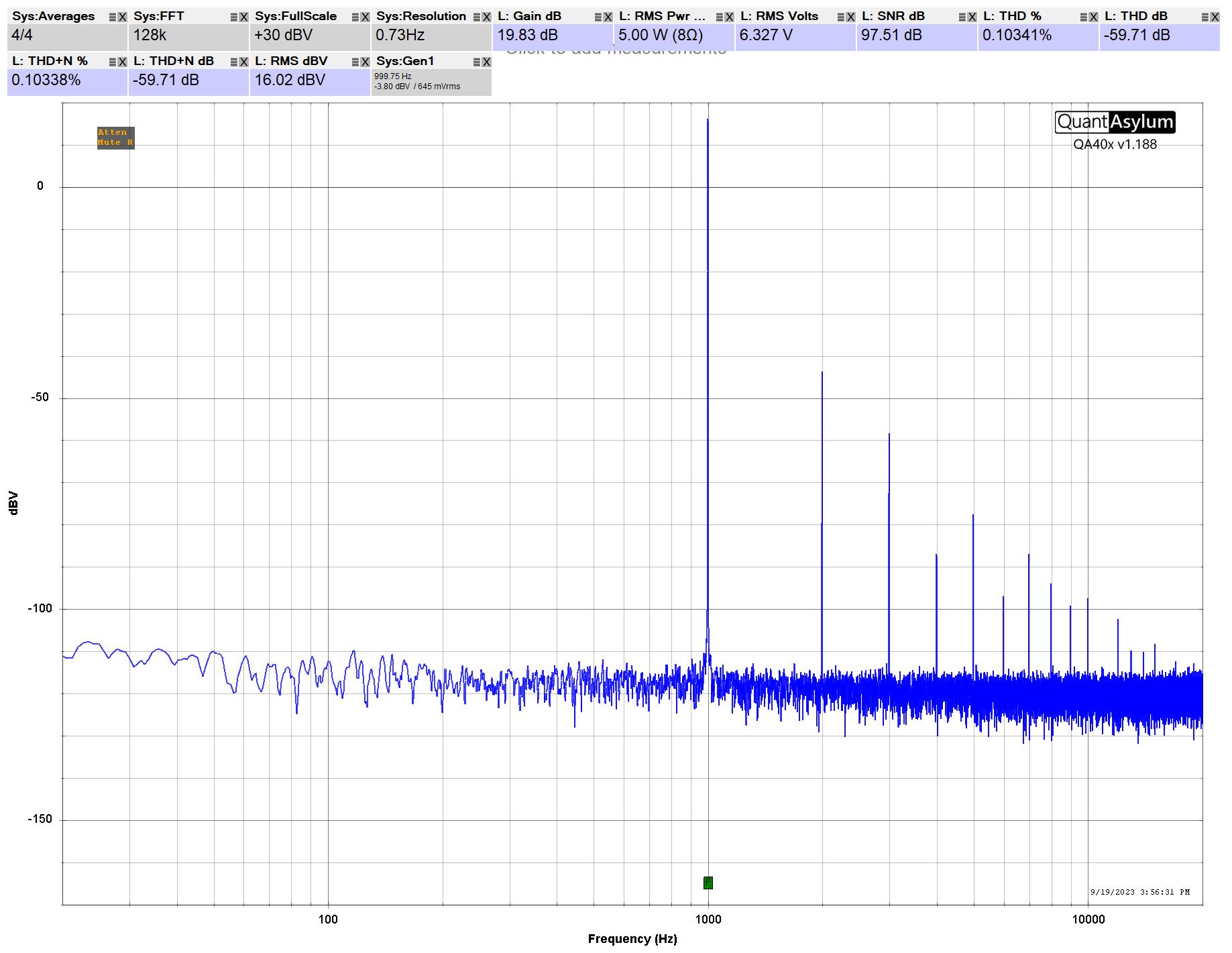

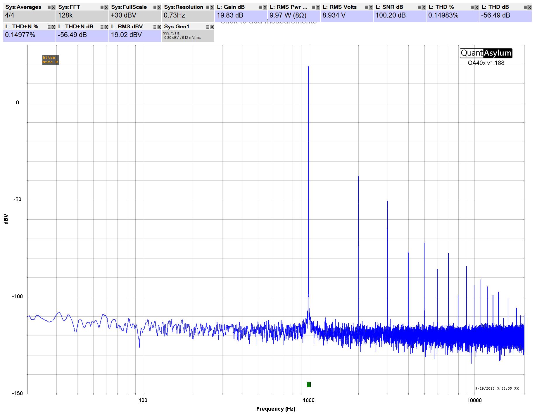

Here's the noise floor. Yep... it's quiet...
Here's the Power vs THD...
Some 8R distortion measurements. The 2nd Harmonic (negative) is prevalent throughout the power range.
And a few at 4R
More to come... I've had a blast building and learning as I go with this project.
Thanks to all!

Nice drawings... thanks.
Did you push into 4 ohms?
The Aleph 60 published specs are: 60 watts/ch @ 8 ohms, 100 watts @ 4 ohms @ 1% THD
By comparison, the Aleph 5 is spec'd at 1 % @ 60 watts, 8 ohms 3% @ 90 watts, 4 ohms
No wonder @rhthatcher prefers his 60s over my 5s. ;-)
