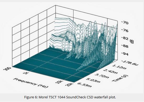

I didn't make this Morel 1" soft-dome waterfall up. It's by the respected Vance Dickason at Voicecoil. aka audioXpress The Leading Global Audio Engineering & Development Magazine IIRC.
There are certain difficulties, because Vance uses different scales quite a lot with different tweeters.
On the subject of ideal speaker materials, well, I really don't know. We mostly all have heard plastic polycone woofers. Paper cones and metal cones. They successively need more complex filters, and things get easier with bigger cones and higher voice-coil inductance which adds a natural rolloff. And there is evidence to suggest that metal cones are very pistonic, which may or may not be a good thing, since a diminishing radiating area on a more damped cone also has benefits.

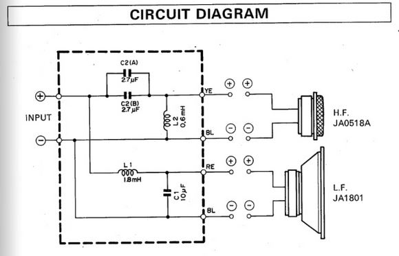

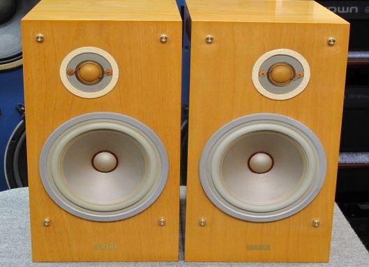

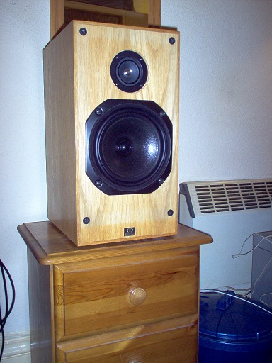

I suppose we ought to get back on topic with Ro808's mystery speaker. I think that is a Yamaha 6" NS-10 nearfield monitor. Pretty ropey speaker IMO, but typically sounded like most users home setup, so useful. The crossover is the all too often seen 2.5kHz solution IMO.

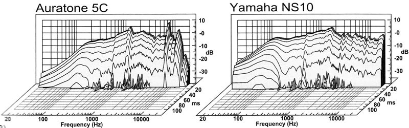

Steve, it's the NS-10 indeed.

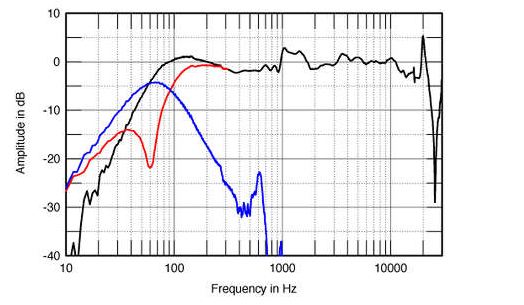

Here's its waterfall next to that of an Auratone 5c
I am fascinated by your preference for BW3.
Crossing tweeters too low is never a good idea, neither is having mid/low drivers playing too far into beam/breakup territory. Careful selection of drivers and (minimizing) trade offs/constraints are essential imho.
I have a preference for minimalistic designs with a few - not necessarily expensive - high quality components that make a nice blend.
