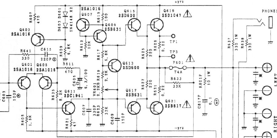

That's a Rotel RA-931?
A long time ago I owned one of those, as well as the 820A, 820 BX-II, 840 BX-III and the 980 BX. Nice no nonsense amps after some pot/balance tweaks.
I've always liked Rotel for the amazing build quality. These babies go on for decades! Occasional magic spray on the switches and they just go on and on.
I used to have a higher quality setup that spanned many stacked boxes, but really what's not to like in the simpler system?

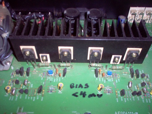

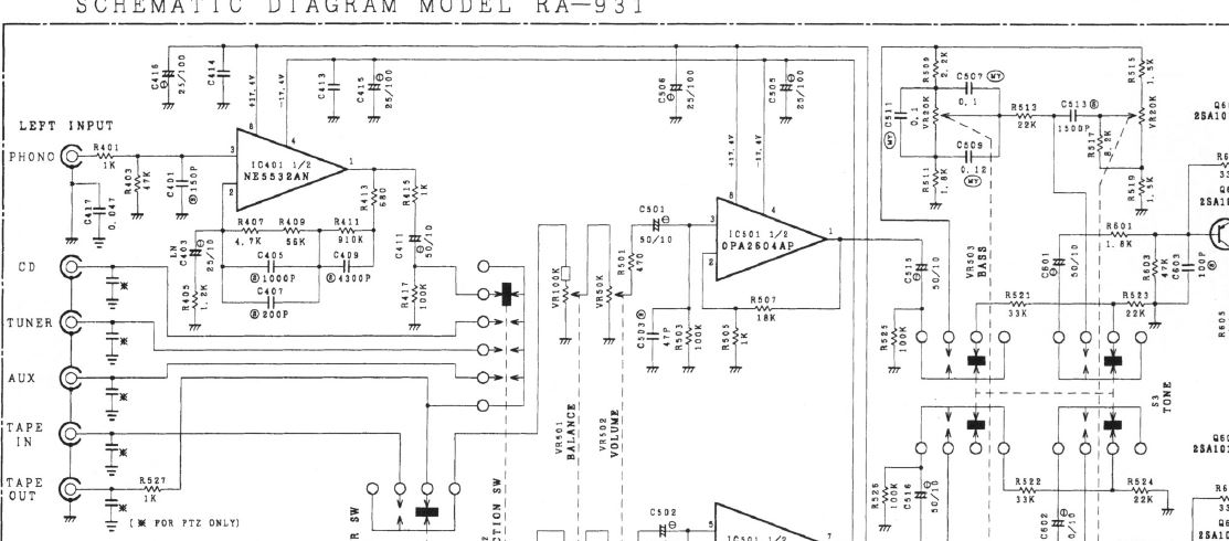

I fiddled with the Class AB crossover bias which had wandered over the years thanks to a competent service manual. It was worth doing.

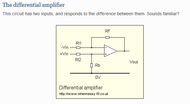

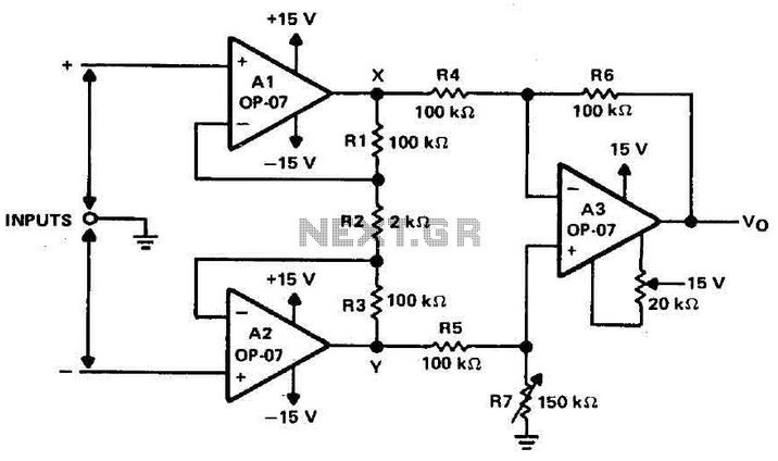

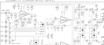

These things are built around differential amplifiers at heart. And the NE5532AN opamp was about as good as it got. Back in the day, people like Quad used class A circuits on preamps, but whatever. As it goes, there are good theoretical grounds for matching resistors around a differential amp which reduces noise from the earth rail known as common-mode. The more complex balanced line 3 opamp version version was what I was doing with a phono-preamp which I showed to Michael Creek.
In theory with low source impedance it shouldn't matter. But in practice most low level sources have an output impedance around 1K to protect them from short-circuit condition.

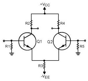

You will see the long-tailed pair in most amps these days, in some form.

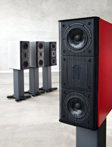

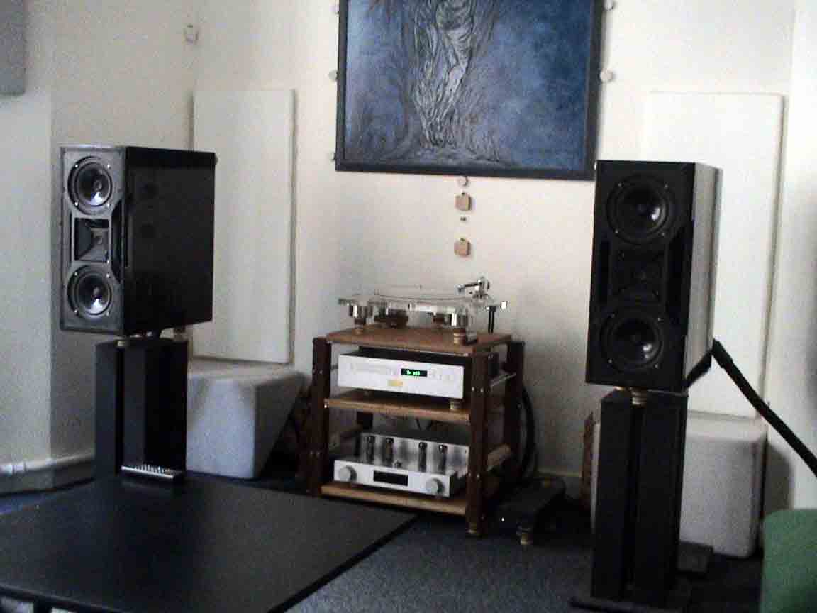

Yes, MTM's done well are able to play some magic (tricks).
The Living Voice MTM's are loved by many, though basically it's nothing more than a upgraded old Dali 104 (which my brother owns).

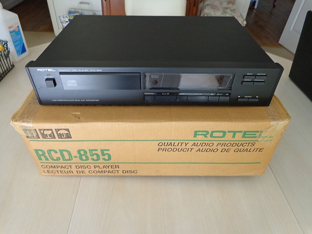

To conclude the Rotel R2R CDP's, here's an illustrative comment:
"FWIW, the biggest mistake I've ever made in this hobby was going from my beloved Rotel RCD855 (16 bit R2R) to a Rotel RCD 965 (bitstream) CD player during the end of my student days in the early 1990s. The loss in SQ was obvious in the first few notes. Fortunately, I rectified things by buying a Rotel RHCD-10 (20 bit R2R) a few years later, once I was finally working and earning some cash. I sold the RHCD-10 only a few years ago as I simply had no use for a CD player anymore. But to this day, I still maintain that the RHCD-10 is the best CD player I've ever heard - better than the Esoteric P70/D70 combo I had for many years, and better than the top-of-the-line Linn and Naim CD players I demoed at various dealers' places."

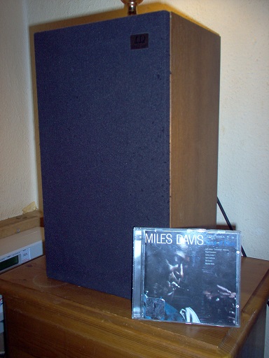

But we are speaker nuts! The most critical component IMO. Let's reiterate that little 5" plus 3/4" MA7 BW3 speaker I currently enjoy:
I'm actually amazed at the good bass sound a 5" can produce in 12L reflex. And VERY detailed.
There's a lot wrong with this speaker. But it does a lot right too. So, as a speaker nut, I want to keep the good things, and lose the bad things. This is the hobby, isn't it?

So, this is a 'grown woman with a piano' speaker?
Ha, ha, nice expression. 😀
HaHa. Certainly not a "little girl with a guitar" speaker so beloved of the simple crossover brigade! I'm currently "Groovin with Mr. Blow", aka Mr. Miles Davis on "Kind of Blue". The best way to explain Jazz, is you just set off not quite knowing where you are going to arrive.So, this is a 'grown woman with a piano' speaker?

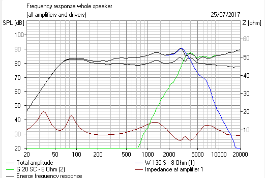

According to my best simulation, this little butterworth3 MA7 has TERRIBLE impedance, and a peaky nature that may be slightly ameliorated by NP capacitors:
Some of Miles' notes just shriek. But overall a very good sound. So I think we should MTM this idea at ear-height. And since that ends up a bit tower, we might as well add a bigger 8" woofer and go 3-way.
I really don't know about tweeters. Surprisingly, classic old mylar plastic types seem to work well.

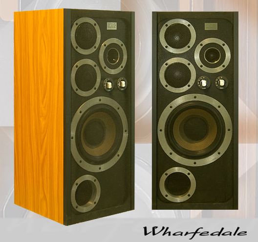

It's is all very Wharfedale E70, which had series wired mids:
But we can do a better job on crossover and the flat impedance. We now know how to do that.
