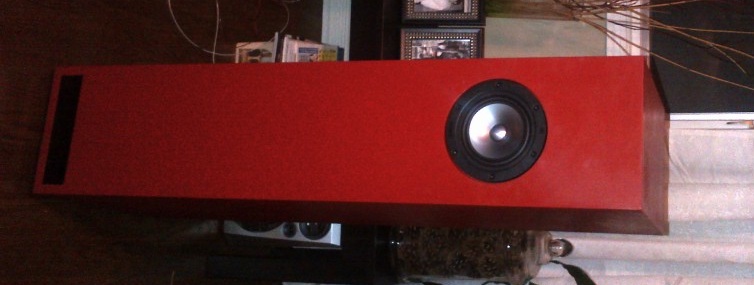

Perhaps he was suggesting a lower XO point like 500Hz and use a full range (wideband) driver for the "tweeter" - similar to FAST systems over in the Full Range Forum. FAST (Fullrange Assisted Subwoofer Technology) or 2-way speakers with low XO point can sound very good.
Here is one example of a FAST that I really think sounds great using an RS225-8 and Scan Speak 10F/8424 as the midtweet.
10F/8424 & RS225-8 FAST Ref Monitor
I made a passive transient perfect 1st order XO for it, and now use this as my main speaker for testing amps over the past 2 years (ignore label that says FF85WK - works for either driver):

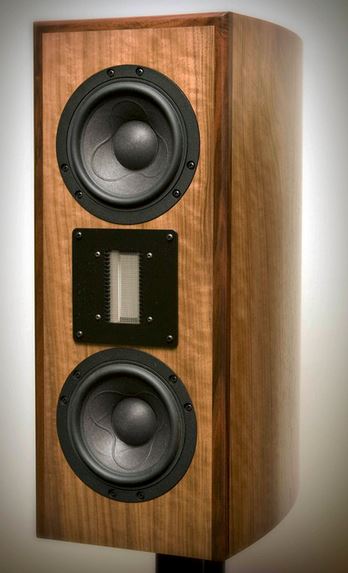

I like what Shane Rich says about an MTM design. More direct speaker, less of the room acoustic. I think that is the way forwards.
635014d1505220144-home-theater-speakers-vifa-pl14wj-dappolito-mtm-jpg
I could probably make a good case for doubling the tweeters, too. MTTM. :)

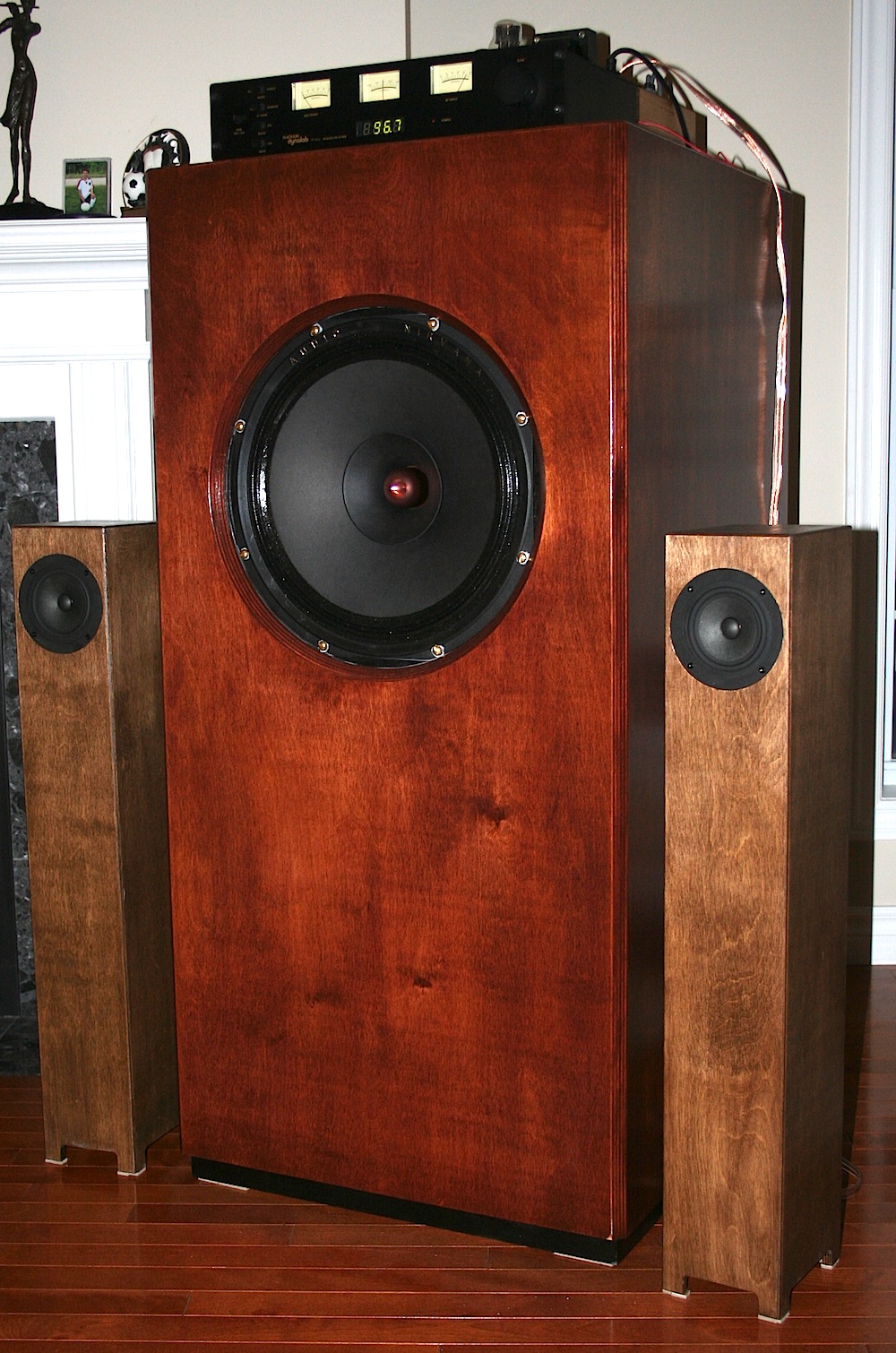

Bigun, you are a terrible troll. Have you actually ever designed or built a moderately competent loudspeaker? It's not easy. Mainly, IMO, because such a thing doesn't exist.
well, I think your comment was well out of context - a low XO is a problem as described by Lynn but in other regards it's preferred.
I was thinking about my PMC floor standing speakers, FB1, 2-way. I have the originals which have a higher XO than you'd want given dispersion hand-off between woofer and tweeter. Three generations later, the FB1i had a lower XO, enabled through the use of a soft dome tweeter that can operate lower. The result being a better hand off between woof and tweet. It's not first order for starters. I could do this upgrade myself.
'x' raises another interest of mine - the FAST arrangement. I can't do that with my PMCs so that would have to be a different project.
At least I am a harmless troll though ! - I have never built a speaker with more than one driver so the world of XO is new to me. I have build a few speakers with only one driver - see photos :D

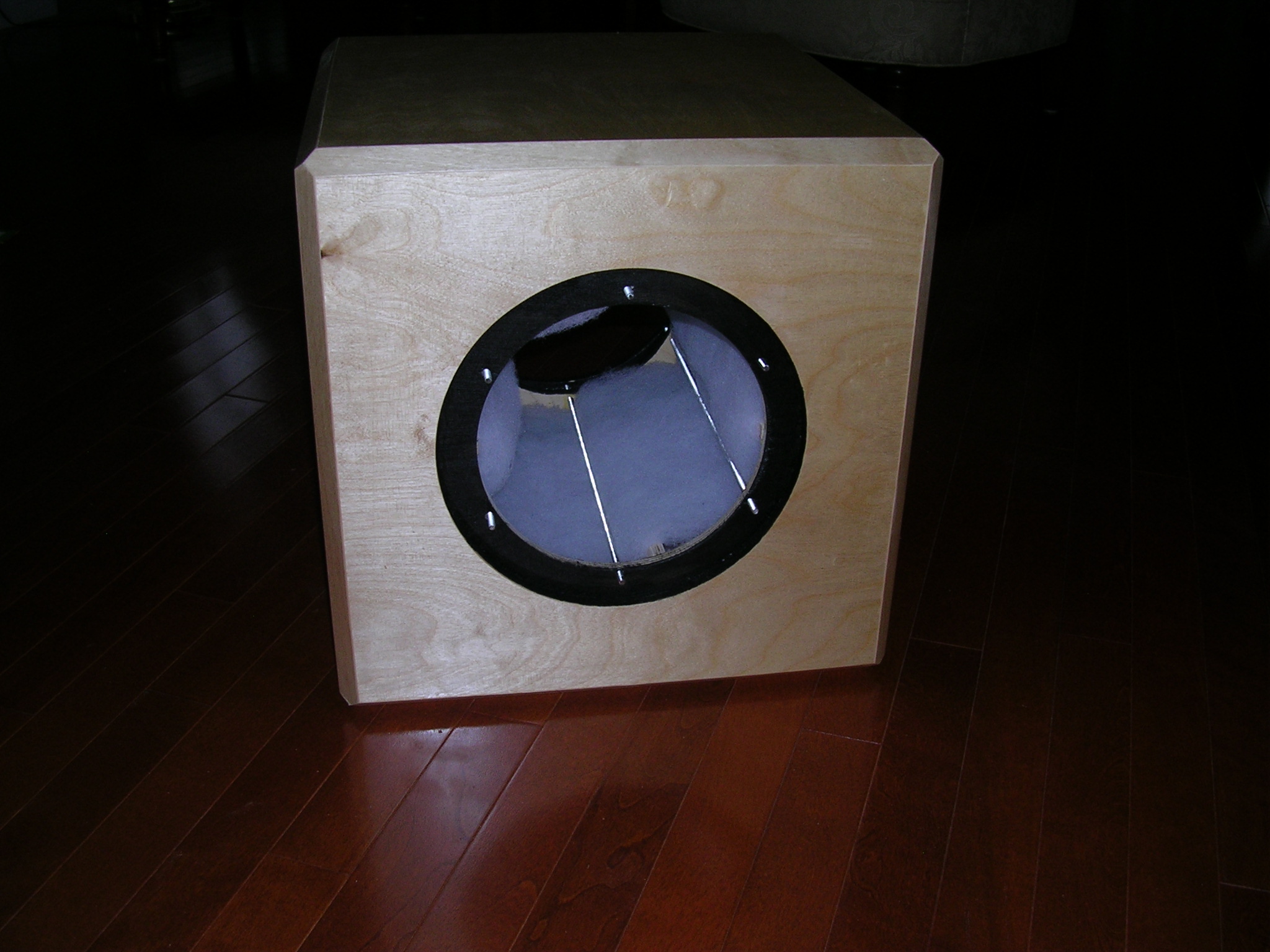

I do like how the sub-woofer turned out, that's the first photo. Two drivers mounted push-push, one faces out, one faces in, 2nd order harmonics cancel, no box vibrations, steel rods connect the drivers.
I mostly build amps. If you like to build amps, I have a Class AB amp that I'd put up against any amplifier you care to name, it's that good.

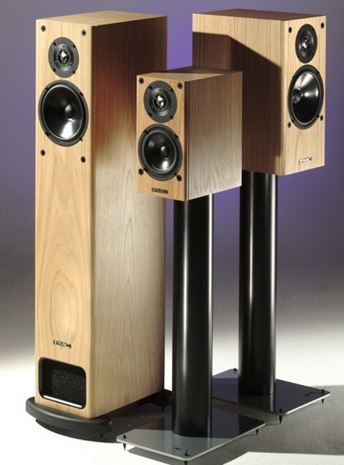

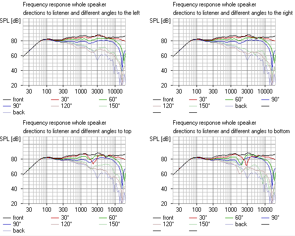

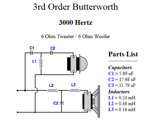

I ought to spend some time explaining how BW3 works, because I'm not sure people really get what it does. Your comment about the poor PMC FB1 (famous old vifa metal dome, isn't it?) dispersion might then make more sense. See, phase aligned like LR2 and LR4 is fine on axis, but above and below axis the two drivers lose phase coherence, and the sound changes. This is the 3dB power hole I often describe.
Both the speakers in my room are butterworth designs. 90 degree phase at crossover, but nevertheless flat frequency response on axis. They have more power at the crossover point, which makes them more consistent off-axis. There is a higher power lobe above axis, IIRC, but this is offset by the poorer dispersion of the bass, so it sort of works out. The fact is you don't get the huge nulls off axis like you do with phase aligned designs. And this is one of the musical secrets of most BBC and KEF designs.
Rogers Loudspeakers › LS5/9
In fact the impedance is remarkably flat too. Which made them valve-friendly. Another interesting aspect is with, say, LR2, you might tune the bass filter to 2kHz, and the tweeter filter to 5kHz for a 3.5kHz XO. With 3.5kH BW3, both filters are tuned to the same 3.5kHz frequency. Bafflestep is a separate matter, but there are ways to do it.

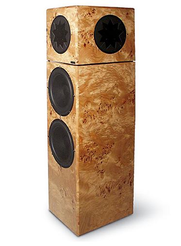

XRK971's FAST is an appealing alternative, but with sensitivity most likely <90dB.

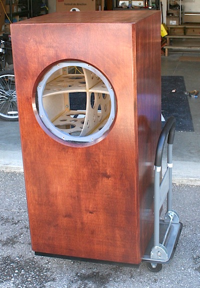

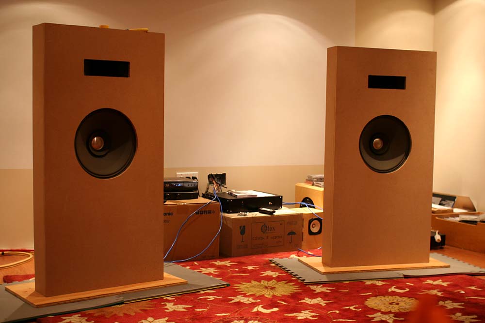

@Bigun, I jumped through your build thread and I do like the concept of 1 big driver in a large cab. As usual, a few questions arose:
- How does that whizzer / phaseplug perform in relation to the lower (cone) spectrum? I would suspect some cuppy, beamy characteristics.
- VAS is very high and xmax very low, which implies a very, very large cab or an OB as was mentioned in the thread. I wonder how these AN drivers would handle high power, bass heavy input.
- As I understood, you didn't measure these drivers in the cabs, which would be the only objective indicator on performance.

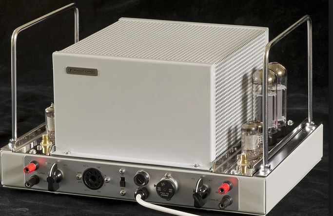

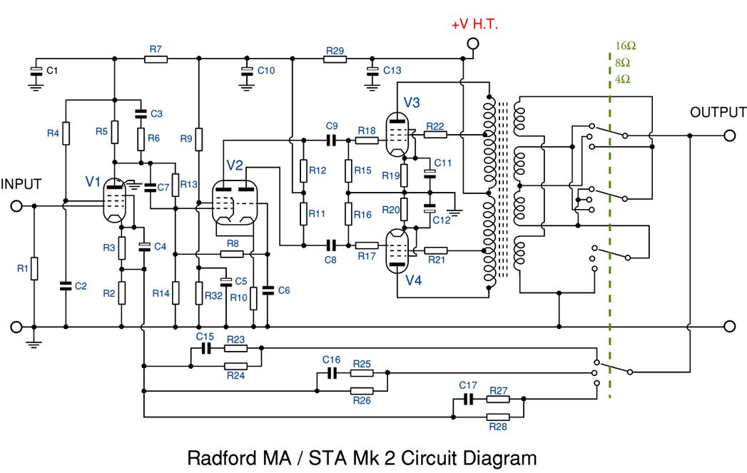

My brother-in-law has always liked the good sound. He generously gave me his old Radford STA-25 valve power amp. Being a mere noob, back in the 1960's day, I really didn't appreciate you had to set the grid bias up for low distortion.
And valves really never liked a complex-impedance reflex load. Happier with closed box.

Low output SET amps are not the best companion to BR loudspeakers of modest size, that's a fact. Even more so if the impedance shows serious drops.
Solution: step up in cone size (HES) and you might switch to 16 Ohm drivers. Another option: feed the bass with class D.
AFAIK , the Radford STA-25 was not a SET amplifier. My version was not exactly the same as this one:
635374d1505410753-classic-monitor-designs-radford-sta-25-power-amp-jpg
With valves you did best make a guess at speaker impedance, so 4-8-16 ohm taps. This mainly affected efficiency, but because of the output transformer which worked less well at extreme bass frequencies, you just didn't get huge damping factor on the bass. Mine differed in having an adjustable pair of potentiometers to set the grid bias, aka output crossover bias. But if we look at a schematic, I see some global feedback. Which is less SET and more mainstream negative feedback.
The pre-amp and FM tuner were both transistor designs. So clearly the magic was in the fast valve output stage.
TBH, I puzzled over valves for years. It seemed like subsequent transistor designs were a lot worse. But we now know that early transistor designs suffered from transient intermodulation distortion. Which was simply that output transistors ran out of gain at high frequency, so feedback stopped working properly. More modern designs like my Rotel transistor amp pretty much do what it says on the box. 0.1% distortion into 8 ohms up to 20kHz.

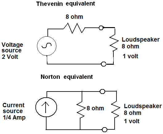

The exact Norton-Thevenin mathematical theory tells us that, WITH A FLAT IMPEDANCE LOAD, voltage and current devices get to the same place. So my interest these days is getting a flat impedance! :)
