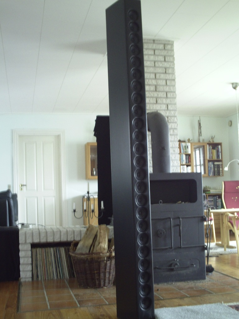

I made a black line source using cheap Madison drivers and an alu linesource using the same Vifa as IDS25 except paper cone instead of glassfiber.
Koldby
Did you do any equalizing? how do they work for you? Is it closed box?

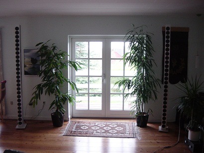

Sorry for not responding earlier
Oh yes eq. is nessesary. Not that much, but absolutely nessesary.
The one with Aura sound is eq. by a Behringer deq96 and is palying in my HT room. Does a good job here. Crossed over to 4x 10" subwoofers @120Hz and aided in the top by a 19mm ring radiator.
The Vifa source is my main reference speaker. Eventually I will mate it with a IB subwoofer as it cannot play loud enough in the bottom octave to my taste.
I use Audiolense to eq. it and room correct at the same time.
These are amazing speakers!!!![smash :smash: :smash:](https://files.diyaudio.com/forums/images/smilies/smash.gif)
The best I have had. A little trick:
Put a little Isopunkt made thinner with turpentine on the paper cones and let oit harden in UV light. Takes them a step up in clarity and definition.
It is closed boxes both of them.
The alu boxes are actually a little too small, but when the subs are ready, makes no problems.
They play insanely loud when crossed over about 80-100 Hz.

Amazing. Really amazing.and you like how it sounds?
If you think such beast are big and bloated - think again..
They can pinpoint if it is in the recording, make vast spaces if it is there, and are ligthning quick and dynamic.
