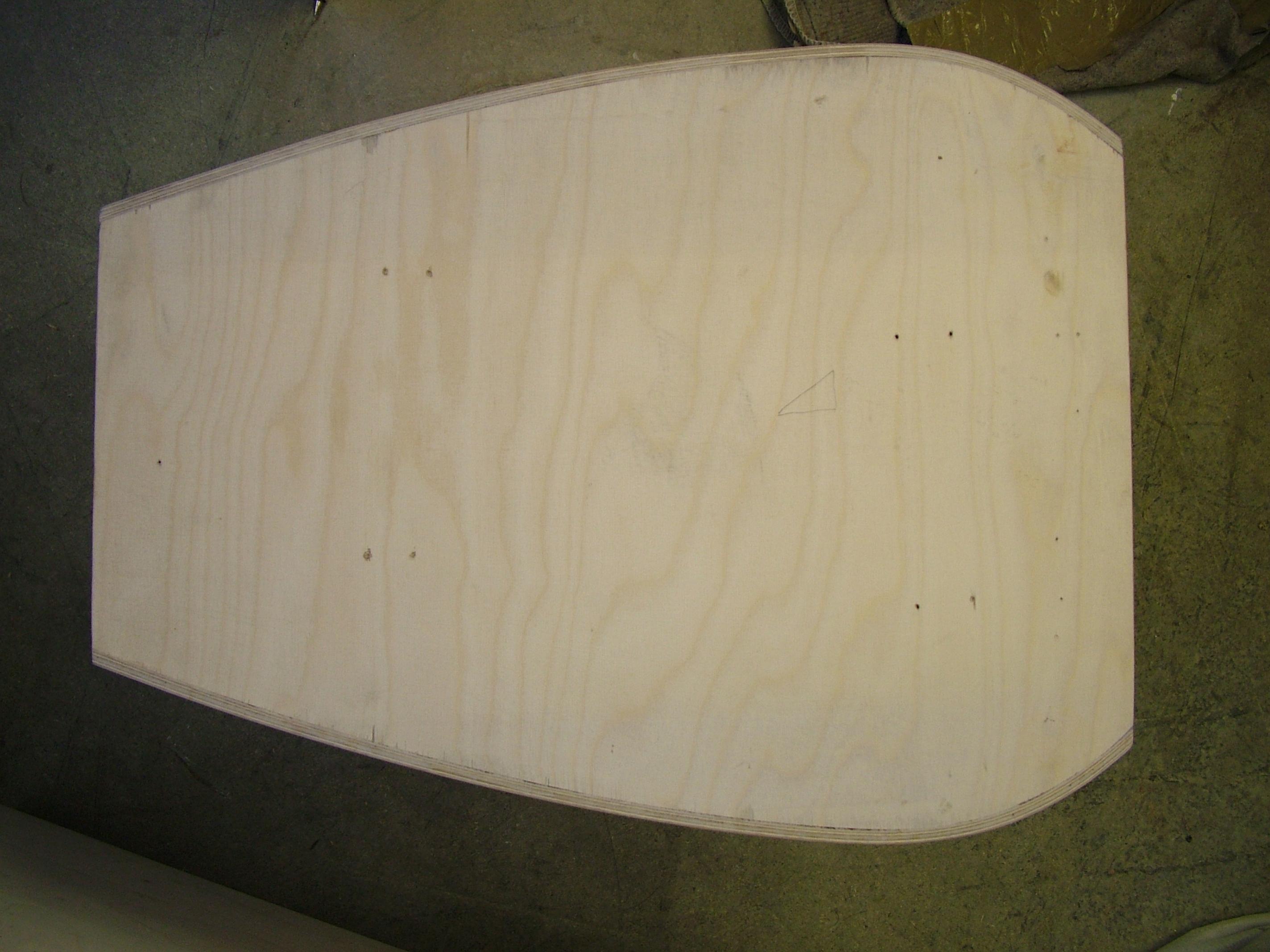

First steps, a lot of work ahead:
![P1030822-small.jpg](https://www.rsr-concepts.com/diyma/P1030822-small.jpg)
On the left a finished set of routed ply, on the right the rough cut and my water yet cut template..
My DIY table (Workmate with a router between the vice, bolted to a piece of plywood) works. You can see a small stud behind the cutting bit to make it easier to start cutting by easing in using that stud.

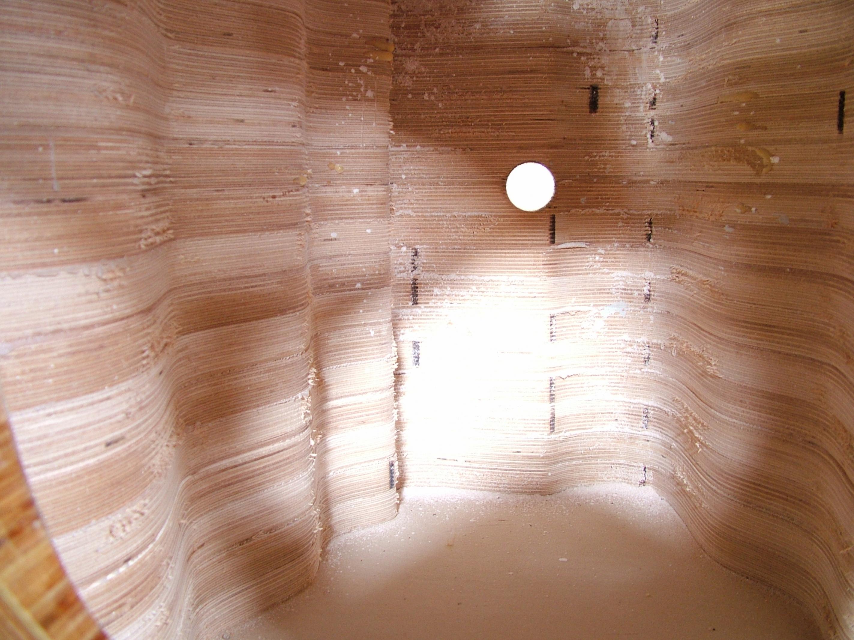

Great progress, and Vifa TC9's rule!!! Question though, is the undulating alternating wave like internal surface meant to provide acoustic damping? Neat idea.

Thanks xrk,
The alternating wave (or internal alternating phase sinesoidal diffusers™, as someone put it
) should help diffuse/scatter the back wave some but the shape is really too small to work for anything but really high frequencies. But it should also help to prevent/limit resonances of the walls by varying the thickness of the outer shell. it varies from 18 mm minimum to about 25 mm (or 1"). At least that is my theory for doing it this way
It's the middle ground to keep internal volume up with stiff walls and manage the weight.
Although translam construction generally doesn't end up providing significant improvements in panel stiffness (depending on orientation it can actually be weaker). Looks good though, albeit rather expensive in material terms.
The varying thickness will likely have the net result of shunting panel resonance upward somewhat (no bad thing since they're less likely to be excited); TBH, with quality BB ply, the multiple layers & bracing I wouldn't expect it to be an issue in any case, but it's certainly not going to hurt.

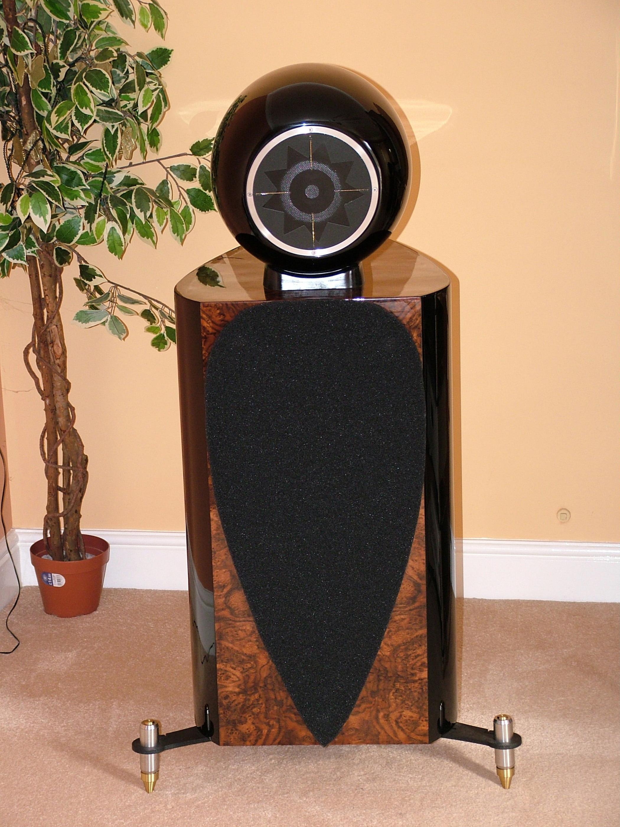

Multi layer birch ply construction
Hi Wesayso,
Just saw your cabinet photos and I smiled...!
I can promise you its well worth all the time and money, blood sweat and tears.
Not only does vertical laminated construction look great it sounds ( or to be more accurate does not sound at all) great too.
Building in Asymmetry internally reduces standing waves ( not resonance) and the external curves have superior defraction properties.
Resonance is greatly reduced as well, esp with variable wall thickness. Compared to a standard 25mm thick flat MDF or Birch Ply panel your curved, variable thickness, laminated and asymmetrical cabinets are vastly superior.
Finally there is the static mass to moving mass ratio. I spent a lot of time and money with prototypes of the Overkill Audio Encore and discovered the optimum 1,000 times ratio.
ie a Beyma 12LX60 bass /low mid driver with a moving mass (Mms) of 100g needed a 100Kg mass of bass cabinet to reach its best performance.
The Beyma can handle 600 watts continous AES with 1 Kilo watt peaks.
On bass transit's the power amp / driver combo could " move " a 40 Kilo, 60 Kilo even 80 Kilo cabinet. Bass clarity, depth and texture as well as drum and percussion impact kept on improving ( quite clearly, not subtle improvements) until the 100 Kilo bass cabinet.
This did not include the 20 Kilo Head unit for the Manger or the 18 Kilo Sistrum stands...!
I will post a few more pics which should be of interest to you or anyone using this " Overkill " construction method...!

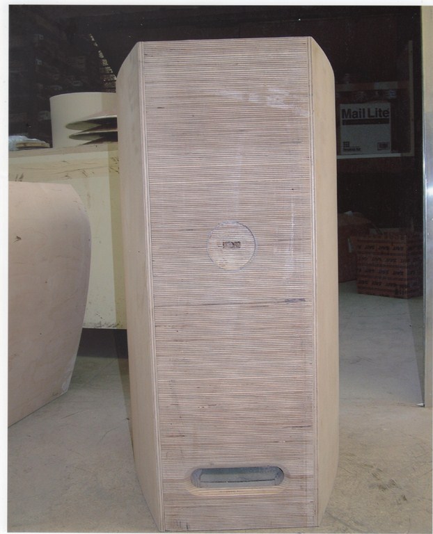

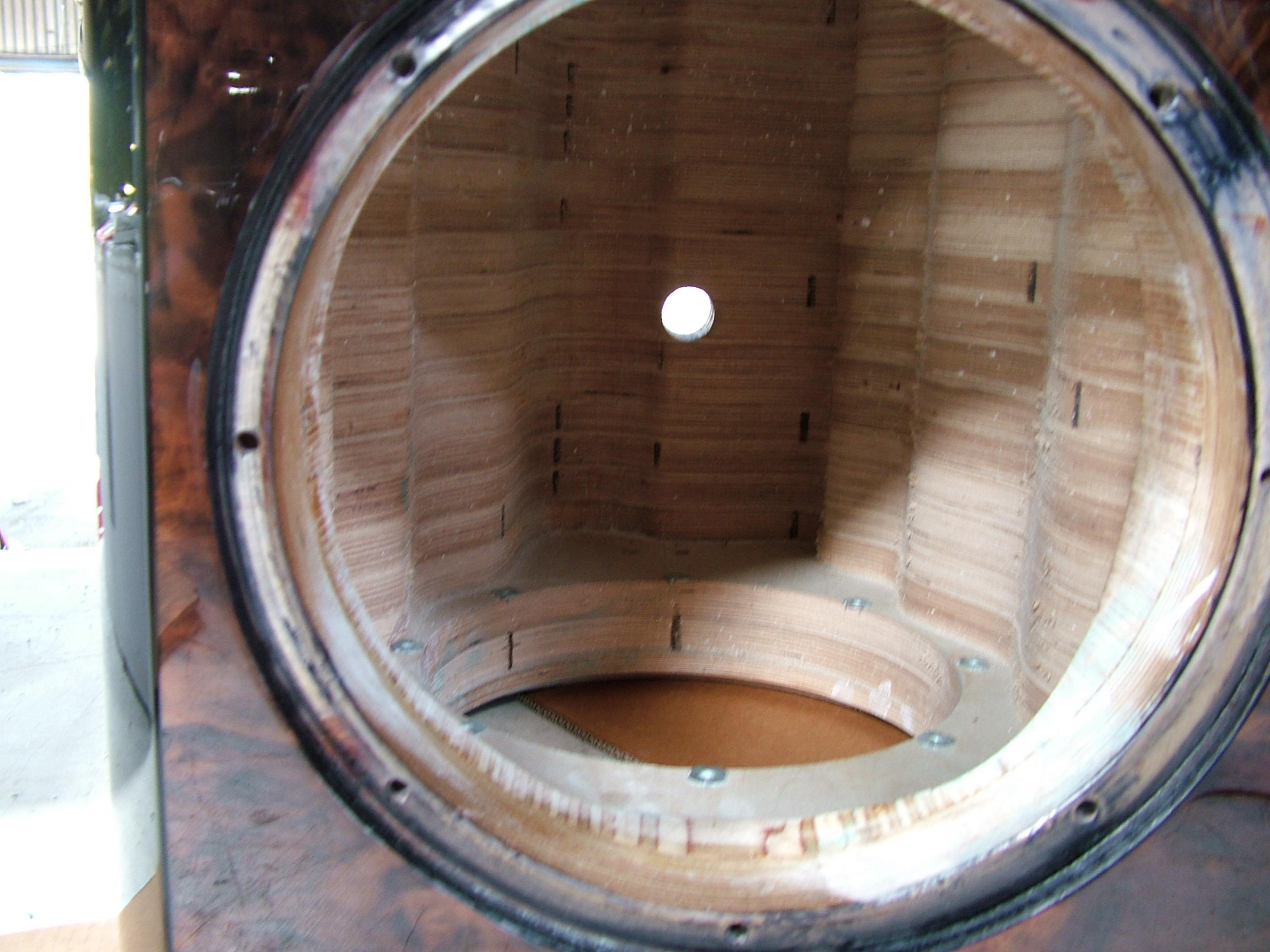

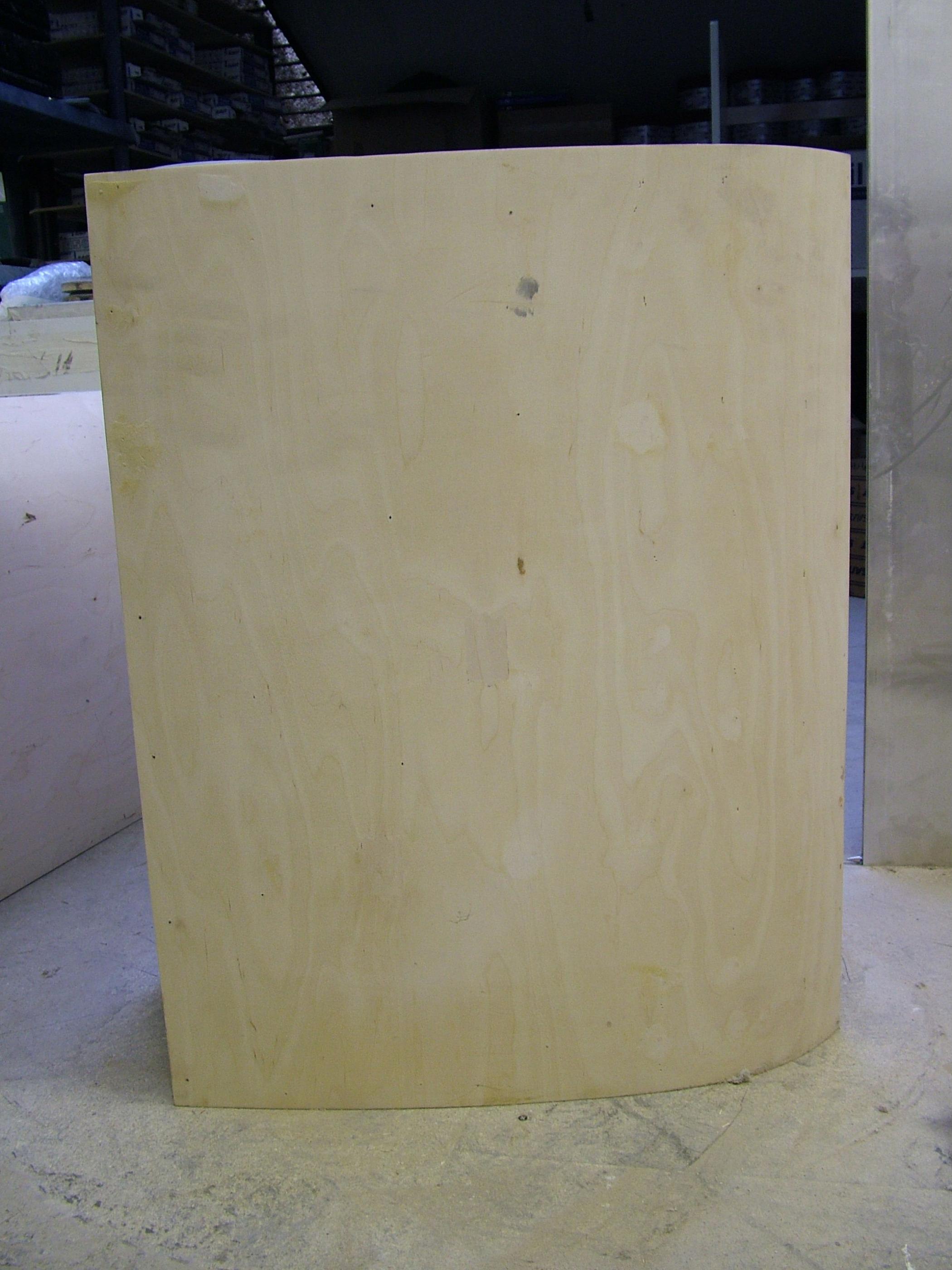

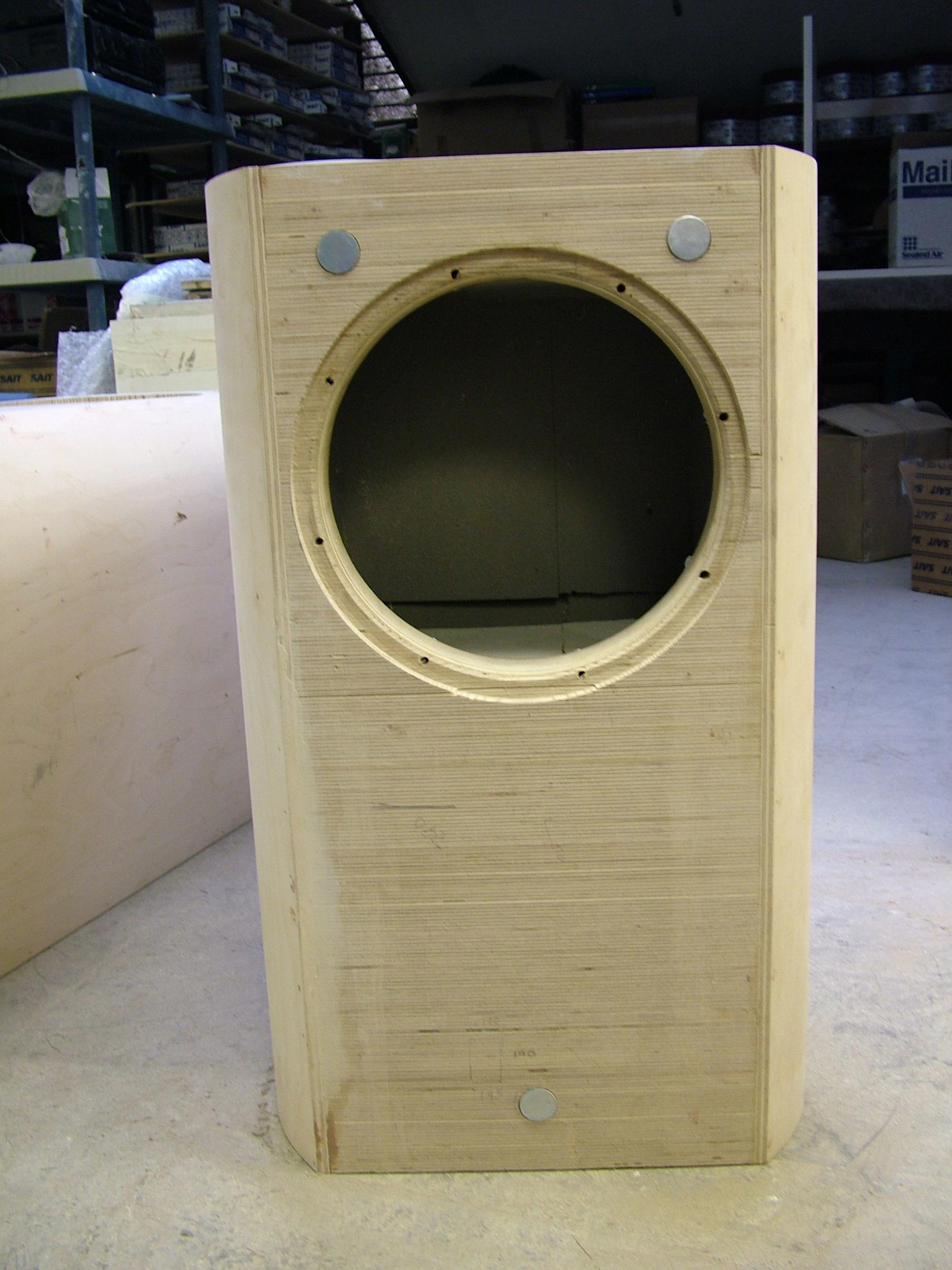

More pics multi layer ply cabinet
Some more unfinished cabinet pics.
The first pic : We had to clad the stack in an external curved layer of 6mm ply so that no ridges were visable in the piano black gloss or veneer finish.
Long term the layers can expand / contract with ambient humidity changes so cladding is the only way to be sure of a 100% perfect finish long term.
The second two pics : show the internal Asymmetry and variable wall thickness, 25mm to 55mm in the final production version of the Encore.
Also shown in the last pic is the hole in the base of the cabinet for an ABR or extra bass driver depending on model.

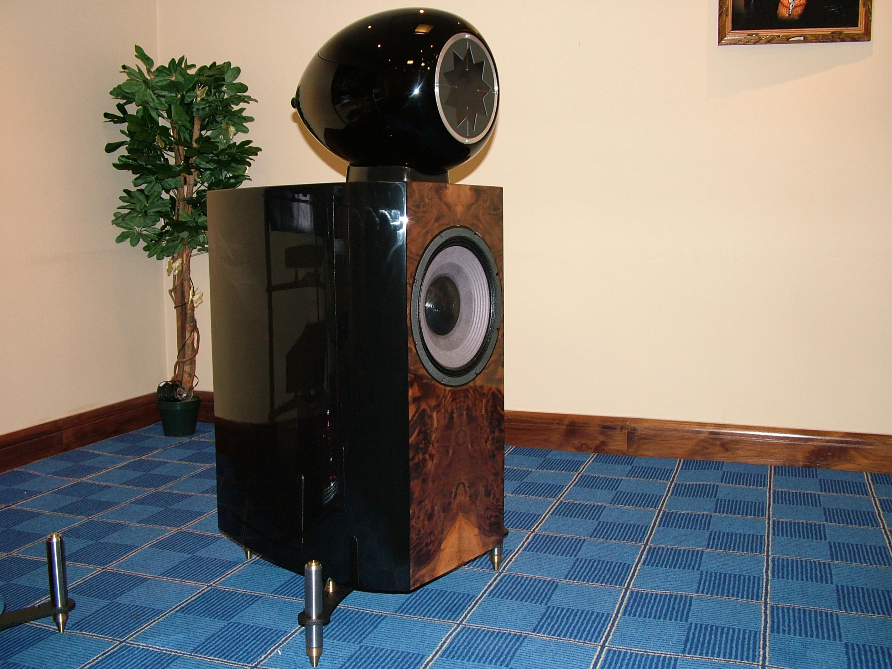

More pics of external finish
They also sounded amazing!
Check out a review :
6moons audio reviews: Overkill Audio Encore Speaker System
