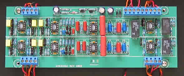

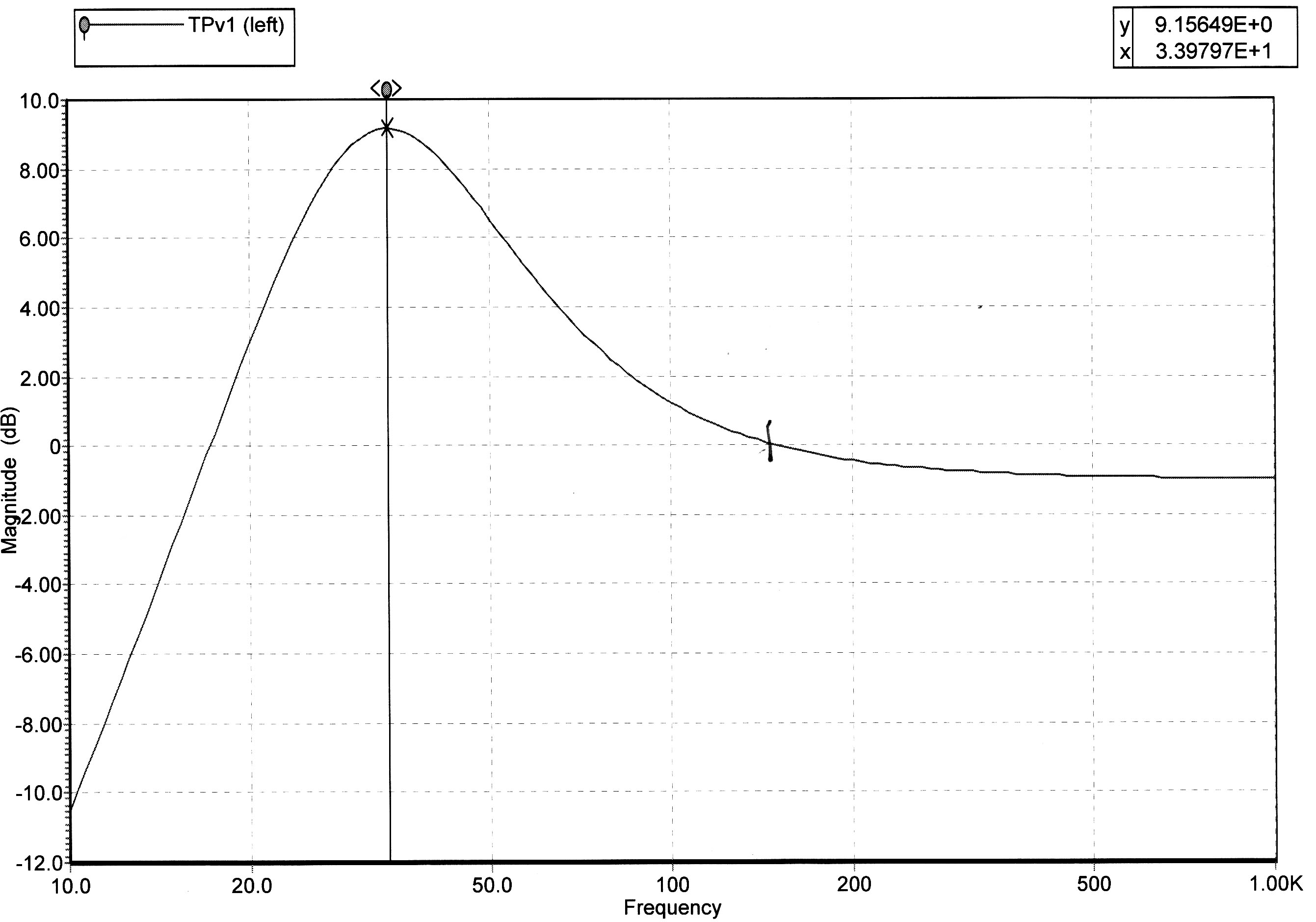

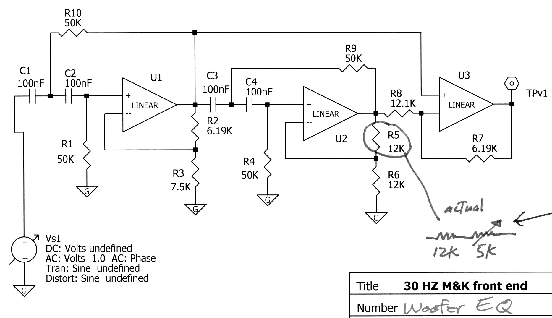

Roger didn't share the schematic for the active equalizer, but does show it's frequency response in the Audio Express article that I have here. 200HZ - 500HZ is the lowest point on the graph (dB scale very difficult to read) but he did say he had about a 15dB peak in the response at 30HZ, apparently relative to 250HZ, with a fast rolloff below 30HZ (very important). There is a gradual rise in the EQ that goes from about 500HZ to 20kHZ. If he's up 15dB at 30HZ, then it looks like he's up about 7dB at 20kHZ. The slope for the curve from 500 to 20kHZ looks like it's about 3dB/octave.
By the way, Gary Pimm pointed out to us that the Behringer analog circuits in his DCX2496 unit are very poorly designed. I have a DEQ2496 that I totally re-designed and rebuilt the analog section of. Way too difficult for most techs, and very time consuming. I'd look at DBX brand digital EQ, or others, or scale some existing analog circuits in a SPICE type program to get the desired EQ response, then add good tone controls to the system if you don't already have them. I hope this is helpful.

If I come up with a good analog active EQ circuit I'll share it here. In the mean time the Behringer mod can be found on my website at:

I'll try to get to the IDS25 active EQ circuit soon. I just bought a ATEN brand computer switch so I can switch between the new Win 7 PC I recently built, and the old XP PC that has a version of SPICE that works with the M&K woofer circuit that's already modeled. With mods that circuit will give me the perfect low end EQ, with the fast rolloff below 30HZ, but I'll need to dig out a five section pinking filter circuit and integrate it in for the apparently 3dB/octave rise from about 600HZ on up.
Pinking filters create a rolloff, but put in a feedback loop will do the opposite. Maybe a Baxandall section would work better for the slow rise to 20kHZ. I'll have to play with that a bit to get it right. With room acoustics and etc being such variables, I'll also use my four section Baxandall tone circuit as well.

In case anybody out there is good at using the SPICE or equivelent circuit modeling program, and has time to modify this circuit to do what you want for the IDS25, here's a starting point. This partial M&K circuit originally had about 20dB of gain peaking at 23HZ. As shown, the lo-pass function has been removed. The rise above 600HZ will have to be figured out separately. It may be a while before I can get to this myself.

Can't wait for the full EQ circuit.
