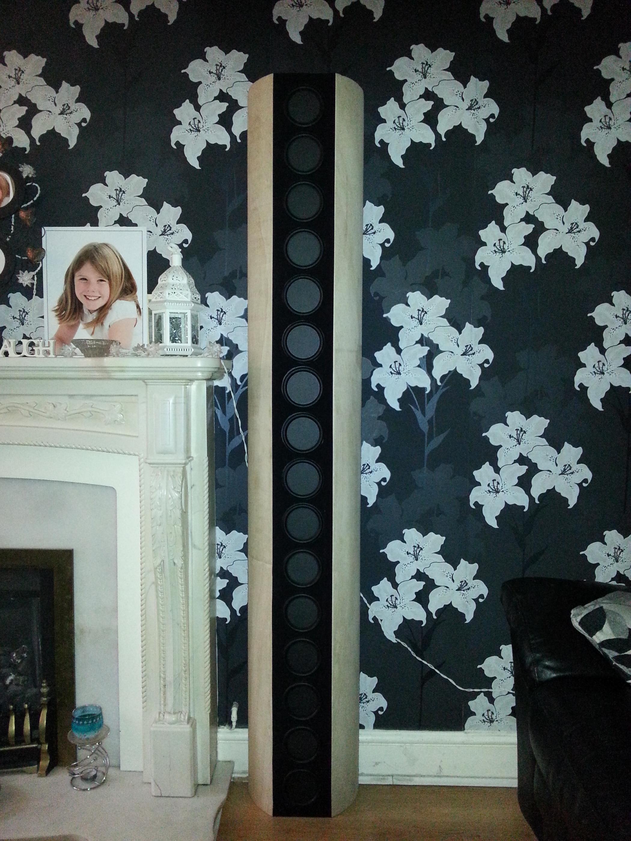

External Epoxy coating
If you can get the external epoxy smooth enough that will be a great base to paint on.
If you are hand layering its going to be tricky... Maybe spraying on a few coats of epoxy or polymer based material will be easier?
By the way all my Overkill Encore pics are from about 8 years ago. The attached La 16 and LA 8 use 16 and 8 BMR's per side in a full range line array, ( back on topic!) and are my latest designs.
I now mount them tight against the wall using rebated metal Keyhole inserts. This makes a really big difference as it gives the speakers the effective mass of the wall they are fixed too...Nice Mms to cabinet ratio!!
I will take some more pics tomorrow and show the LA 16's wall mounted.
Cheers
Derek.

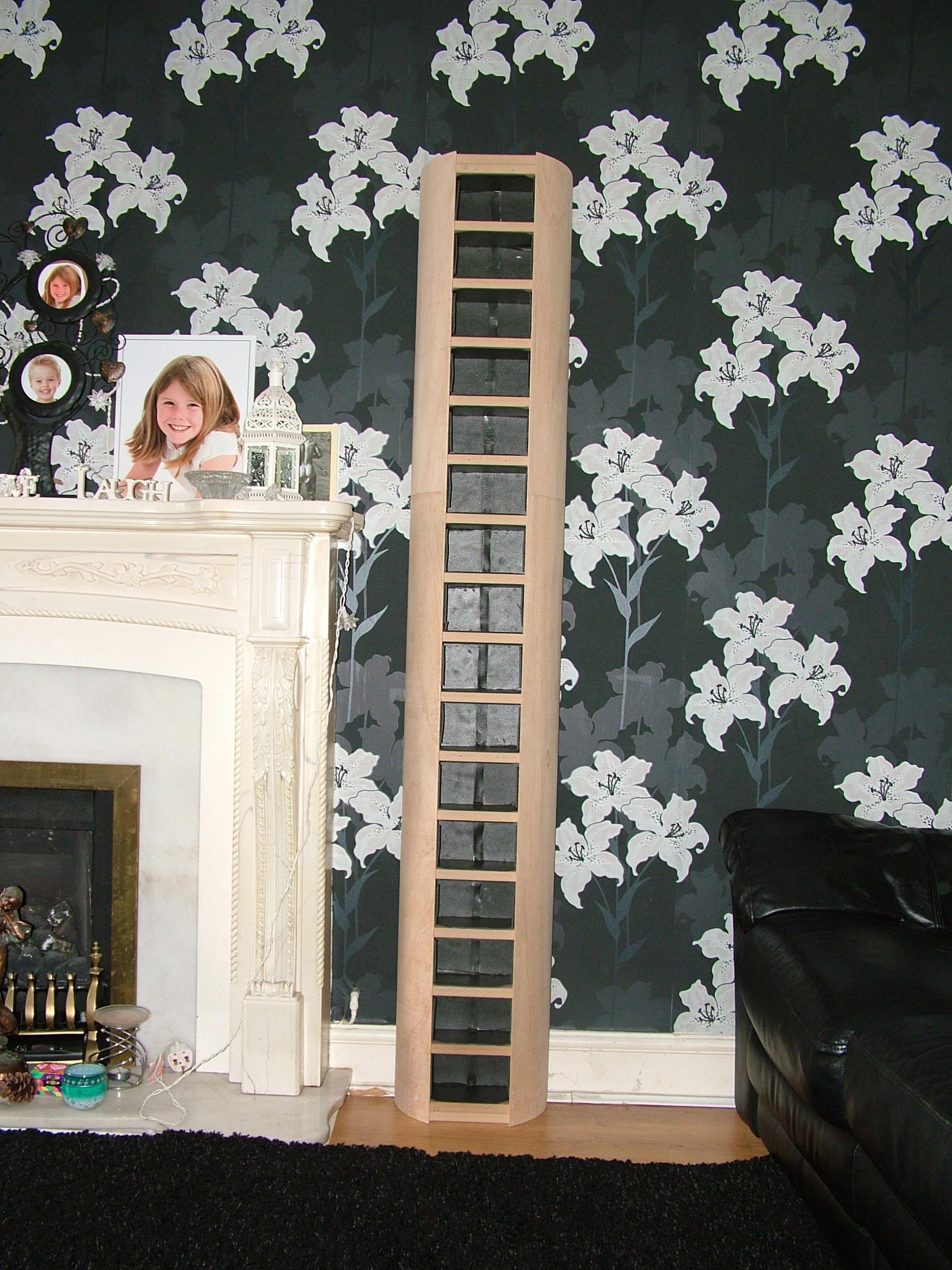

Here's a size reference, still 7 more chambers to go:
![size.jpg](https://www.rsr-concepts.com/diyma/size.jpg)
(my almost 7 year old posing beside the stack)
It's just a loose stack with m6 rods to prevent it from falling. As soon as I have the aluminium I'll start gluing.

My aluminium came in for the baffles and I've reached the highest point (on one speaker) today. Still a loose stack of ply:
![finalstack.jpg](https://www.rsr-concepts.com/diyma/finalstack.jpg)
These things are huge!
I think I'm going to seal the inside too. A bit troublesome to do that after all the glue-ing so I think I will use Por 15 clear to seal the insides. That way I can do the sections as I go and make sure everything is sealed.
