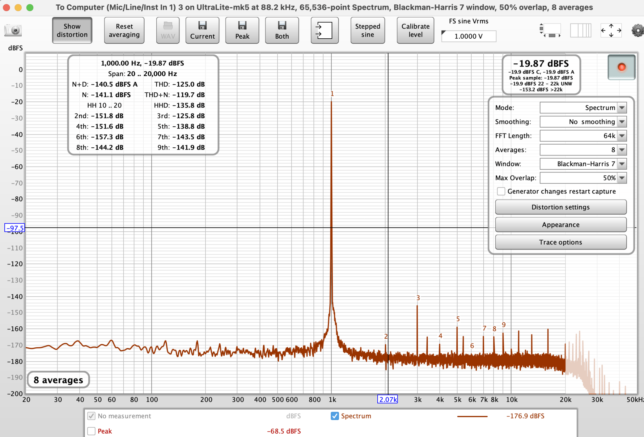

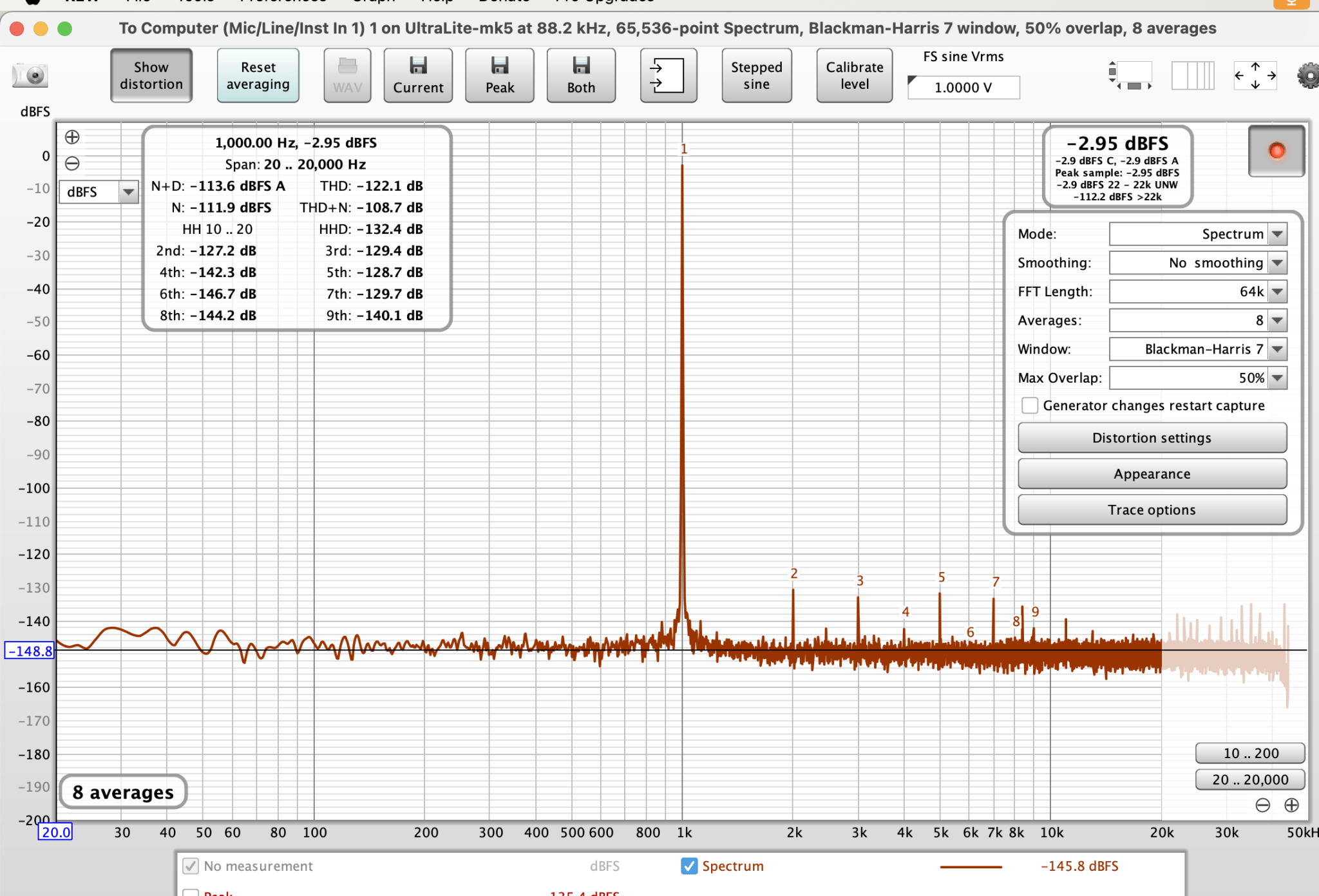

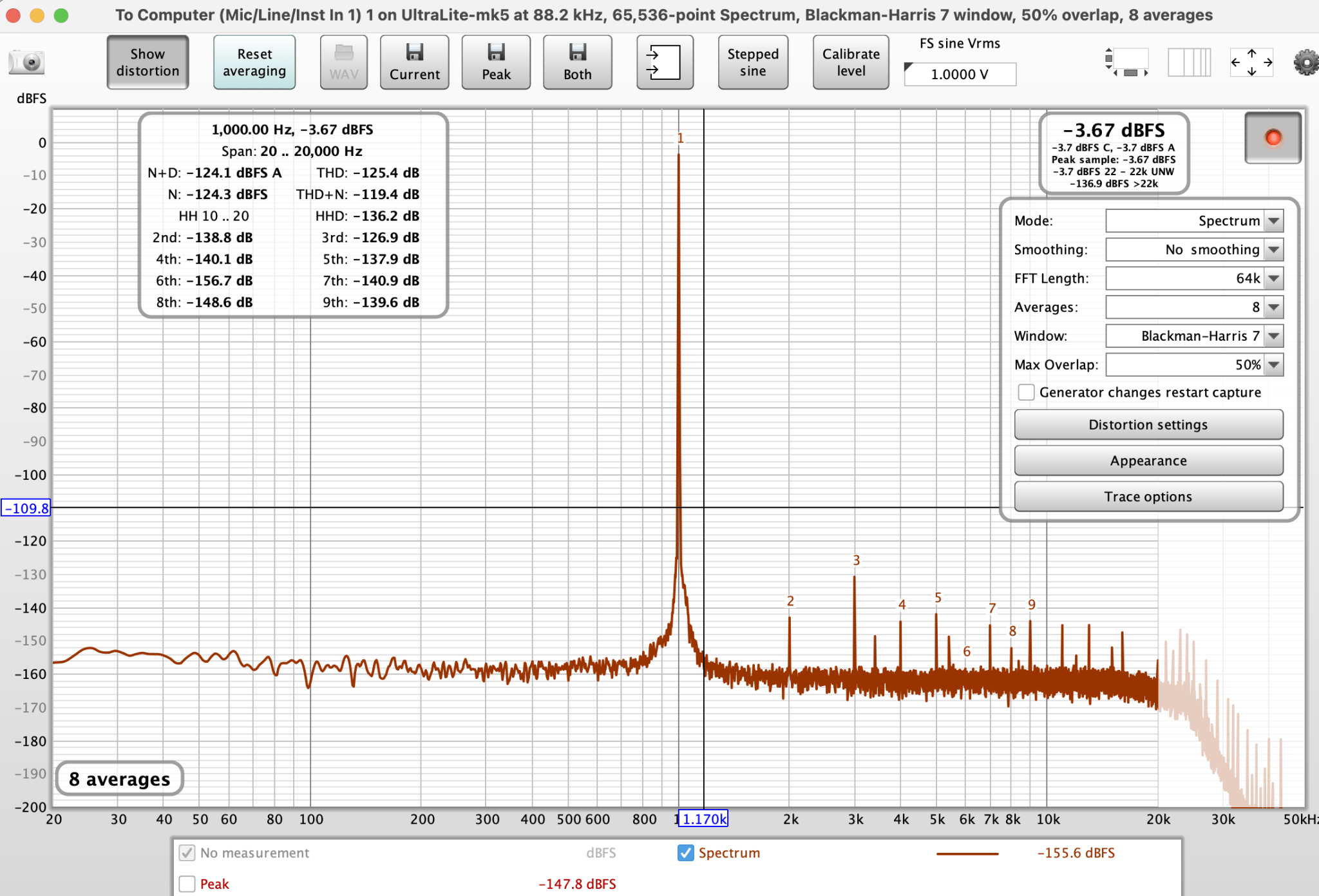

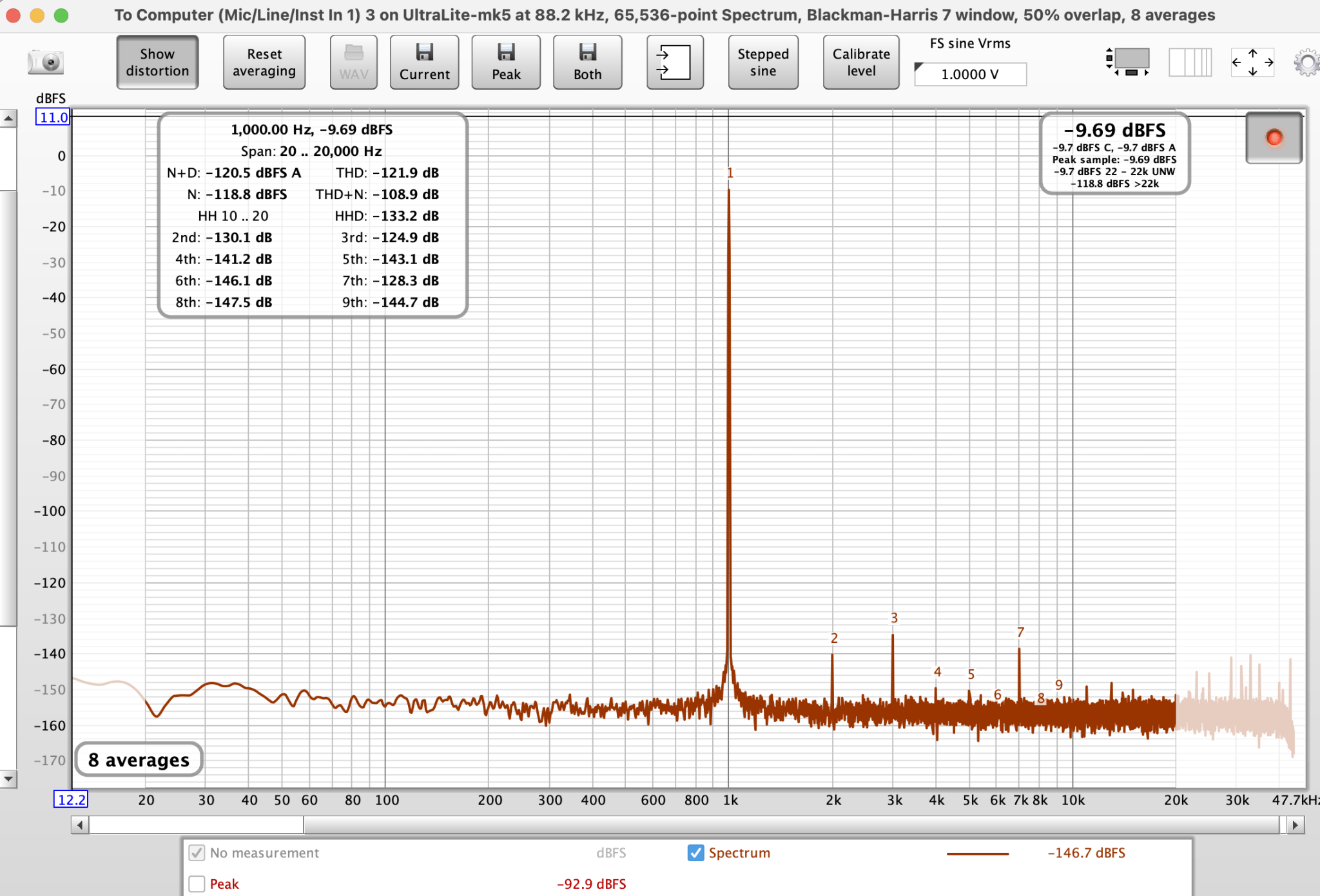

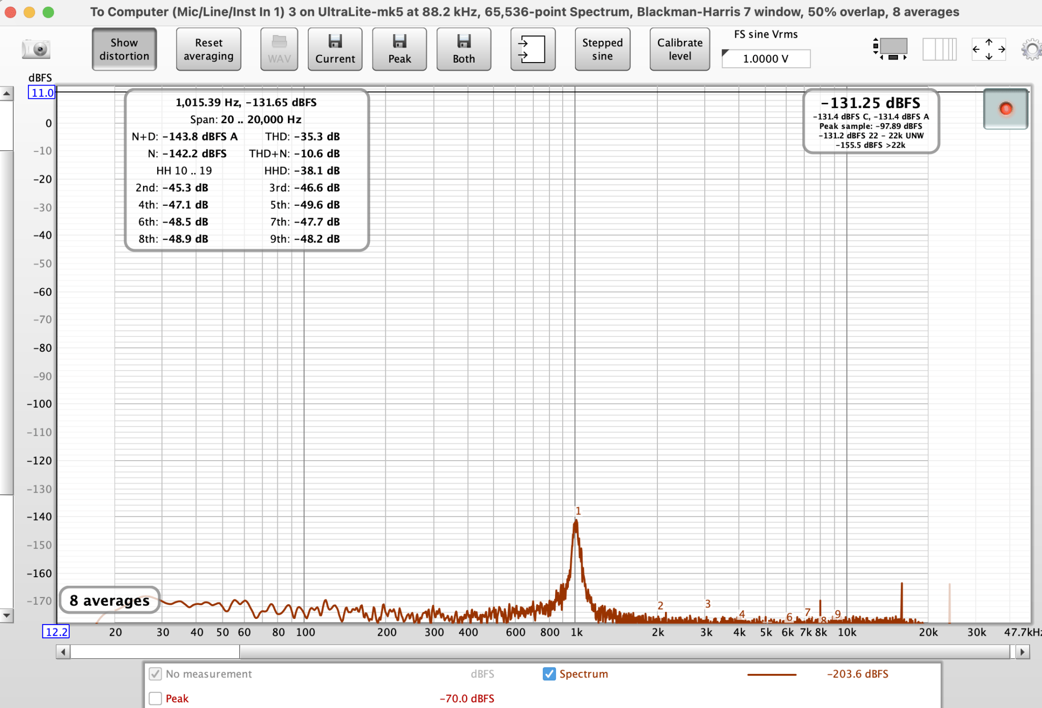

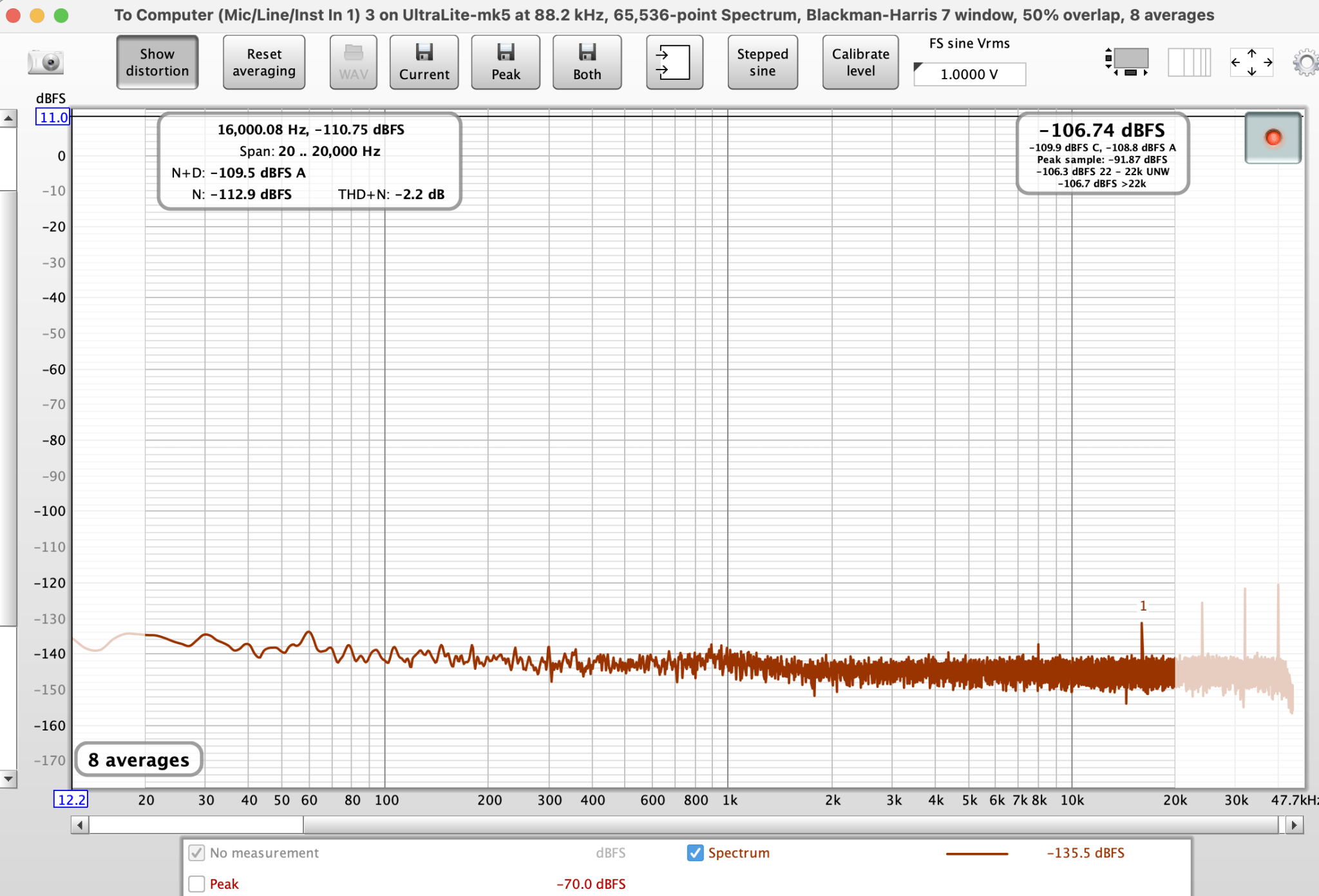

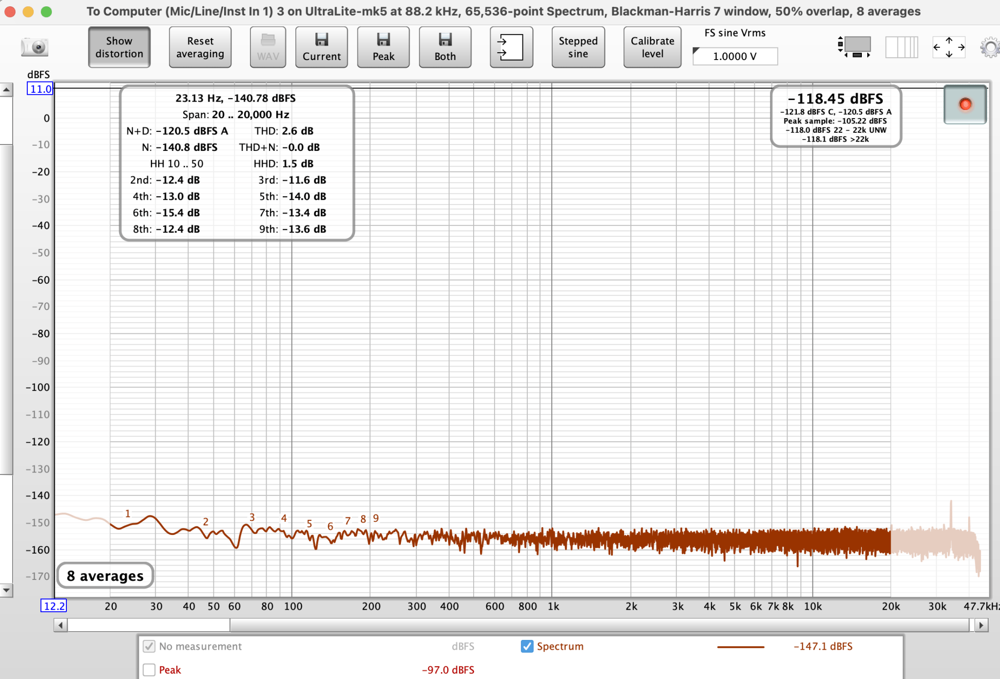

Sanity checking my setup... the results are consistent, though not sure where the high-ish H3 comes from (is it really from DAC or from APU).
I'm satisfied now I need a better DAC lol.
DO100 -> Motu UL MK5 (no signal)
DO100 -> Motu UL MK5 (~4Vrms, 0dbfs = 12Vrms)
DO100 -> Motu UL MK5 (on +2dB Mic input)

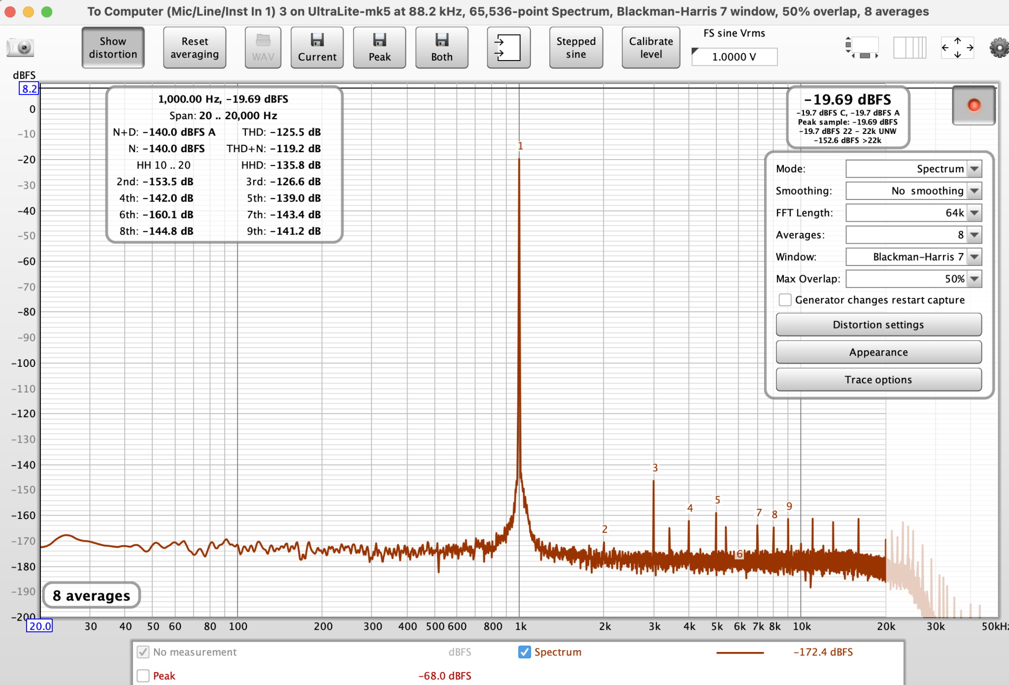

DO100-> Cosmos APU 1kHz notch (0db) -> Motu UL MK5 (Without CAL file)
DO100-> Cosmos APU 1kHz notch (6db) -> Motu UL MK5 (Without CAL file)
DO100-> Cosmos APU -> Motu UL MK5 (With CAL file)
Same but with the other DAC channel
DO100 -> Cosmos APU -> Motu UL MK5 (on +12dB Mic input)

I've tried the following: compared XLR and RCA outs, RCA L + inverted R used as balanced out (usually it should produce better graphs compared to XLR outs with my DAC), run both DO100 balanced outs simultaneously, run the measurements on my windows laptop, feed the signals on APU preamp section, also checked Archimago's DO100 measurements with the APU. The H3 only goes up substantially (compared to other harmonics) when being fed on the notch section, not sure though how much dB. Nothing much to do other than waiting for the opamps (around 2 weeks)
D
Deleted member 148505

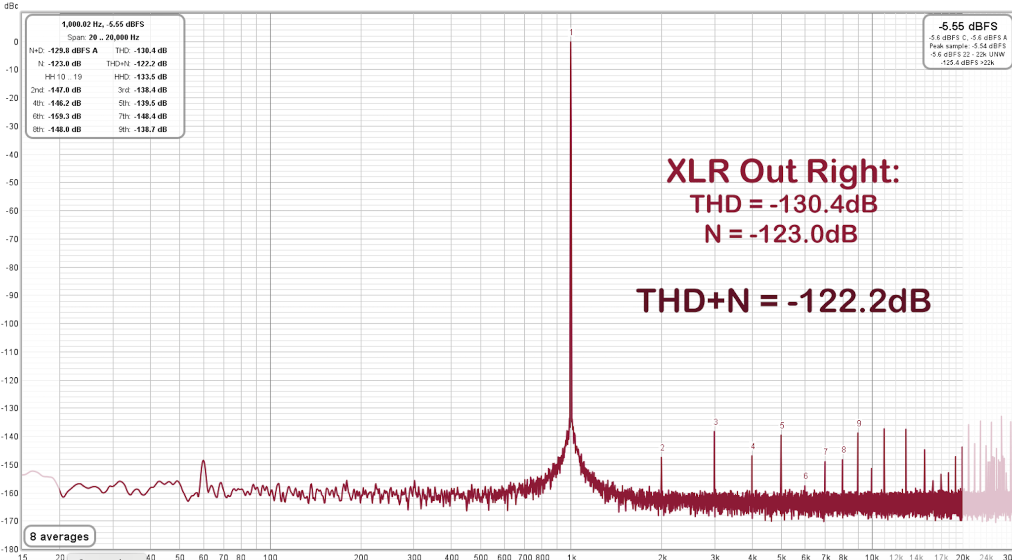

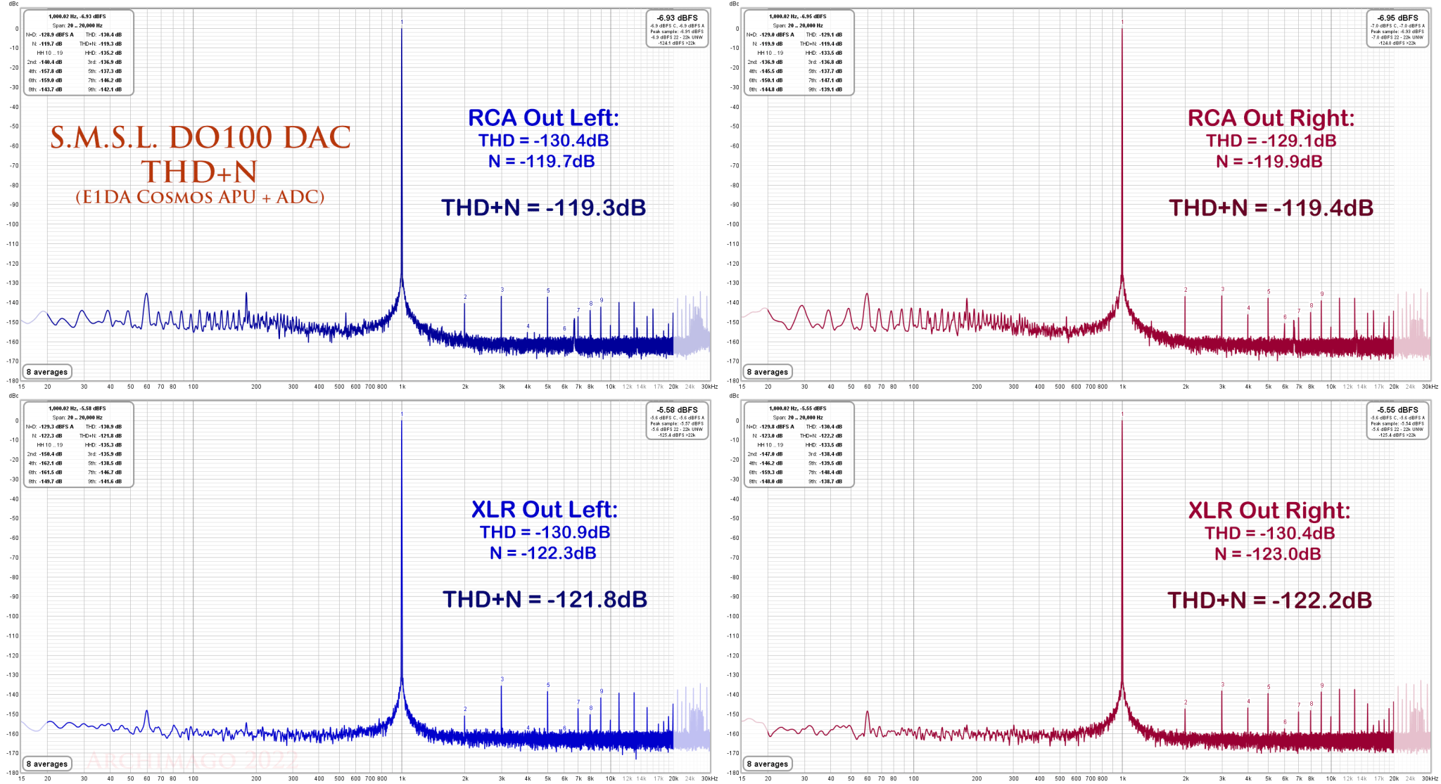

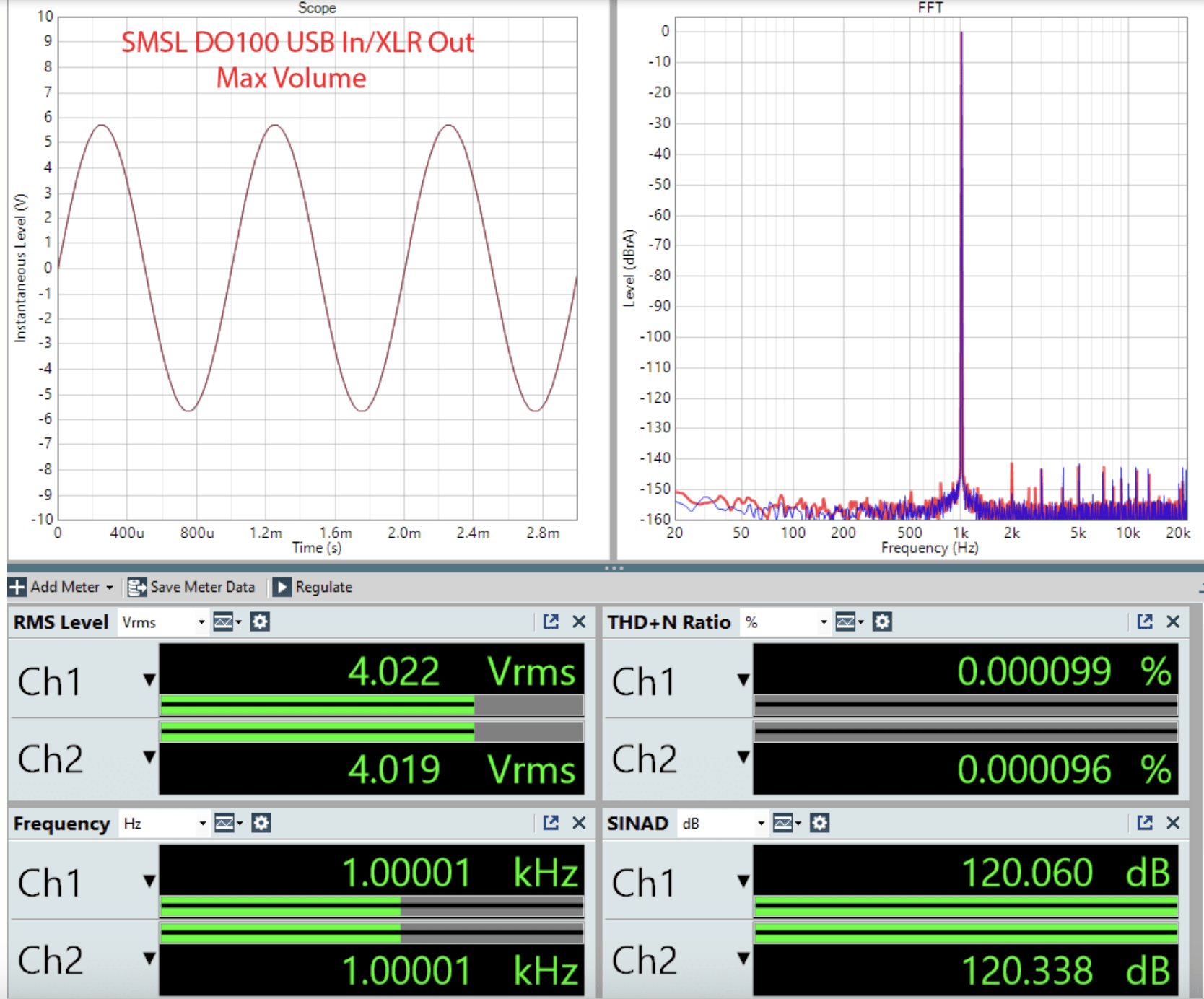

Yes, SMSL DO100 DAC, either the DAC that I received has a subpar performance, or the Cosmos APU with me is. Based on ASR's review and Archimago's review, DO100's H3 shouldn't veer away much higher compared to other harmonics. Unfortunately, I don't have a generator here that has an ultra-low THD like Victor's osc, so it's only my speculation for now unless I try to change the APU's opamps to confirm.
Notice that my measurements are almost similar with Archimago's, except for the huge H3.
DO100 ASR's
DO100 Archimago's
Most if not all of Archimago's DO100 measurements have an H3 that is always better than -132dB.
Sample below has an H3 not much worse than other harmonics.
I can't get H3 better than -126 to 127dB. Other harmonics are superb.
My measurement below.
DO100 ASR's
DO100 Archimago's
