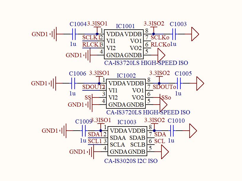

Yes, much cheaper compared to the MAX1443x/MAX2216x I use but with diy stuff economy is not a top priority. One possible problem with your setup is that part-to-part skew is much higher than channel-to-channel skew. So separating I2S signals to 2 isolators may cause unexpected timing issues.I'll check 768k later, regarding the economy you can see the reason - the trafo is cheaper:

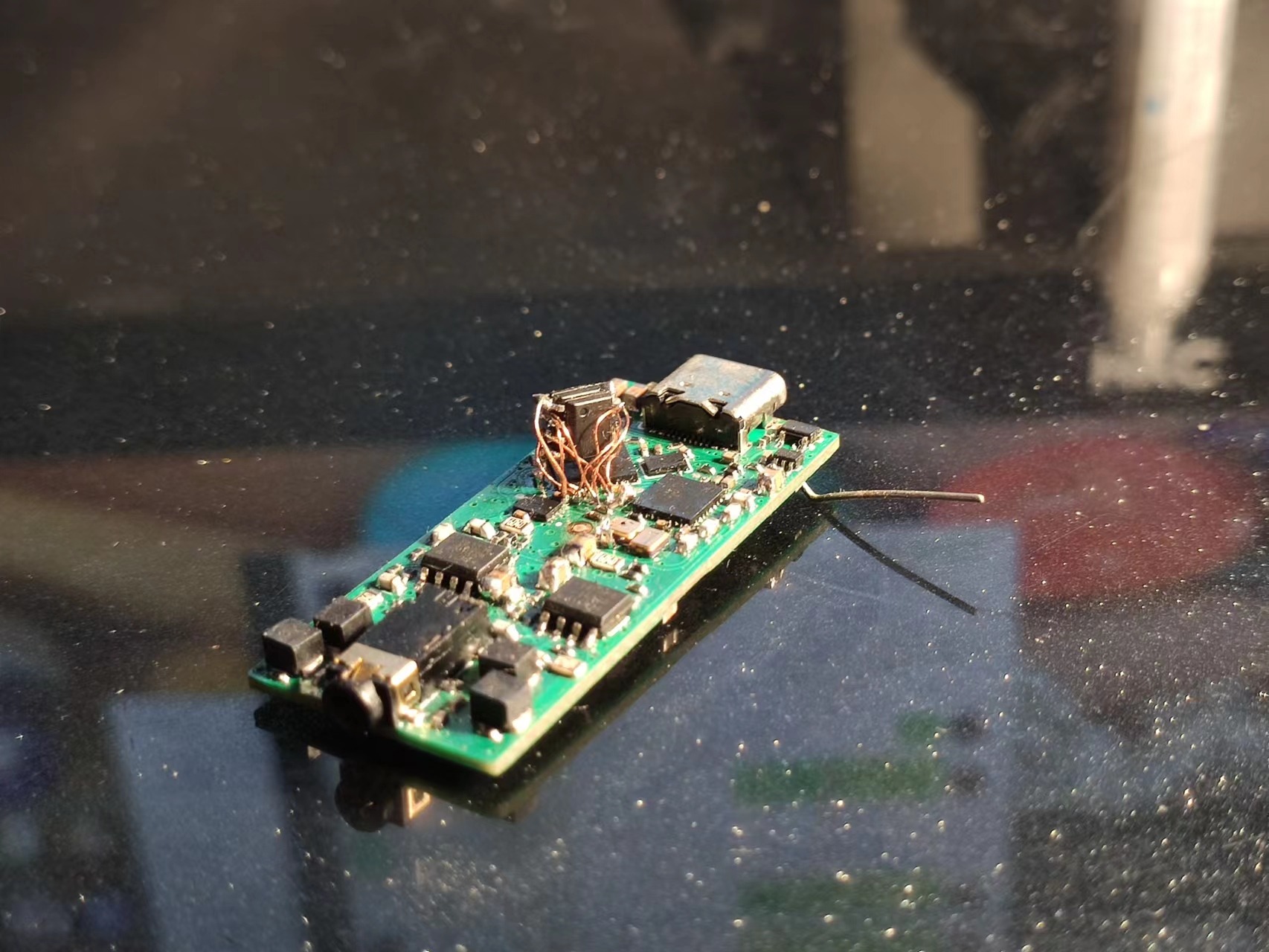

right, I didn't find any comments about the sync mode in the ES9039Q2M.pdf at all. My protos usually not too neat after massive rework was required after tests. For instance, this is the proto where I tested 150Mb/S ISOs.that is not necessarily true with at least some of the ESS converters!
I re-tested my AK4493 and ES9039Q2M (sync mode) dacs. MCK phase did not matter for either so results were the same if MCK was passed through isolator or fed directly to MCU. What mattered most with both dacs was the timing between BCK and LRCK. By tuning the series termination resistors on both lines I got various results: correct data, garbage, correct data but with swapped channels, correct data but on both channels. AK4493 seemed more lax but ES9039Q2M is very picky at 768k/705k6.Well, I used to think so too. And with AKM converters it is stated in the datasheets that the phase of the MCLK is not important. E.g., from the AK4490 datasheet:"MCLK should be synchronized with LRCK but the phase is not critical."

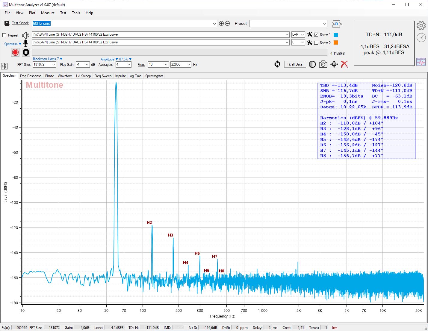

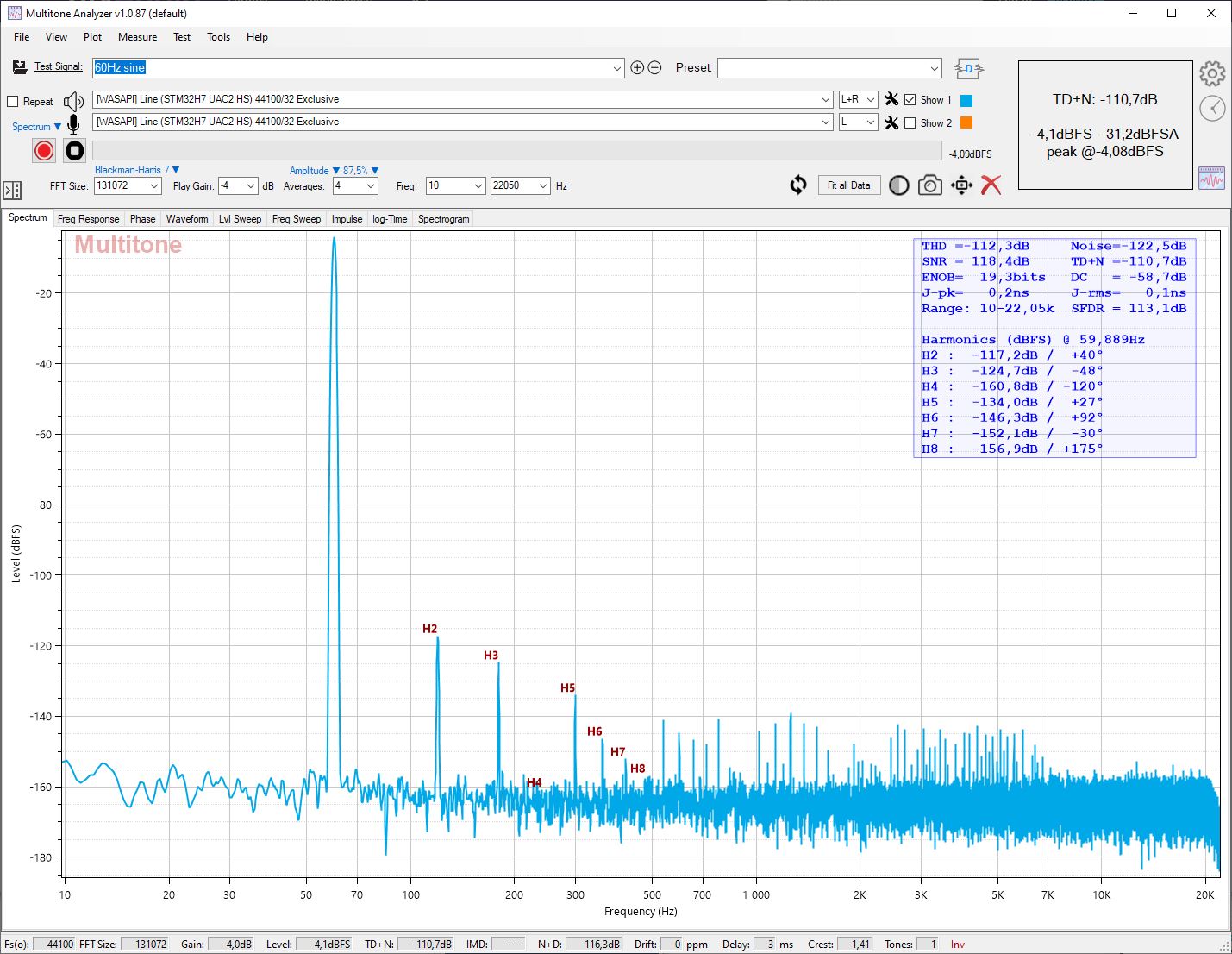

Your 1st problem is not a real problem looking at the results. Attached is ES9038Q2M 60Hz with PCM vs DoP64. With ES9039Q2M results are similar.Two problems with that thinking...
