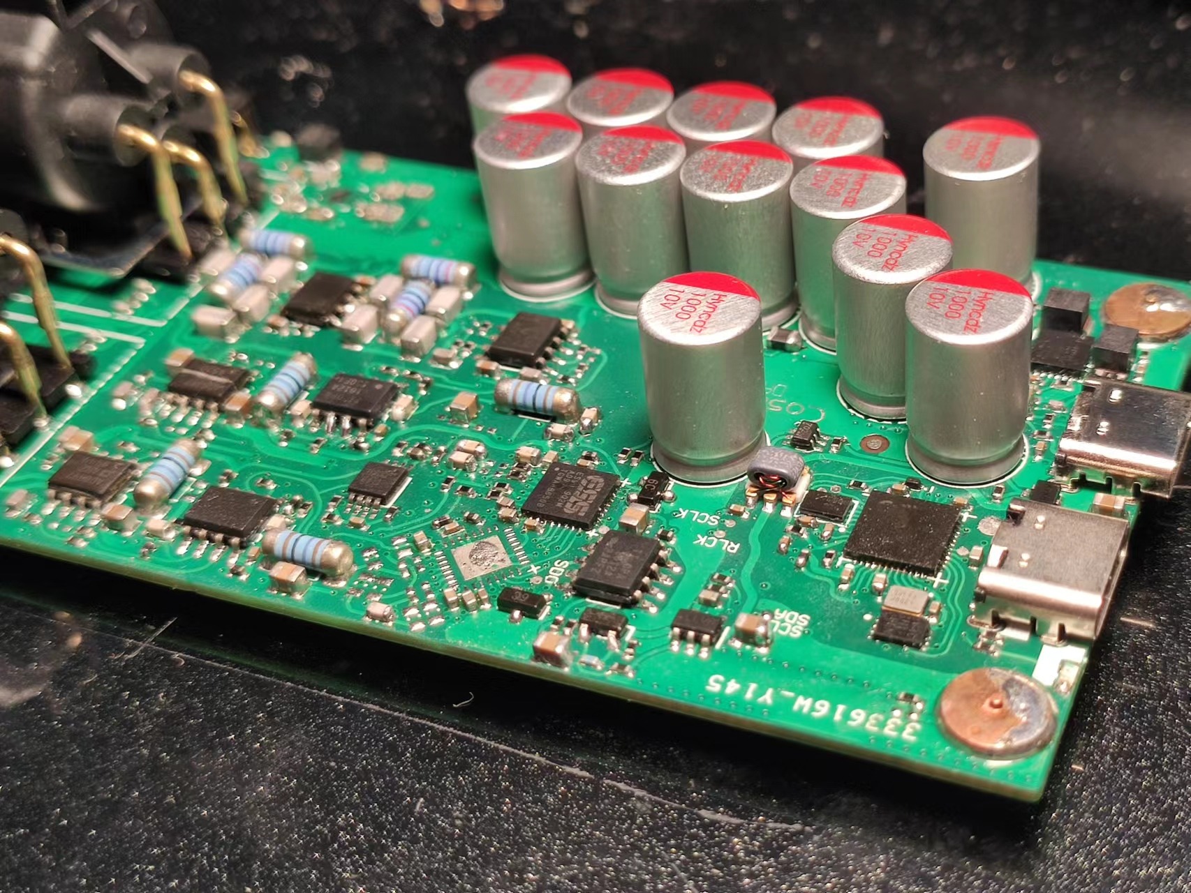

A couple of days ago I noticed that during the calibration Cosmos ADCiso has no green/blue/red LEDs indication, in about 30% of cases.
I decided to retest all Cosmos ADCiso that I prepared to sell and found the same over there 30-40% of units have no LED indication at all, at least until units are cold. In my area right now pretty unusual "cold" days 23-25C, and that may explain why prepared to sell and tested at 27C units are glitching. The fact that no one so far complained about the issue even more surprised me. After couple of days I found the root cause and FW solution to fix the issue. Technically, I know the folk over here may understand what I mean, the I2C isolator chip adds 100nS of delay or 200nS round trip delay, and correctly implemented 100KHz I2C interface has 100.00% zero chance of getting any trouble with that. Even 10x times longer delay can not affect the stability, if.. I2C implemented correctly What happening with the hardware-implemented I2C of CT7601 from Comtrue, when the ADC unit is warm the delay becomes <200nS and I2C works, however, a cold enough unit slightly increases the delay, and CT7601 I2C interface starts to lose acknowledges! Data becomes corrupted and LED's indication doesn't work. Perhaps Comrtue's I2C reads an acknowledge by mixed-up pulse edge, for example, the issue is easily fixable by adding the 47pF capacitor to the SDA line. A +/- few tens of nS are able to turn over so implemented I2C. Of course, I asked Comtrue for help because no one HW I2C register is documented in the supplied datasheet but Comtrue has been silent so far. Finally, I decided to switch I2C to the software mode, Comtrue's source has such a switch but.. that code for sure never tested at all because it had a lot of principal mistakes. So, I debugged of SW I2C and the interface started to work as supposed to be, the only data rate was way too slow 20kHz. Hence, I had to optimize the code, after I'd omitted tonnes of function() called from another function() and this one was called from one more function(), and so on, I got 33kHz of the data rate. Anyhow, after two days I prepared the FW which fixed LEDs indication issue for Cosmos ADCiso. Nobody asked me, I have no idea why ))

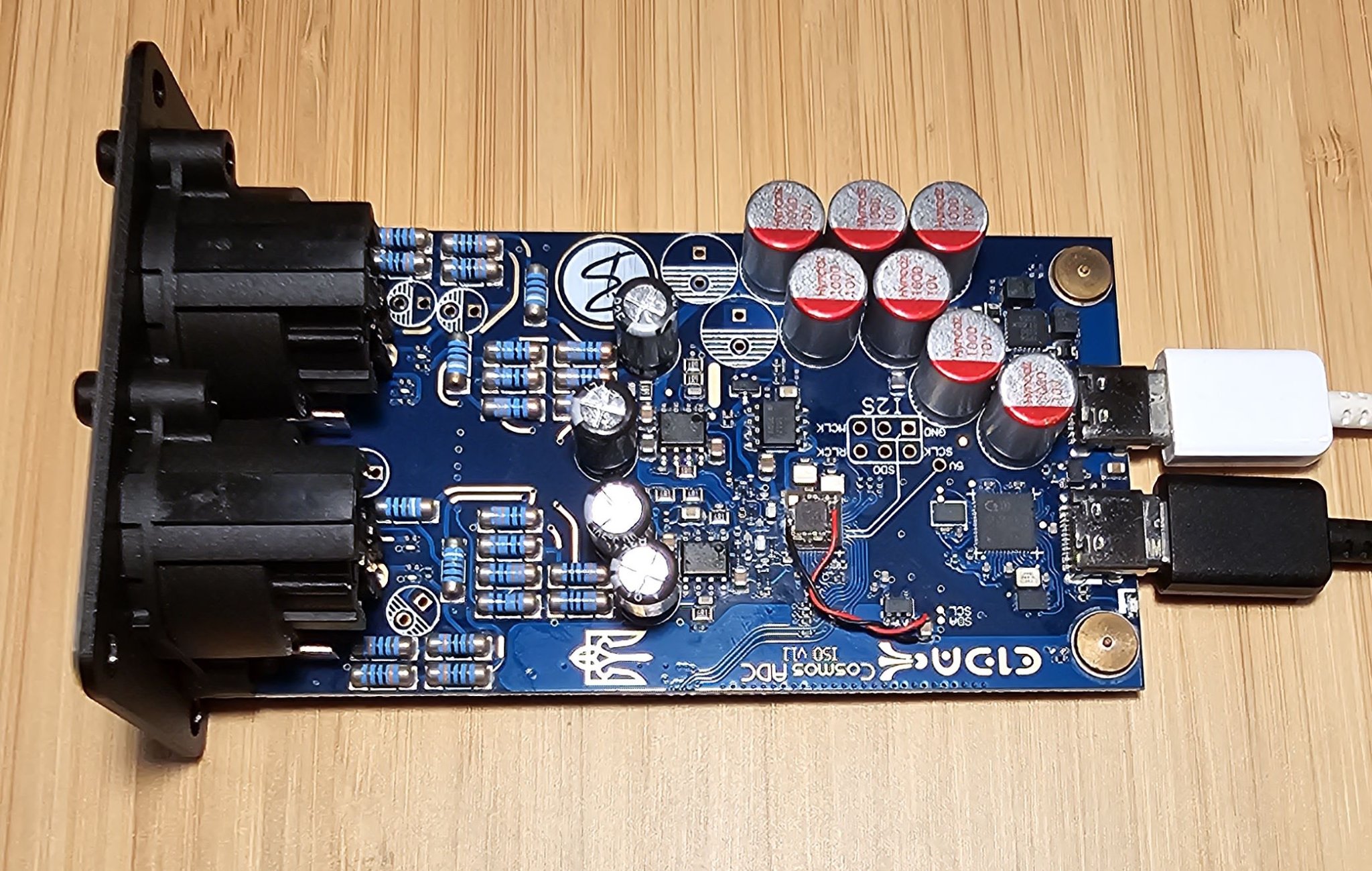

We are now able to measure reliably to -160 dBc levels for a very reasonable price. Here is measurement with APU and Cosmos ADCiso + thermostat board. Source is good signal generator with distortion < -150 dBc. APU was at default gain resulting with -10 dBFs for a 1.7 Vrms input signal.
ADCiso board with attached thermostat board.

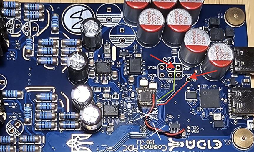

Well, guidelines are practically nonexistent. Nothing at your site and Google will find only an example with standard Cosmos ADC at ASR forum. It would be helpful to add links or instructions somewhere.
Now, even on my photo I can spot connection points, but with real board in hand, it is not immediately visible (especially for someone with age induced presbyopia).

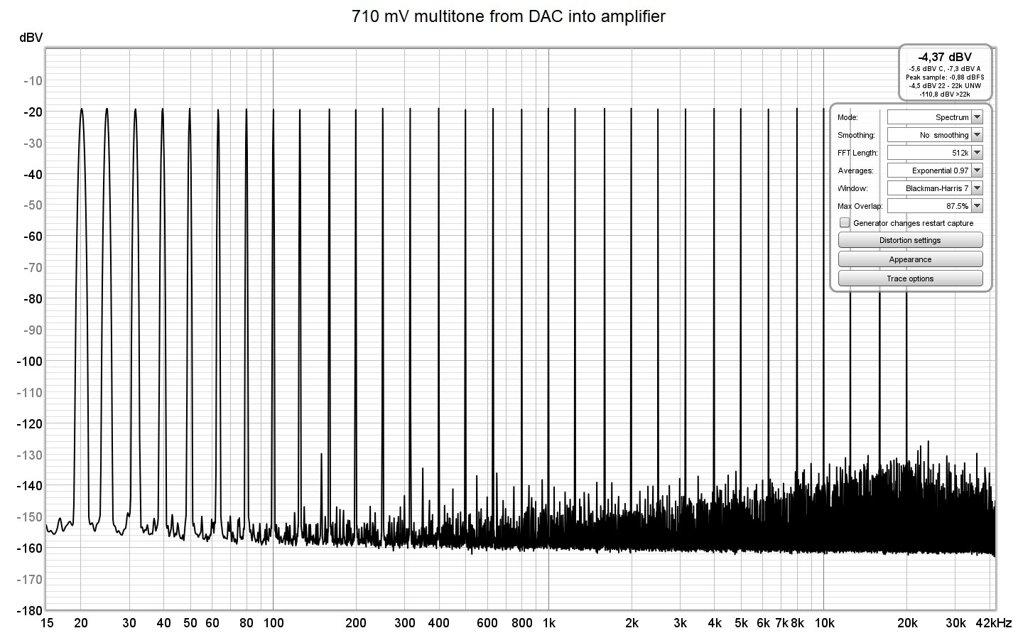

Anyway, I’ll use this for measuring amplifiers and multitone test for IMD tells all that I need to know. Only problems are that Cosmos ADC itself and DAC used as a signal source produce more IMD hash than measured amplifier.
This is 16 Vpp at amplifier output.

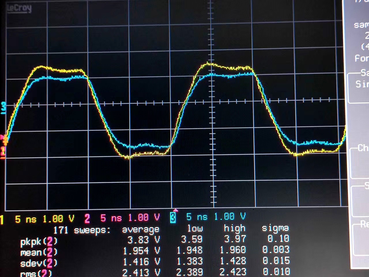

Are you referring to the propagation delay of generated I2S vs. MCK? If so how much is the propagation delay of CT7601?It is about the propagation delay which is 15nS max 12nS typical of my 150Mbps ISO IC. As I said, it is sync mode 32/768, so 15+15 = 30nS when the given MCLK period is 20nS.
