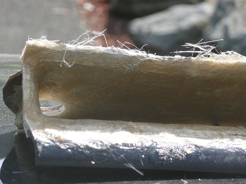

Here's a picture from USD's web site of the mold for the horn in what is likely the best-known installation in the history of car stereo competition:
This project will use a similar configuration. Instead of an uber-expensive compression driver, I'm going to find out if we can get comparable results using more practical components.
IMHO, the main reason to use horn-loaded compression drivers in the car is that it gives you enormous dynamics and it "equalizes" the path lengths.
For instance, if you put speakers in the door of your car, the pathlength difference between the left and the right will be a couple feet. With a waveguide under the dash the pathlength difference can be as little as 4" or so. That's the trick - it creates a center image by pushing the speakers very VERY far back.
![buick-waveguide-mold-plug.jpg](https://www.usdaudio.com/sw/cars/buick/buick-waveguide-mold-plug.jpg)

Here's a pic of the horn which I measured in the previous post.
If you compare this to the other horn, you'll notice a few things.
The throat is 1" across. In the previous horn there were four holes, each was 1/2" across. So the area is identical.
That's about 15" across. Still need to paint and finish it.
In the side view you can really see how shallow it is. The whole thing is just over six inches deep. That allows me to cram it waaaaay under the dash. Also, the midrange is completely mummified in fiberglass and clay, to seal the basket.
![aug21-1.jpg](https://lh6.ggpht.com/_wUDOCViv9D0/So3gvJcoHpI/AAAAAAAABCs/LYWFGC0dRek/s800/aug21-1.jpg)
- There's one hole instead of four. I'll explain why I did this in the next post.
- The midrange is much closer to the mouth of the horn. Note that the hole is still close to the back. The location of the midrange is practically irrelevant, it's the location of the throat that matters.
- Due to the shallower depth, I can push this all the way under the dash. You wouldn't want to do that with a tweeter, but since we're only playing up to 2khz, we can get away with this.
![aug21-2.jpg](https://lh6.ggpht.com/_wUDOCViv9D0/So4DhqLZG9I/AAAAAAAABC8/K2pdyHuto9I/s800/aug21-2.jpg)
![aug21-3.jpg](https://lh3.ggpht.com/_wUDOCViv9D0/So4DhpNGoZI/AAAAAAAABDA/ISEGNF5mwe4/s800/aug21-3.jpg)
![aug21-4.jpg](https://lh4.ggpht.com/_wUDOCViv9D0/So4Dh81SSMI/AAAAAAAABDE/x3d6mwWyzfw/s800/aug21-4.jpg)
