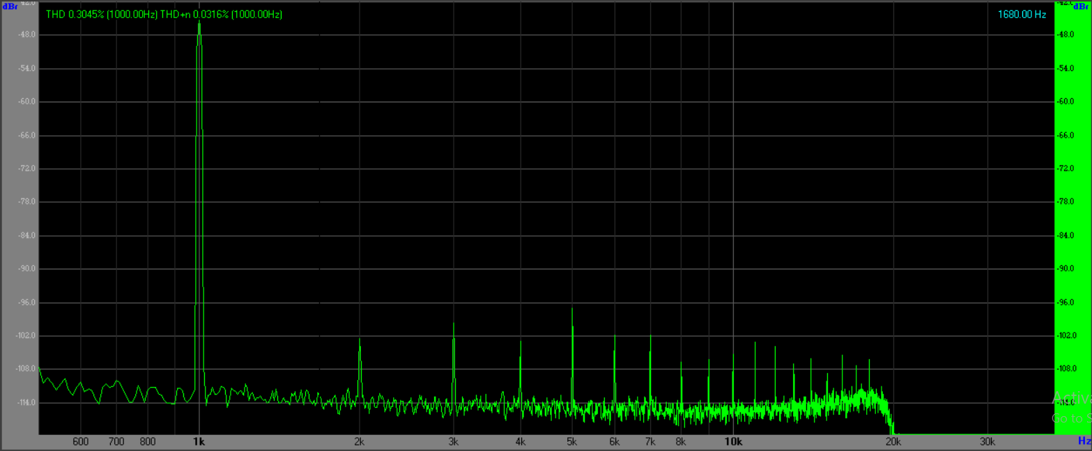

The DIYinHK board came with 150uf caps for both noise reduction caps, they should really have a value ratio of 1:10 and shouldnt be that high, a trace got damaged when replacing these caps and one NR cap wasnt actually connected, this is what was causing the distortion of passive IV seen in post 179.
It was the other, undamaged channel being measured in post 180 when it gave that low distortion.
after fixing the trace both channels now look like that.
Also The DIYinHK board has spares pads for each pin, but it turns out for spare pads at the MSB trim pins arent connected to anything. Still, noise is probably too high in the ADC to trim it anyway.

diyinhk capacitors are not in 1:10 ratio and they have to be, another thing is that there is an active filter after the I/V output, it is dual opamp of which 1/2 is working as an active filter, it significantly affects the sound (for the worse), I do not recommend that filter

By increasing IV resistor to 5k now there is something usableand with plenty of headroom to increase gain further, ADC noise is still dominating.
Hi, I’m a beginner so it’s quite difficult follow this thread ... could you explain a little bit these results? Are the equivalent of the SINAD test on Audiosciencereview?
So this board has more or less 108db sinad and a 0,3%THD (it’s quite high, it isn’t?)?
