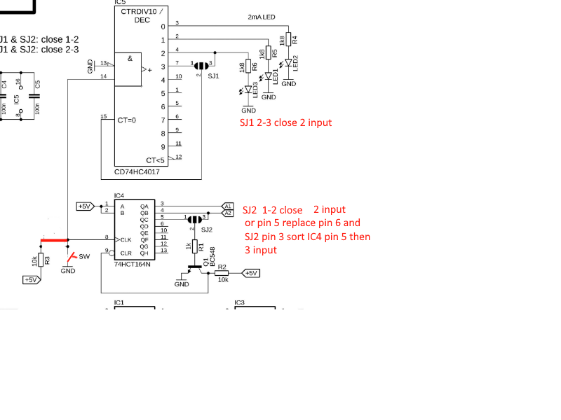

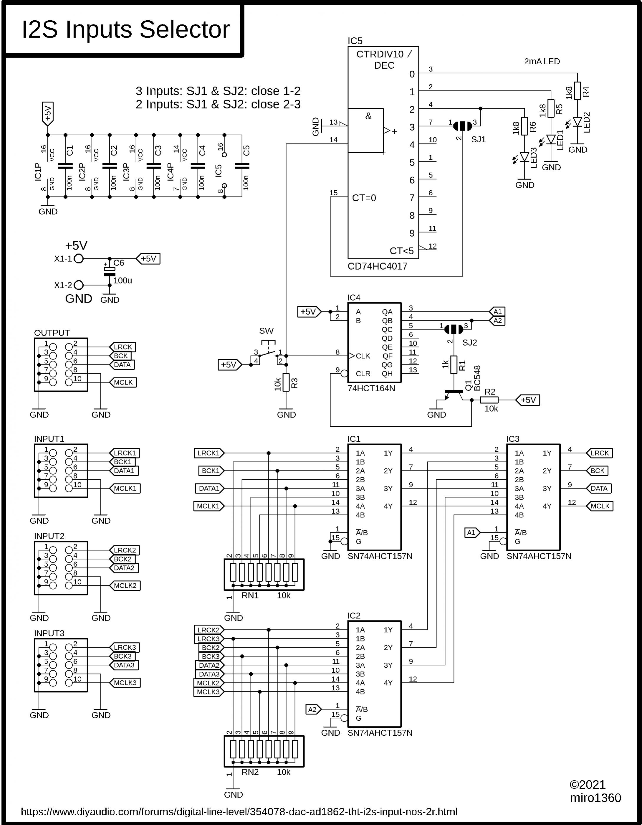

Pin 8 of IC4 can be lifted and connected to the GND with 10k resistor and R3 will be shorted.
Here is the corrected PCB.
You are correct, what a mistake

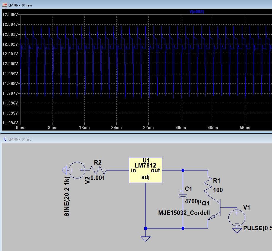

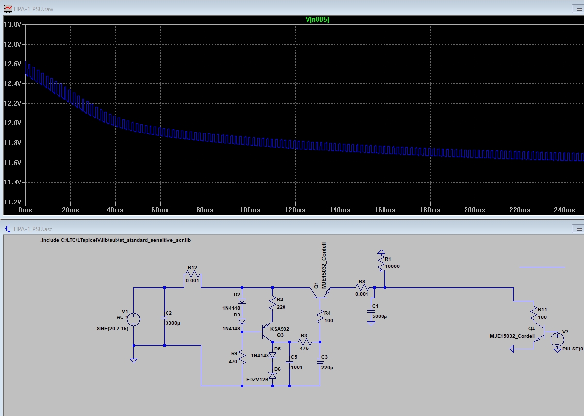

The power supply should not be too loose, nor too tight in regulation. John Curl told me it needs to dance with the music, if it makes any sense to speak in such language. I think John meant he thinks moderate regulation sounds better for some circuits.
Under 120mA pulse load it has some voltage dance.
In comparison the 7812 regulator under the same load is pretty clean
