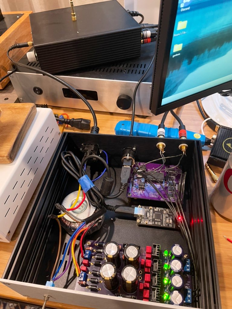

KF, nice build! It looks like maybe you have some firsthand experience with the Soekris dam 1021? I would be interested to hear your subjective impressions between Miro's design and the Soekris stuff -- especially with the AD1862 chips if you get around to it
Yep, that's a dam1021 based build in the background. I built it a few years ago. It was my "main system" dac up until the little Khadas Toneboard I was using at my computer for day to day stuff died. It then got moved to my desk and it'll go back to main system duties now that I have this AD1865 build finished. There is an amanero i2s interface in the dam1021 build and an xmos one in the ad1865.
I mostly use a variety of headphones with a ton of DIY amps I've built over the years. Truth be told I can't hear any significant difference between the two, certainly nothing large enough I could easily pick it out. They both sounds great to me and are noticeably quieter than the ALC1200 in my PC. Both are dead silent and have a black background.
I'm super happy with both of them and they're both fun builds. Sokris is also a great person, super helpful. Just like Miro
