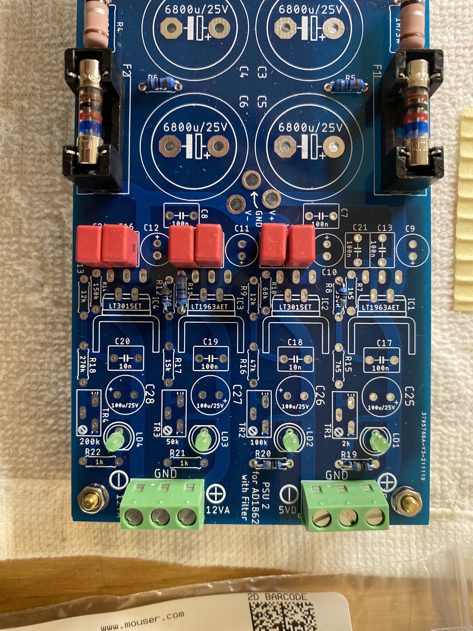

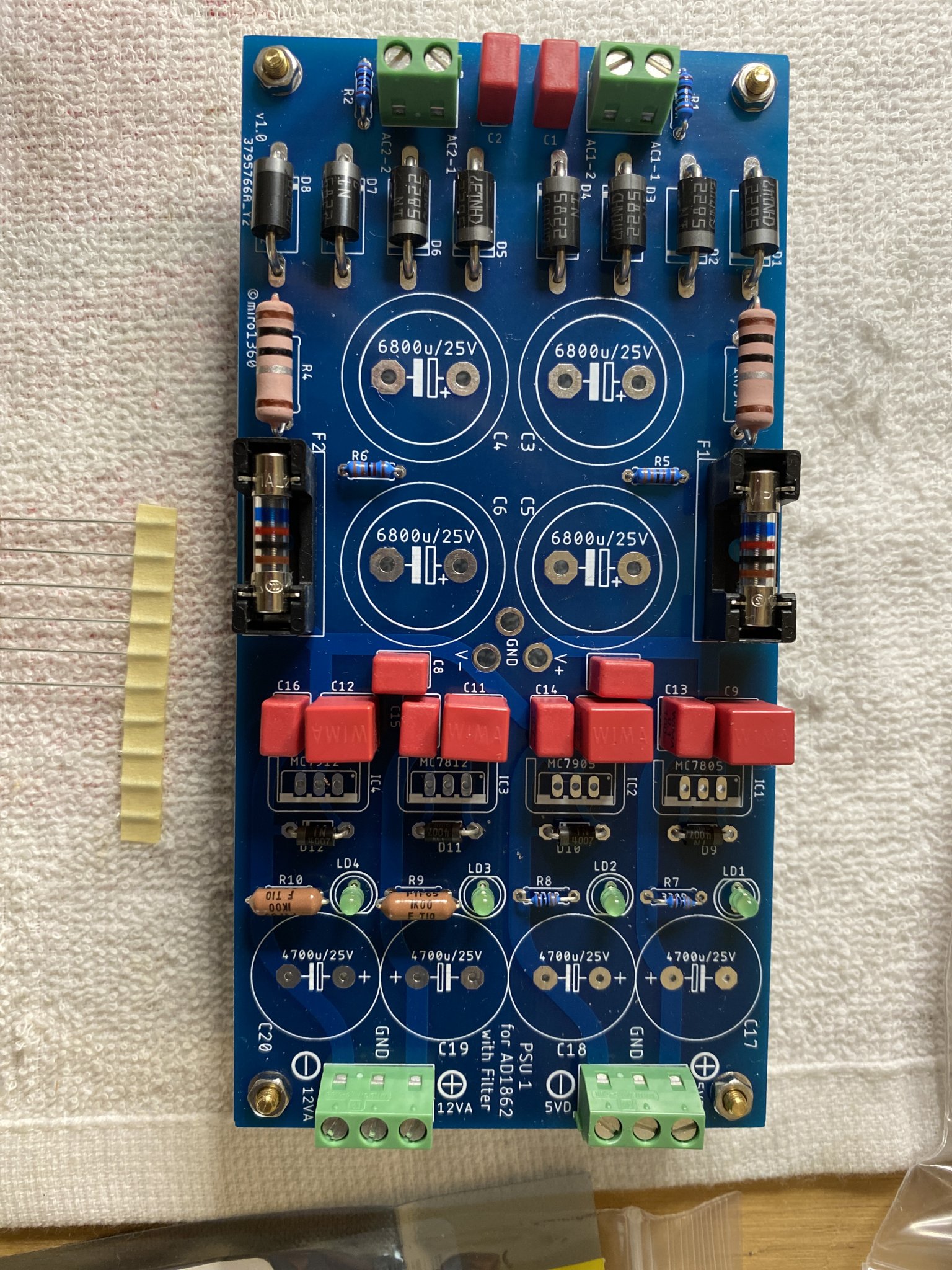

I’m currently building up a psu1 and psu2 for an ad1862 dac and as usual I’m uncertain about ordering something to replace an “out of stock “ item as recommended on the bom. Psu2 calls for a Panasonic 100uf/25vdc capacitor at locations C9-12 and C25-28. I’m slowly becoming familiar with the data sheets and one thing that stands out is the ripple current rating. The panasonic is around 450ma which is much higher than most of the other capacitors that are in stock. So this is my long winded way of asking for a suitable replacement. And of course how critical is ripple current in this location?I reached the limit of 10000 characters in the first post and I am unable to continue with further editing.
