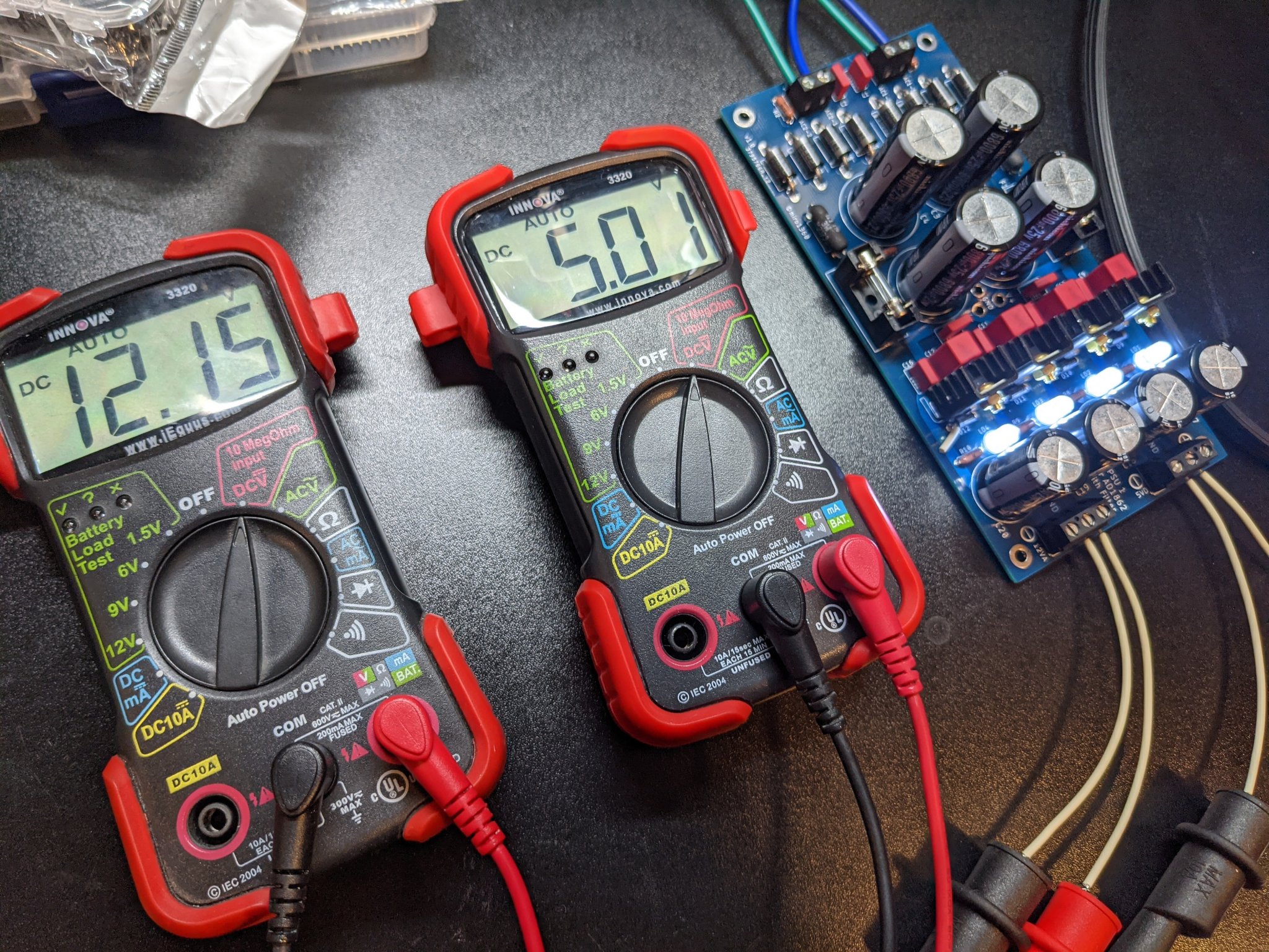

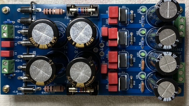

@flak monkey nicely built PSU 😉

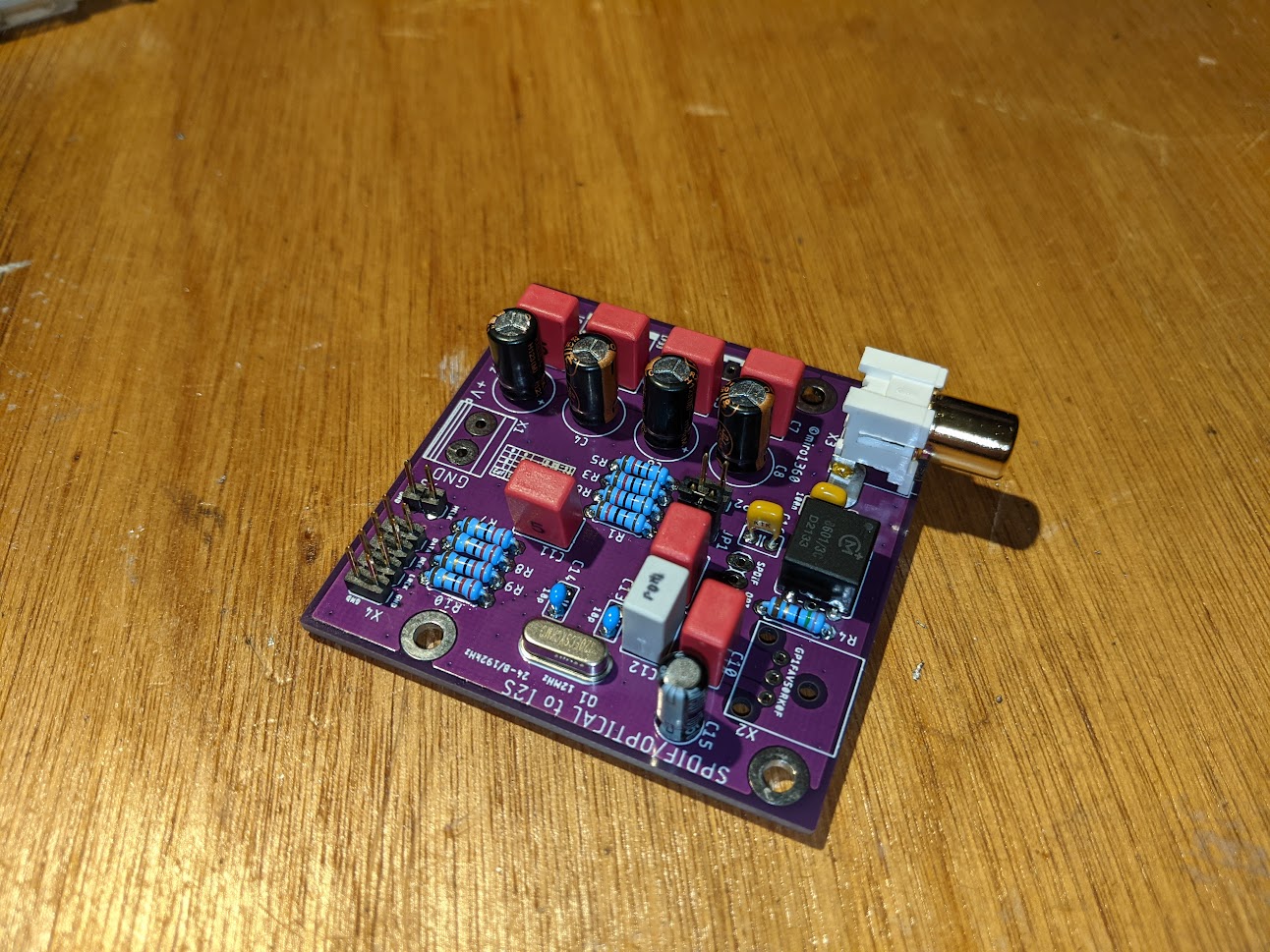

I2S selector is not updated, you need to follow the errata 😁 ... I am looking forward to see the progress with your purple setup 🤩

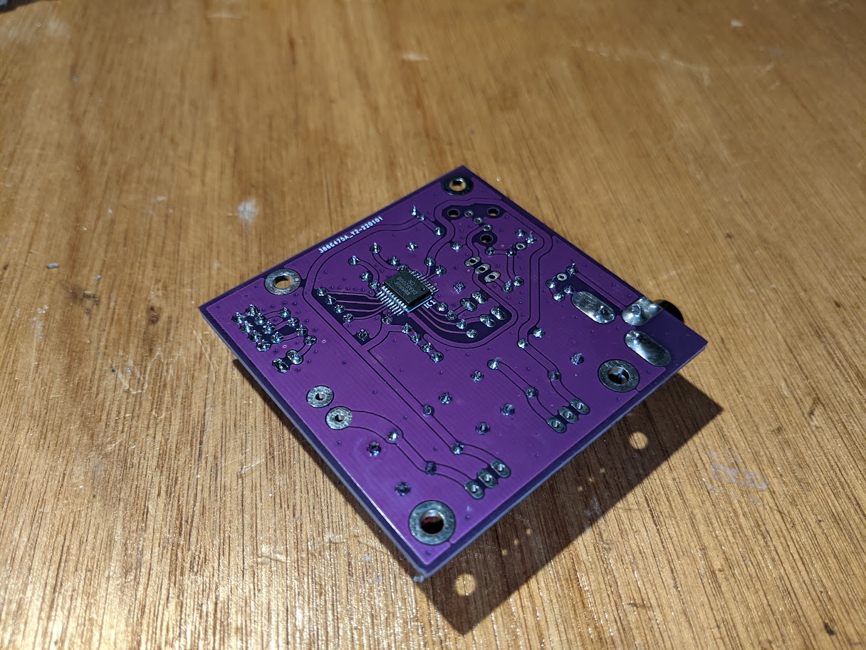

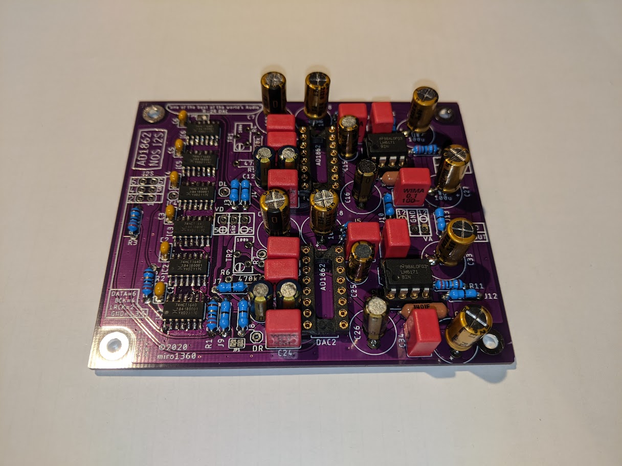

Thanks! Getting on OK so far with assembly. That WM8804 is a fun soldering job! Other than that, so far so simple....@flak monkey nicely built PSU 😉
Just waiting for the last few bits (3.3V regulators, 3.3v optical input) that were out of stock at Mouser and the AD1862 chips to arrive - then I should be able to run some preliminary testing.
![Built DAC.jpg Built DAC.jpg](https://www.diyaudio.com/community/data/attachments/921/921929-2c6a711e18dd273442285655f4dd82c9.jpg)
![Build I2S Converter.jpg Build I2S Converter.jpg](https://www.diyaudio.com/community/data/attachments/921/921930-7d4ab59d72cc7c6831d3b8a108d158f7.jpg)
![Build I2S Converter back.jpg Build I2S Converter back.jpg](https://www.diyaudio.com/community/data/attachments/921/921927-21c6d5088fd3ab79ba2cf71665581943.jpg)

Regarding PSU 1:
Can I use a smaller led (LTL—4231N) at LD 1-4 locations? If so, are there any changes to the resistors at R7-10? I just don’t want those led’s to be too bright.

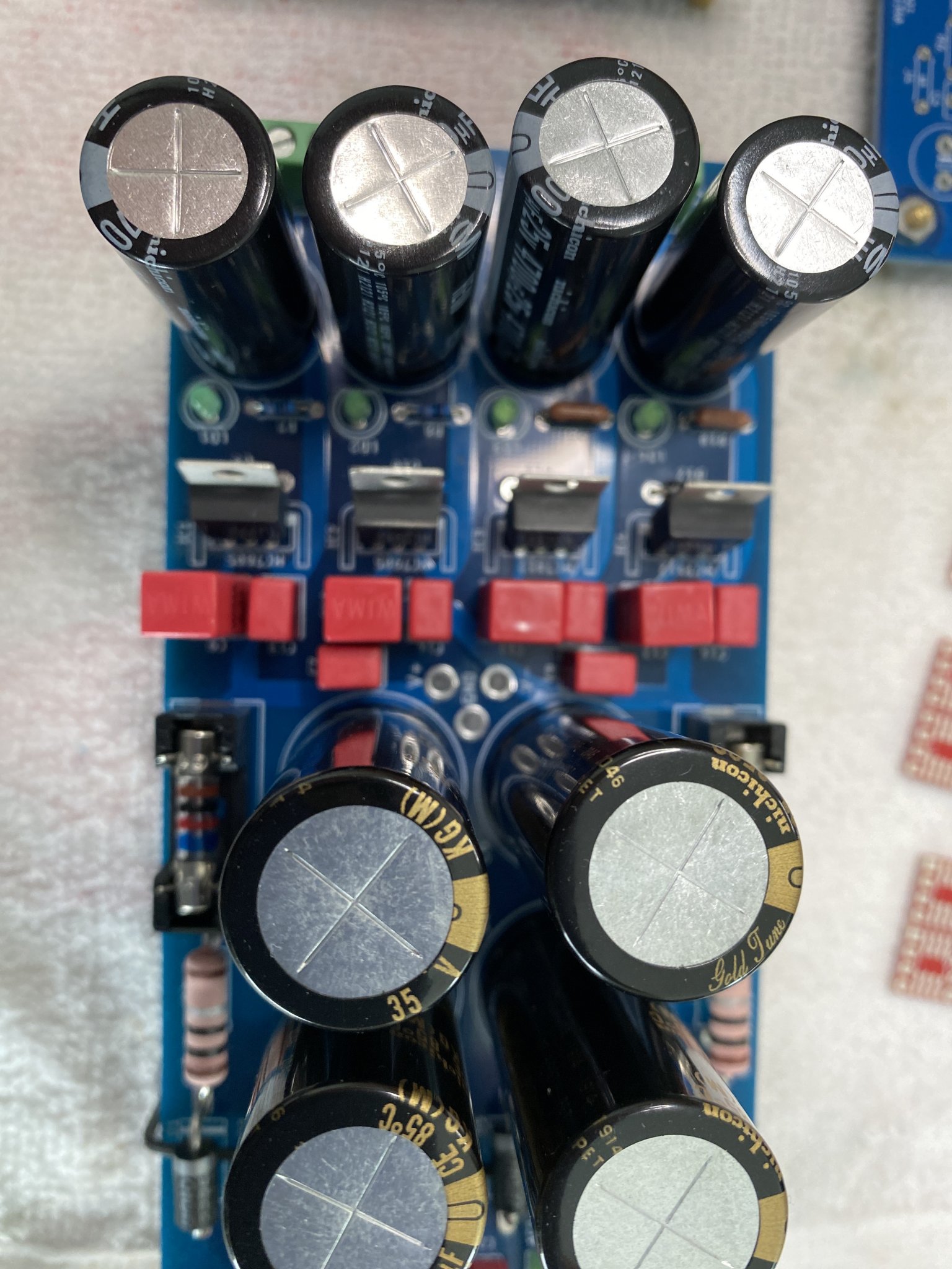

Making progress,Regarding PSU 1:
Nothing soldered, just a mock up.

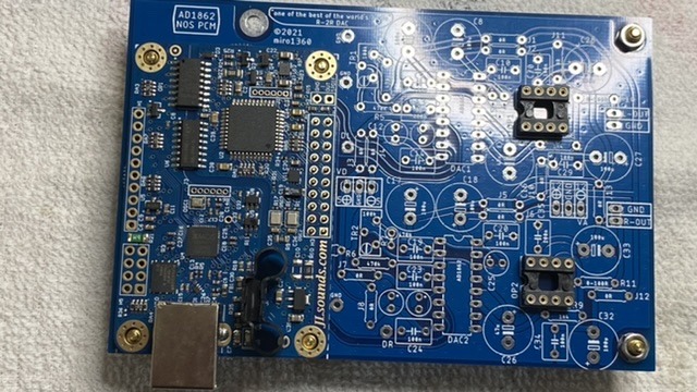

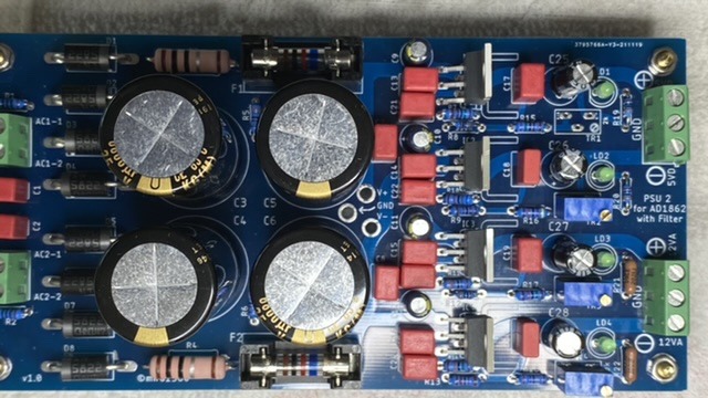

psu1 , psu2 and dac with jlsounds. Psu1 one is complete. Psu2, can a 2k trimmer be used at TR1? I thought it was 5k.
And is there a need for heatsinks on the regulators?

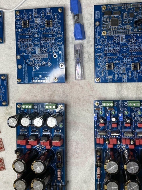

Still waiting on parts.
Are pictures ok?
Finished my boards off, checked voltages and installed the DAC and op amp chips. All good. Thought I would try getting it to work with the I2S signal hacked off a Raspberry Pi 3b GPIO header but doesn't seem to work. I guess it's the Pi set up rather than the DAC. I am getting signals out of the PI and into the DAC, and am getting some junk signals out, but nothing sensible/audible - but can be seen on the scope.
Using Ropieee set to "Raspberry Pi DAC (I2S)" and can see it as an end point in Roon.
I am guessing the I2S signal straight off the GPIO header is junk? Either that or I have messed something up on the DAC board.

Dont use rpi i2sFinished my boards off, checked voltages and installed the DAC and op amp chips. All good. Thought I would try getting it to work with the I2S signal hacked off a Raspberry Pi 3b GPIO header but doesn't seem to work. I guess it's the Pi set up rather than the DAC. I am getting signals out of the PI and into the DAC, and am getting some junk signals out, but nothing sensible/audible - but can be seen on the scope.
Thanks @RipsterDont use rpi i2sget some rpi hats with reclocker or use usb and one of usb to i2s boards.
For now I've ordered a SPDIF hat for the Pi that I know works with Ropieee and Roon - and will then put that back into the DAC via the SPDIF-I2S board. Far from ideal, but hopeful that it will work for the time being until I figure out a better way. While I'm all good with analogue DIY, this digital stuff is new to me so I'm figuring it out as I go with you guy help.Yes, and if the reclocking has an isolated clean side with galvanic isolation towards the dac front end then do not forget to have a clean reg for the clock. If a reg has to be better that is here.
