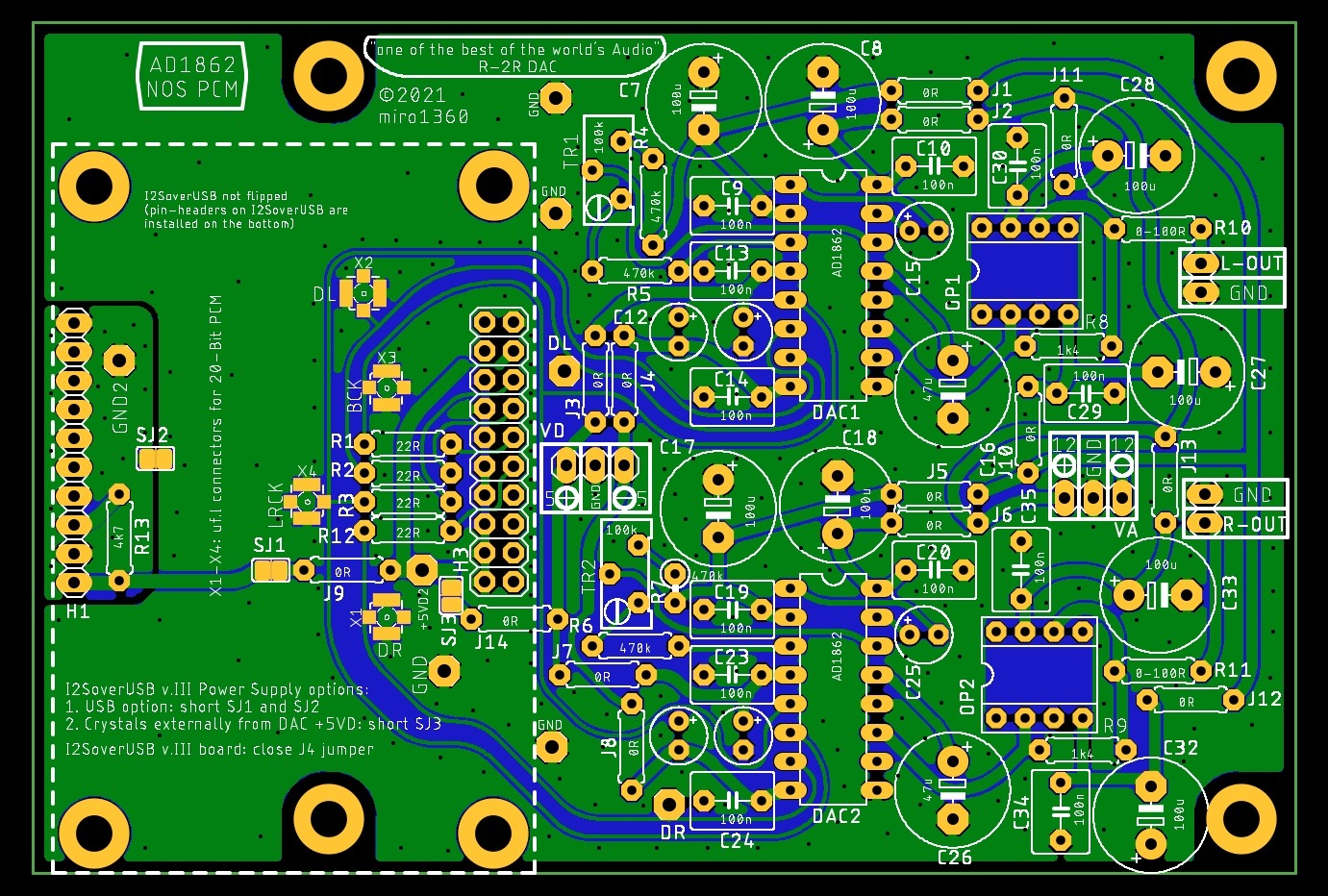

Hello,Hi guys! It's a funny question but I see there a few different version of the Miro's Dac. I mean a different soldering and details but it's not complete as for list of components (first page). So what parts do I need to buy? I already looking of farnell and mouser and there are no necessary parts (resistors, film capasitors).

Thank you! I will investigate.The BOM for the DAC is on the first post and everything else including links to the relevant posts with files etc for PCB's are in the external link here:
https://electrodac.blogspot.com/p/dac-ad1862-almost-tht-i2s-input-nos-r.html

DAC PCB v1.3 #1351 - excludes the AD1862 chips and the pin headers (assumes you will solder cables to the board). Based on socketed/DIL8 LM6171 opamps,

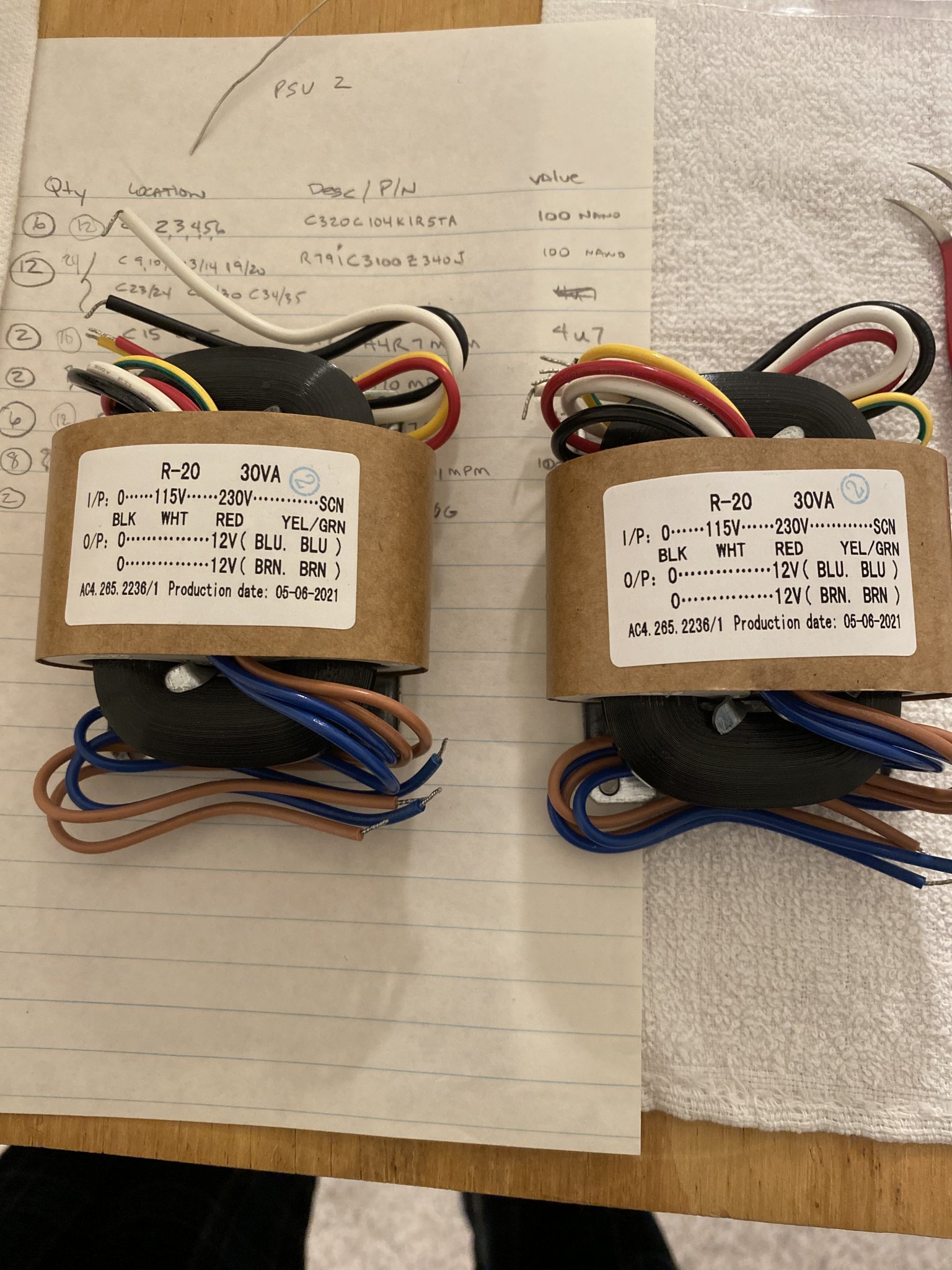

PSU1 #1460 - excludes a suitable transformer, otherwise fully populates the board with screw terminal headers for power in/out

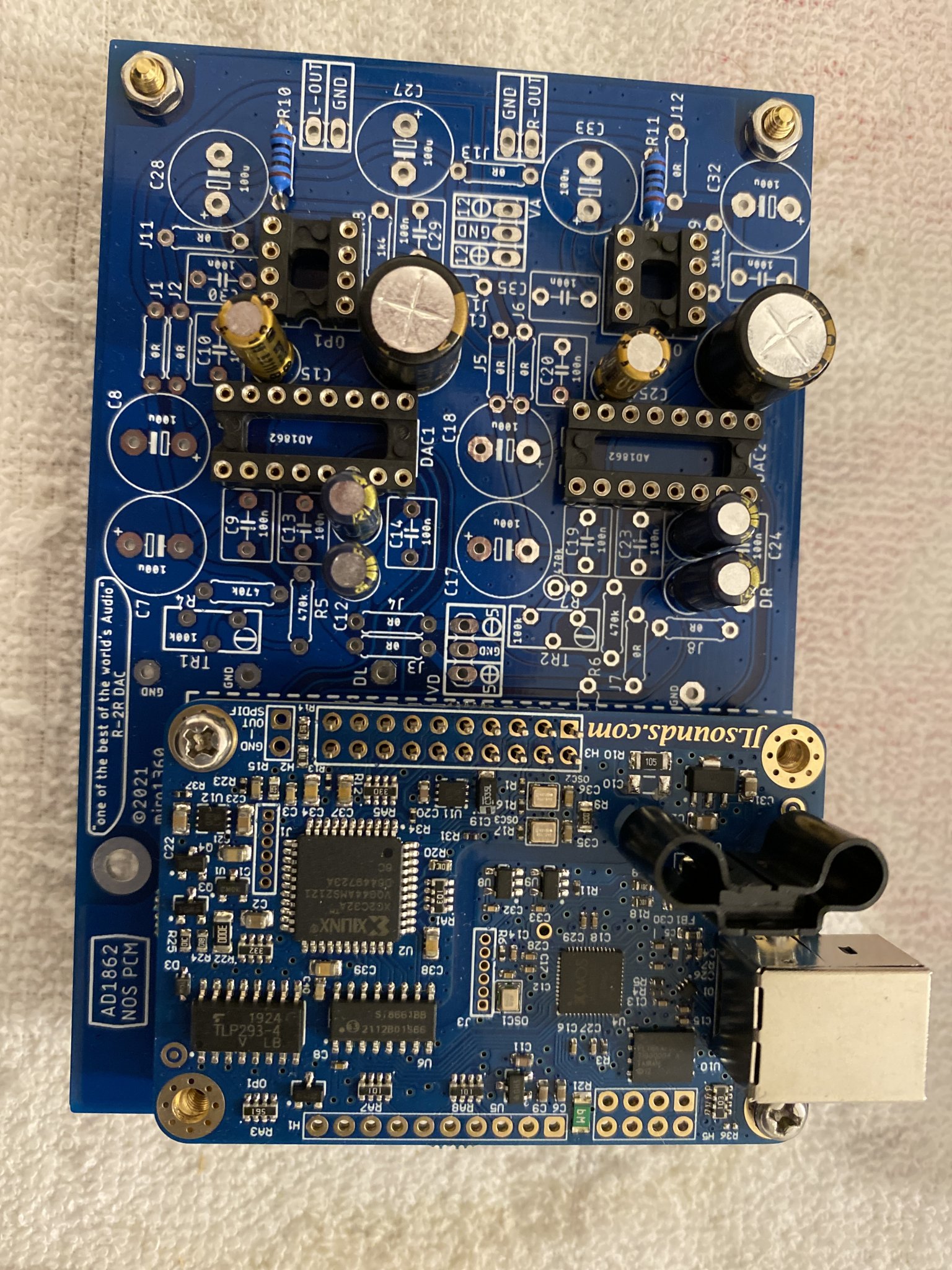

Vunce, do you mind giving us an update on this project? Technical details, but also subjective preferences welcomeI’ve made some progress on EUVL’s Current Mirror I/V converter boards, one pair is soldered. Just checked the output DC offset using my bench supply feeding +/-12vdc:
Board #1 = less than 1mV
Board #2 = 6.5mV
These measurements are without any trim resistors installed! I’d say Ripster did a Fantastic job matching the transistors!!! Thank You![]()
