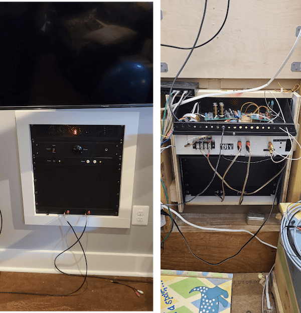

Don't think of it as perpetually building, just adopt a concept from software: this packaging is the result of a couple of years of refactoring.
Mrs PG really, really hates dangly wires, so most of my refactoring happens in the closet behind a relatively clean facade. Out of sight, out of mind.

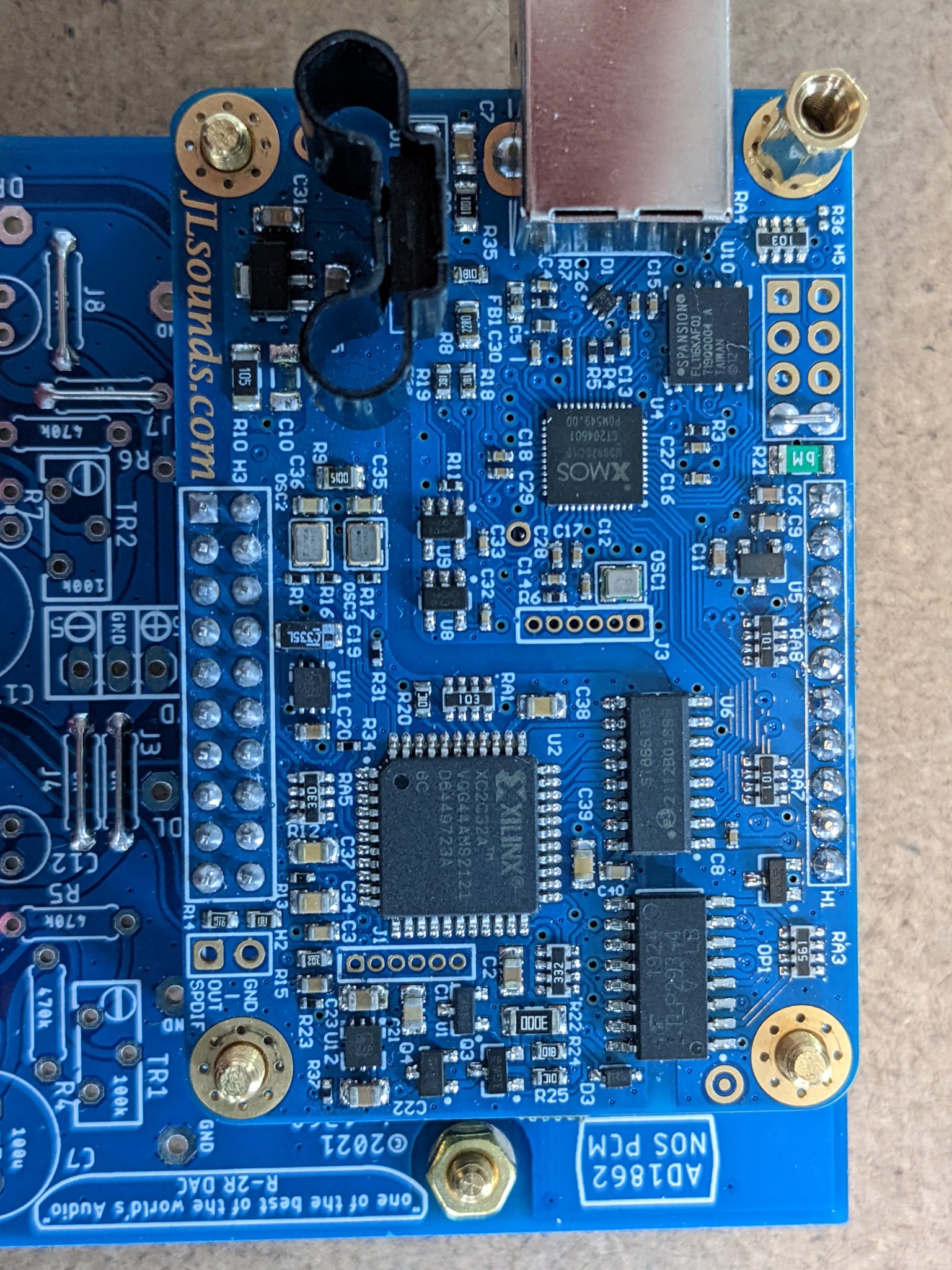

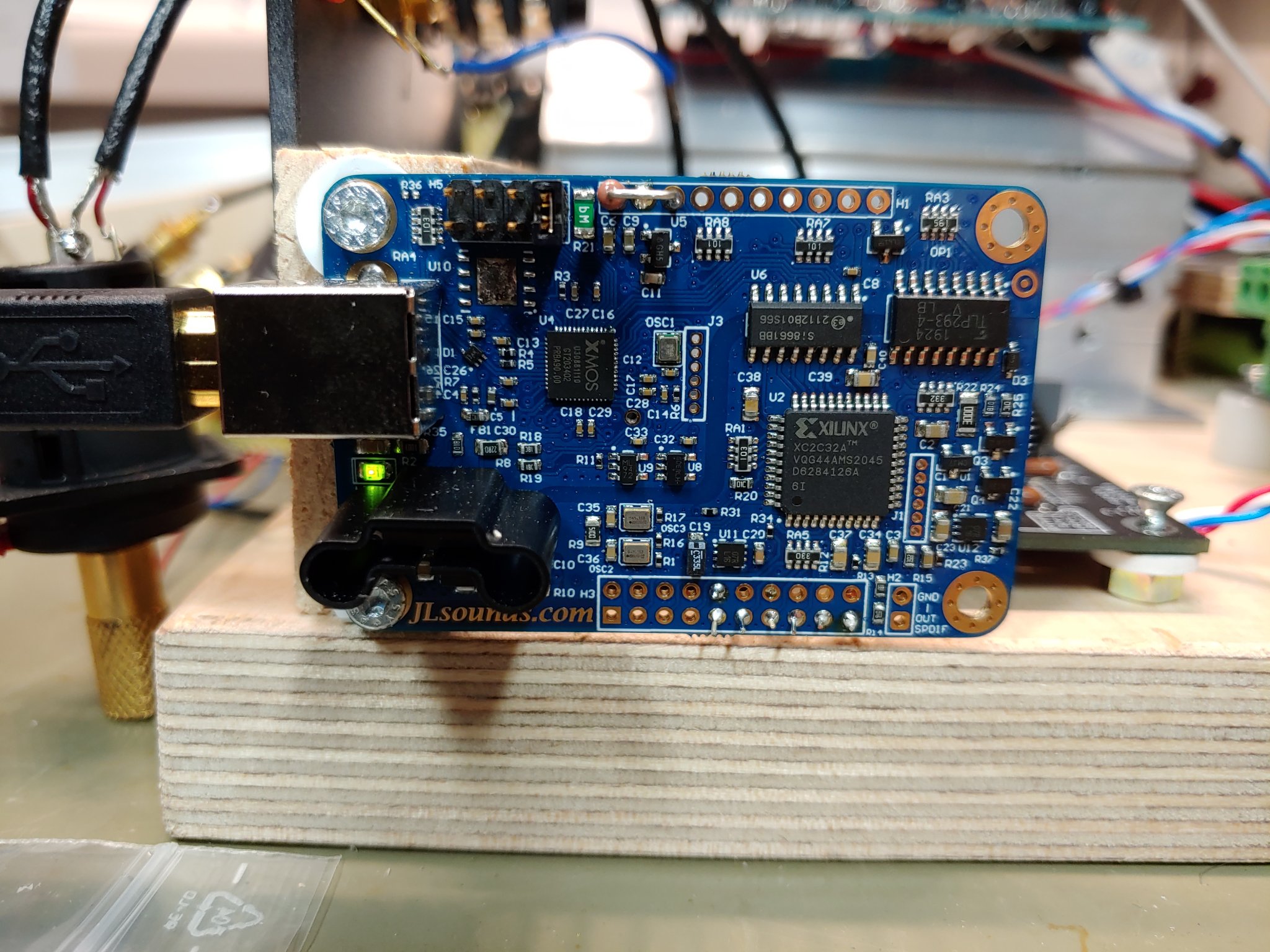

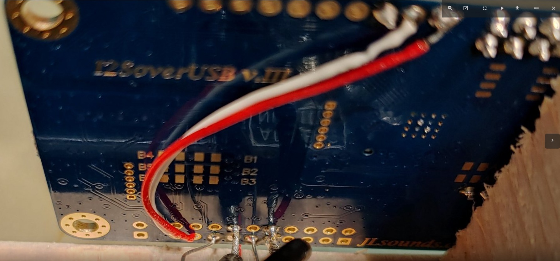

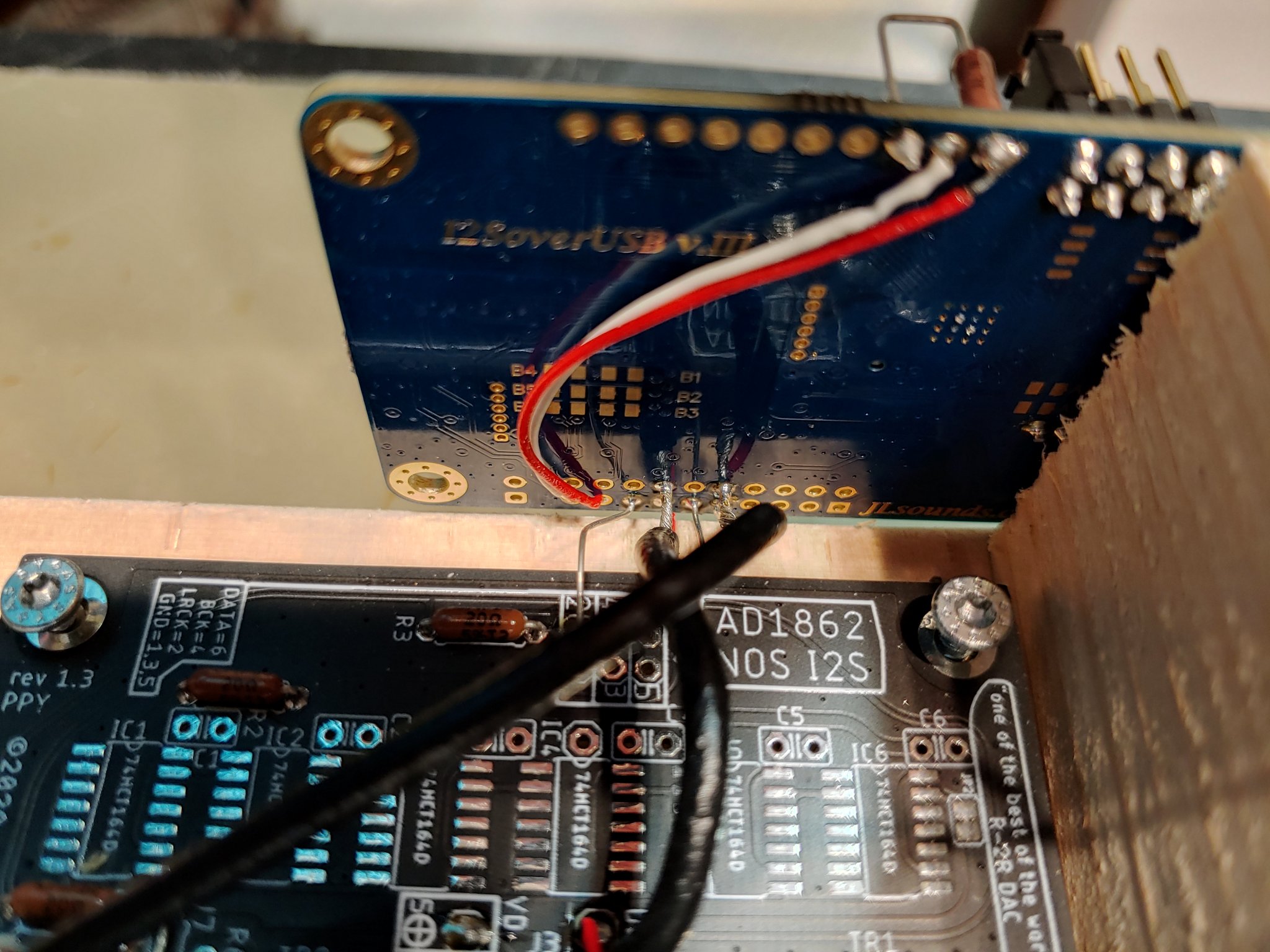

I´ve built the DAC with a JLsoundlab for USB conversion in front.
Everything I get out with headphone after DAC is a scratchy noice without music.
I would be very grateful for any hints

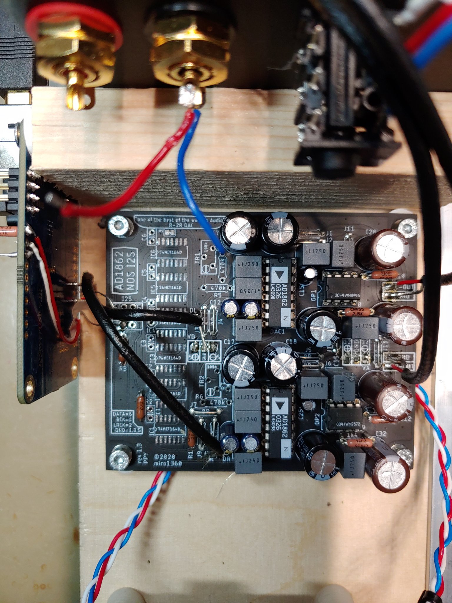

Yeah I burned off one of the traces for a jumper in the center of the board where I can't get clean access -- like right in the middle of everything. I'm keeping it, later this year I'll go back and fix it for a second unit.
Not a big deal, I have like 6 extra PCBs and assembly is no big thing. My 100uf electrolytics were the wrong lead spacing anyway. I love getting time with my solder iron, no complaints

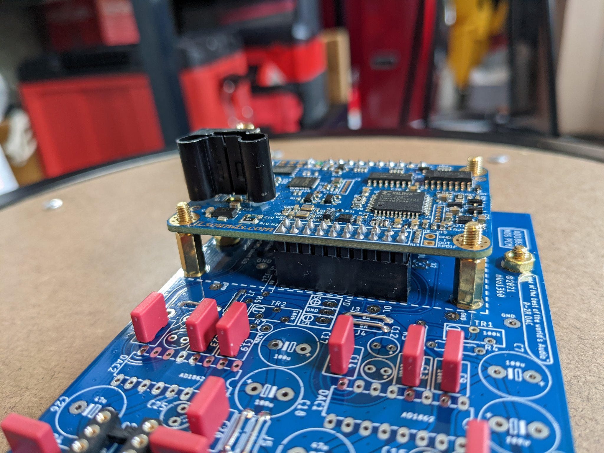

I don't have a schematic for the JL sounds board, but it seems like it should probably have all of its parts...
I wonder if I could convince you to use the mounted PCB too. Then the only thing you need to adjust on the USB board is bridging pin 4

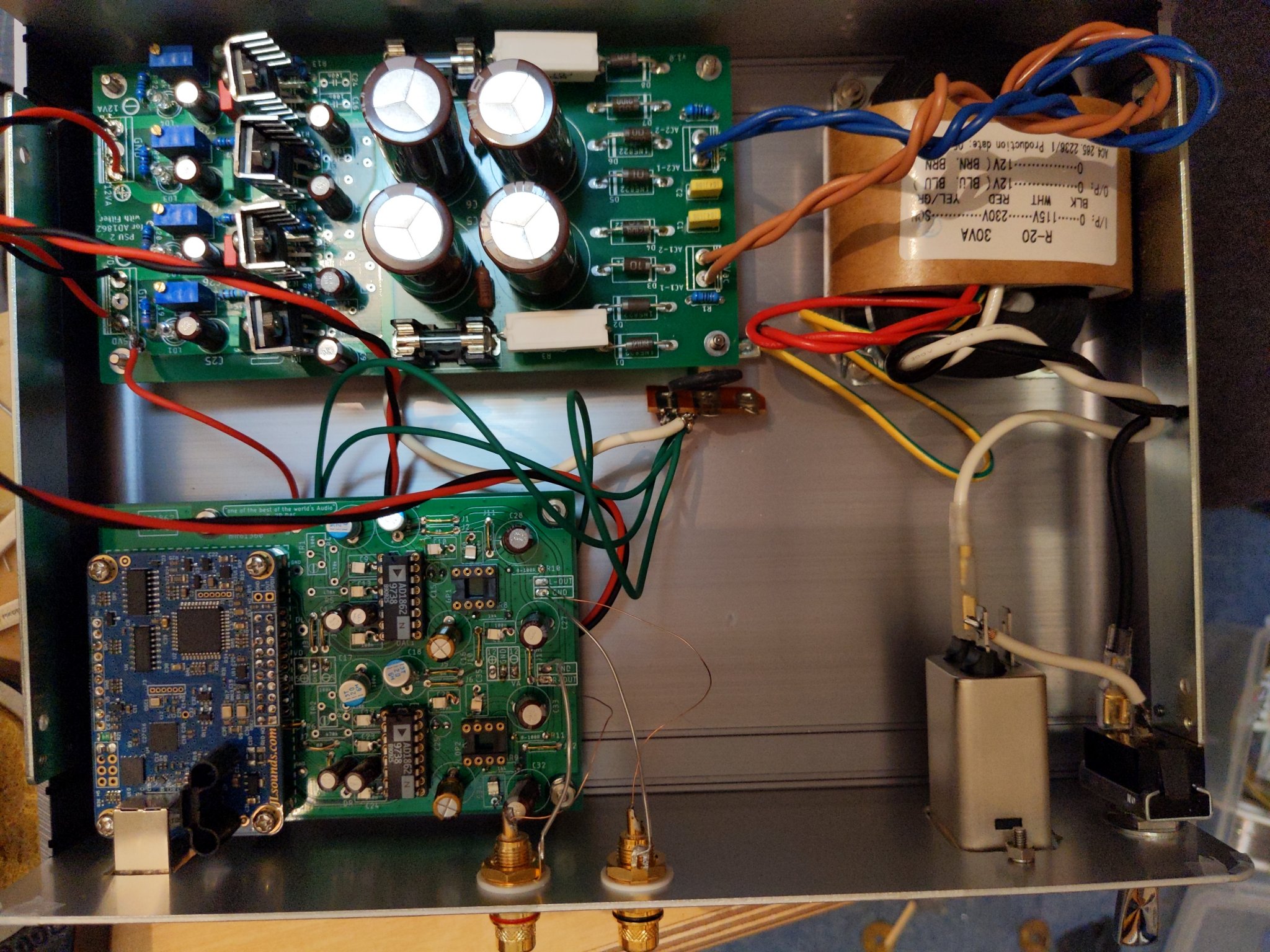

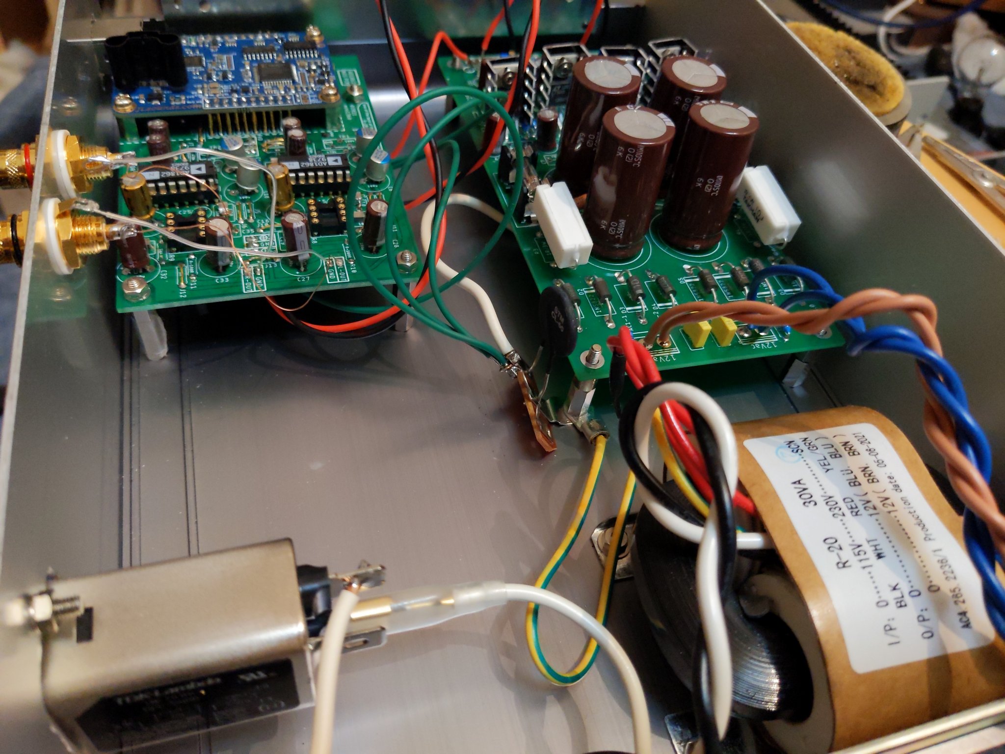

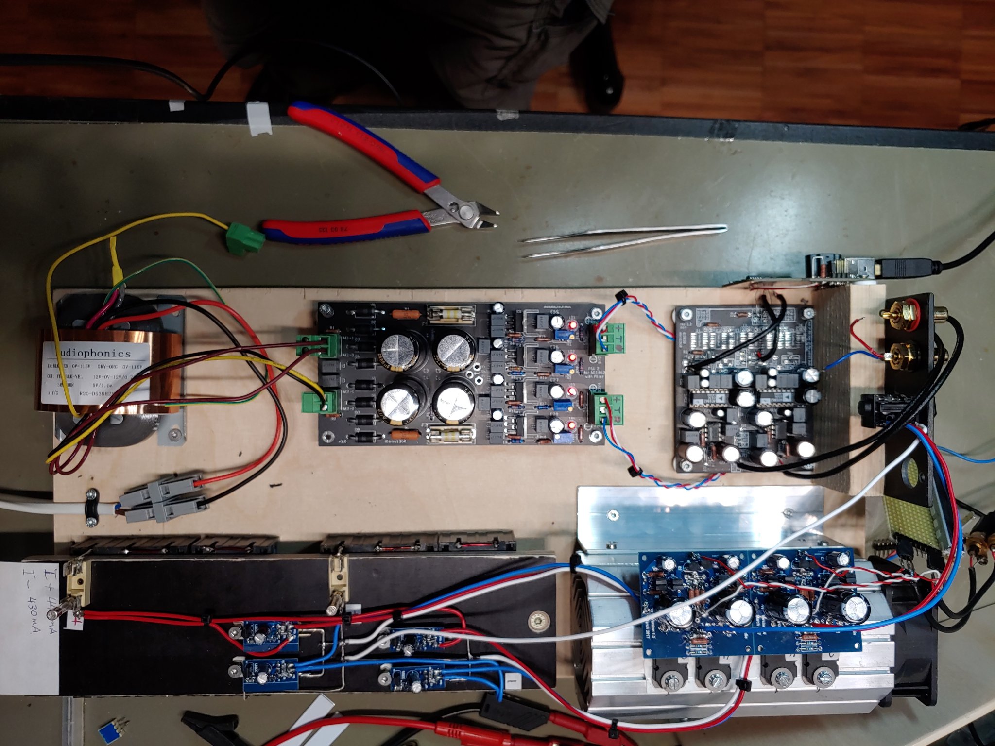

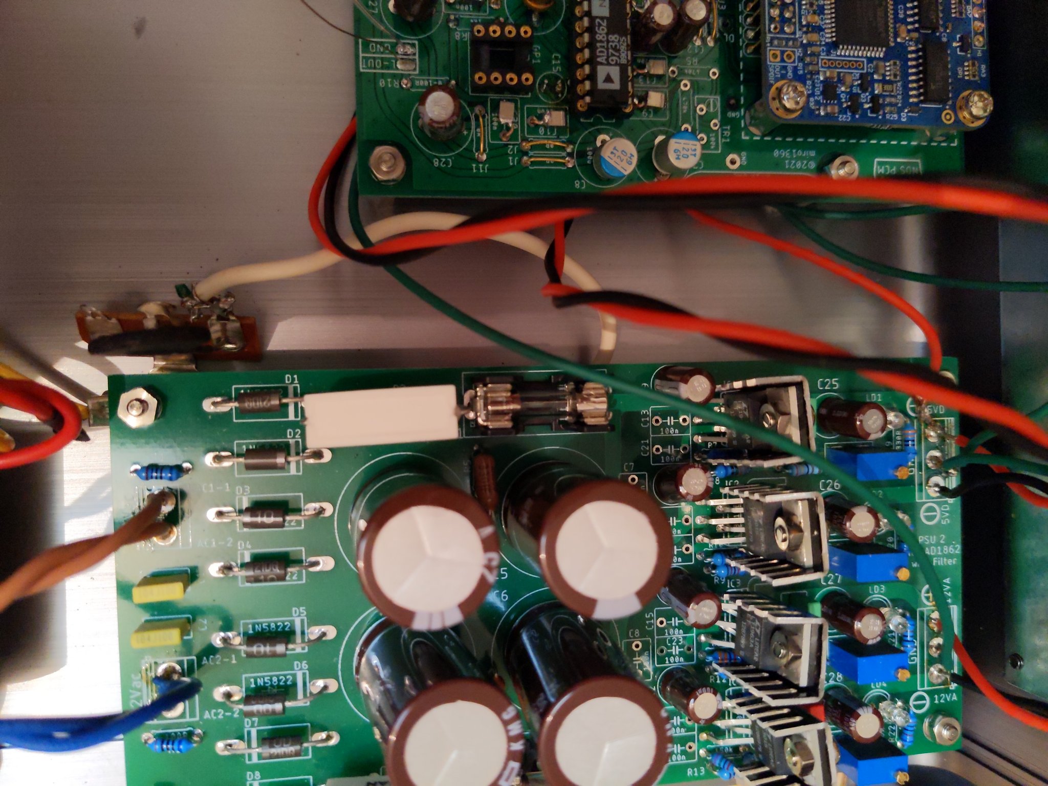

It took long time.finally almost finished.
I am not confident with ground connection
so I would like to ask someone to check.
+-12V,+-5V is ok.
Rcore SCN connected to chaiss.
230V wire cut.
Star ground - cl60 - chaiss.
PSU2 center ground to star ground.
DAC 3 ground to star ground.

Tamra, a couple of thoughts:
- It looks like your power supply board is not grounded. Is that the case?
- I believe all of the grounds on the DAC board are connected, so you should be fine with just one wire to ground from that board. I don't feel qualified to say definitively, but from what I understand running multiple wires like you've got could introduce ground loop noise
- you may consider installing a fuse on the primary side of the power transformer. as it stands, if your secondaries shorted to ground there would not be a fuse to stop that flow -- just an idea.
5V and 12V grounds are shared on both PSU1 and PSU2, and also on the DAC, so that is fine.
Audio ground is also shared with power. I am absolutely not an expert on ground loops but have fought them a lot on this journey and the best result so far has been in my last build as shown above: only the switch mode supply and R-core ground to the case, everything audio-related floats and there's not a sound to be heard.

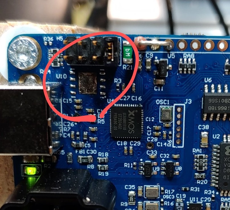

You appear to have connected dirty USB power to what is supposed to be clean +5v power. Why?
Also, what output protocol are you expecting from I2SoverUSB? I don't see the usual programming I need to use at the B1-B5 SMD pads.
