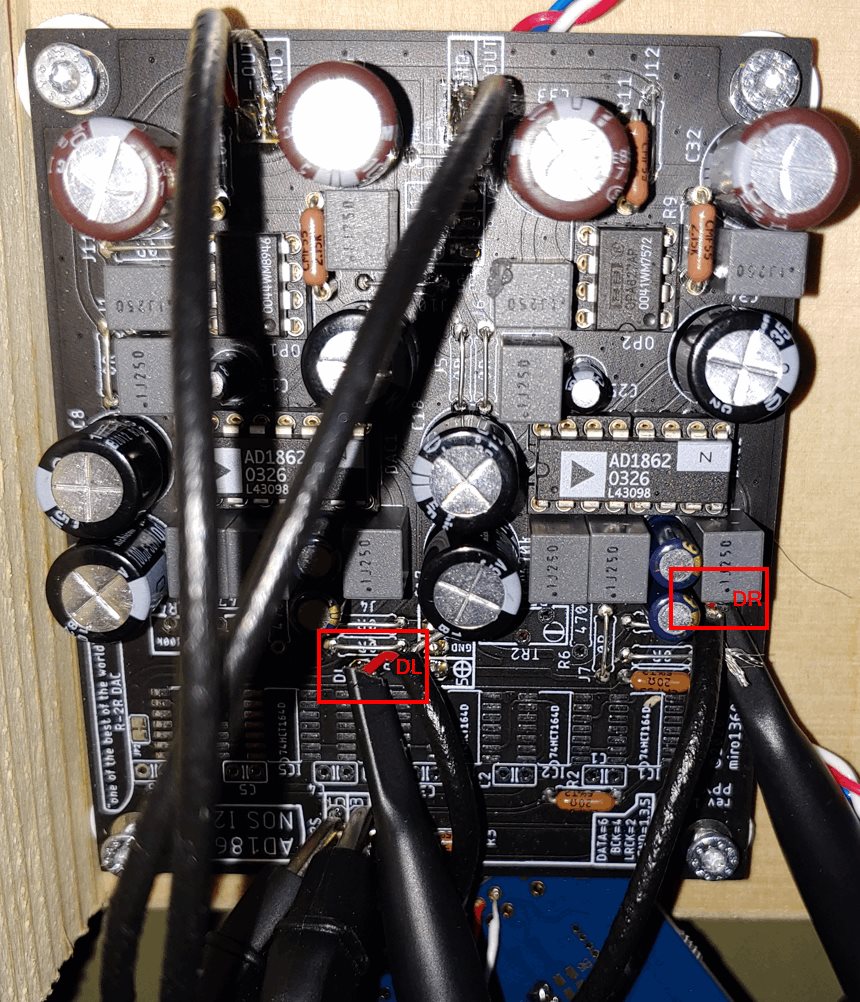

I don´t use the shift register as Miro recommended(see pic). DATA is splitted in DL and DR on JL I2S board and connected to DAC board.
I don´t have an amp with SPDIF in...

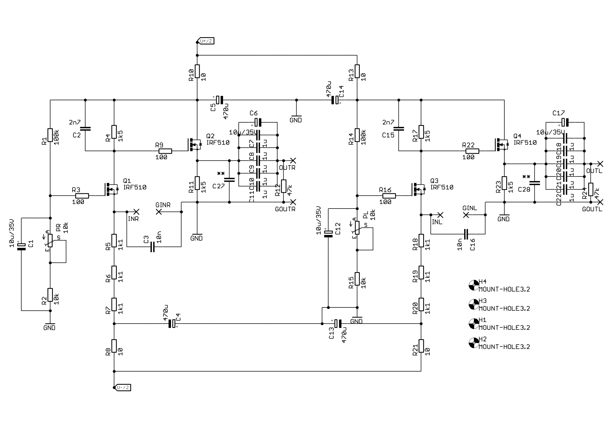

Here are also Gerbers and schematics for the D1 thanks to the mighty ZM.
The D1 featured a PCM63, spec sheet says output for that chip is +/- 2ma - the AD1862 outputs +/- 1ma. I am not qualified to comment on what result that would have in the circuit but hopefully that is in some way helpful to you
It means that the I/V circuit will produce half the output voltage amplitude/gain via the AD1862, but also decreased distortion as a result of that. The decreased gain can be compensated for if required, but doing so would then have the consequence of altering both MOSFET's bias conditions. Likely resulting in increased distortion.

@woodturner-fran: Yellow trace is lrck, blue is bck (first screen shot)
Yellow trace = DL, Blue trace = DR (third screen shot)
The square waves are not very clean? :unsure: LRCK should be 64xBCK slower :(
Try different USB cable (shorter) because it must deliver 400mA

Does anyone know if the D1 as per Pass schematic is suitable as is for the AD1862. I got some D1 boards spare if anyone wants.
It is suitable. Which schematic do you use? Simple change in resistor can increase the output voltage per mA input ;)

@jimk04 for AD1862: R4, R5, R6, R7 = 3k3 ... the same for left channel :cool:
With respect, the values used in the original D1 were calculated for PCM63 which outputs 2ma of current. The AD1862 only outputs 1ma of current. The values have to be doubled. The Drain resistor to +ve supply should be close to 3K and the Source resistor to the -ve supply should be close to 6K6. You may need to reduce the values downwards if the gain is too high.
