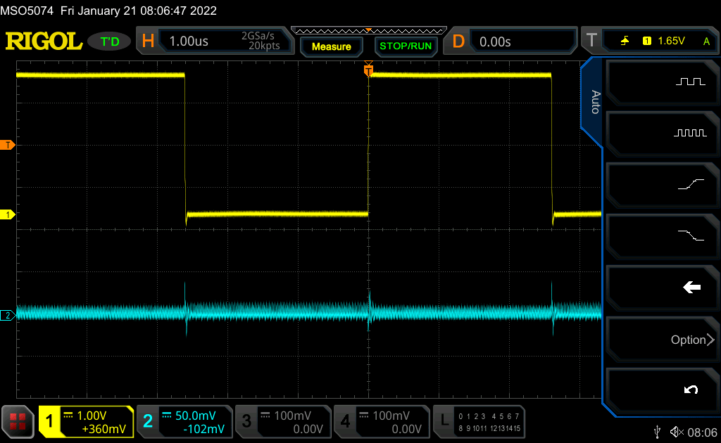

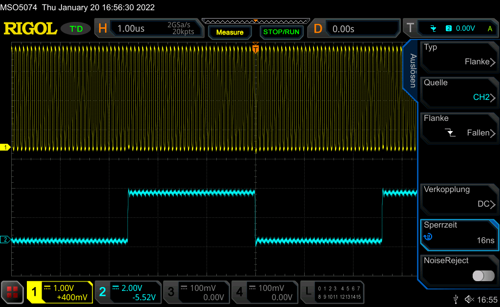

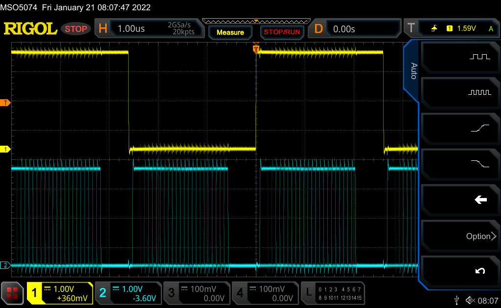

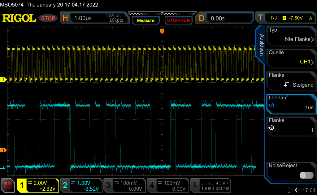

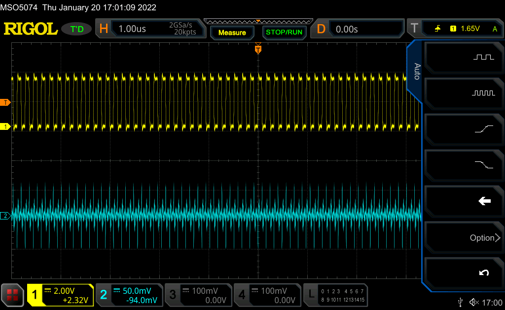

@baggerbole You are fine with 2 probes. Measure all signals with respect to BCK (on the same time scale) and post the measurement here 🙂
BCK + LRCK
BCK + DL
BCK + DR
BCK is always yellow trace
Looks like DL is flat...
I assume you sent music or a sine wave through it. Is the configuration is as in your post #3225?
DL looks flat 😳 ... Can you add measurements LRCK_DR and LRCK_DL?
Your scope has 16 digital inputs (inputs great for this measurement). Do you have cable for it? It should be the rectangle connector with many pins.
Yes I sent music trough. I´ve changed the config from #3225 to #618 as Vunce advised.
Config is now:
J1-J4 open
B1-B3 closed
B4-B6 open
DR = H3:9
DL = H3:13
BCLK(BCK) = H3:11
LRCK = H3:15
Power connected via USB at H3:17 and H3:19
The scope is new to me. It's like EXCEL or WORD, it can do quite a lot and you use a maximum of 10 percent of it 😉
I don´t have the wire harness for the dig in port.
I have inquired with JLsounds but have not received an answer yet.

@baggerbole first go back to config from post #3225 since you are not using shift registers. I think this is J2 open, J3 open, J4 closed. B1 to B5 all open. Then if it was me who knows even less about scopes and measurements I would first measure signals coming out of i2soverusb board directly on output pins of i2soverusb board.
If everything on that side is OK I would move to DAC board and measure signals coming to DAC.
