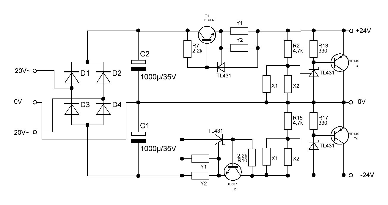

I use a TL431 +- shunt regulated design. I got the schematics from the power supply forum here at diyaudio. I dont have access to it for the time being will post the schematic later.
I used the schematic found here https://www.diyaudio.com/community/threads/mini-superreg-for-phono.334946/ You have to scale up the transistors used for the D1, to set the current source at 165ma by using 15R 2W resistors at the Y1 position and to set the voltages at +/- 30V, the resistors at the 2nd half of the TL431 shunt regulator portion at R2, R15 are 10K and for X1 is 910R. I had on hand some BD241 and BD242 from my junk bin, with a continuous collector current of 3 amps which measured a hfe of approximately 176, which I used for the pass transistors. They do run very hot though and adequate heatsinking is a must.I use a TL431 +- shunt regulated design. I got the schematics from the power supply forum here at diyaudio. I dont have access to it for the time being will post the schematic later.

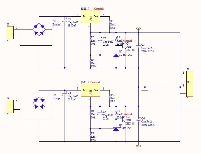

Another schematic you may want to consider is from http://www.garbz.com/electronics-static/projects/dac/ where right at the bottom of the page the psu schematic is given for the D1 i/v. The current source portion is implemented with an LM317 set as current source with about 150ma using a 8R2 resistor. I did not follow this psu schematic because it requires a transformer with 2 secondary windings, which I did not have on hand. I used an EI 50VA 24-0-24 V centre tapped transformer.I used the schematic found here https://www.diyaudio.com/community/threads/mini-superreg-for-phono.334946/ You have to scale up the transistors used for the D1, to set the current source at 165ma by using 15R 2W resistors at the Y1 position and to set the voltages at +/- 30V, the resistors at the 2nd half of the TL431 shunt regulator portion at R2, R15 are 10K and for X1 is 910R. I had on hand some BD241 and BD242 from my junk bin, with a continuous collector current of 3 amps which measured a hfe of approximately 176, which I used for the pass transistors. They do run very hot though and adequate heatsinking is a must.

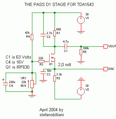

Just for your information, I only used the 1st half of the D1 i/v; without the 2nd half source follower. Nelson Pass himself in posting said, the source follower is unnecessary, if you dont need to run long or highly capacitive cables. The schematic, I used is that posted by stefanobilliani for the TDA1543. https://www.diyaudio.com/community/threads/the-pass-d1-for-tda1543.32999.
Just replace the values R4 with 100K as per the original D1 and if using a single AD1862, R1 is 3K3 and R2 is 6K6. Trim VR1 the source pin of the IRF610 to 0V.
