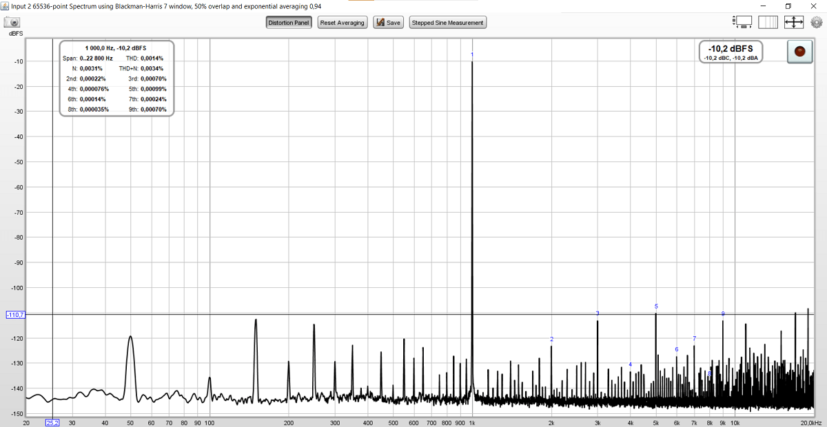

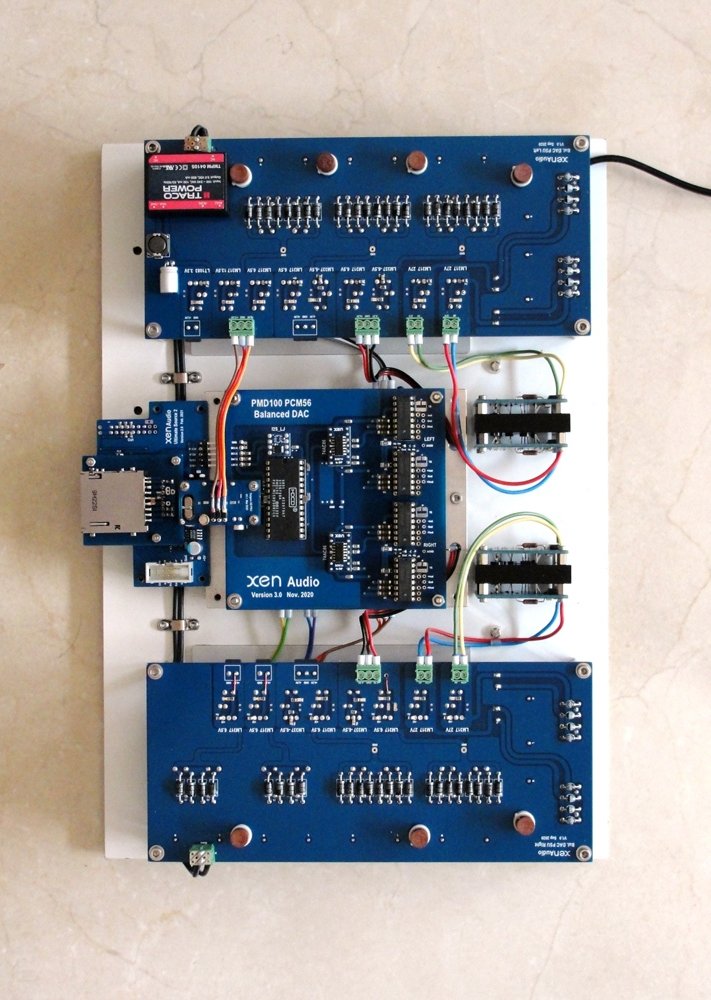

....... I am surprised that apart from me and one other forum member, nobody else seems to have tried out the PCM56 dacs.
We did.
And I am not too bothered now to try the same with AD1862, even though a compatible board is ready.
The measurement was done with PCM56K (no trimming) and a DF1704, but we have adaptor boards for PMD100 as well as a NOS Shifter with 2x 74AHCT164.
All of them functional. Still need a bit of work on the source (QA550 like) and to case up properly.
Cheers, Patrick

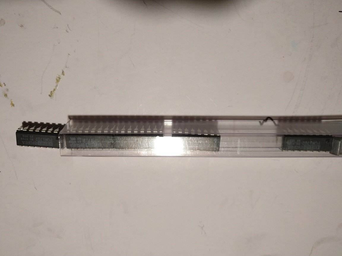

Why is no one pushing PCM1702? Looks like I'm the only one addicted to them. I recently bought five more so I can put them together in parallel.

@EUVL those boards are elegant and clean. I enjoy seeing your work
Thank you.
You have only seen maybe 20% of what is involved.
When it is time, we'll opn a new thread and let you see more.
It is a common platform which will allow you to use different DFs and R2R DAC's, etc.
Patrick
