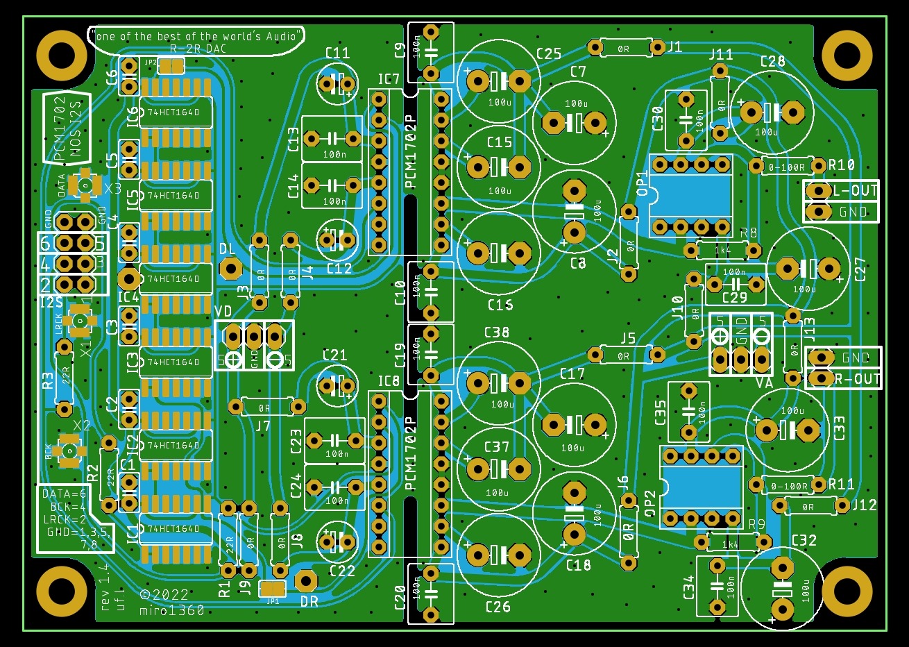

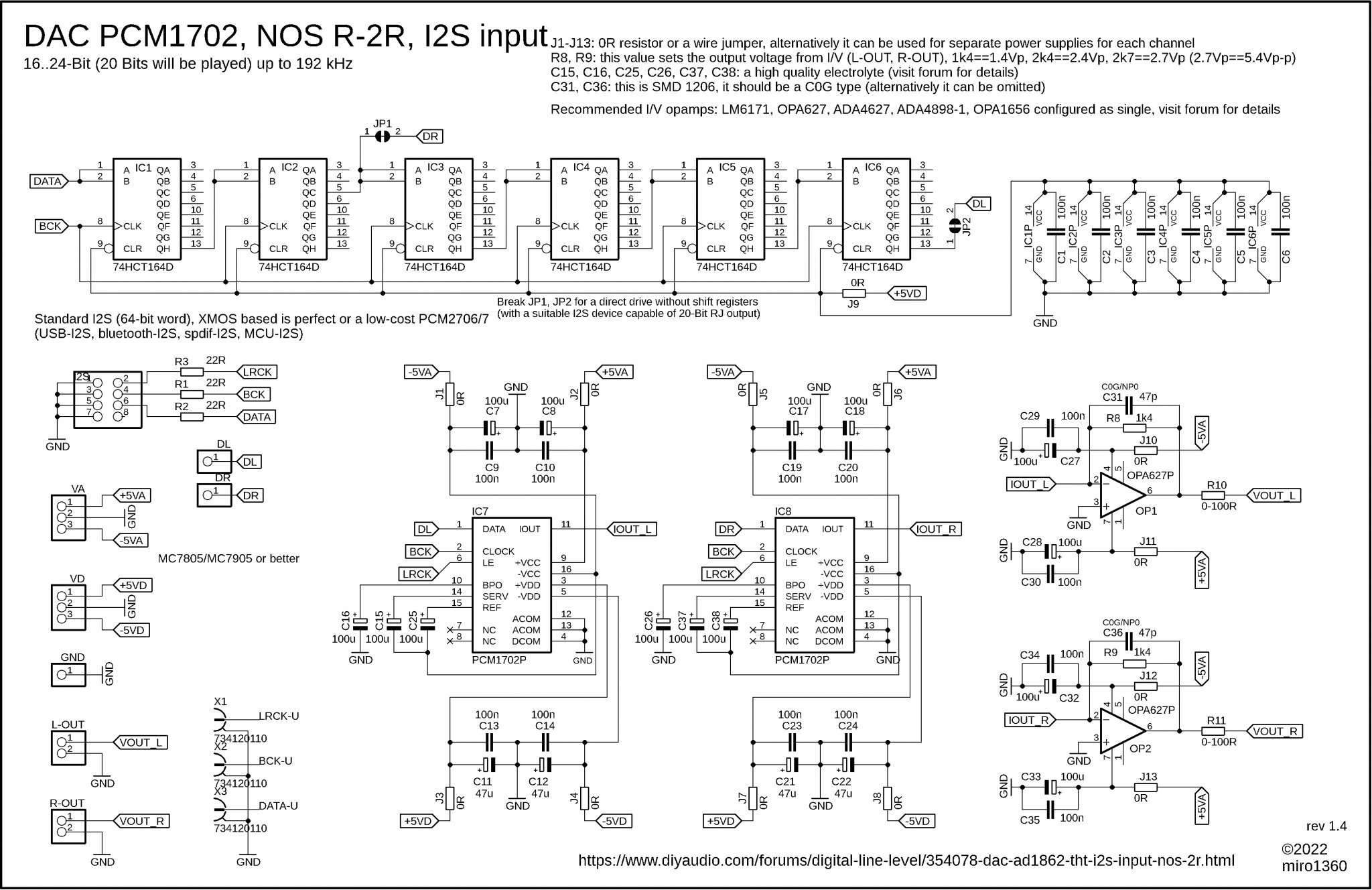

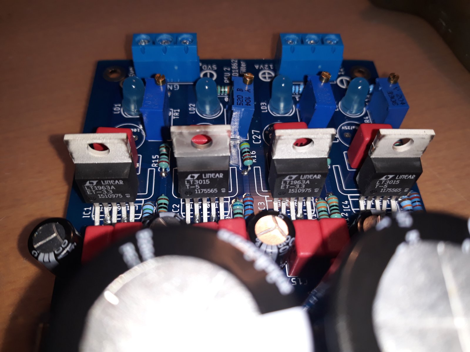

@miro1360, can I use the PSU-1 with double stabs on 5V? I think this is better DAC (1702) instead pavouk project on smd. I don't like smds😄

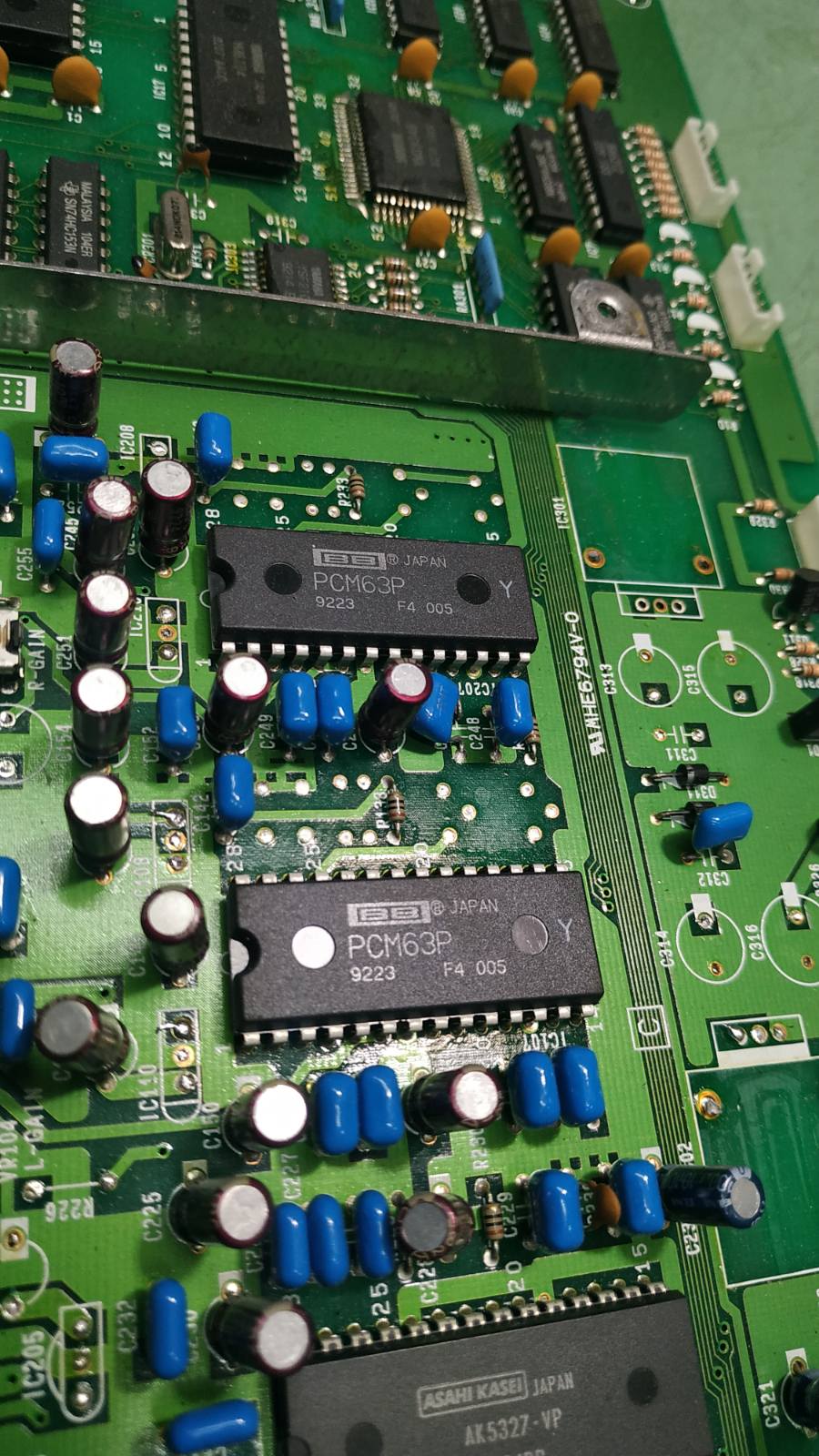

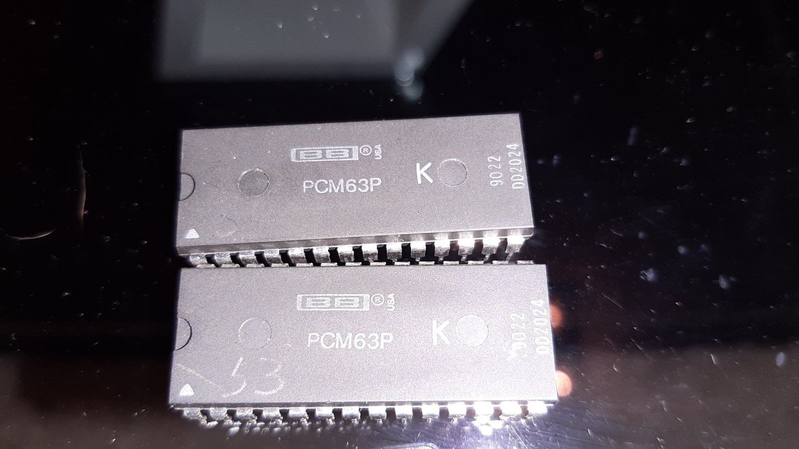

As for me - 63 is worst than 1704. The last one is another level of sound. 63P-K is a little muddy. Doesn't emphasize on instruments just like no pause between instruments. That's not bad but it's a disadvantage.If PCM63P can be done, I will be the happiest man in the world.![]()
I have Akai CD-79 and also listen Lynx D27 (Lynx audio).

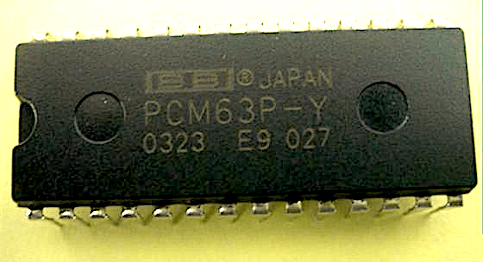

PCM63P-Y is the very RARE (limited) edition. I get it in person from Mighty @Zen Mod taken from some Sony dac studio console.As for me - 63 is worst than 1704. The last one is another level of sound. 63P-K is a little muddy. Doesn't emphasize on instruments just like no pause between instruments. That's not bad but it's a disadvantage.

This is the problem, you will need the adjustable version3.3V and 5V. Not adjustable.![]()
