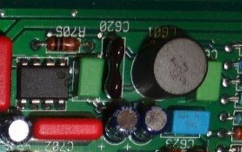

Psu - 1 have 4700 and 6800/25V. I am planning change on 16V.
On the Dac board have many Wima 0.1uF and 6pcs Kemet 0.1uf (ceramic). I also will change all of them on np0 smd.
Do not use the 0,1 uF at the output of the 7xxx reg ic, a simple 100 uF is enough, then decouple at load pins on Miro's board.
If you reduce the voltage of the smoothing caps then reduce the secondaries outputs acordingly. Remember the 1.41 x rule we talk already in the thread. 12V secondaries for instance will be too much with a 16V smoothing cap. This first cap shoukd always be surdimensioned in temperature and voltage rattings. Epcos and Pan FC are perfectly fine. Btw I use an long life Epcos as smoothing then the FC at reservoir cap on PSU 2.

No, I won't. Isn't Wima's located before MC stabs?
0.1 and 0.33uf. I don't touch them.
You say that 4700uf can swap on 100uf or I don't get your Idea???
Yes the low values are mandatory on the input pin only.
I just didn't get the idea for the 4700 uF there. The big cap before the reg suffice an ideally should be higher capacitance and voltage type in order to have the lowest esr and ideally just a decoupling at the load. Sometimes a little value can calm down things at the ic output, typically 10 to 100 uF , but it should be tested each time imo with listening test if mandatory or not.
If the idea is more to have a constant current source with the 4700 uF then I will raise it to 10 000 uF then the ic will just serve to feed it and will have no behavior at all. Simulation s can tell you other things though. Experimentating is the key.
So in this scenario the output cap should be with lower esr (better)than the input main cap = higher capacitance and voltage for the output cap and as you are here feed it through a 1R resistor..
But nothing should stop anyone to try the PSU just with a final decoupling at the IC of the oap (w/o that big cap) just in case the 7xxx are able to enough transcient 😉 ! And big caps are expensive...🙁
