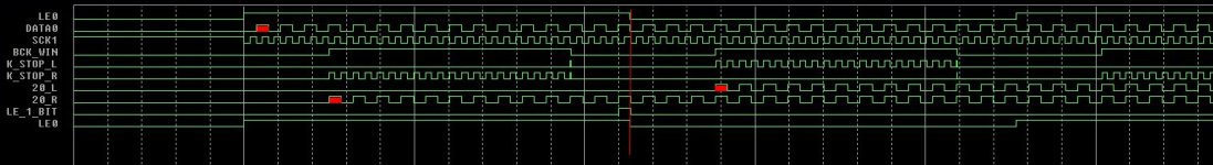

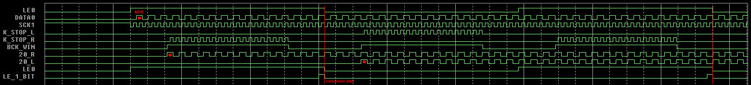

Hi jpk73Zoran, did you check my simulation I posted in #3957? Attached a screenshot of the output of my circuit (in this case fed from the PMD200): as far as I understand the timing satisfies your remarks - or am I missing something?

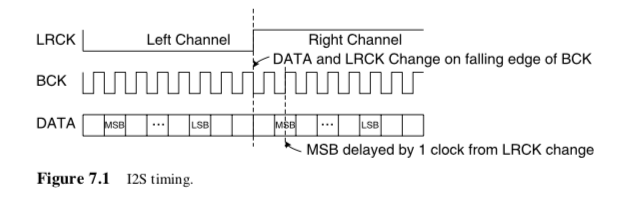

I just spot that You invert BCK signal at the input as I2S line?
Take a look at the standard BCK is changing state from 1 to 0 within LR latch changing the states.
So i think that BCK should be inverted in the source stimulus?
Try change the BCK generator it to strat the opposite value from present?
Hi jpk73

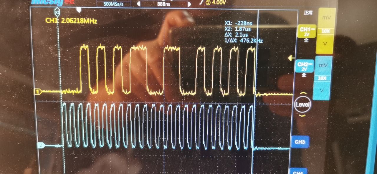

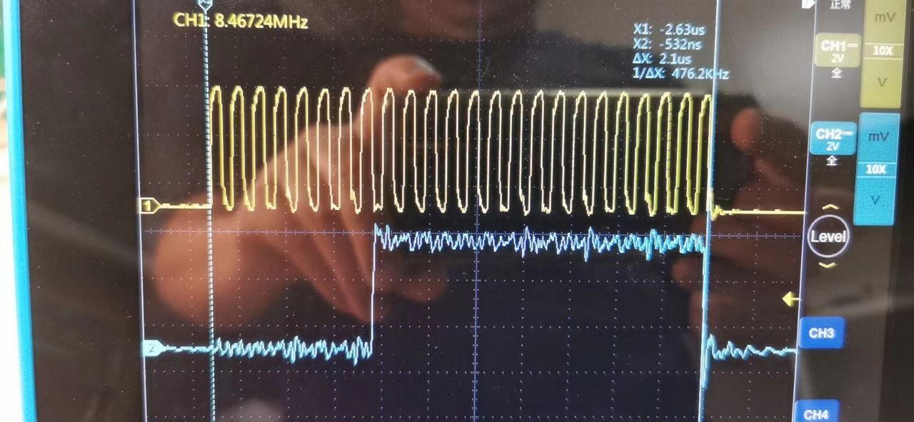

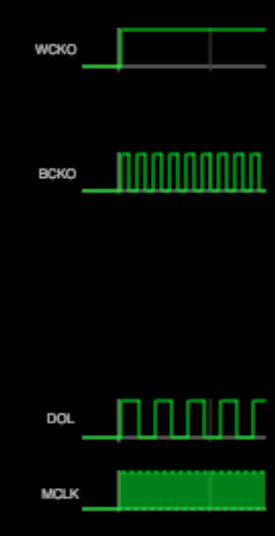

Inverting BCK is only for simulation, not in the actual circuit. Output format of PMD200 is not i2s, see attached scope shots:

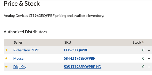

LT1963EQ#PBF is unobtanium part now....>>Why this choice LT1963 and LT3015 ?
This PDF led me to those components A comparative overview of power supply regulator designs with listening tests - PDF Free Download
and also because of the still unsurpassed popularity of THT
But I barely managed to find it from the USA.
AaaInverting BCK is only for simulation, not in the actual circuit. Output format of PMD200 is not i2s, see attached scope shots:

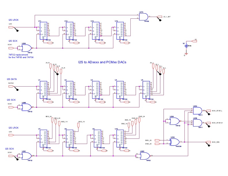

I know from the other topic that You finished controller for the PMD. Was it 100 or 200 type?

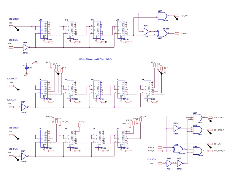

There is one solution for not to going into conversion in the same time digital word is loaded. LE could be used as it is or just one pulse.
Stopped clock. For 16 18 20 and 24 bit words.
(WIndow where words and clock are happening, is not exactly in the middle. For instance for 16 bits (32-16)/2=8 8 bits before word and clock and 8 bits after LSB. The same blanc period of time between going to conversion LE event. For other word length (32-18)/2=7, (32-20)/2=6, (32-24)/2=4.
I will do it in next version maybe in with inverting data in the time window and recklocking with MCK)

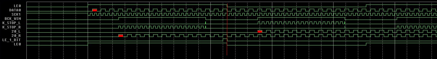

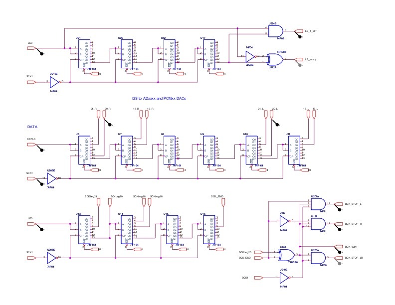

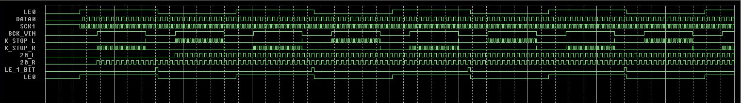

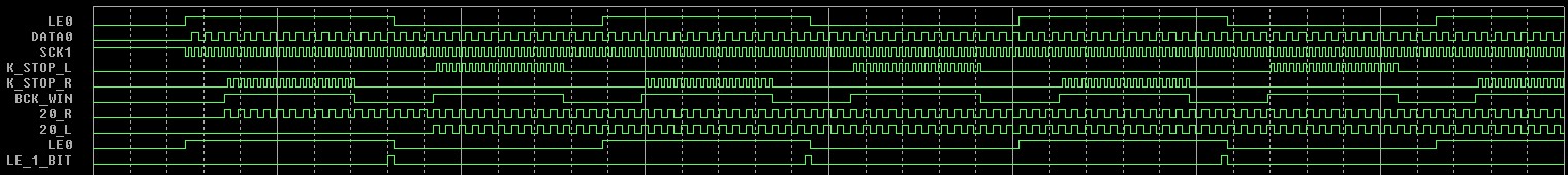

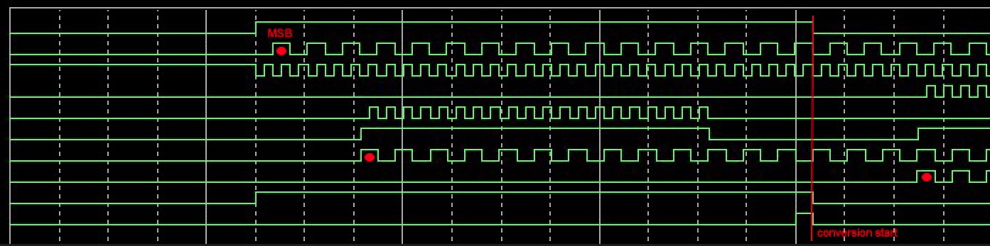

I made corrections to the format. Main idea is that all clocks and datas are happening in the "window" that is symmetrical to the Latch Enable events. So same number of blanc SCT time is prior and after the reception of DATA word. Also I made correction about position of SCKs and DATA. Now it is like in data-sheets. Time delay is much lower than in Right Justified composition. So one shift register for data delay went out.
(in earlier post BCK is moved half of BCK to the MSB. I spot this too late to edit post before.
Now everything is as standard.

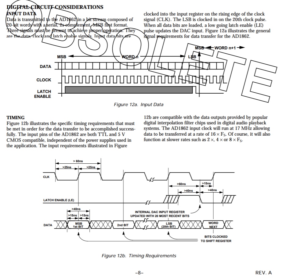

please see the timing line of AD1862 and compare.
Window is not fixed and could be used for 16, 18, 20 and 24 bit word depending of DAC chip. For Analog Devices and TI Burr Brown DACs
This is results for AD1862. I will try 74F series DIP because of same level of technology and dimensions as DAC chip. Also 74AHC could be used.
In the SCH are some additional signals that I use as sort of reference that is no needed for DAC operation and could be omitted...
