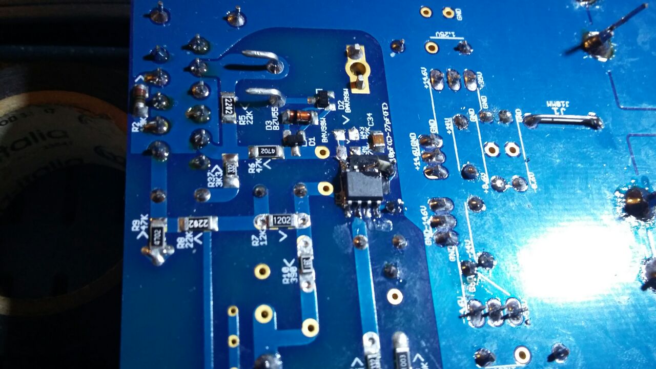

~this is what can be seen in the photo.
I have blobbed together the two inputs and had connected to ground, with a resistance.
But Miro's config is better and requires the same space, topology arrangement.!
More: what is hidden in the picture:
Should prepare the pads before placement:
With thin wire, beneath chip, connect:
Pin1 - pin6;
Pin7 - pin8;
Cover with tape : pin5; pin6; pin7
Place and solder the chip in 5 places:
Pin 1,2,3,4, 8.
On the remaining 3 free pins :
Solder pin7 - pin6;
Connect pin5 to ground. (Miro config)
Pin1 - pin6;
Pin7 - pin8;
Pin 1,2,3,4, 8.
Solder pin7 - pin6;
