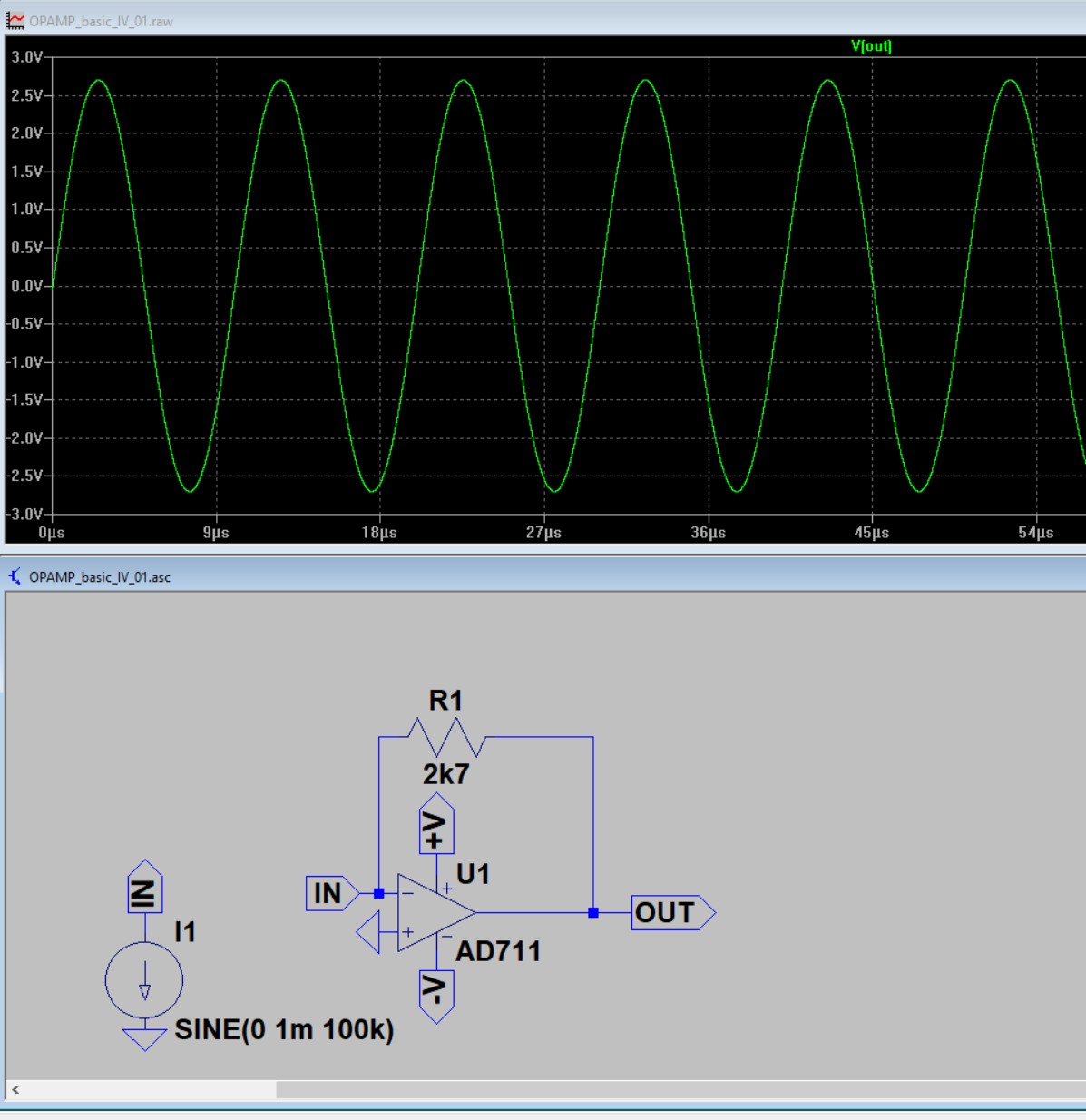

Yes, you calculated it correctly.
Vrms = Vpp / (2 x 1.414) = 5.4 / 2.828 = 1.91
The output current from AD1862 is +-1mA, so the Vpp from basic I/V will be simply 2x resistor value (R8 or R9) in kiloOhm.
This is how the voltage output Vpp sine looks with 2k7 resistor:

full output current from this DAC is +-1mA
resistor (Rx) in I/V converter is directly related to this output current and forms desired output voltage
Vp = 1 x Rx, thus Vpp = 2 x Rx
Vrms = Vp / 1.414 = Rx / 1.414
==> Rx = Vrms * 1.414 [Rx in kOhm]
if you consider the Vrms to be 1.228, Rx calculation is:
Rx = 1.228 * 1.414 = 1.736[kOhm]
