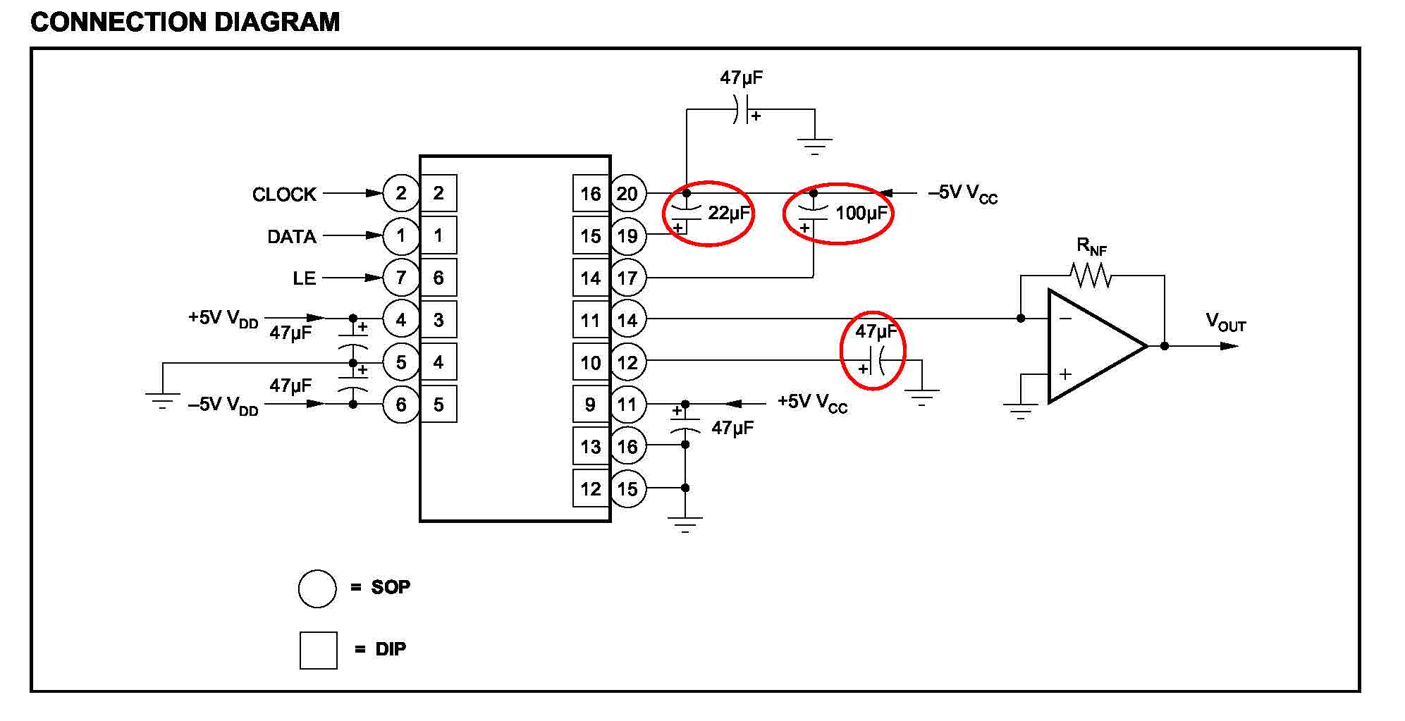

one PCM1702 needs 7 electrolytes from 47uF to 100uF, 4 for decoupling and 3 of better quality with a small leakage current for internal references
Here's what the creator of this PCM1702/PCM63 adapter probably did, I will check it out later. He put these three electrolytic capacitors on the adapter PCB according to the datasheet (22uF+47uF+100uF). The other four decoupling capacitors on digital and analog +-5V supplies are on the Miro PCB (100uF along with parallel 100nF PP).
All the ones I got were LOW ESR, Panasonic, NIC and the like from local stores. I don't see any problem, that should work nicely instead of PCM63 on the Miro DAC board.
I don't know if it would be wise to put some small ones of 100nF on the adapter PCB in parallel with these three electrolytic capacitors? I have a lot of 100nF ceramic 1206 SMD and Wima MKS2?
Unfortunately, the person who made the adapters did not read the DS until the end where it says ; As shown in CONNECTION DIAGRAM, various size
decoupling capacitors can be used, with no special tolerances being required
. The size of the offset decoupling capacitor is not critical either, with larger values (up to 100μF) giving slightly better SNR readings. All capacitors should be as close to the appropriate pins of the PCM1702 as possible to reduce noise pickup from surrounding circuitry.
It would be better if you put that 100nF SMD right on the power supply pins on the adapter itself, because the PCM1702 produces interference at some 3.6MHz. COG SMD would be better with these frequencies. Avoid PP or MKS2 because of the long legs, especially since here the PCM1702 is on the adapter and it is not very close to the decoupling capacitors. Panasonic FC would be a good choice for all 7 capacitors , 100uF/25V also has a small leakage current..

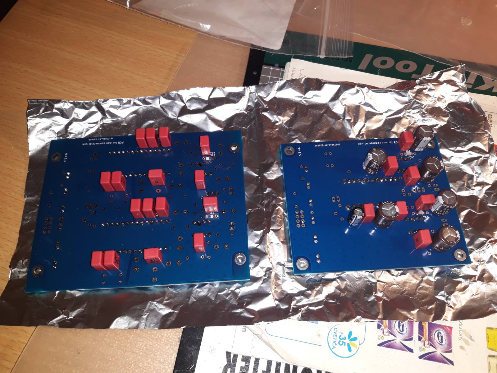

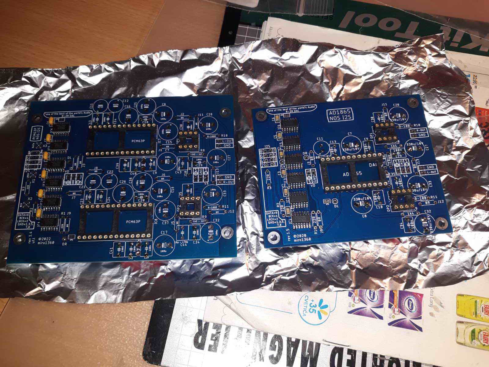

Unfortunately, all capacitors must go on the underside of the PCB. Otherwise, it is difficult to change operational amplifiers and DAC chips. Let's say the adapter for PCM1702 is 20mm wide and all the parts around it get in the way. I mean functionally there is no difference, it's just uglier when you can't see the beautiful parts. The electrolytic capacitors will be Elna Silmic II and Nichicon Gold on the PCM63 boar. For the AD1865 board I chose NIC and Panasonic LOW ESR capacitors. Wima PP are definitely red. :ROFLMAO:

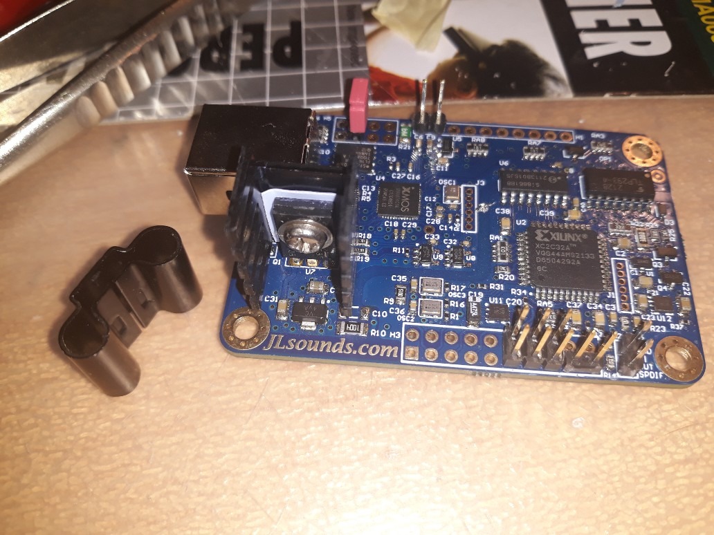

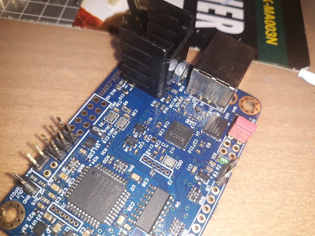

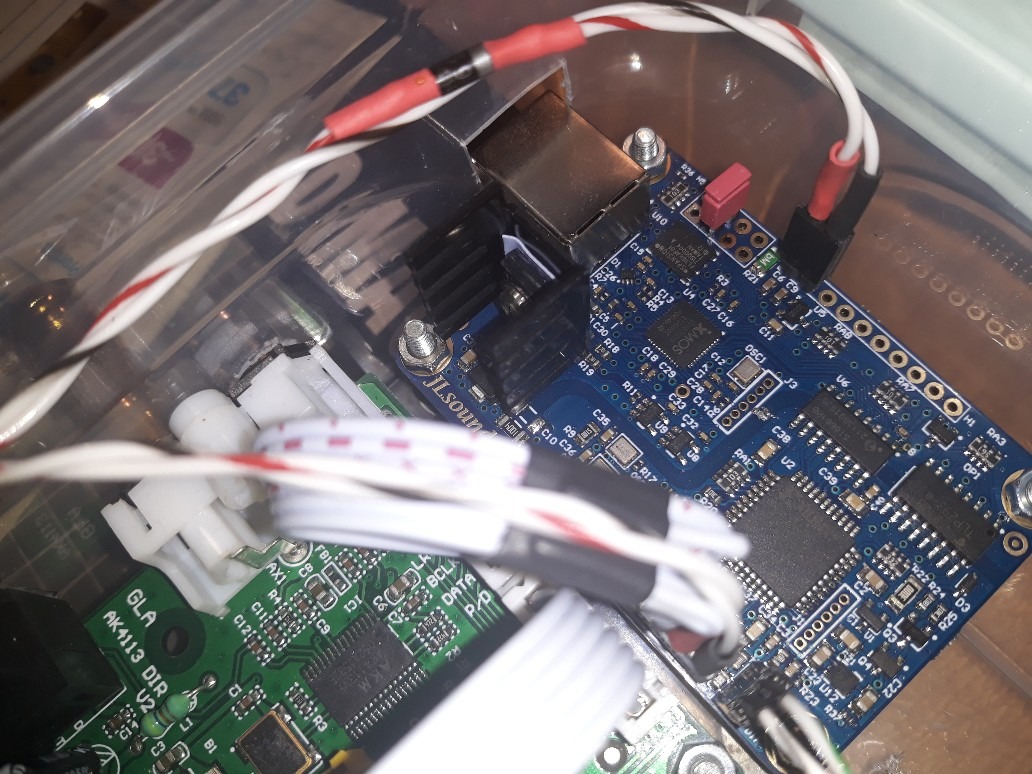

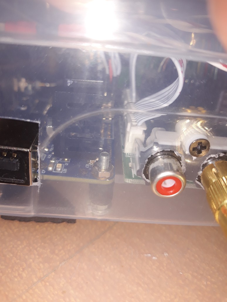

I replaced the heatsink on the JLS board (on the BD139 transistor). The combination of a 4VDC power supply and a slightly larger heatsink gives a slightly lower temperature. One cooler rib can be shortened by 2-3 mm so that it does not touch the spacer or the nut. Isolator is silicone washer. The original heatsink does not have thermal paste or good contact, which means that we do not know the temperature of the transistor. Now it is safe.
