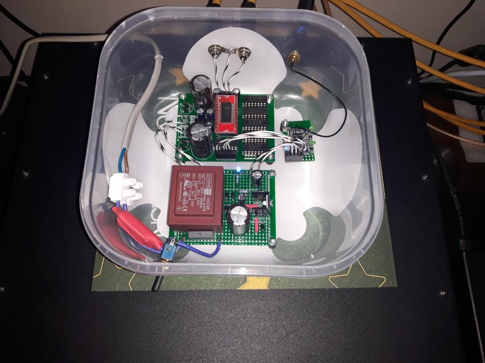

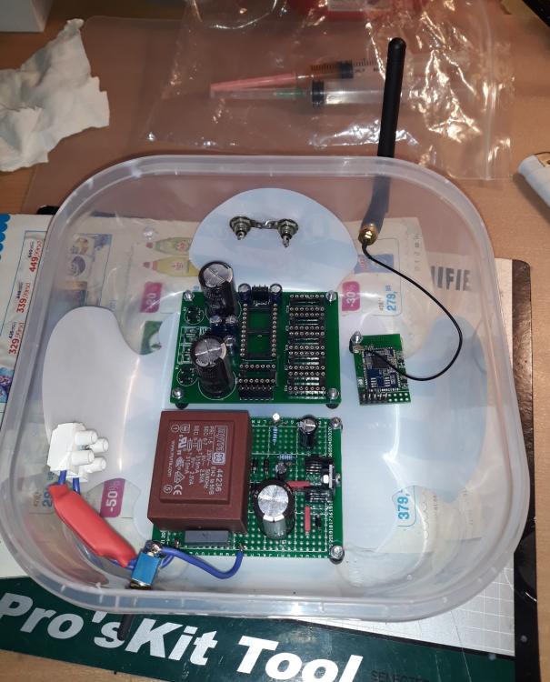

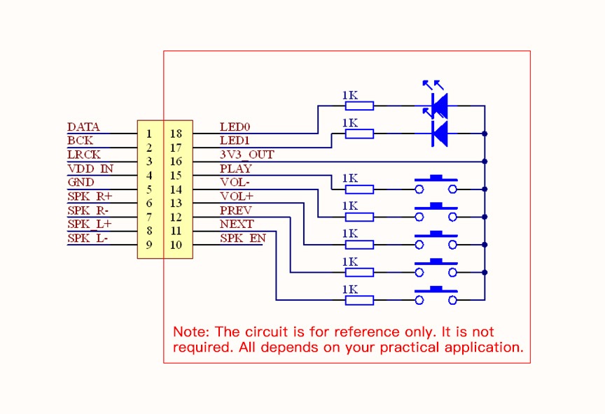

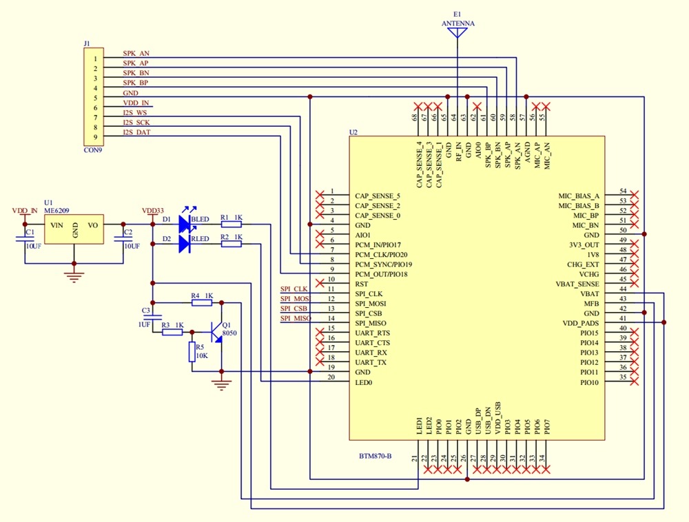

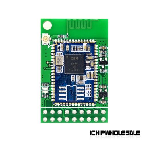

Shift registers are cheap, and then the choice of input interface is large, USB, SPDIF, TOSLINK, Bluettoth ... to I2S
Let's say this is my cheap experiment, one BT 5.0 module with I2S output and a Pavouk AD1865 DAC. It can also be used with any Miro DAC, all the same. The sound is very decent when using FLAC files, a little less decent with Youtube, Internet radio and the like. It's a pity that BT5.0 does not have lossless transmission.
