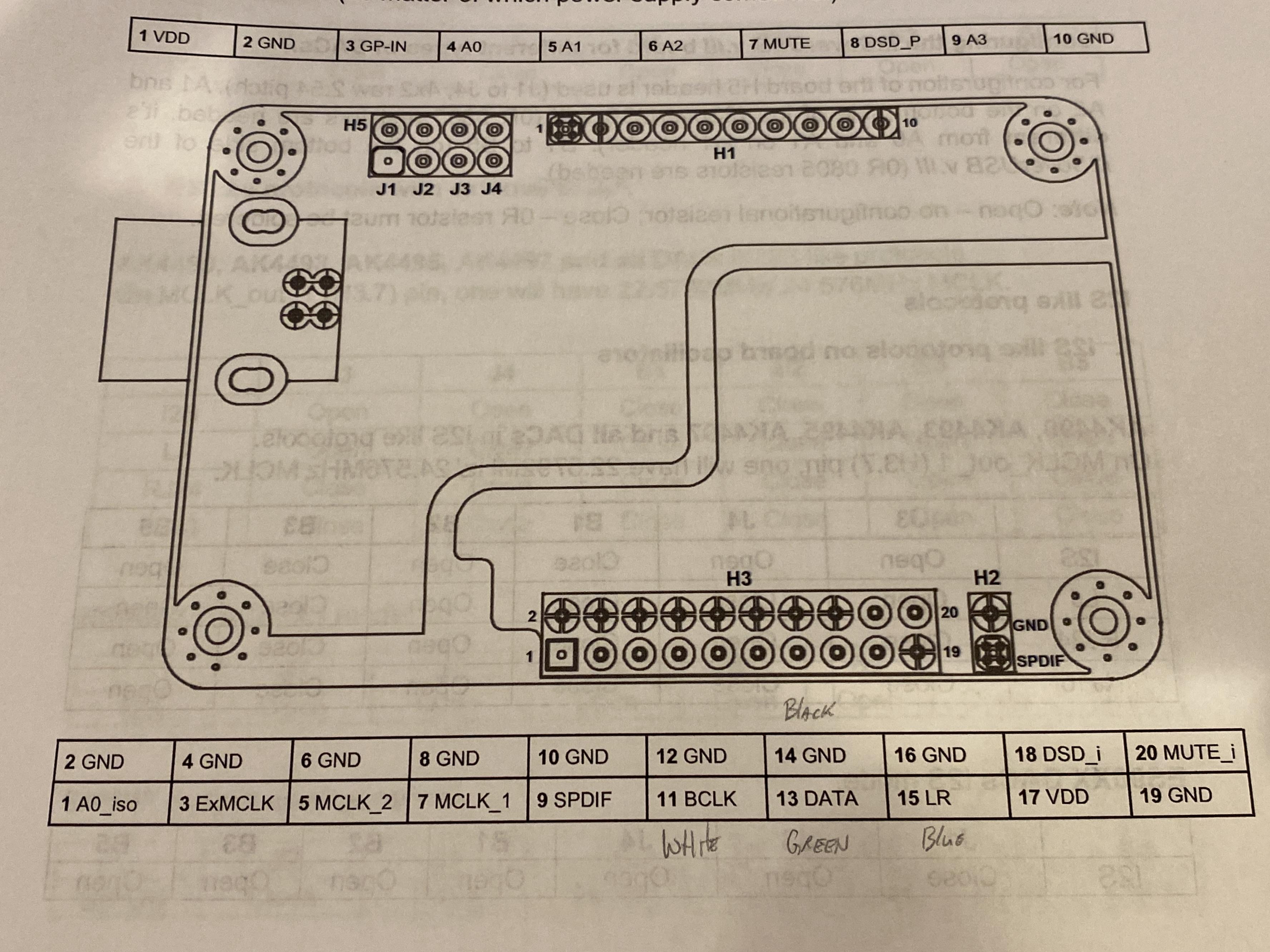

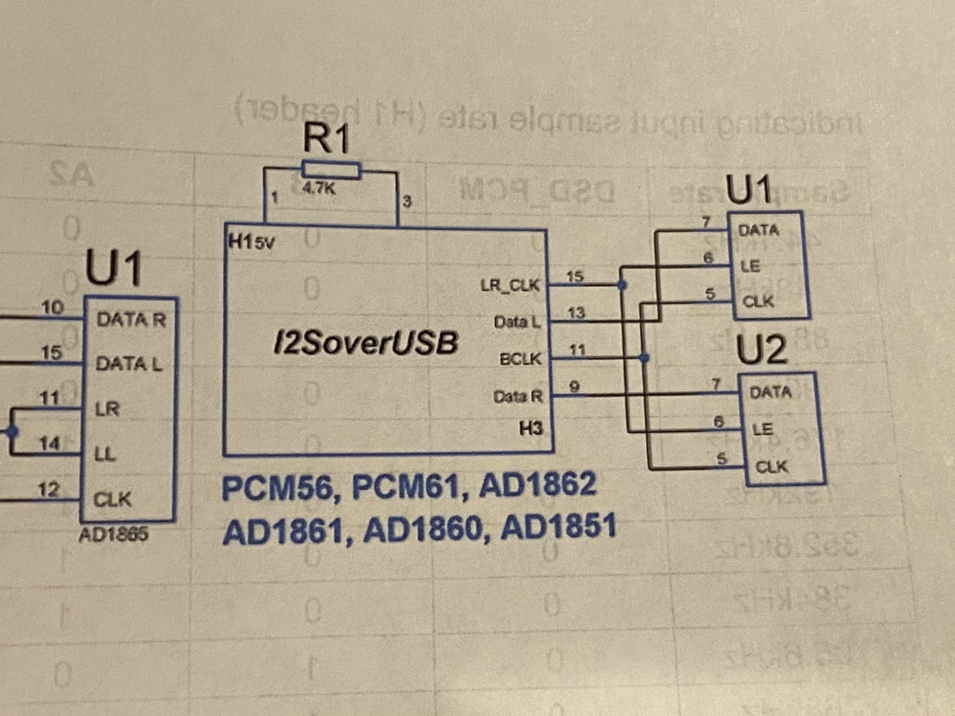

I received my JLSounds I2SoverUSB board and am trying to connect it to this dac board, but I’m not having success. It’s using BUS power for the USB section and an external psu for the oscillators and reclock, this is confirmed to work. I also have confirmation the Mac sees the I2SoverUSB.
The input header is wired like this:
I2SoverUSB BCLK —> BCK Dac
I2SoverUSB DATA —> DATA Dac
I2SoverUSB LR ——> LRCK Dac
GND ——> GND
If I turn the volume up high I hear faint distorted music!
Obviously, I’m doing something incorrectly??
Does anyone have experience configuring this I2S board?
JLSounds I2S has galvanic isolation between input and output (separated GND).
First try to power the isolated part (output) from an internal regulator.
This isolated output must be powered (either from internal regulator, or from external (+5V DAC)), connect the internal regulator:
Connect H1:1 with H3:17 (VDD)
Connect H1:2 with H3:2 (GND)
Your second picture is not the reference, it is reference only for direct connection without the glue logic (see my post #538) ...
The reference for DAC with glue logic still be this (without R1):
I2SoverUSB BCLK (H3:11) —> BCK Dac
I2SoverUSB DATA (H3:13) —> DATA Dac
I2SoverUSB LR (H3:15) ——> LRCK Dac
GND (H3:14...) ——> GND
But now in manual is section with different I2S protocols, do the following configuration from the page 5:
"JLsounds AK4396 DAC board I2S mode (old I2SoverUSB board)"
J3:Open, J4:Open, B1:Close, B2:Close, B3:Close, B5:Open
... this should be the standard I2S mode in 64-bit frame
If that worked, you can try to power the isolated part (H3:17 and H3:2) from +5V DAC board 🙂
  • Thank You
Reactions: Vavilen
Yahoo!! Music!!😀😀
Thanks Miro, your guidance saved me from pulling out the little bit of hair that’s left on my head!
Maybe add this specific configuration to the first post, I’m sure there are other I2SoverUSB users out there.
