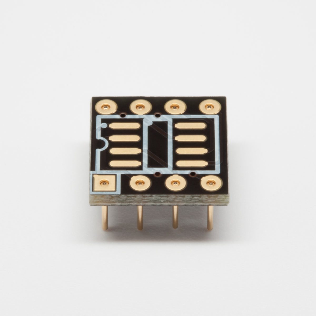

Even soic to dip adaptators are a problem - Miro: any soic outputt planned with a separate buf stage as well ?
Vunce did a nice job with his OPA861 separate output stage. Voltage regulator on such a board is a great benefit.
We could make some universal board in the future, that will handle additional tuning
For now use universal soic adapter and solder the legs similiar to this picture and it shortens the connections.
You can always add a capacitor from the top
