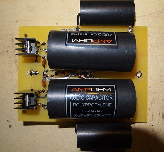

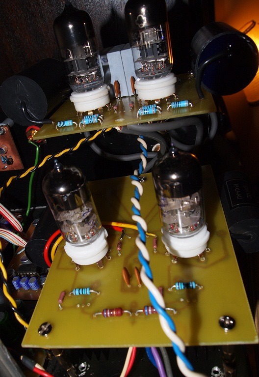

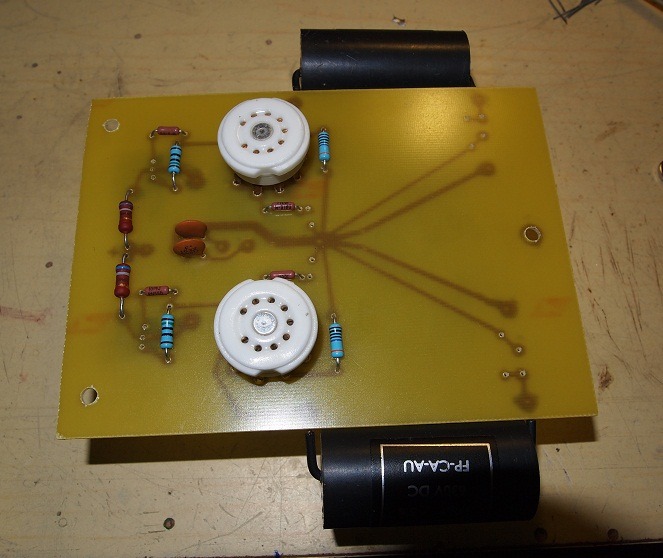

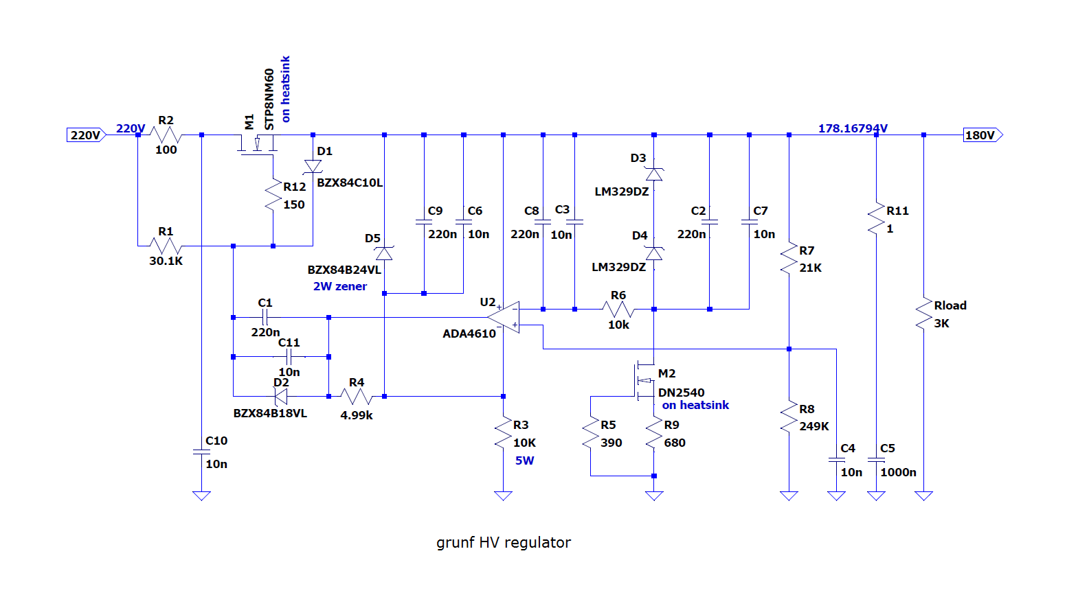

Due to self-oscillations, you have depletion mosfets and ECC88 which is problematic itself.Hey Grunf, thanks for your valuable input. Just for me, why is important to miniaturize CCS traces?
Gate stoppers and grid stoppers must be next to the gate or grid. The same applies to the high-ohm resistors in CCSs. Heating performed directly with the wires, with the mandatory small inductor in series and 1nF ceramics.
And in the end, all because of better performances.
The photos show the I/V stage with 6S4P and CCS with one DN2540 (12 years ago).
Well, it's not, I stick to the old proverb; as much money as much music .
Otherwise, this is a simplified version of the regulator that I used for tubes and it really does a great job, the difference is quite audible if I compare it with classic HV power supplies and regulators.

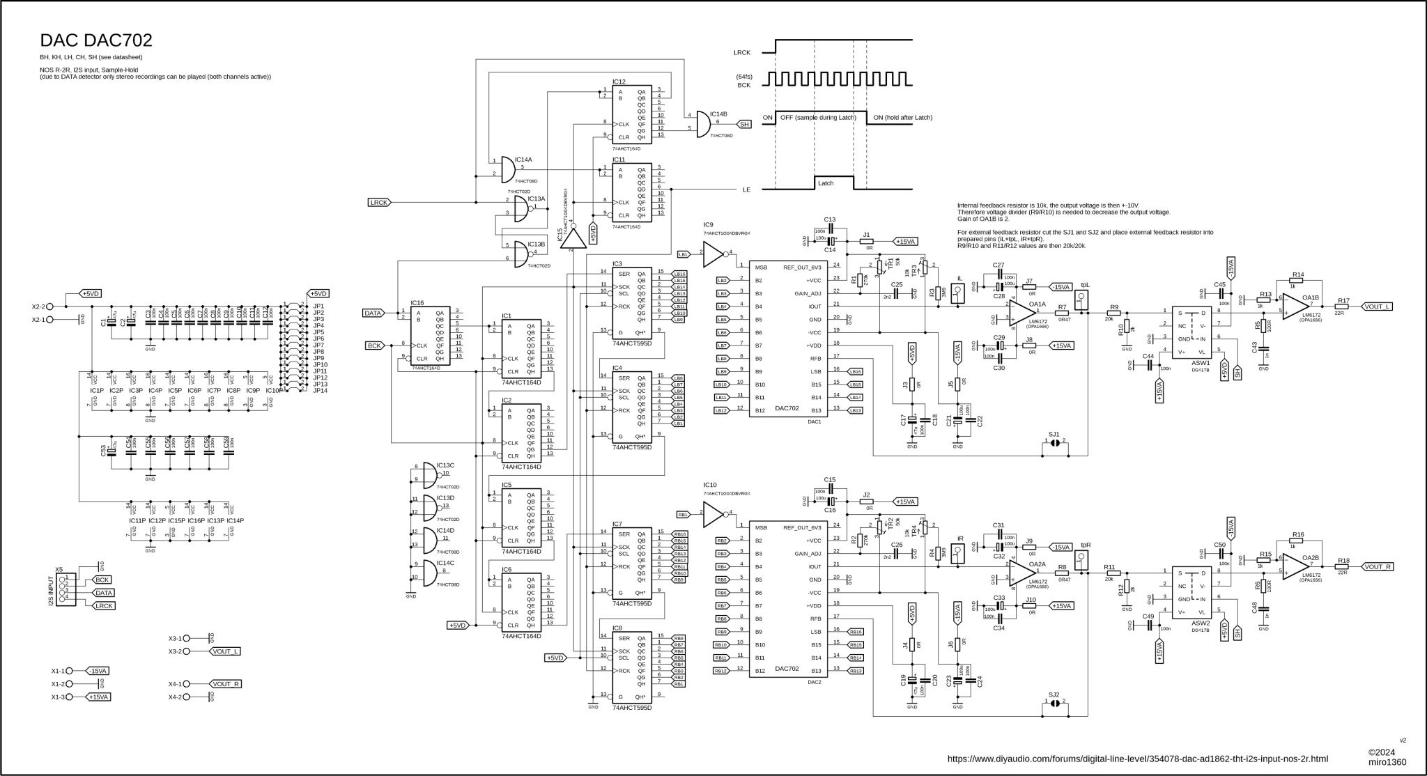

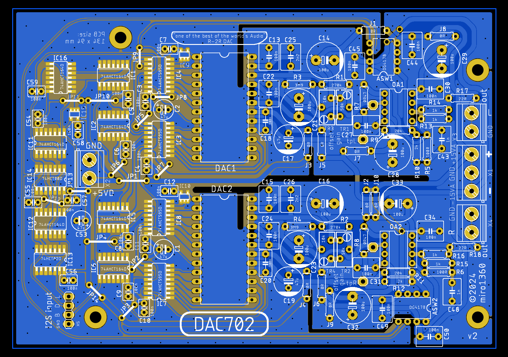

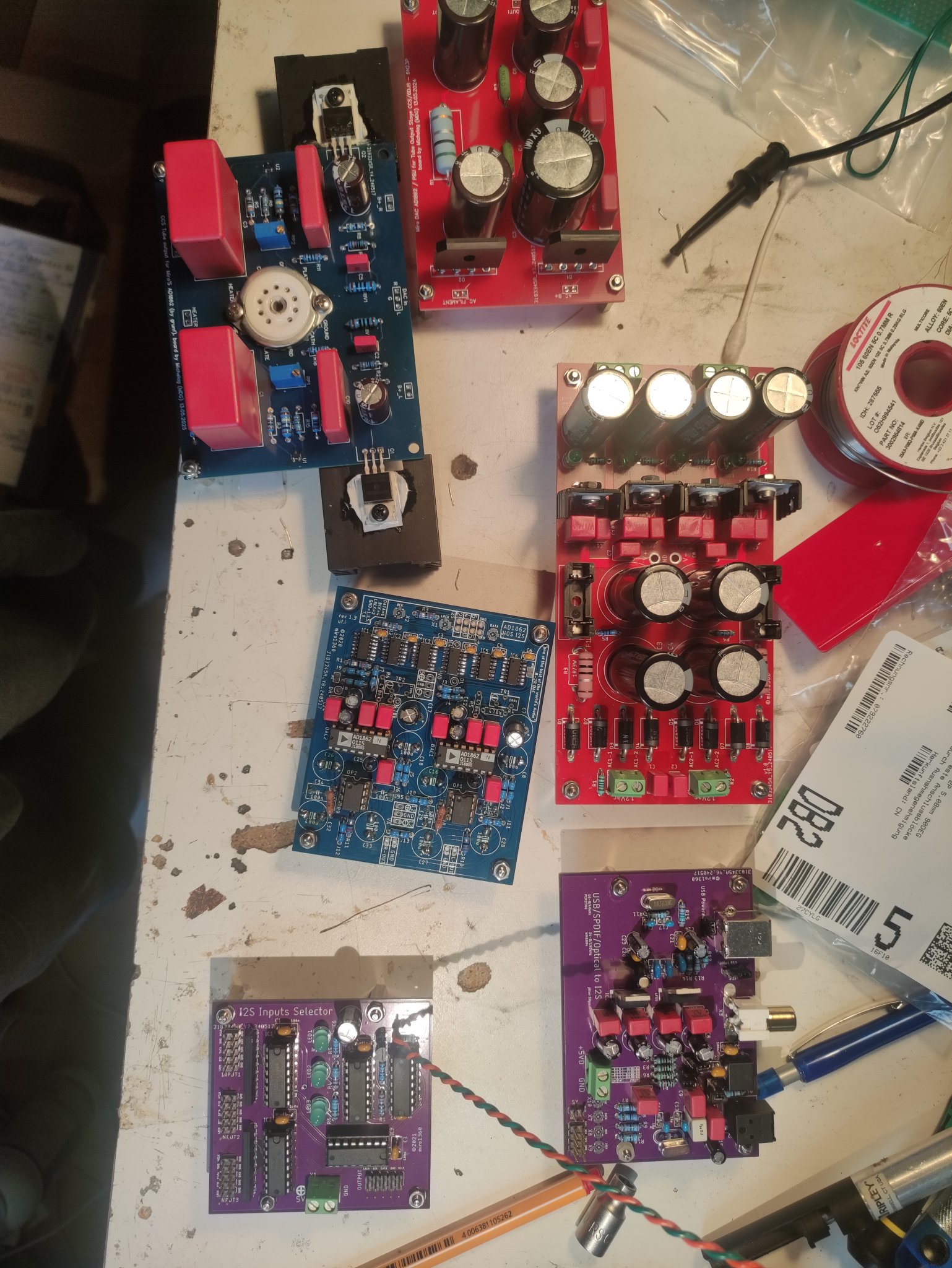

DAC702 update
I tested the first schematic, it works but not "great" because present are audible glitches when the volume is very low
In this case the easy way is not possible, it was to be expected. Sample-hold circuit was added with digital control circuit.
I will have to test it somehow on the first prototyping board, so things are getting a little complicated 😎
If the test succeeds, this will be the result.
@zoom777 This trimming is for testing purposes. So far what I tried the offset is almost impossible to set with standard multimeter, in fact, it is almost zero from factory. It will be a very fine tuning which is probably useless for practical use. Imagine that based on datasheet you need set with offset trimmer TR3 (TR4) voltage 0.000305mV on tpL (tpR) You need a precise multi-digit multimeter for that. The same is for TR1 (TR2), where the maximum positive voltage exact 10.000000V on tpL (tpR) is set, or the maximum negative voltage -9.999695V. So we are most likely talking about setting the precision on one bit here, what is 0.000305mV. I made a simple code for arduino with which you can set these values (the code actually sends bits via I2S ... it is also applicable for AD1862, but here it would be an even more precise setting, since there it is 20-bit precision, and ultra-precise trimmers are needed - again useless for the practical use )
I haven't fully tested it yet, because I'm waiting for the parts so I can see if the changed digital input with the sample-hold circuit works at all

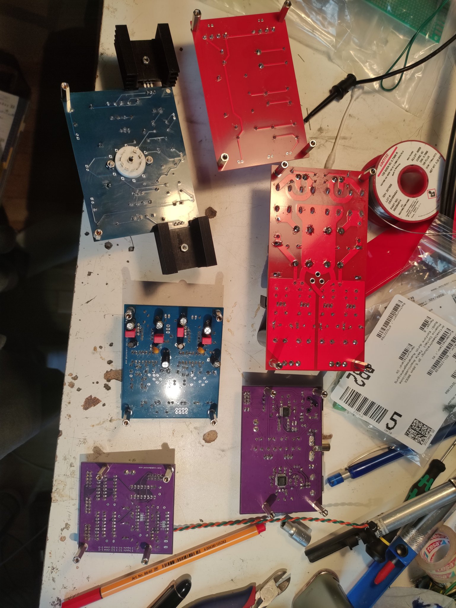

Hello friends, I've looked back in the thread in a quest for answers but...
Ok, if someone has the patience to drop me a 2-liner for my questions... I guess everyone not acquainted with the digital world would benefit...
Thank you (for the moment 😊)!!!
Mike
- what's the function of the shift registers? Why 2 for data right and all 6 for data left?
- will be there a significant audio improvement with and without shift registers?
- in the inputs board to i2s, what's the difference between the different decoders i2s, lj, RJ (read there is a change in bck, but will this be correctly interpreted by out ad1862?)
- what is that optional msb adjust, for which we are leaving the six resistors out?
Mike

Seems like another abandoned project DAC702 still have some digital noise on the output. It will not be a good chip for audio use ... there is a similar digital noise problem as with discrete DACs and I haven't found a way to eliminate it. In my opinion the internal switches are not immune enough to digital interference and that's where the noise is transferred to the current output. Placing digital filters or analog filters on the output is not the way.DAC702 update
If someone has an idea or know how to deal with this digital noise issue, I can send the project files
So the candidates for excellent audio remain AD1862, PCM63, TDA1540, AD1865, there is a lot to choose from
